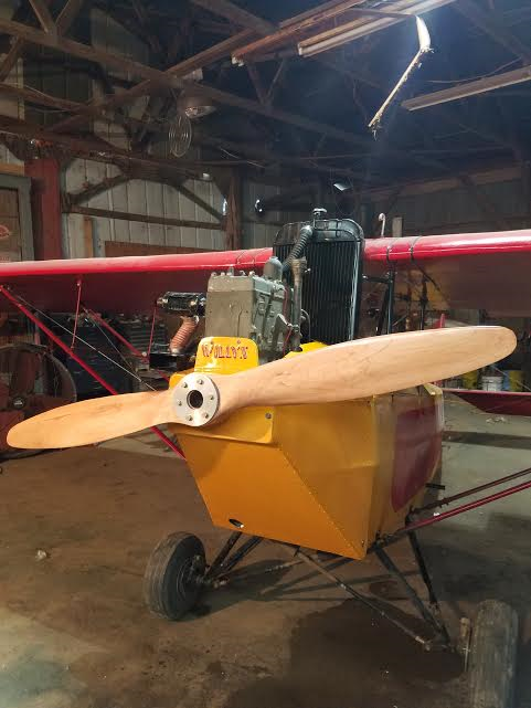

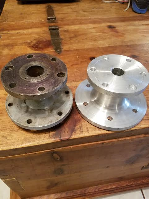

I have spent the last few days making more modifications to the Jeepenpol. I finished my new propeller and did a job I have been avoiding all winter and that was to turn a new prop hub out of a large chunk of aluminum on my lathe. I have been testing and using a hub I made out of three pieces of steel welded together then turned true. I of course never intended to fly behind this hub, but I have and it was probably ok but I think I won't push my luck any further. I know some of the more particular builders are shaking their heads and saying "what the hell is wrong with this guy", but I assure you I have a document that says I am a mechanic of good standing with the USA gubment, anyway I wont go further into that discussion.
I have removed the little extra radiator I added to the side to help cooling because I don't think it is needed now that I have the big 8N ford radiator , and the last time I flew the temps stayed low. This mod alone saved about 7-8 lbs off the front, the aluminum hub is about 3 1/2 lbs lighter than the steel one. The Maple prop is about 2 lbs heaver than the the walnut one so I have made a significant improvement in weight.
I called my DAR and have set up a visit for next week , so I may wait to try the new propeller after his visit like I am suppose to , (there goes those heads shaking again) . I am going to ask him if he will give me the four hours on the tach against the 40 hour restriction , but he probably wont, (he seems like he takes his work seriously). I mounted a used , but time remaining , ELT because when I asked if he would require one his one word answer was (yes), I replaced my aluminum data plate that I stamped out with a stainless data plate that I stamped out.
Another interesting development I will share, When I first mounted my first propeller, I used fine thread grade 8 bolts which I drilled for a cotter key and a castilated nut, and let me tell you it isn't easy to drill grade 8 bolts for a cotter key as the holes never line up just right (more head shaking?)
After a few messed up bolts I finally got six that would work , and I have used them ever since. When mounting my new prop I managed to strip one of the bolts , and because I am trying to replace all the temporary stuff , I ordered AN6-44 undrilled bolts and AN drilled nuts which I safety wired very nicely. Proud of my neat and safe job , I was telling another pilot friend of mine about the change and he mentioned, "Well you have the nuts safety wired , but the bolts can still turn and loosen,"
"Damn !" I didn't think about that , So I drilled the heads of the bolts and now they are safety wired front and back. I sure am hopeful that I can safely fly soon , I will update later . Kenny

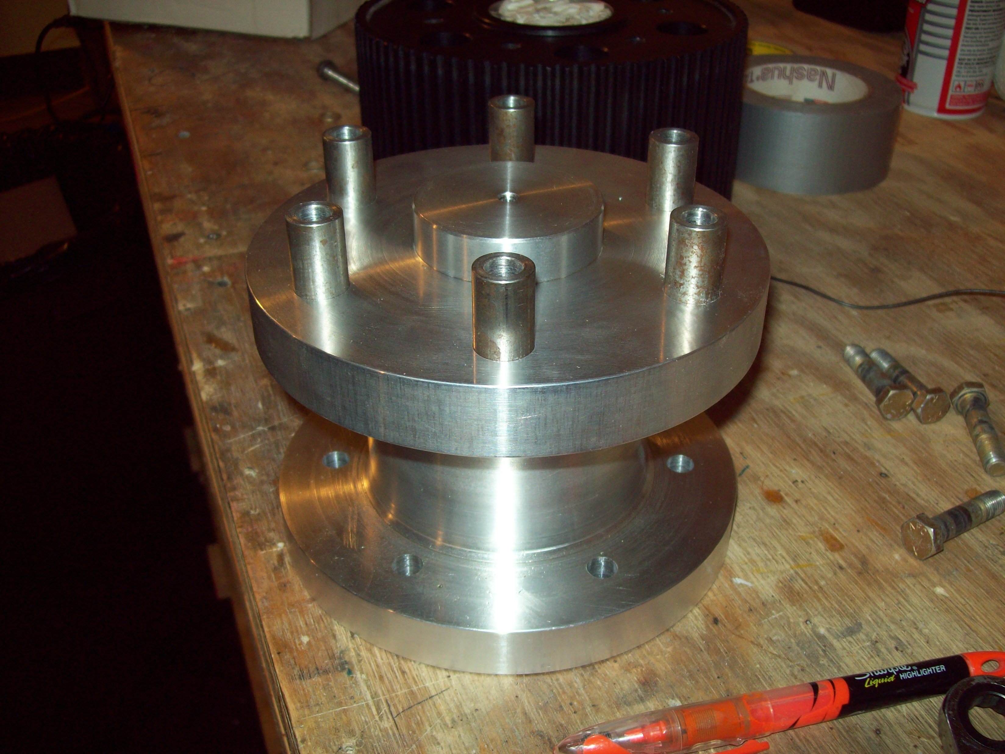

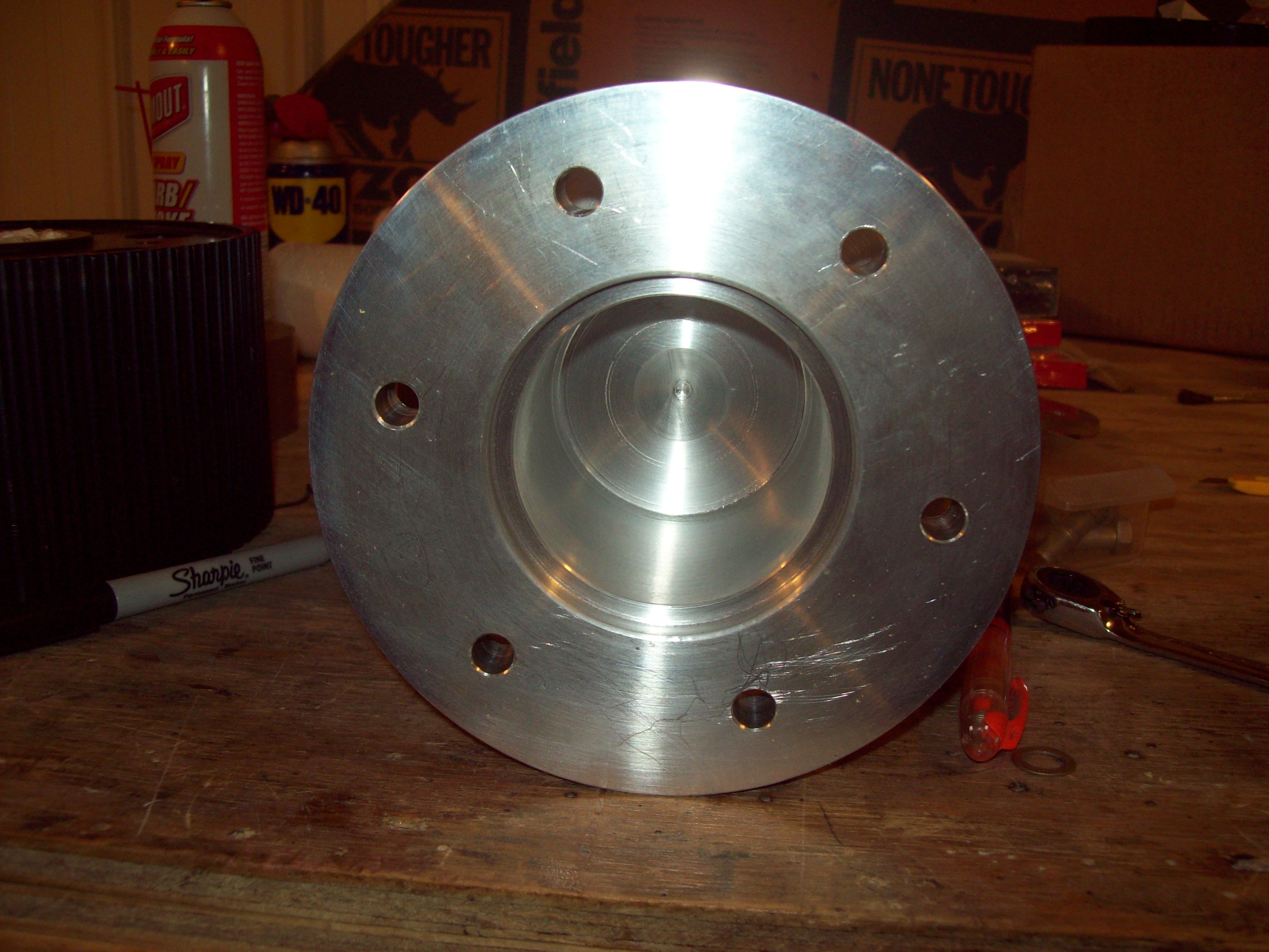

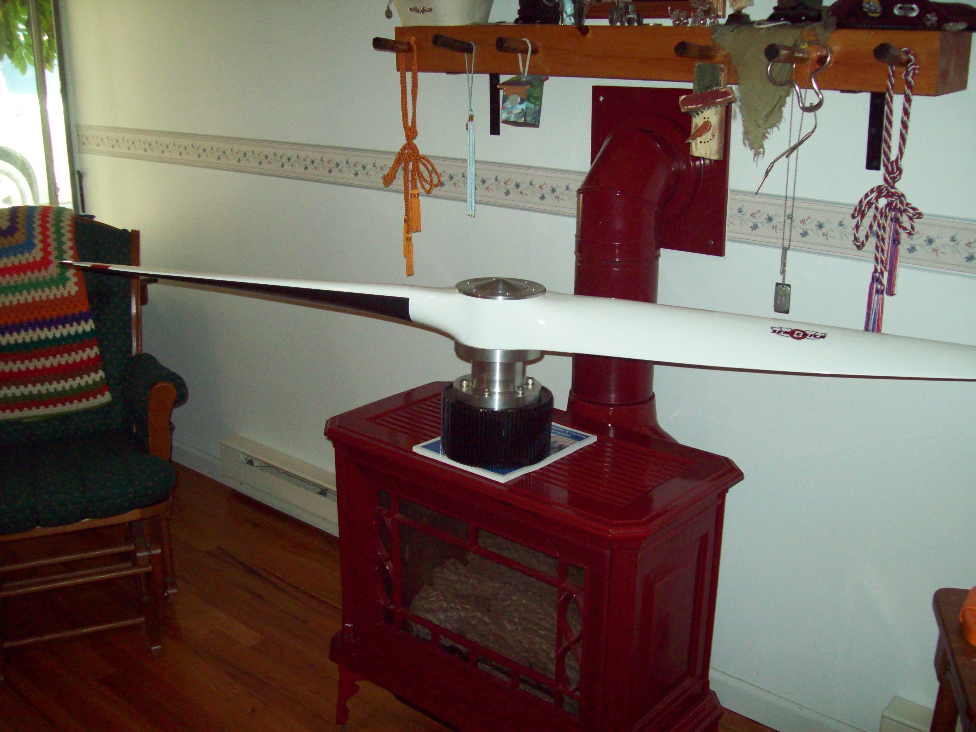

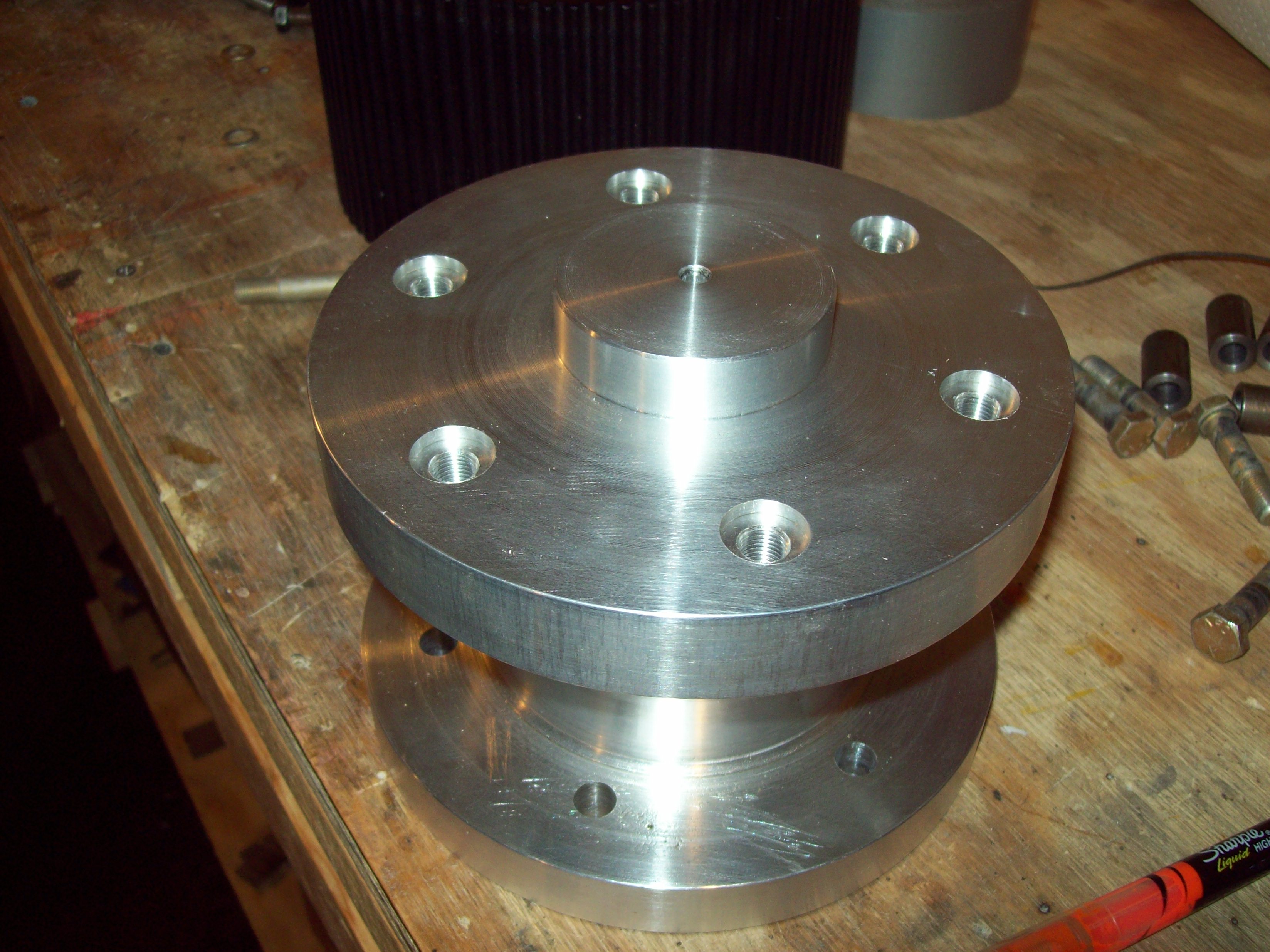

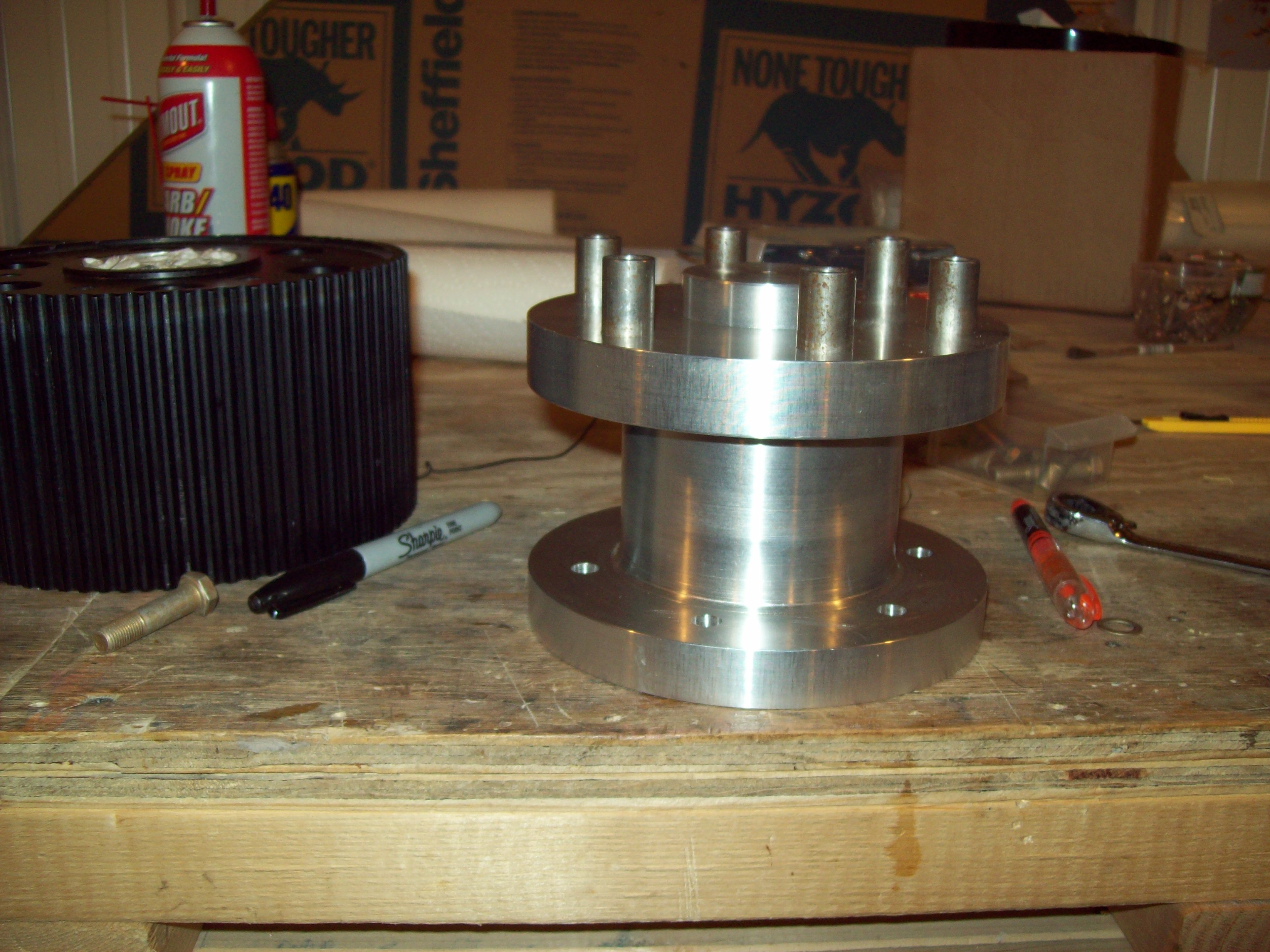

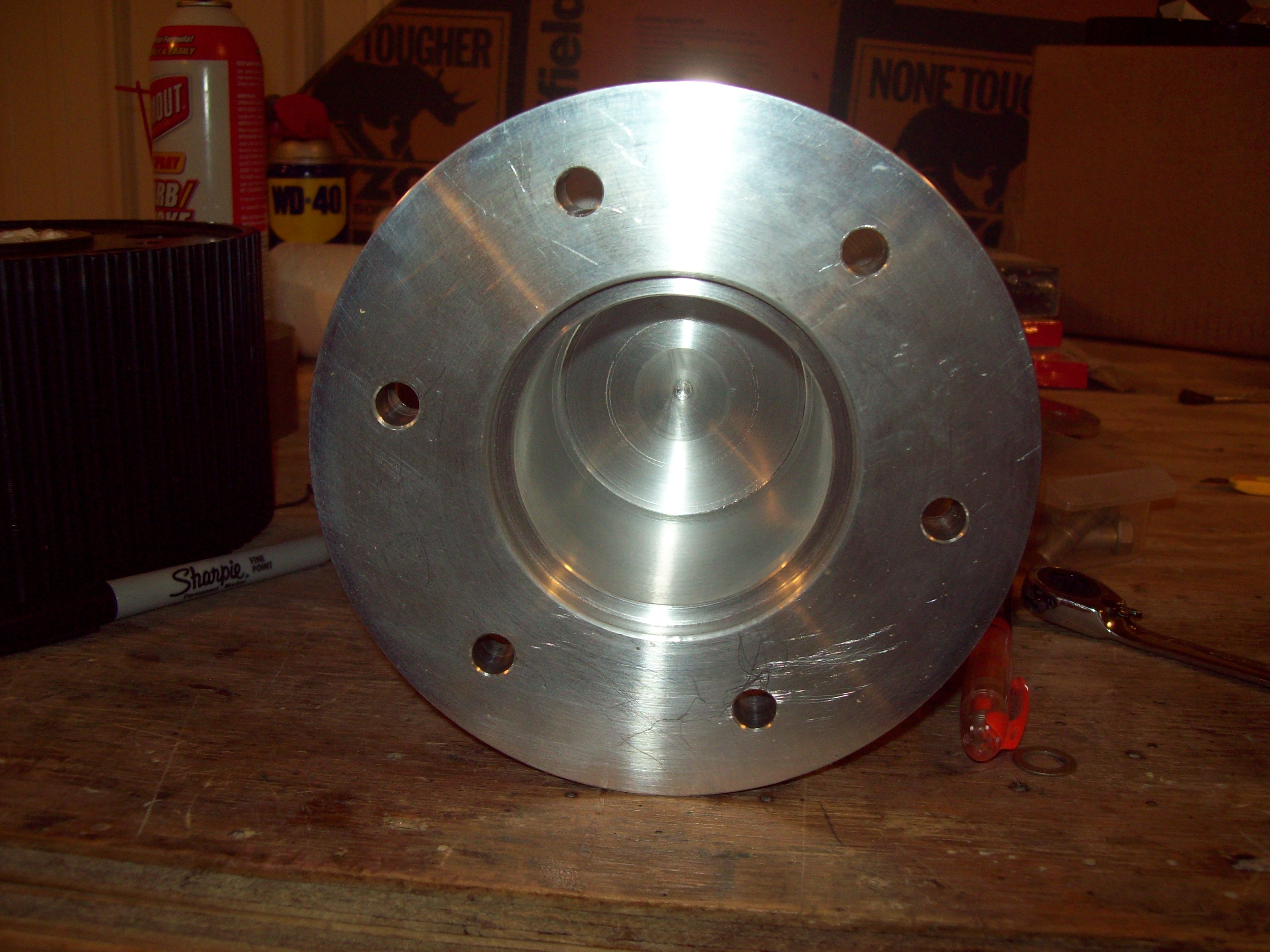

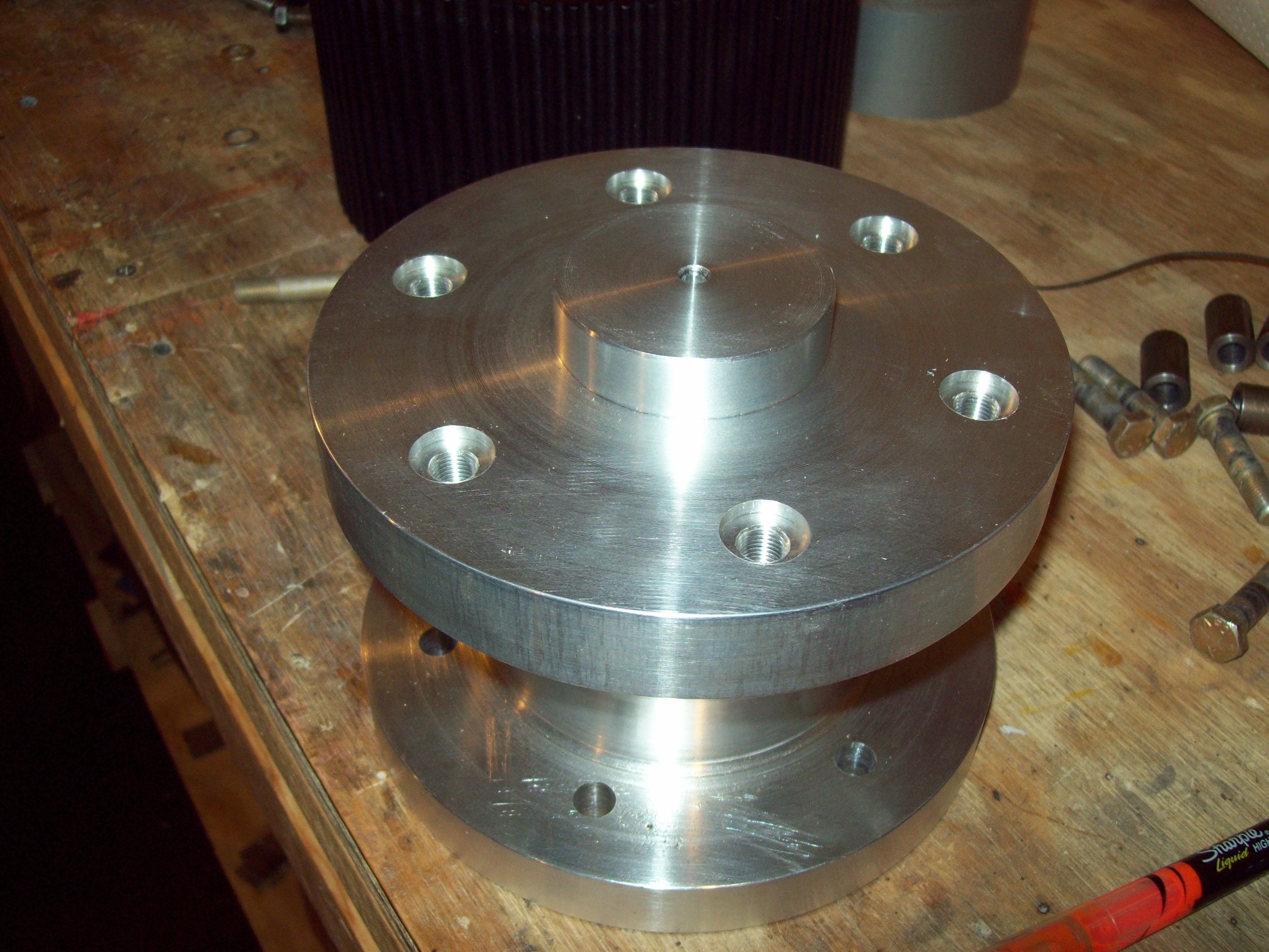

From what I can tell from your pictures, I'm concerned that I don't see prop-drive lugs. I have attached several pictures of the hub I turned down, The importance of the drives is they drive the prop, not the bolts. Sensenich has a lot of detailed information about this and it has long since been the standard used. Using the prop bolts to drive the hub can/will cause heat to build up. Hope the information helps you.....build on.
HD Rose
