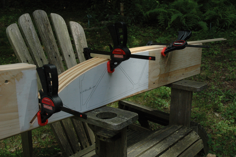

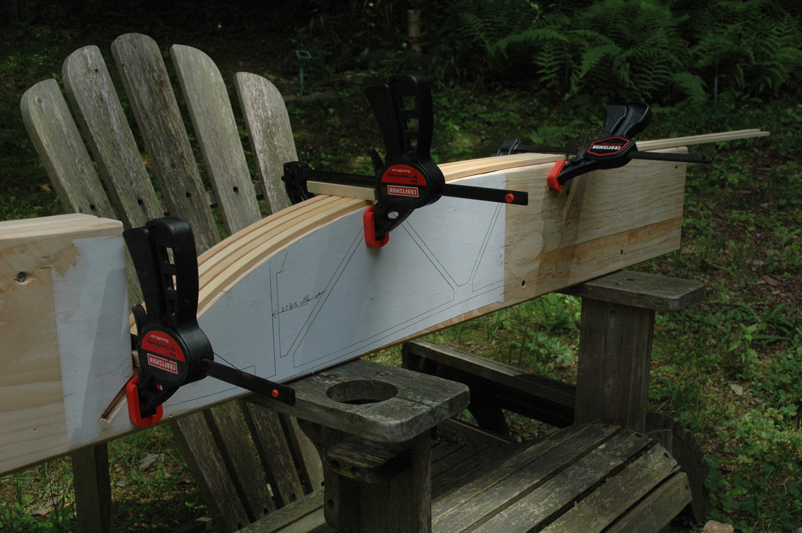

My form was actually cut slightly tighter but just cutting to the shape of the rib would work fine.

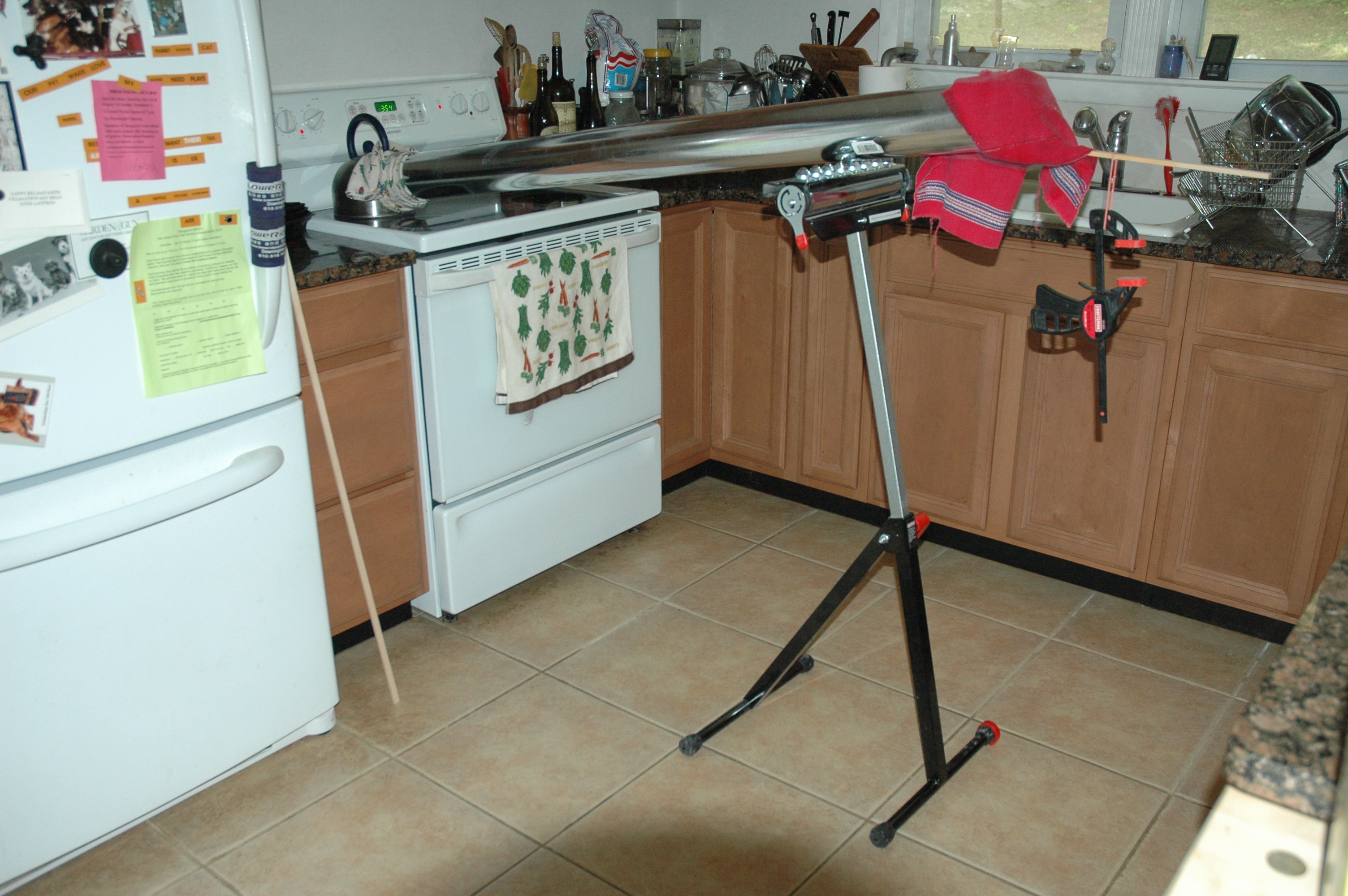

Here are a couple of pics of the form and the high tech steaming device.
