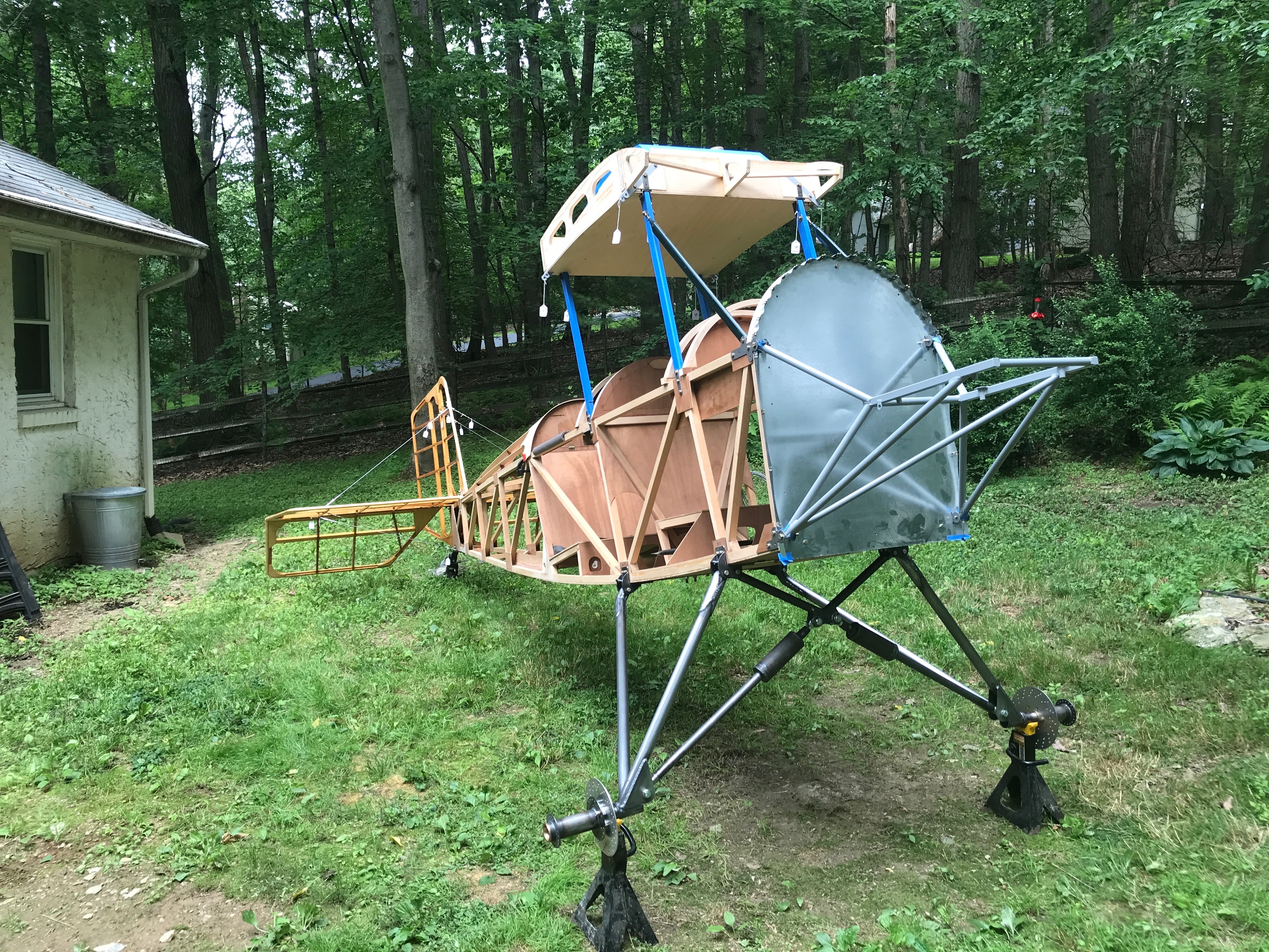

EAB4
Posts: 61
Re: Building the fuselage
Post by EAB4 »
here is where mine is now- plenty strong enough to move around and lots of room to work inside
Lorenzo
Posts: 6
Joined: Wed Feb 22, 2017 8:59 pm
Location: Tellico Plains, TN
Post by Lorenzo »
I agree. Fit everything you can without the sides. There is much that you need to access on the inside that is way easier to do without the sides in the way. Delay gluing them on as long as you can stand it.
Brian Amato
Posts: 112
Post by Brian Amato »
Thanks guys....makes perfect sense.
(Nice welding, my the way)
As I look at your photos, I see the mid braces and cross braces at both the top and bottom of the fuselage, don't actually touch the longerons but touch the gussets at the longerons. Does everyone agree that's as it should be? Can't see any other way to do it. They DO get gussets on the outside at those junctures, tho, don't they.

EAB4
Posts: 61
Post by EAB4 »
Yes, they get gussets on both sides.
