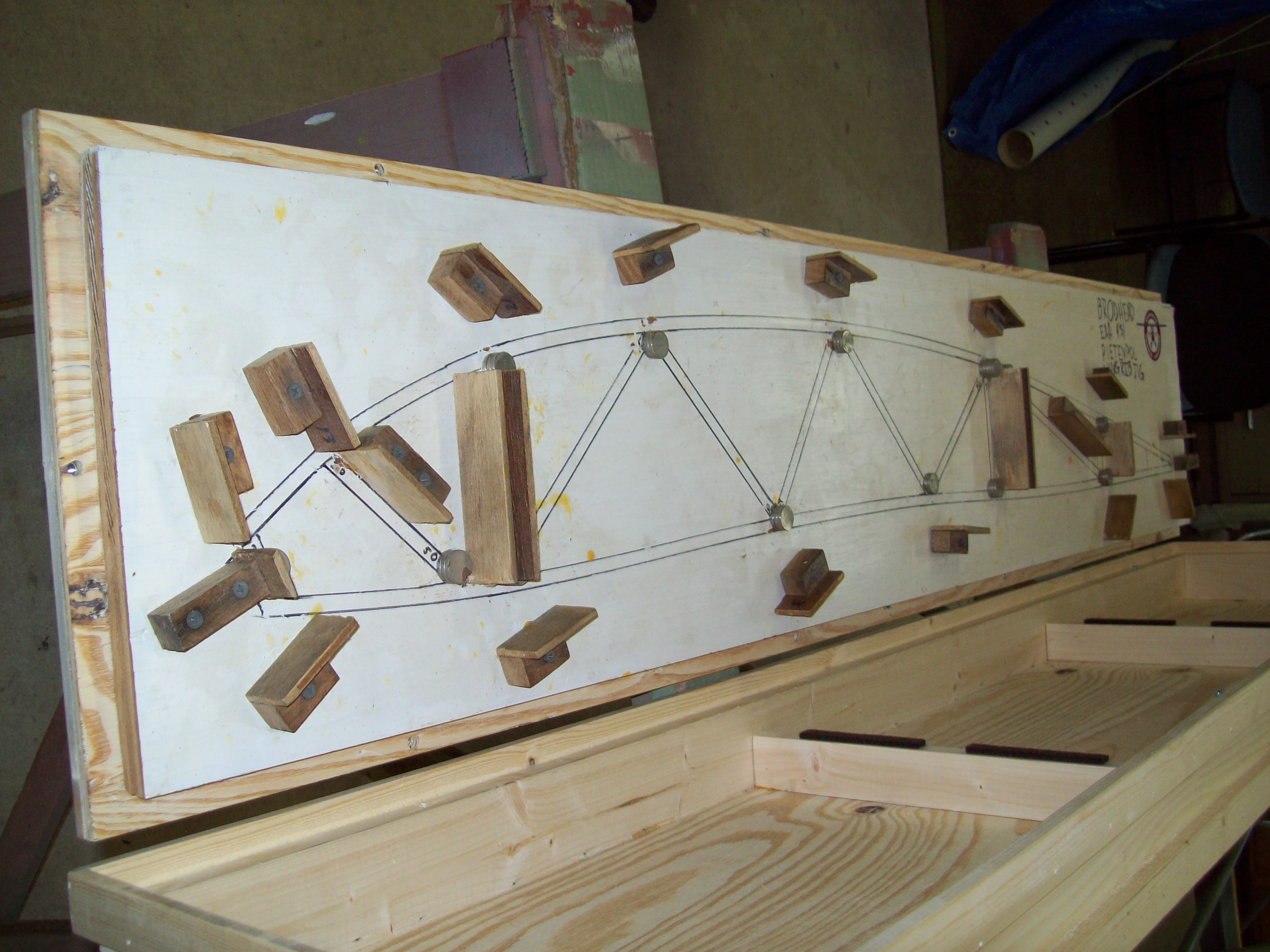

The Brodhead Pietenpol Association has two rib jigs available to borrow. Just pay shipping from Brodhead.

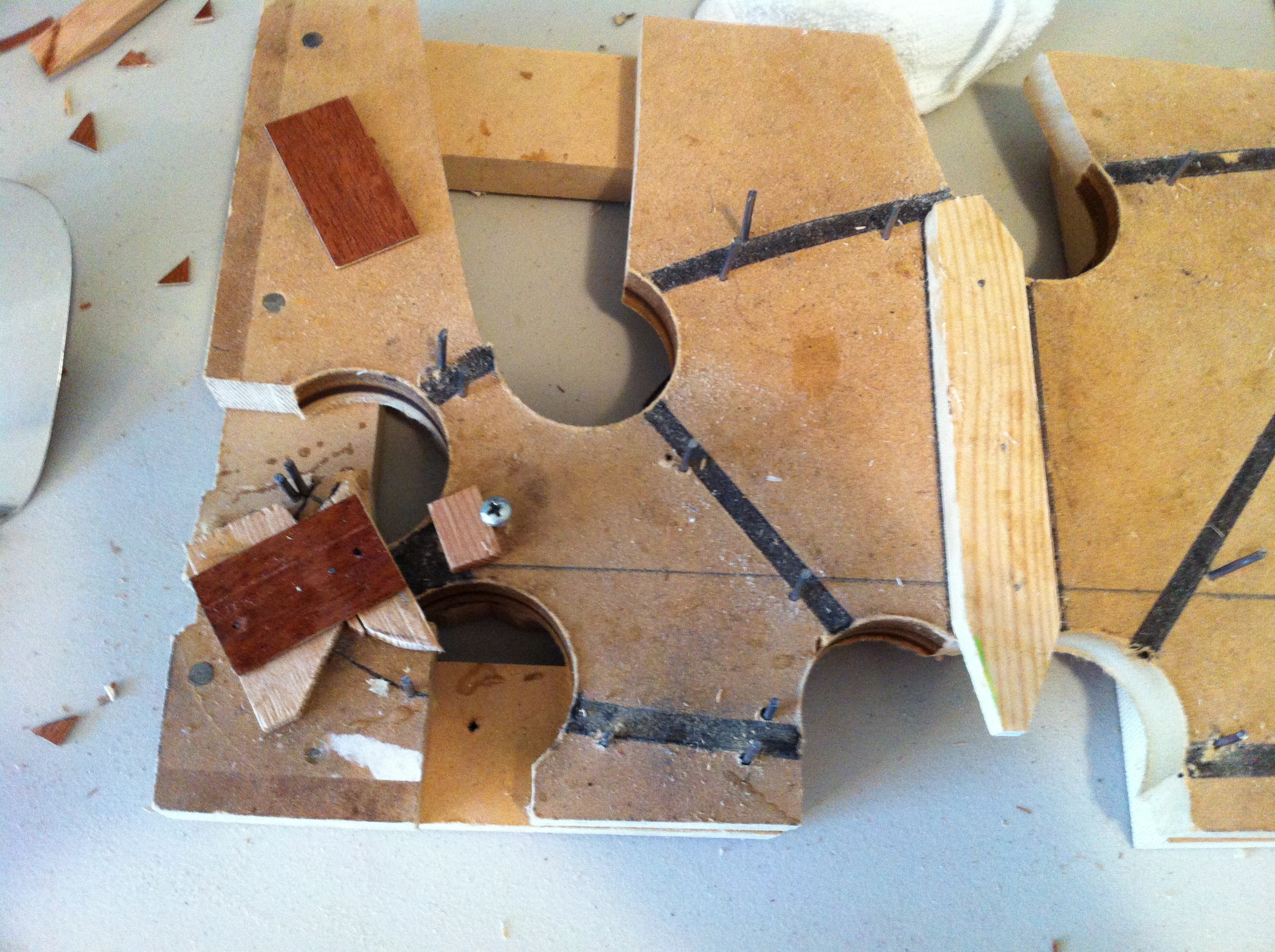

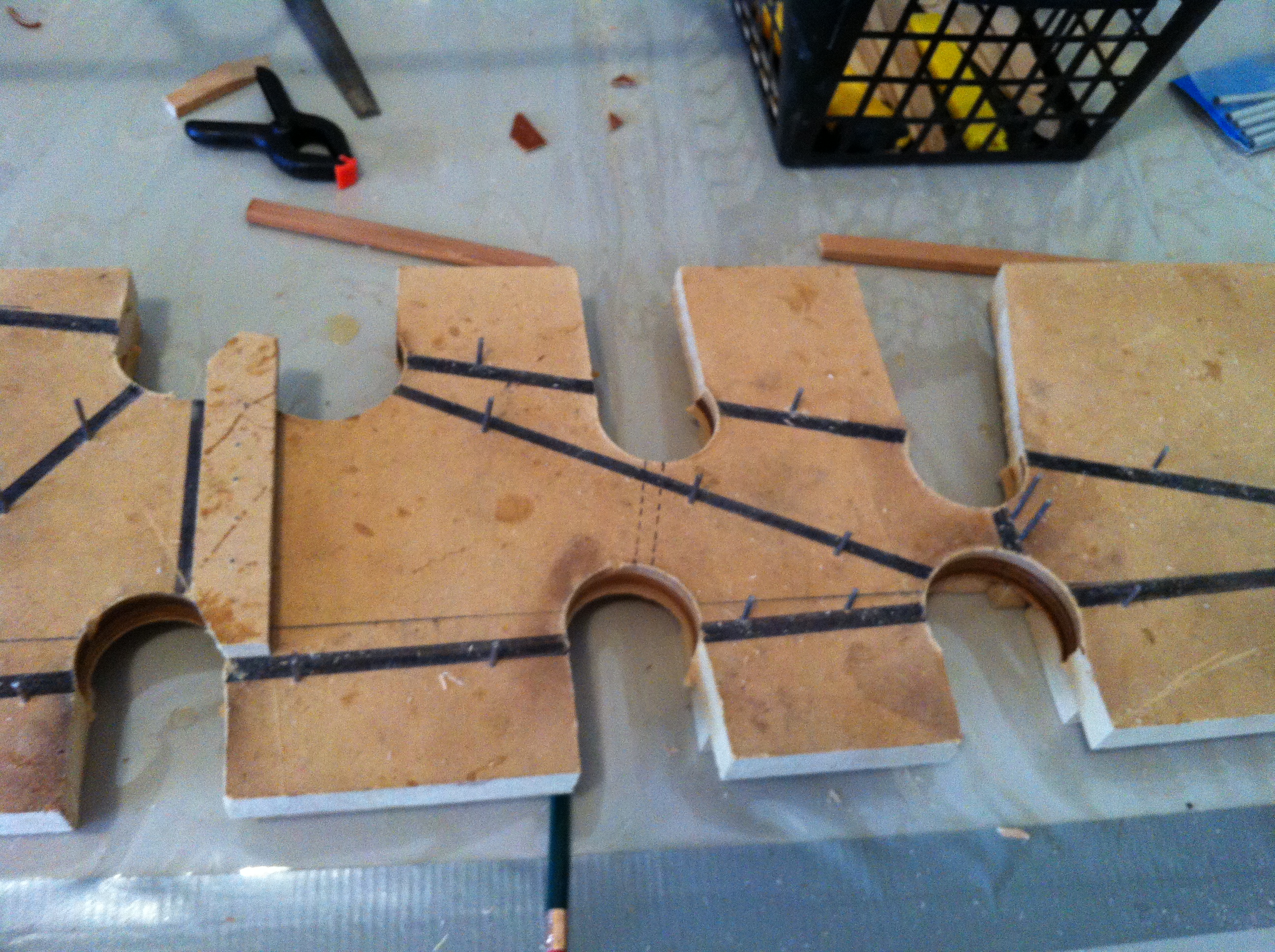

It is very nice of BPA to have a jig to loan, but I would encourage you to build your own. You may need it again, and they really are not hard to make. I made three (yes, it took three to get to one I liked, but I learned in the process). The last one was made from MDF and small nails for aligning the capstrips the verticals and the diagonals. It was not pretty, but it worked like a champ.
Besides, shipping to and from will negate any cost savings, especially if you need it again for some reason. Just a thought.

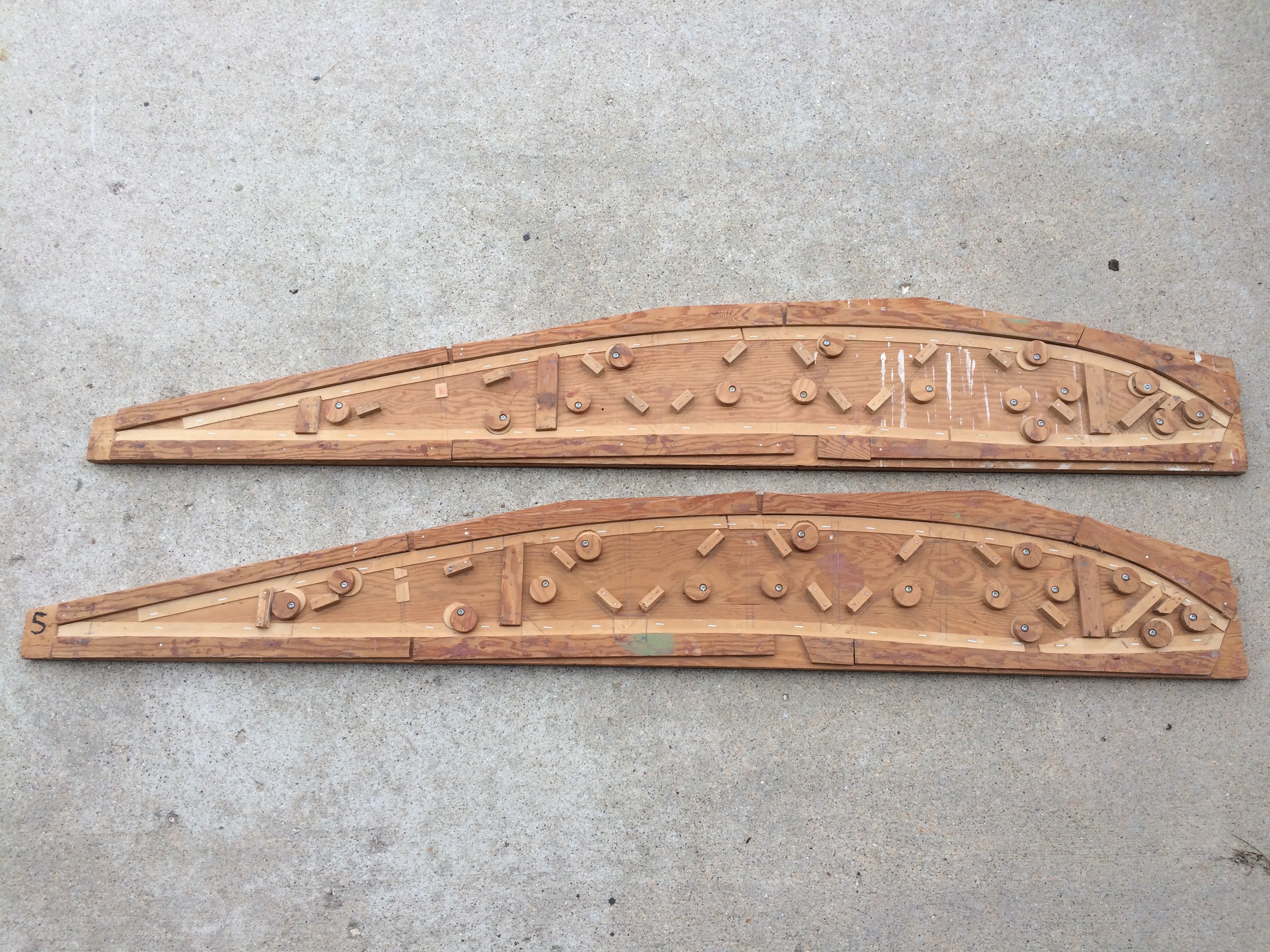

Happy to say that as of Yesterday I have one available!!!!! Just finished my last rib (plus a few spares). I enjoyed taking the time to build it and make it to my specs. I find it more civil to curse at myself for any frustrations with the jig than cursing another guy who built it. :lol: But borrowing one would save a few hours. I'm in SE Louisiana if that's convenient for pick up.

Like I said, it took me three times to simplify it down to these criteria -
- cheap
- simple and easy to build
- solid enough to consistently build ribs
- cheap

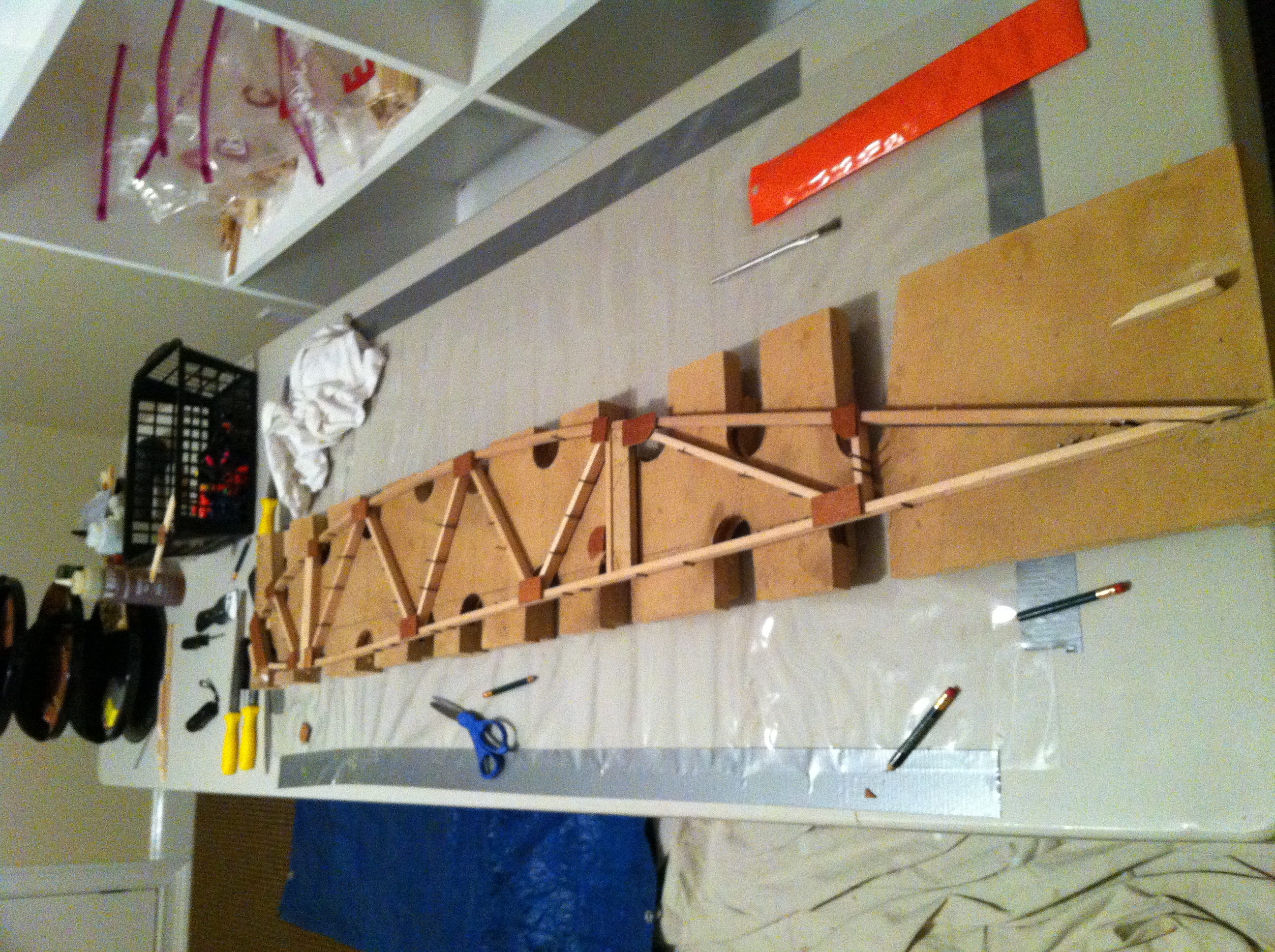

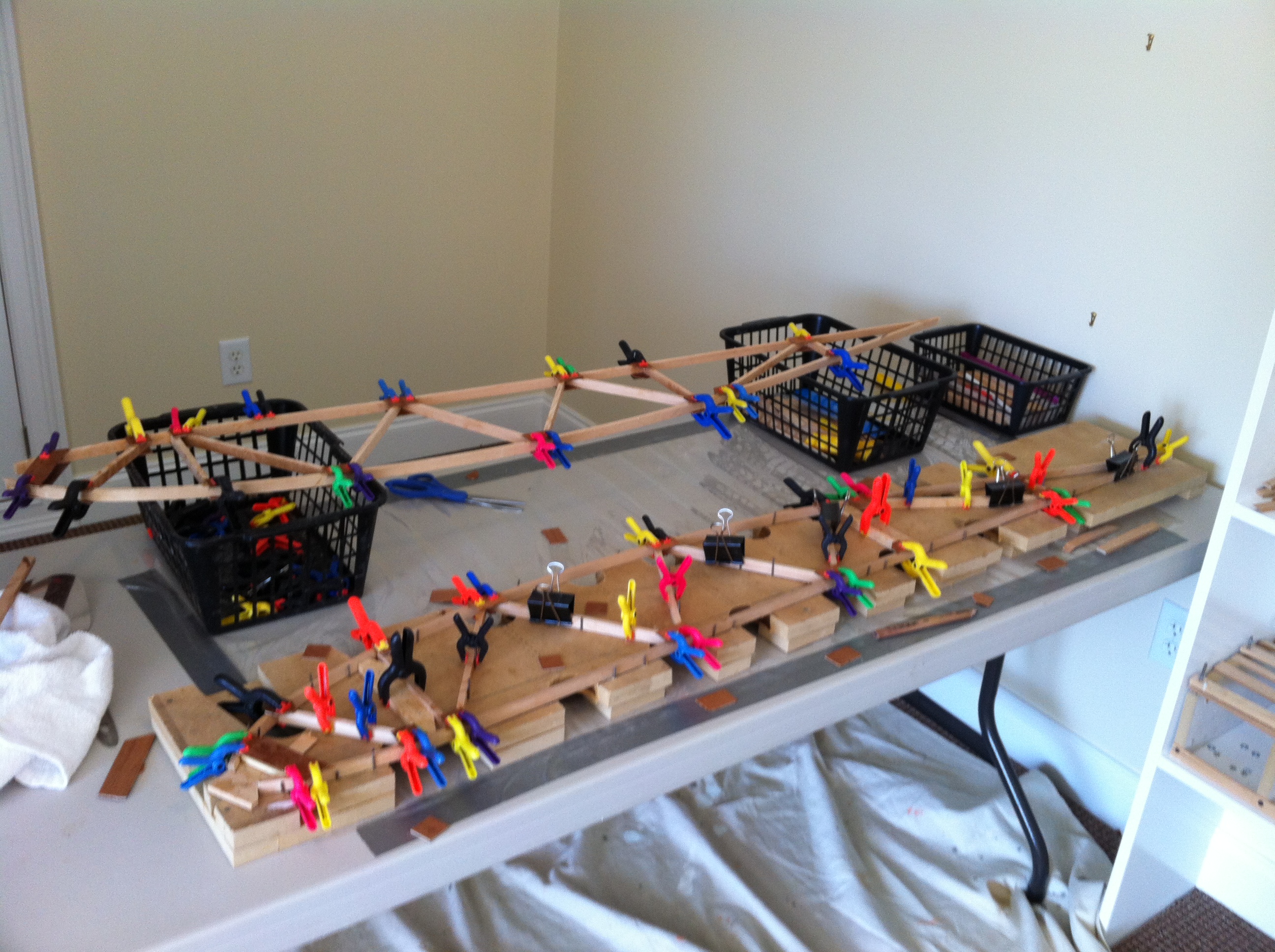

It fulfilled all 3 (or was it 4) criteria, and was extremely simple. With cheap Harbor Freight clamps, I was able to build my ribs with no staples, or nails, about as light as I could possibly make them.

Post by taildrags » Sun Aug 19, 2018 3:10 pm

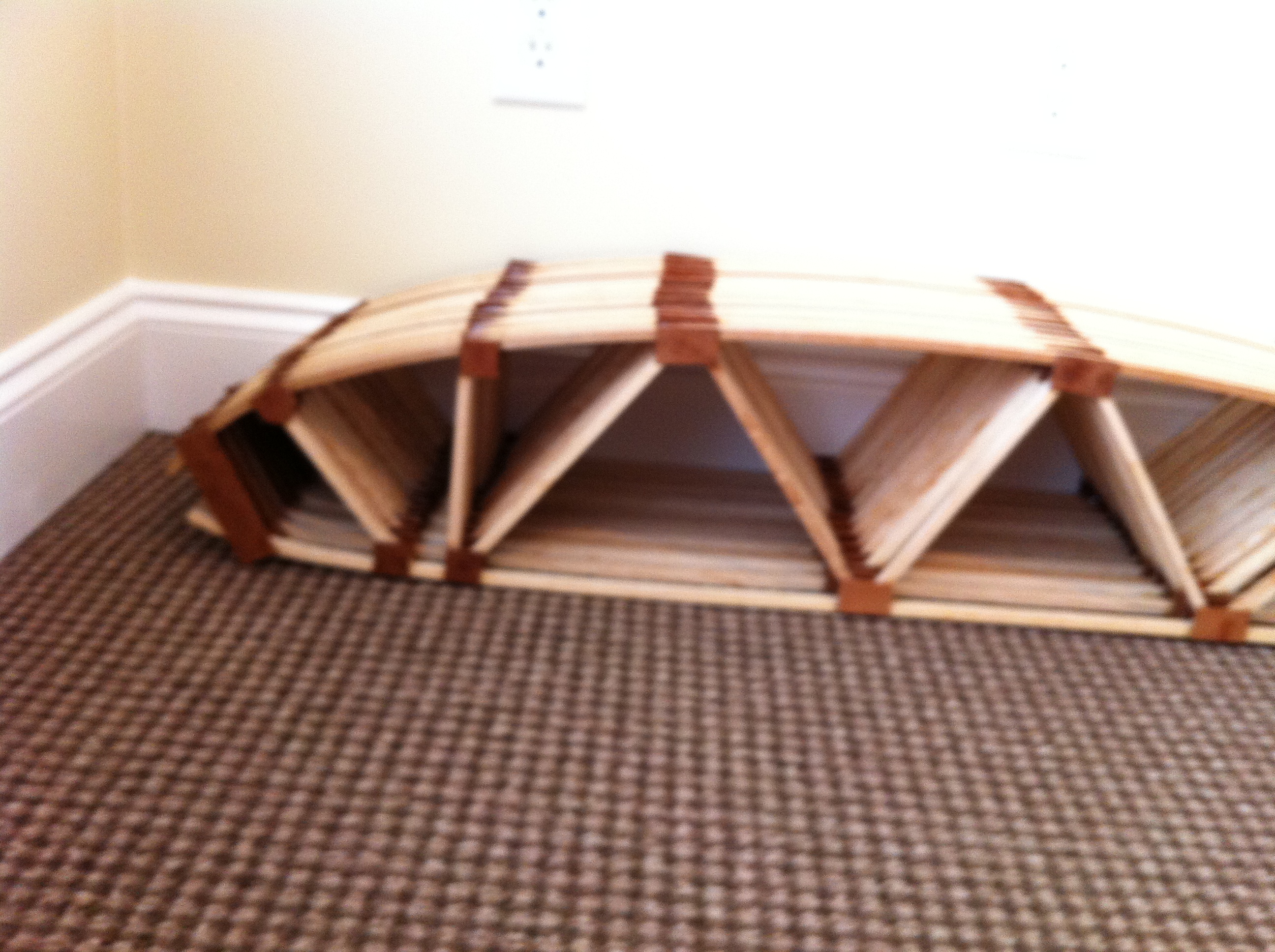

Terry, that one is worth sending in to the Newsletter to share with other builders. Your jig has all the elements of good builder practice, with a heavy sprinkling of cleverness and simplicity thrown in as well! The blocks for the spars are a nifty touch, so are the rib tails and other things about it. Covering the table with plastic is a step that is easy to miss but which results in dried squeeze-out glue lumps on your workbench. You've got all the essentials covered and other than your jig being for a flat-bottomed airfoil rather than for the undercambered Pietenpol foil, everything you've done transfers to pretty much any other stick-rib design. All you'd have to do is add a brief narrative about how you handled the gussets on Side B once you had Side A all gusseted and clamped. I'm assuming you just flipped the jig over and then worked your way around the jig removing or loosening one gusset clamp at a time to insert the gussets on Side B...

I will write it up and send it in to Pat. And yes, after the T88 had dried overnight, I would take my spatula from the dollar store (the kind you would use for flipping pancakes), slowly go around the edges til the rib "popped off" the jig. I would then flip the half-finished rib over, clean up the joint areas where T88 had dripped through, then go through the whole process again on that opposite side. Same gussets, same T88, same clamps. Lather, rinse, repeat.
It worked really well, and that is why I encourage people to build their own jig. When researching a way to build my jig, I saw some jigs that would make an engineer jealous - the quality of the design was outstanding, the workmanship awesome. And then there was my MDF and nail jig. Not pretty, but it worked.

I think I spent maybe $10 on my jig, probably the cheapest part of the whole project!
There is already a blueprint available, The full size rib print. You build the jig right over the print
