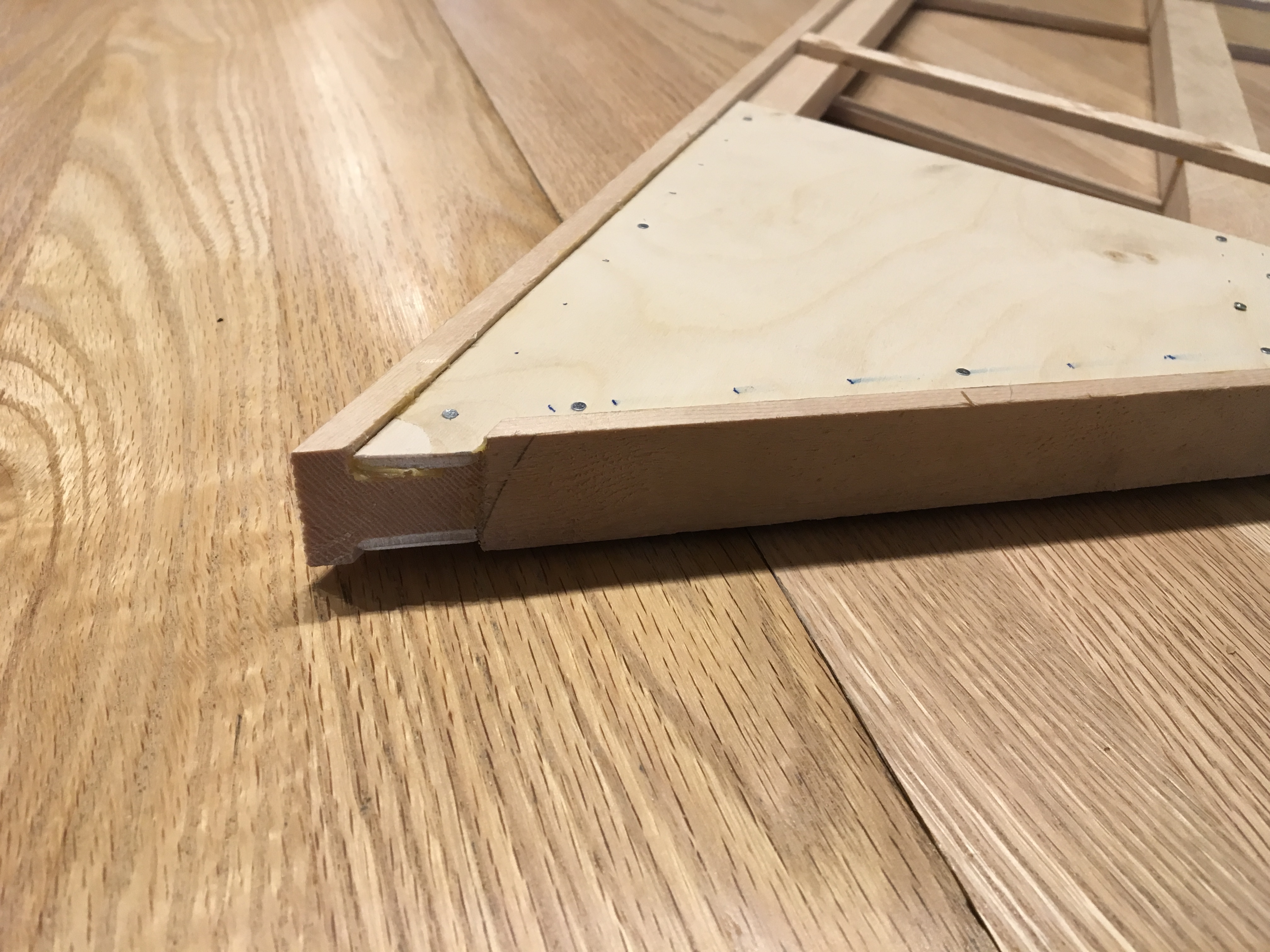

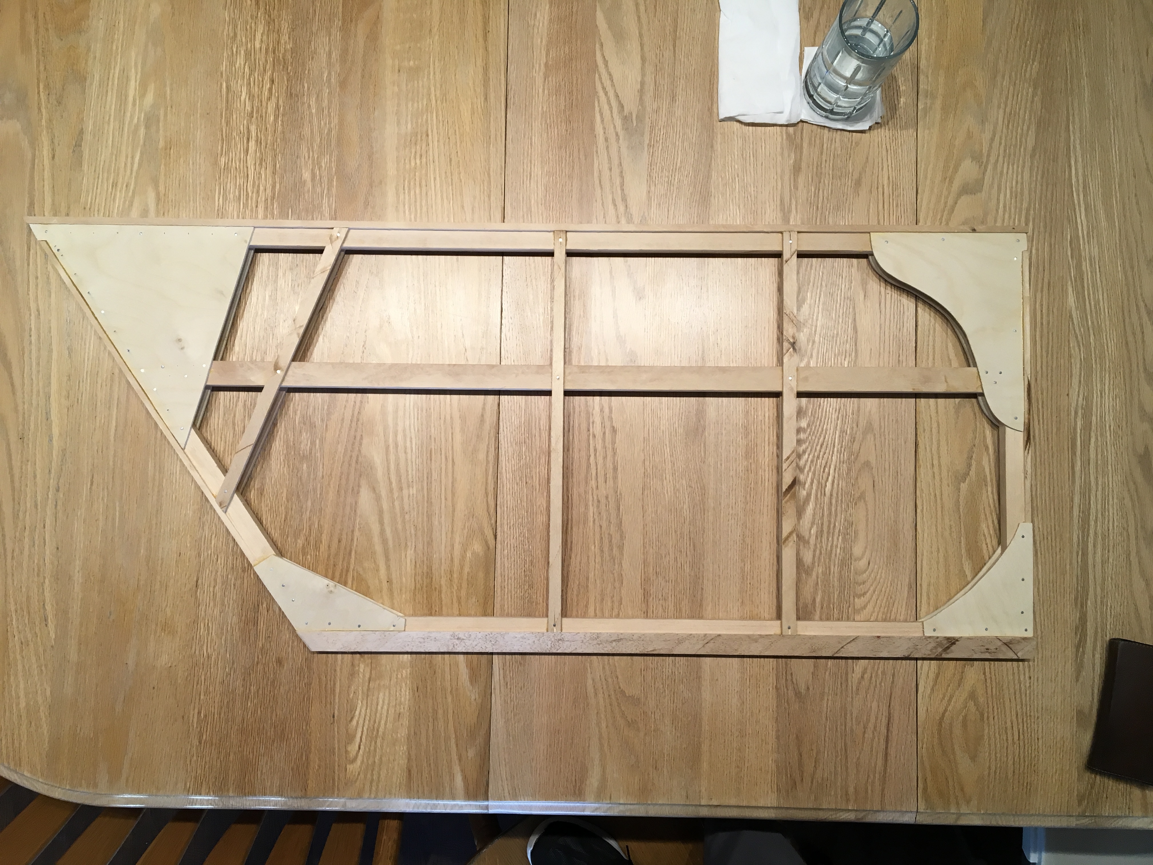

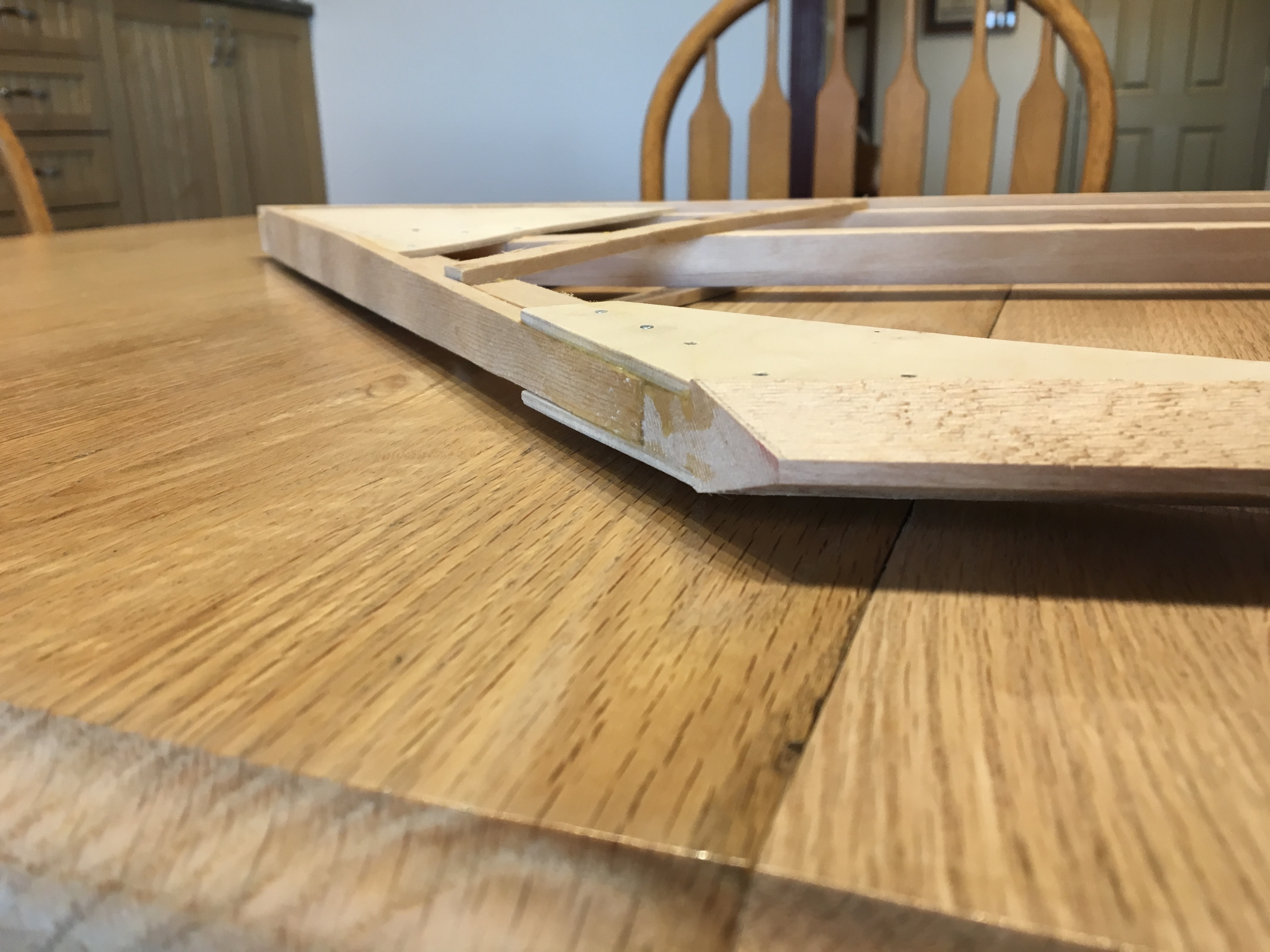

I just finished my test elevator and it turned out pretty good if i do say so myself, I now feel confident that i will be able to make two flyable elevators. I used hardware store nails regular birch plywood and Titebond original to put these together. I have three questions. Keep in mind I’m trying to be as frugal as possible but not unsafe, basically I’m not wanting to by “the best” just because its “the best”
1) I’m planing on getting a 1/2 pound of 20ga nails for nailing my gussets down. Is that enough? And are those going to be to long or to short?
2) What are your thoughts on plywood. Birch or mahogany? Do I need MIL-P-6070B plywood, is good quality wood store plywood good enough or will any old 3 ply do the job.
3) Titebond III, West System Epoxy Formula 209, or T-88? I’m aware that there might be some of you that say T-88 is the only way to go, I want to know your opinion on why WSE F209 or Titebond is inferior (I’m not here to argue but educate myself, so please add/link technical data/experience if you have any)
Thanks in advance,
Joshua
