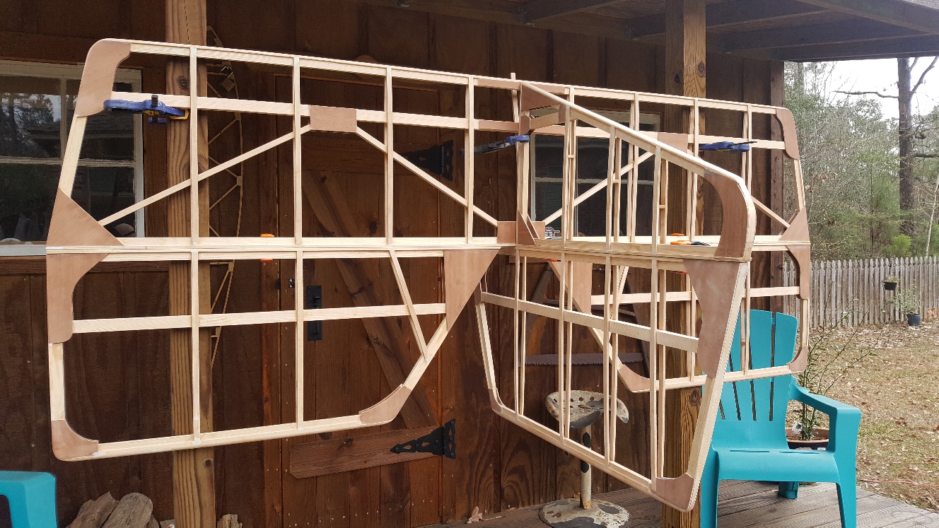

I concur, I started about two years ago and have finished the ribs, all tail surfaces and am working on the center section of a three piece wing. I have two corvairs I've pulled apart for a motor. All of this done on a small workbench in a small shed (see Pic). Ribs first is a great way to test your patience and dedication to the build. Feel free to contact me if you have any questions.
Woody
