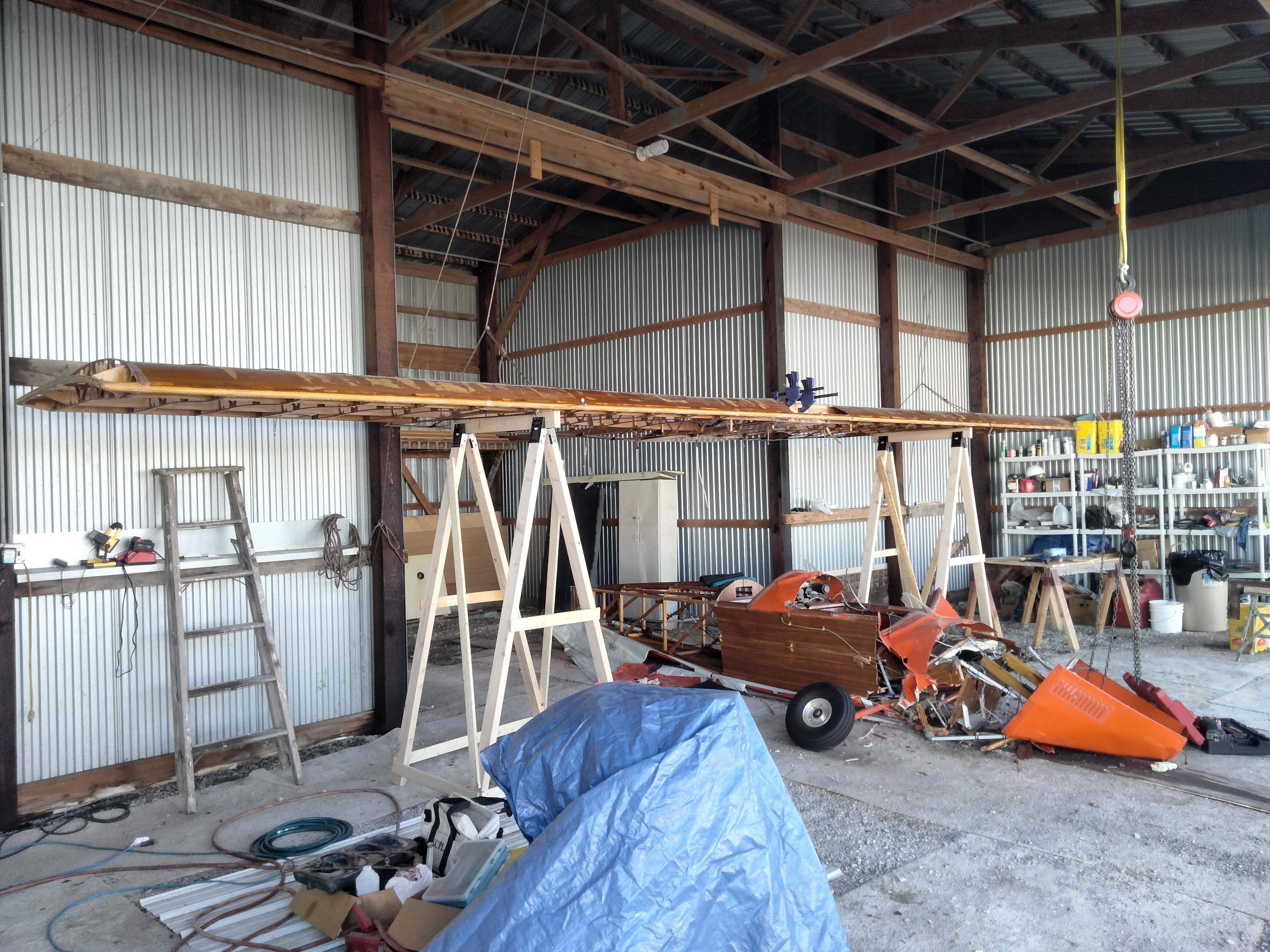

Yes. getting a rolling fuselage makes lots of sense. I plan on hoisting the wing up to the hanger rafters, get a table built and leveled and get started cutting wood.

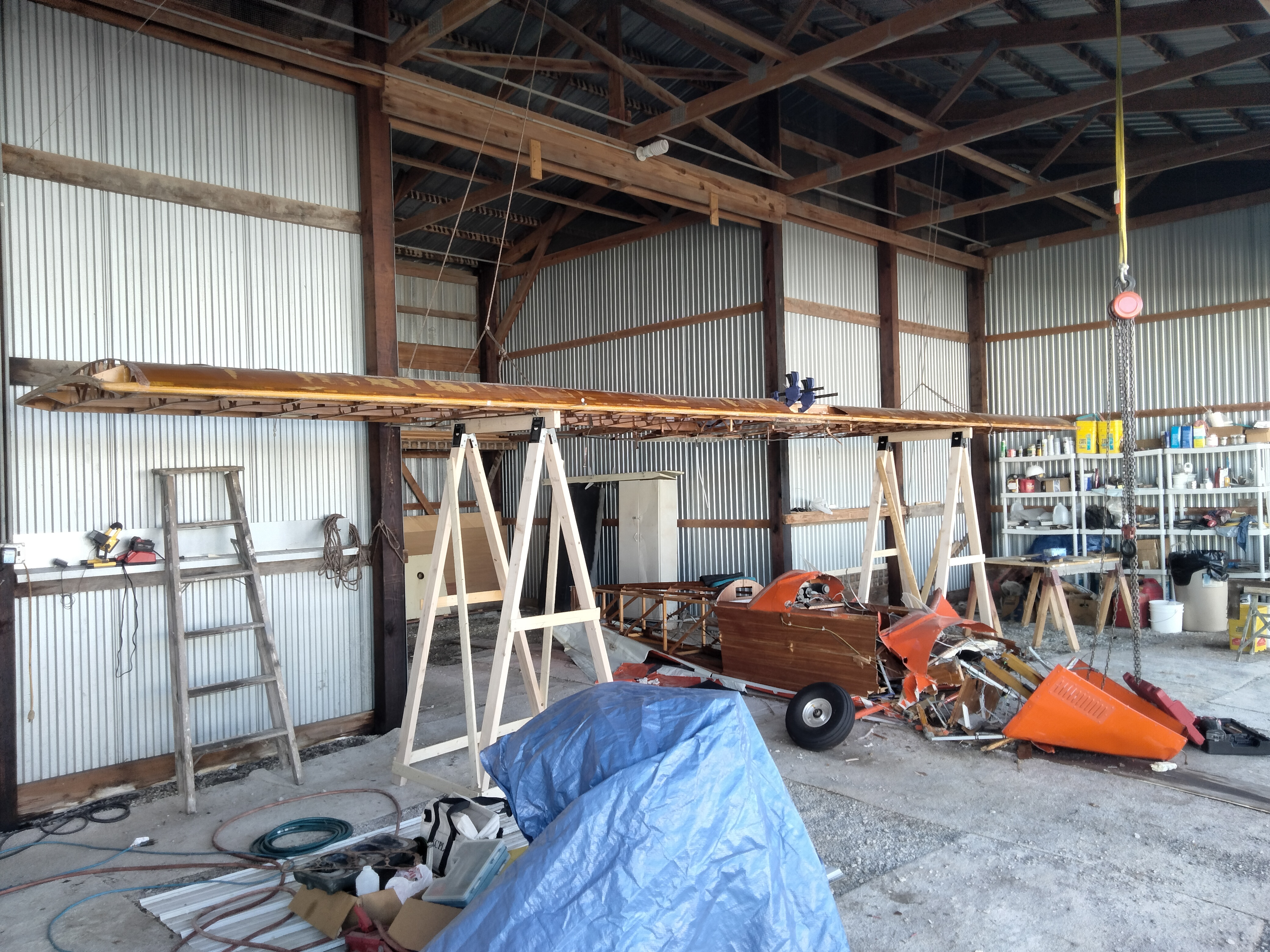

I built some stands to support the wing on. It's high enough to walk under, but I can get to it for measurements. I put the wing on the stands today. Doing it all by myself turned out to a bit of a hassle!

Okay! Great progress since taking the wing out of the picture gets about half the workspace freed up but as you said, still leaves the wing where you can measure and examine.

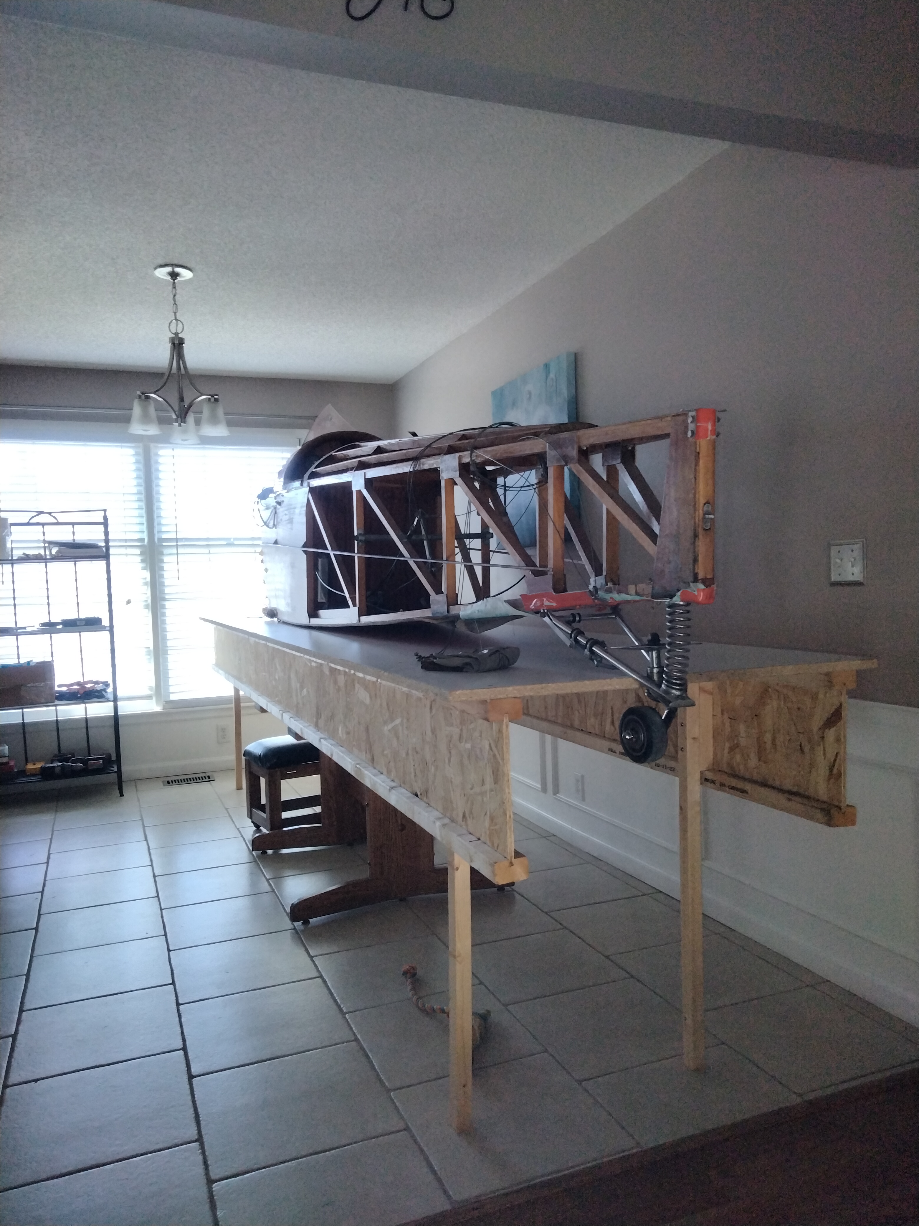

I've had a pair of work tables from a local Piet owner donated to me to set the fuselage on.

Richard; perfect! Getting the fuselage up onto a bench or table at waist height will provide just about the best working condition until you need to start fitting the landing gear and the plane needs to be just a bit higher (top longerons at about chest height). My Piet was on a table and sawhorse for about a year as I reworked this and that, while my welder worked on fabricating or repairing metal parts. When it got to the landing gear, the fuselage had to be elevated to get the geometry correct. and with it up a little higher, I then moved to the fuel tank and firewall to work on stuff up there.
The reward? The plane will fly again ;)

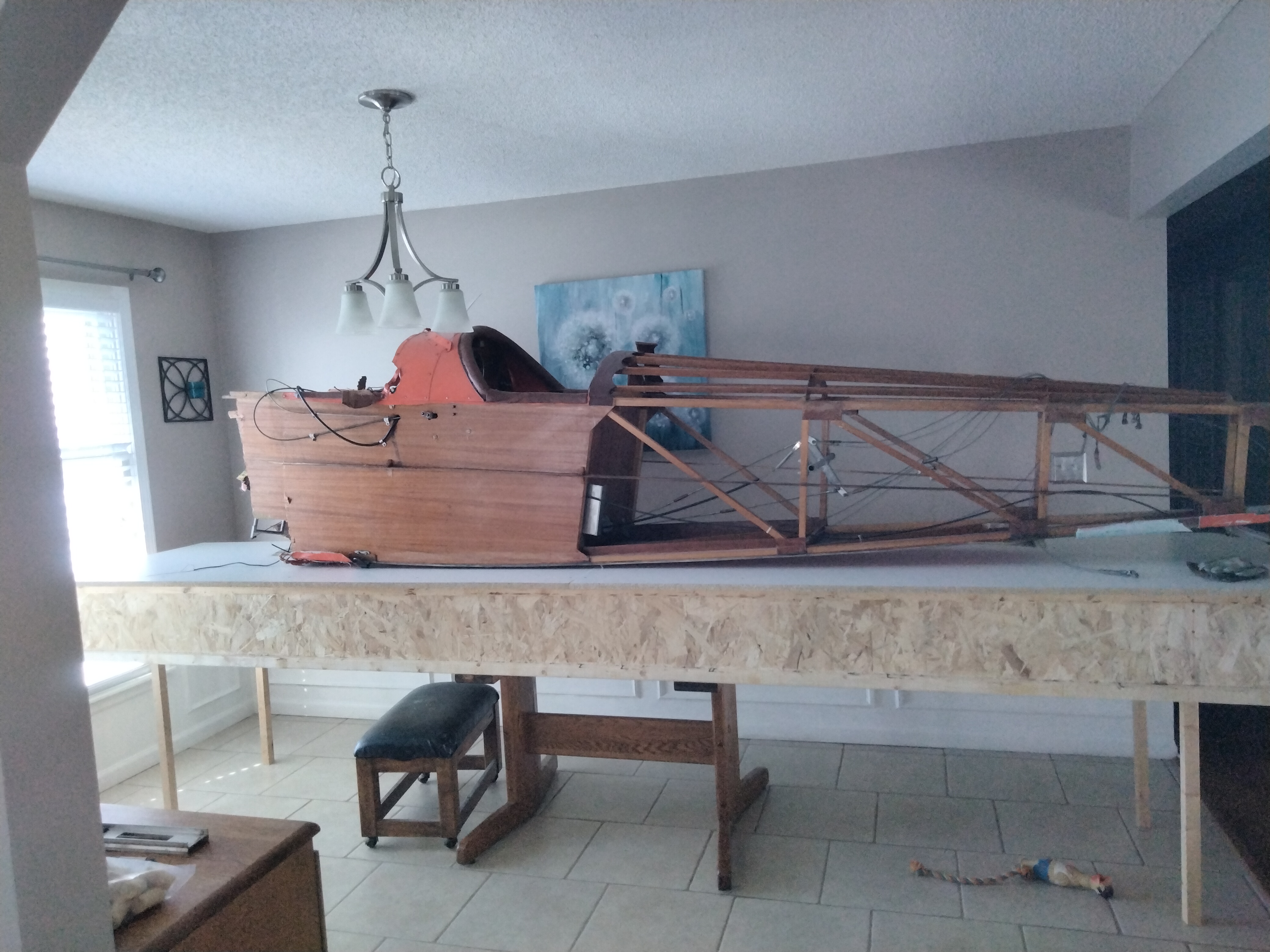

I've decided to move the dining room table, build a work table in the dining room and do the repairs there. Great lighting and a easily cleaned ceramic tile floor (for spilled epoxy!). Nice and warm too. It'll help having my tools in one place also.
When the fuselage is done I'll cut the center section out of the wing and do the repairs at home also, build a new center section here too.
Lisa would roll her eyes, but she would understand.

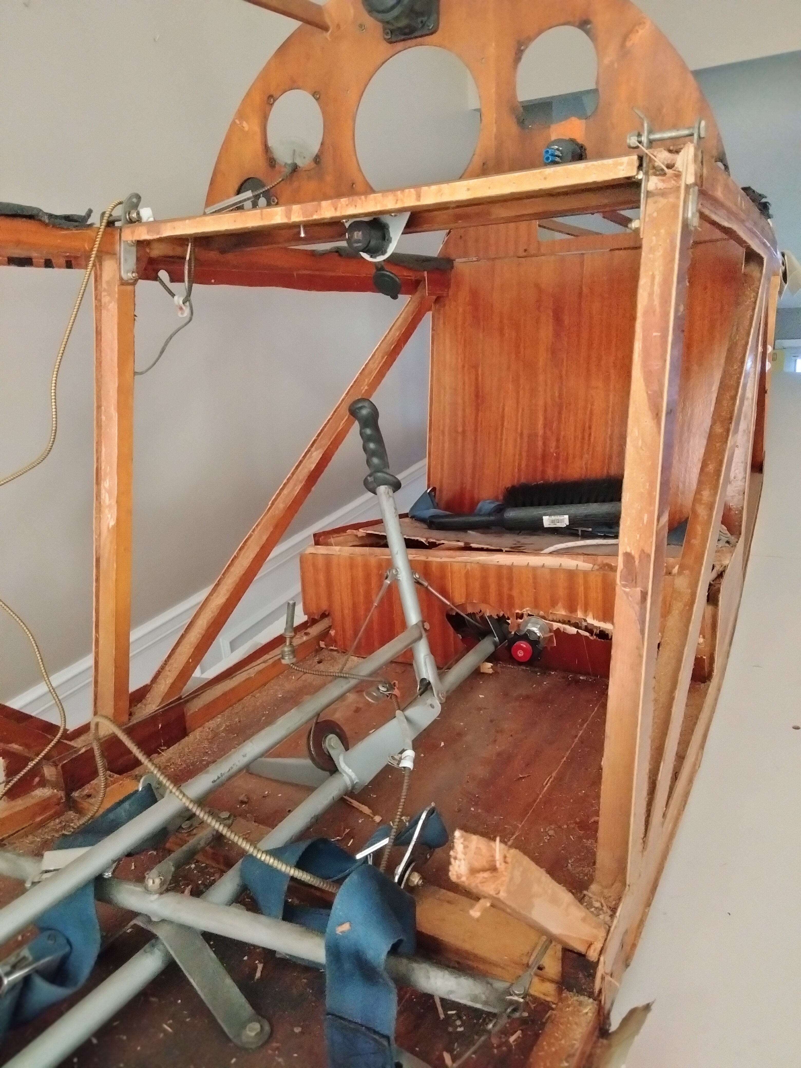

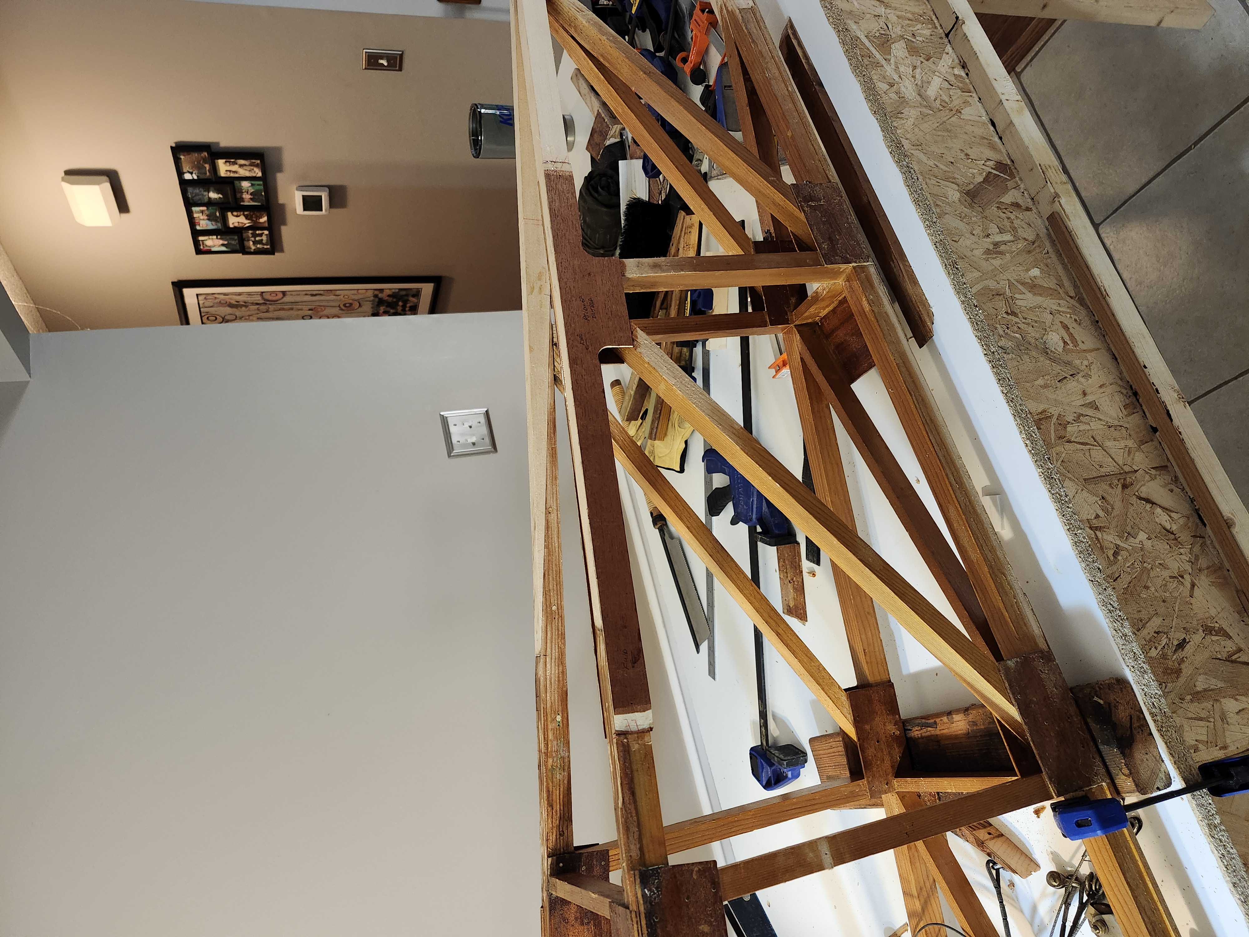

I've cut the plywood between the trusses off. I found some more damage, here and there. The next step will be to peel the remaining plywood off the truss itself, then the floor plywood. Probably not necessary, but I'm considering 45° plywood when I go back together. Something to consider.

How do you plan to get the plywood off? That looks like a tough job to me..
Posts: 254
Re: N34KP's rebuild
I'll remove the plywood with a heat gun and a thin piece of stainless steel sheet. I did it for years while working on 767's.

Richard Roller wrote: Sun Mar 03, 2024 9:30 pm I'll remove the plywood with a heat gun and a thin piece of stainless steel sheet. I did it for years while working on 767's.
Removed a lot of the plywood from the truss today. I also removed the rest of the controls that would be in my way.
Does that work with T88?

We used thin stainless steel (.015 +-) to cut through the adhesive under exiting patches, etc. We also used it when cutting pieces out of the skins over underlying structure. Slide it between the layers and cut very carefully through the skin until you saw sparks start to come out, then stop.

Yes, you can soften T88 with a heat gun.

I pulled the ply off both sides of the truss in the repair area today. The Spotted Cow was a reward! 😁
