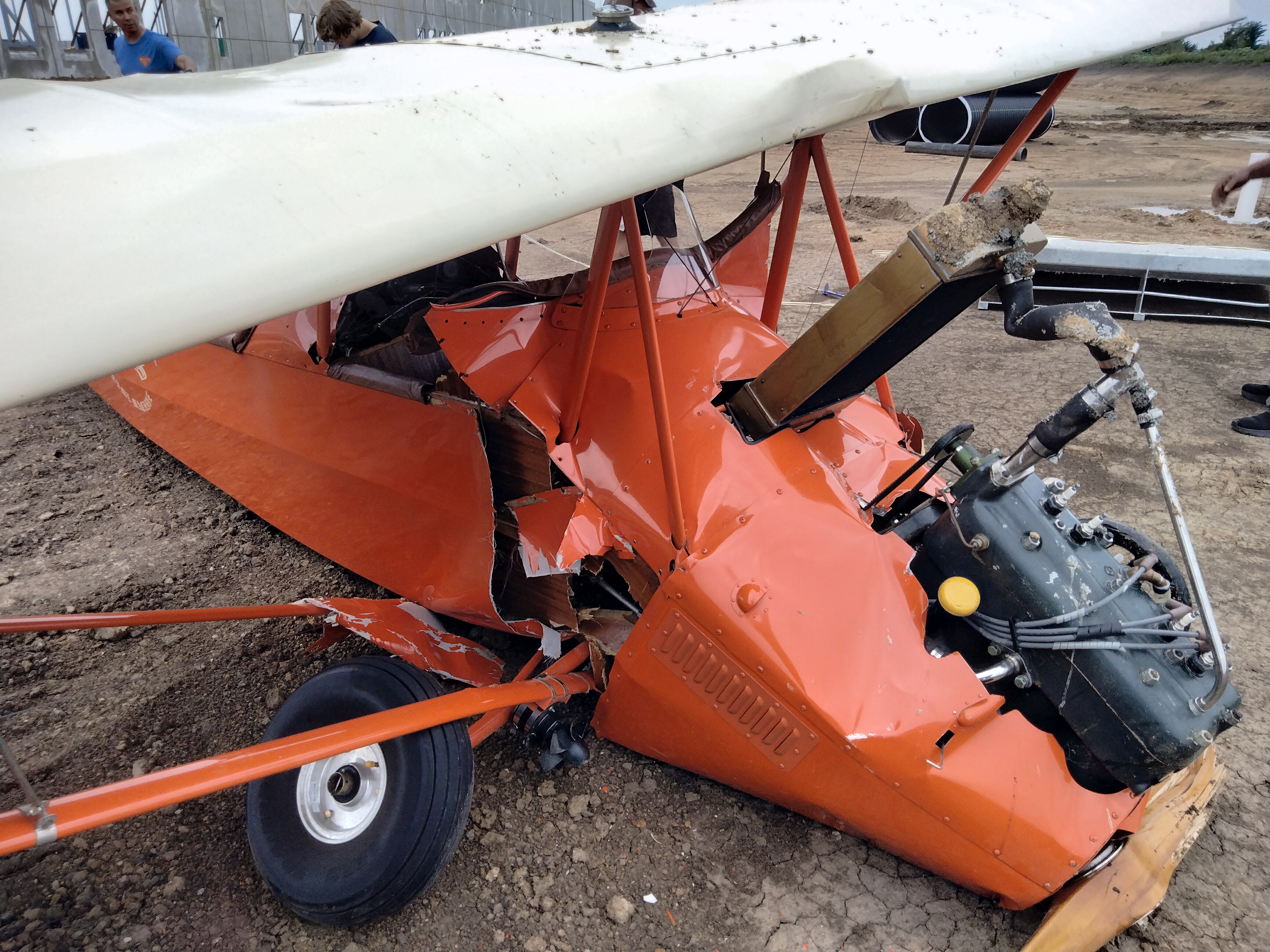

Okay everyone. N34KP is going to be rebuilt. I'll be posting interesting things as they happen. It would probably make more sense to build a new one, but I couldn't stand the thought of Ken Perkins Pietenpol not flying.
The fuselage will be pretty much new from the pilots instrument panel forward. The wing needs a new rear spar. The front spar and leading edge are damaged in the center section, so the wing will become a three piece wing. Lots of bent and broken things.

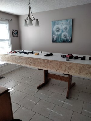

I've decided to move the dining room table, build a work table in the dining room and do the repairs there. Great lighting and a easily cleaned ceramic tile floor (for spilled epoxy!). Nice and warm too. It'll help having my tools in one place also.
When the fuselage is done I'll cut the center section out of the wing and do the repairs at home also, build a new center section here too.

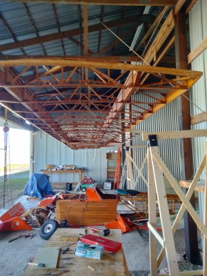

I see you've got the patient under sedation on the operating table now, Richard. The cuts will be painful to make, but the broken bones and dead skin have to be cut away before new stuff can be grafted in. My Piet's damage wasn't as extensive as yours, but it was every bit as painful for me to cut, pry, chisel, scarf, sand, and glue until the frame was back to its original strength and ready to rebuild. I tried to plan my cuts so as to remove all of the crushed or splintered wood and leave clean strong gluing surfaces with room to work clamps in, but some of it was tight work. Worse yet, there were times when I'd be working on something and -dang!- I'd spot a broken glue joint or a hidden bit of crushed wood that I hadn't seen before, or I'd see something that I wanted to remake a different way and I'd have to get out the pull saw again. There will be a time when you turn the corner though. I guess we should form a Recovering Air Campers support group or something... me, you, Helsper, Purtee, Markle, Bickers, others. Carry on.
Posts: 260
Re: N34KP's rebuild

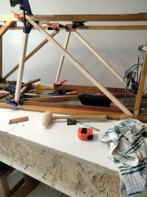

I've cut the plywood between the trusses off. I found some more damage, here and there. The next step will be to peel the remaining plywood off the truss itself, then the floor plywood. Probably not necessary, but I'm considering 45° plywood when I go back together. Something to consider.

I'll remove the plywood with a heat gun and a thin piece of stainless steel sheet. I did it for years while working on 767's.
Removed a lot of the plywood from the truss today. I also removed the rest of the controls that would be in my way.

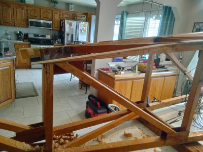

I pulled the ply off both sides of the truss in the repair area today. The Spotted Cow was a reward! 😁

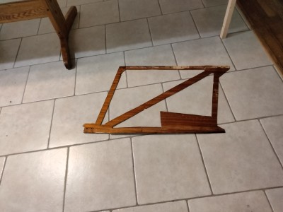

I cut the left and right station piece and the rear diagonals for moving the seat back today. Lots of measuring before the cuts. They turned out good!

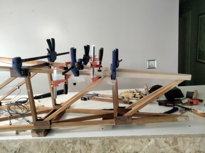

Well. My first glue up. This is the test. I could tell it's been a long time since I did composite repairs for a living, I mixed way to much! I had about 4 times more left over than I used on the joints. Oh well, I'll get back in practice. Nice joints with just enough squeeze out. I'm done till I get a chance to check the joints, tomorrow afternoon.
Posts: 260
Re: N34KP's rebuild
Both in now.

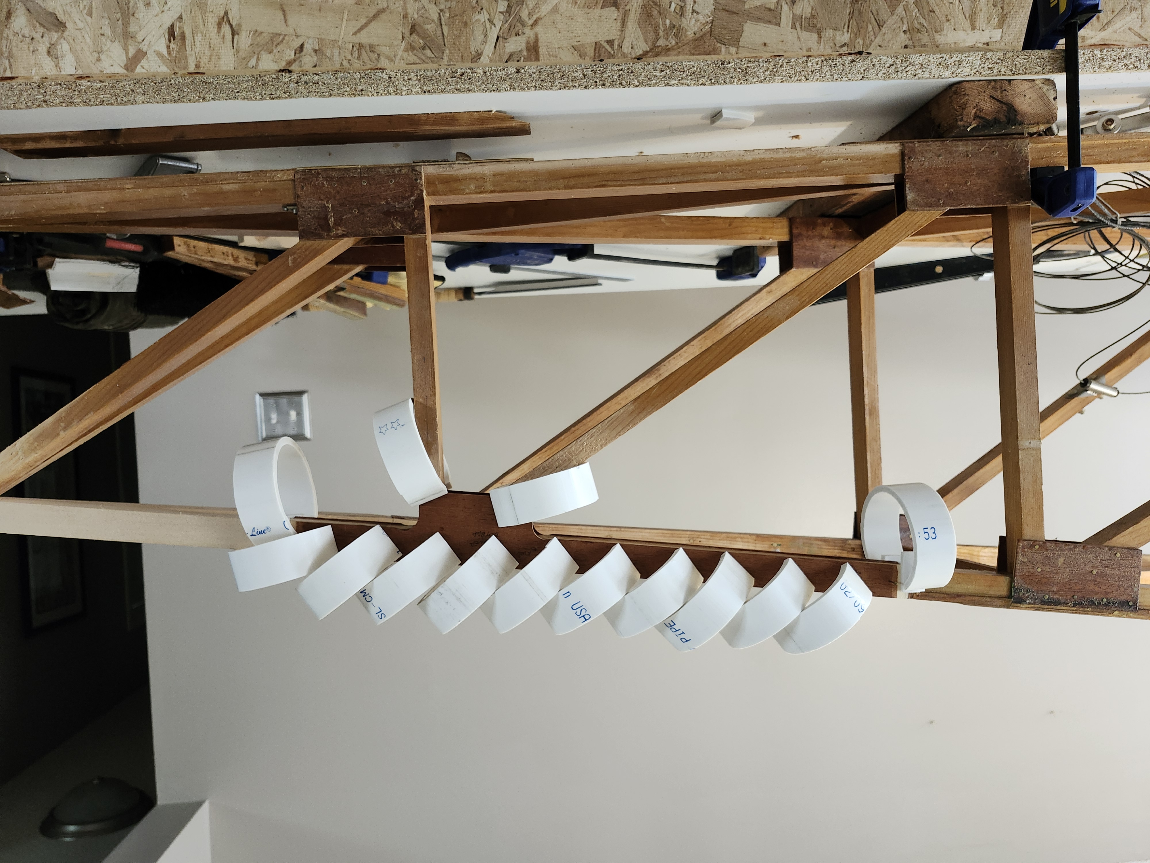

Glued the right lower longeron doublers today, inside and out. Heading south to see my mom and sisters in the morning. First time I'll have seen them since my wife Lisa died.
Posts: 260
Re: N34KP's rebuild
The glue up turned out good. The edges will need to be planed to fit.
