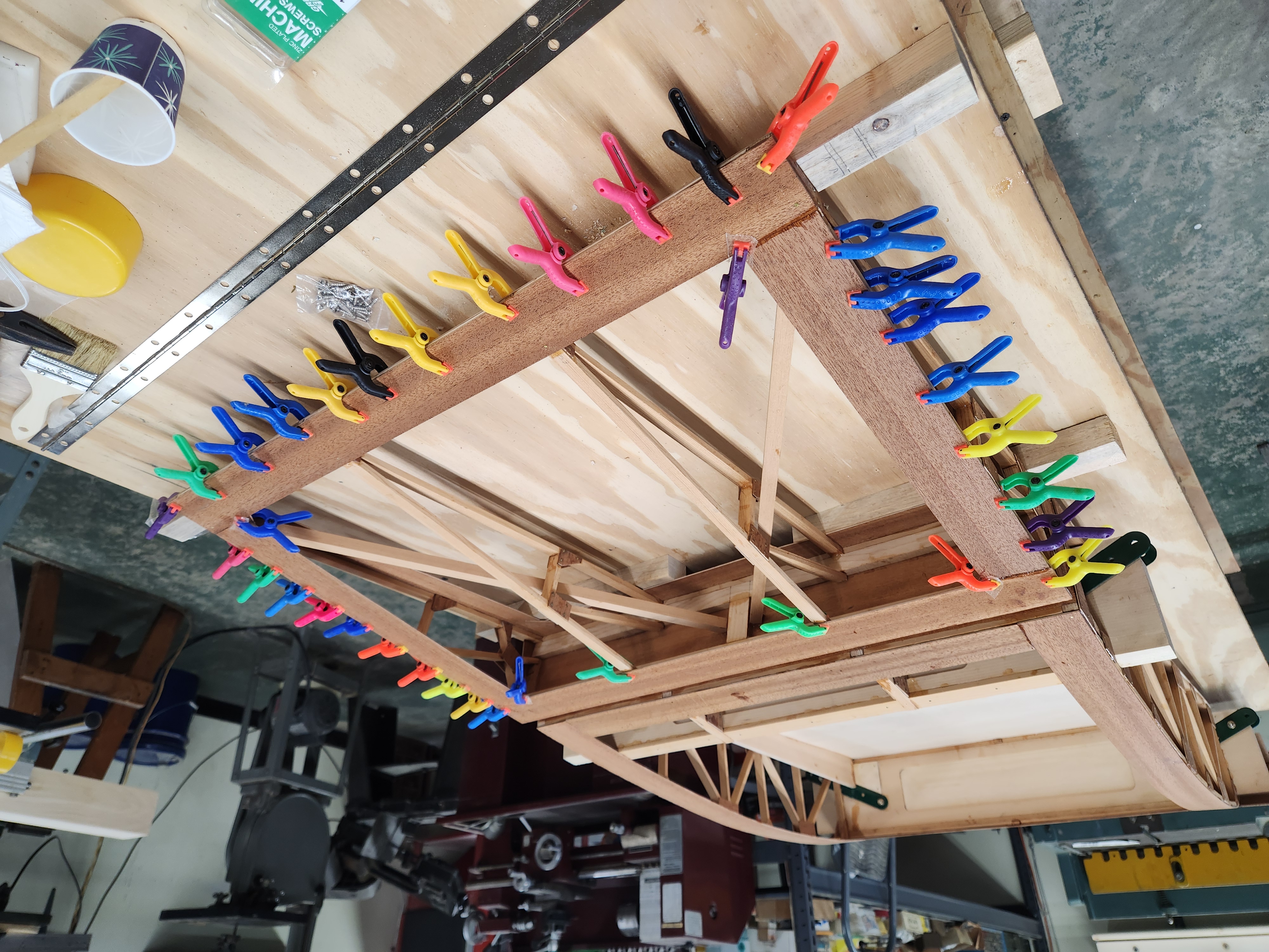

A little progress.
I keep seeing flops made from the plans mentioned. There certainly aren't any in the drawings I have.. I'd like to make it like the drawing, no need reinventing the wheel if it's not necessary.

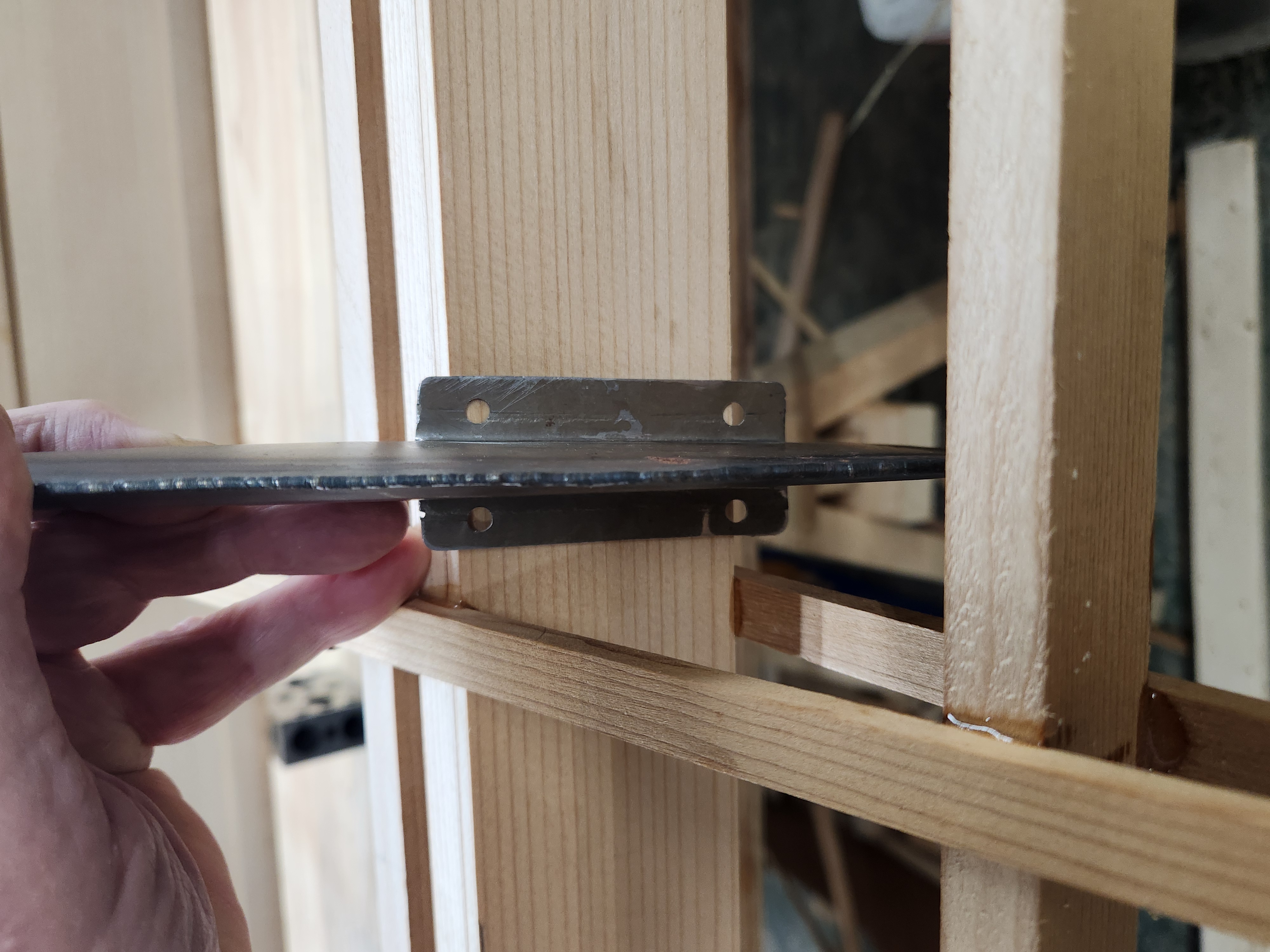

Here's where that lower fitting and bolt interfere that I was talking about a while back.
Finished adding 2.4 lbs. of lightness to each spar today..
I wish the west coast site was up so I could look at what others did. Move the hole, or just cut up the rib?Finished adding 2.4 lbs. of lightness to each spar today..
Re: Intro
Chuck, now I see the conflict to which you were referring several weeks ago. Yes, I had the same thing. I left the holes where the plans showed them and cut a notch in the rib gussets (and if I recall part of one of the interstice braces). It all fit together fine in the end. Though my recollection is that it was a pain to insert the bolt in the hole and get a wrench on the other end. Cheers, Ken

Thanks for the answer, Ken. That seals the deal for me. I'll do the same way as I did the center section.. varnish the fitting area, install the fittings for the last time, and do whatever it takes to get the rib on. Beef it up as necessary, or "Hammer to fit in field, paint to match."
Re: Intro
Chuck, I went back through my pictures. I found this one. If you look closely, you can't really see it in the pict, but the vertical interstice braces are half thickness where they pass over the wing attach brackets. Be sure to radius the notch, so that the brace doesn't want to split where the cut out is located. Also, I had to notch the fore-aft compression pieces. There are similar notches cut on all four corners. Cheers, Ken
