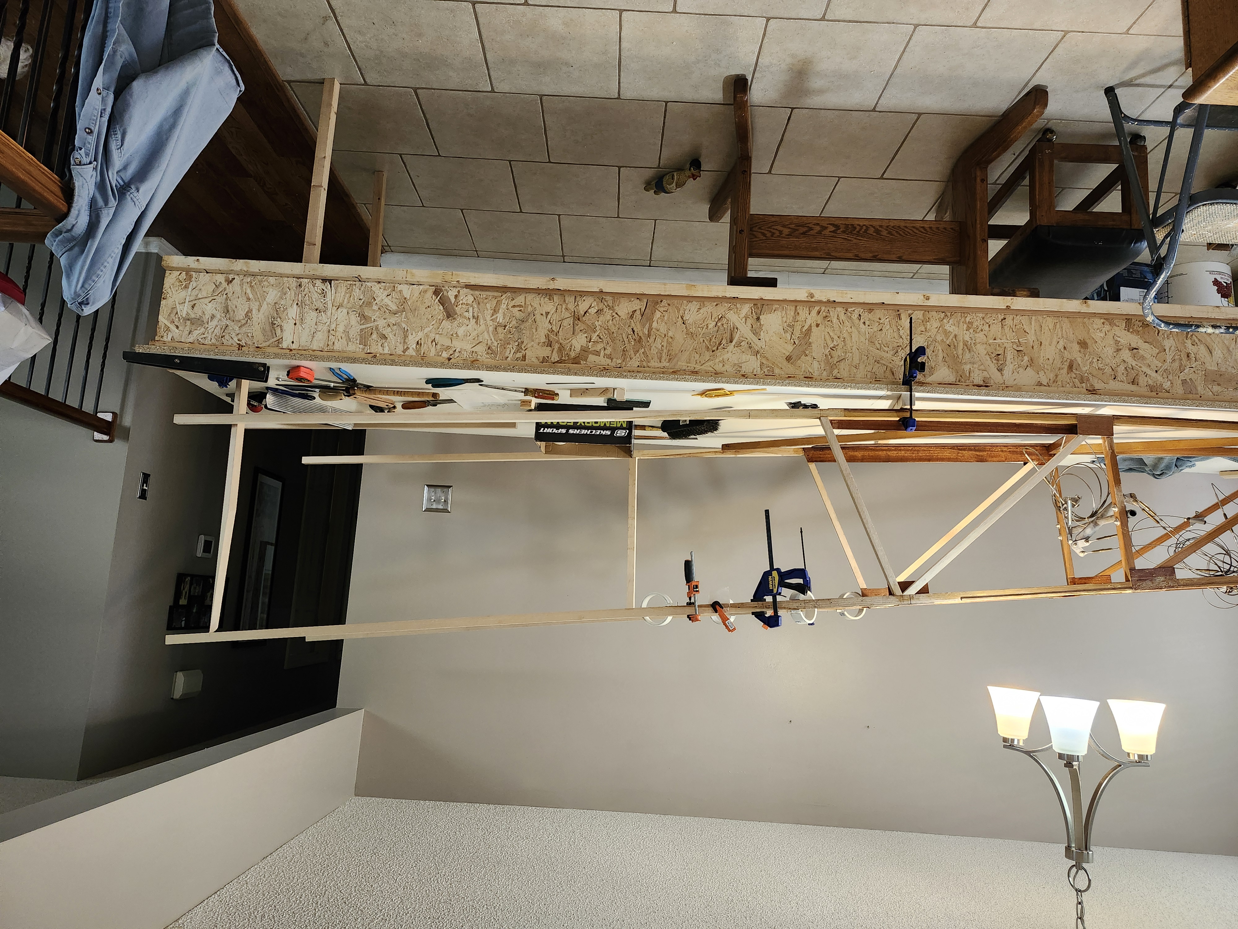

Back from visiting my sisters and mother. I planed the doublers on the lower right longeron this morning. Time to glue up the lower left.
- Posts: 259
Re: N34KP's rebuild
Glued up the lower left longeron doublers today.

The rear splices are complete. Station piece and pulling them together at the tail post next.

Station piece, diagonal and doublers. Late night glue up.
- Posts: 259
Re: N34KP's rebuild
I glued in the old tailpost last night. Gussets next.

Re: N34KP's rebuild
The tail reconstruction is finished except for fairing strips and holes for the fittings.

The holes for the forward tailwheel brackets are drilled.
- Posts: 259
Re: N34KP's rebuild
Since I moved the upper seat back aft 3-1/2" I was able to reuse the diagonal brace behind the seat back by re-cutting to the new angles. I still need to install the forward gusset.
