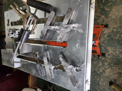

While waiting for the wood to come down from Wisconsin, I drew wing fittings on CAD, filled up a 12"X24" sheet, and took the file to a laser/water jet shop. Here are the fittings plus some other stuff that I had made uhh, (gasp) 20 years ago. :shock:
Hey! I'm as much an antiquer as anyone else, and if Bernard had this stuff available, he'd have used it. Cutting out all this 4130 with a hacksaw and file?

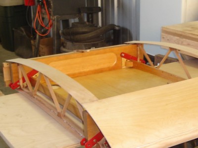

A little progress.
I keep seeing flops made from the plans mentioned. There certainly aren't any in the drawings I have.. I'd like to make it like the drawing, no need reinventing the wheel if it's not necessary.

Looks terrific. I love those routed surfaces!

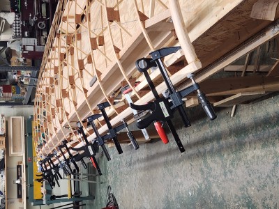

Couldn't put it off any longer and started gluing.. :?
Posts: 130
Re: Intro
Chuck,
That's a great looking shop. I especially like your worktable ... a smart way to keep assemblies square and true.
Is that an old library card catalog against the wall? I'd love one of those to hold the bits and pieces that are in too many little boxes in my hangar. I may have to do some sleuthing in our local flea market store.
Gluing is good. It means you're making progress!

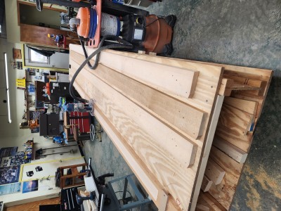

Waiting for the T88 to set up
Turned over the flop and added the 1/16" ply.
Time to start on the wings, I think.. :D

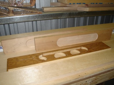

Adding some lightness..

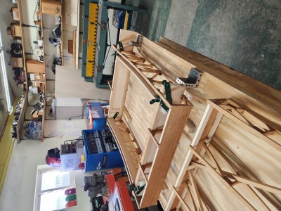

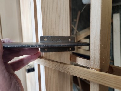

Here's where that lower fitting and bolt interfere that I was talking about a while back.
I wish the west coast site was up so I could look at what others did. Move the hole, or just cut up the rib?
Finished adding 2.4 lbs. of lightness to each spar today..
Posts: 130
Re: Intro
Chuck, now I see the conflict to which you were referring several weeks ago. Yes, I had the same thing. I left the holes where the plans showed them and cut a notch in the rib gussets (and if I recall part of one of the interstice braces). It all fit together fine in the end. Though my recollection is that it was a pain to insert the bolt in the hole and get a wrench on the other end. Cheers, Ken

Thanks for the answer, Ken. That seals the deal for me. I'll do the same way as I did the center section.. varnish the fitting area, install the fittings for the last time, and do whatever it takes to get the rib on. Beef it up as necessary, or "Hammer to fit in field, paint to match." :D
Posts: 130
Re: Intro
Chuck, I went back through my pictures. I found this one. If you look closely, you can't really see it in the pict, but the vertical interstice braces are half thickness where they pass over the wing attach brackets. Be sure to radius the notch, so that the brace doesn't want to split where the cut out is located. Also, I had to notch the fore-aft compression pieces. There are similar notches cut on all four corners. Cheers, Ken

Yeah, the center section is pretty easy because the rib is more inboard than on the wings and you just have to clear the fittings. I've done essentially the same on the CS.
