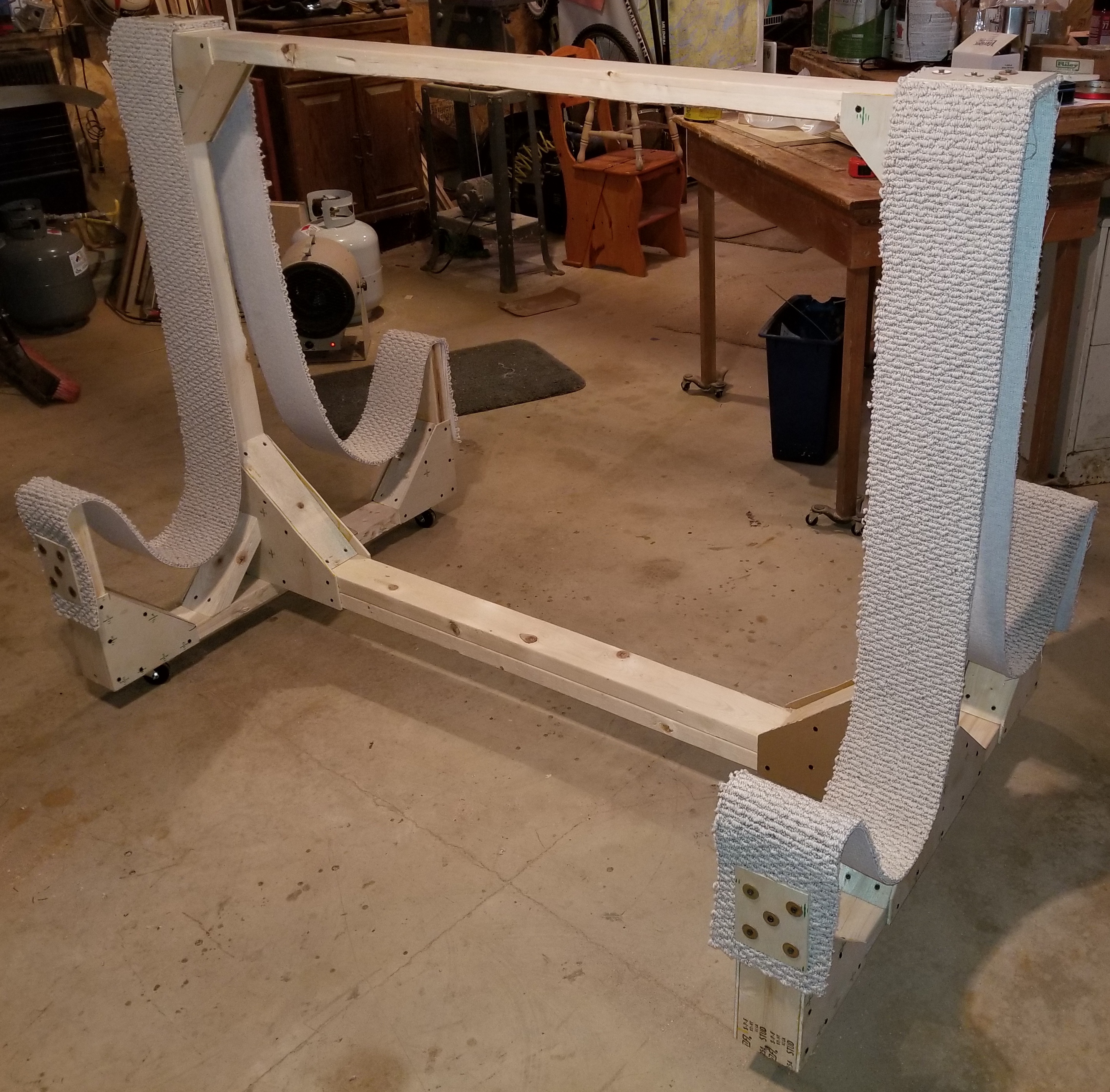

I made this wing stand this weekend following the plan from EAA.
https://www.eaa.org/en/eaa/aviation-com ... wing-stand
After Christmas I will be using it to transport a Pietenpol from Louisiana to Wisconsin.
More details to follow.

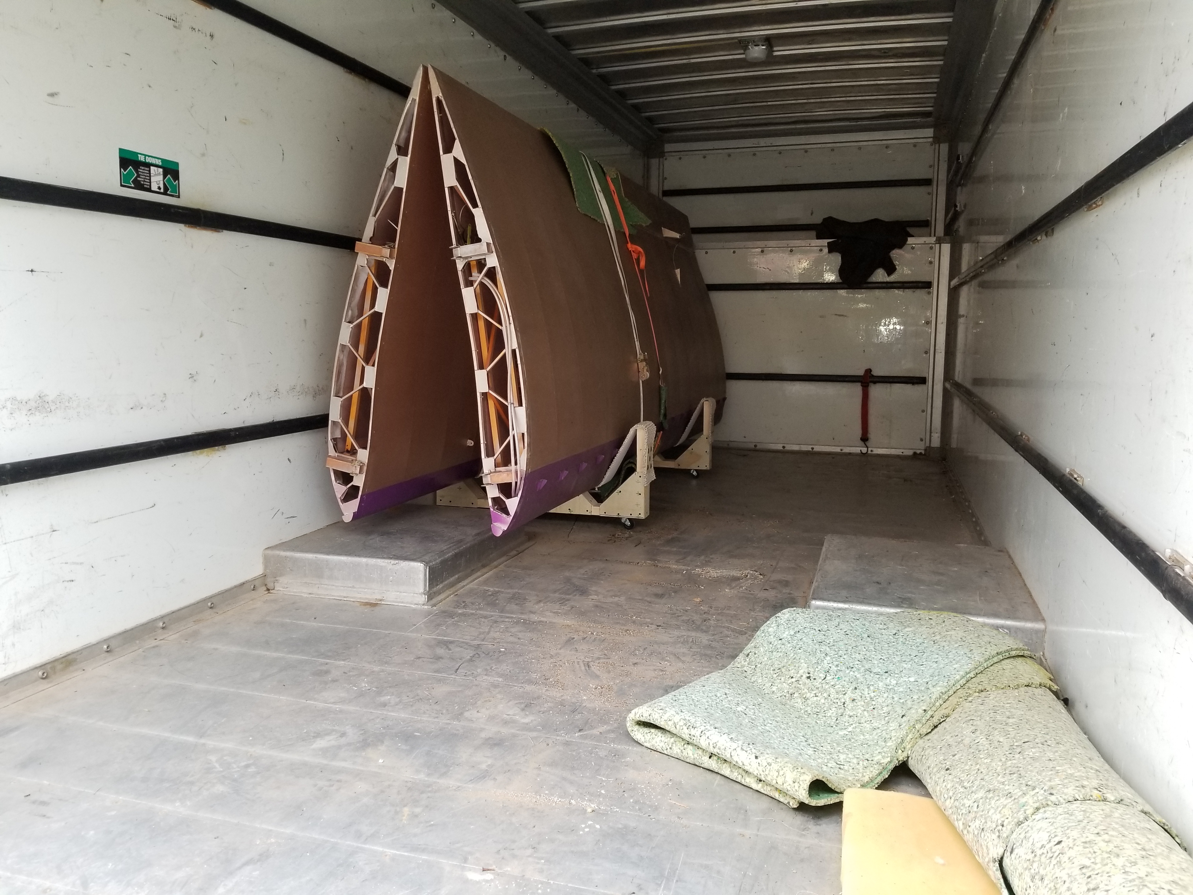

This fine fella in Louisiana donated a Pietenpol that he built to BPA. A couple of buddies and I drove a U-Haul from Wisconsin to Louisiana and loaded the plane up and hauled it back.
Look for details in a newsletter. Come to Brodhead this summer and see the plane on display.

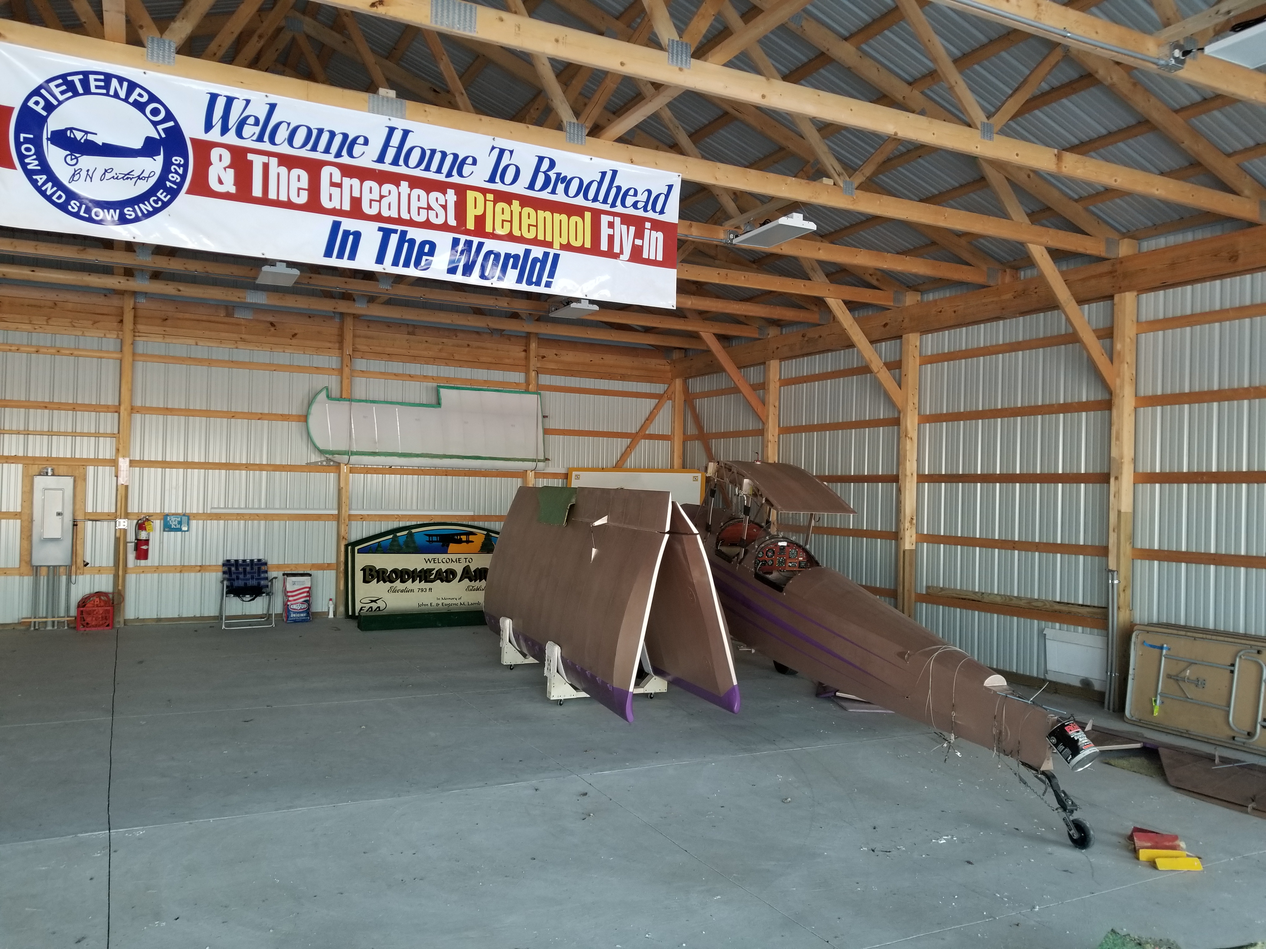

Here is the plane called Snoopy in its new home.
