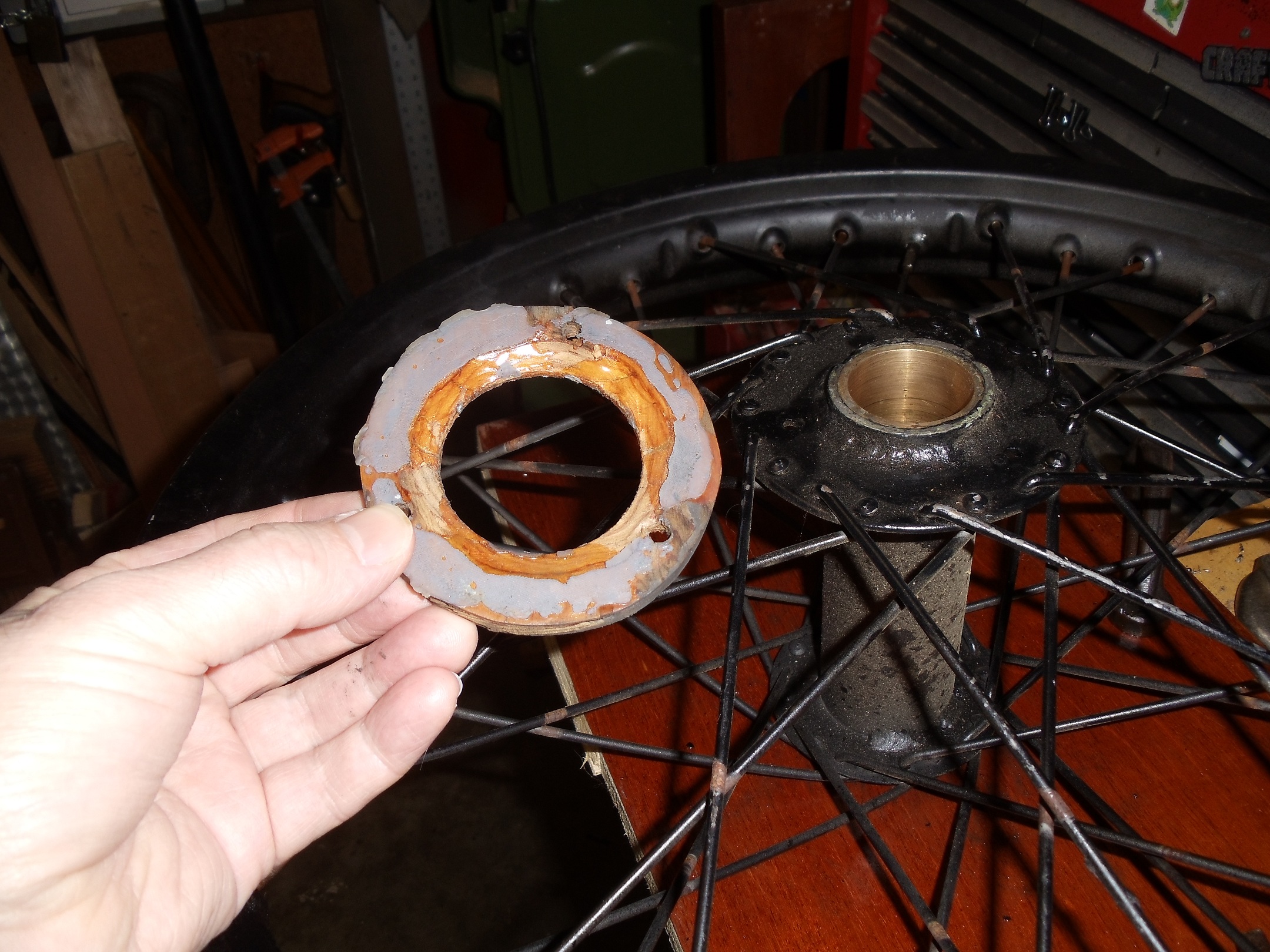

RE: Pietenpol-List: Spoked Wheels
Post by matronics »
Original Posted By: raykrause(at)frontiernet.net
on the faces of my hubs I cut a 1/4 or 3/8 thick plywood donut and glued that to the hub. That kept the fabric off the spoke heads and gave a smoth appearance plus it served as a spacer for the brake drum. I know that I have a couple more photos somewhere and I will try to post later today. Craig
matronics

matronics
Posts: 81779
Post by matronics »
Original Posted By: Craig Aho
I went out in the garage and took a couple of photos, the wood disc is 5/16" thickand one inside edge is beveled to lay flat and over the welds. Also the disclays inside the spoke heads. Worked great on my original wheels which I amdismantling with some struggle since the nipples have been on tight for at least19yrs. soaking them with penetrating fluid.CraigRead this topic online here:http://forums.matronics.com/viewtopic.p ... ttachments: http://forums.matronics.com//files/dsc0 ... __________
matronics
