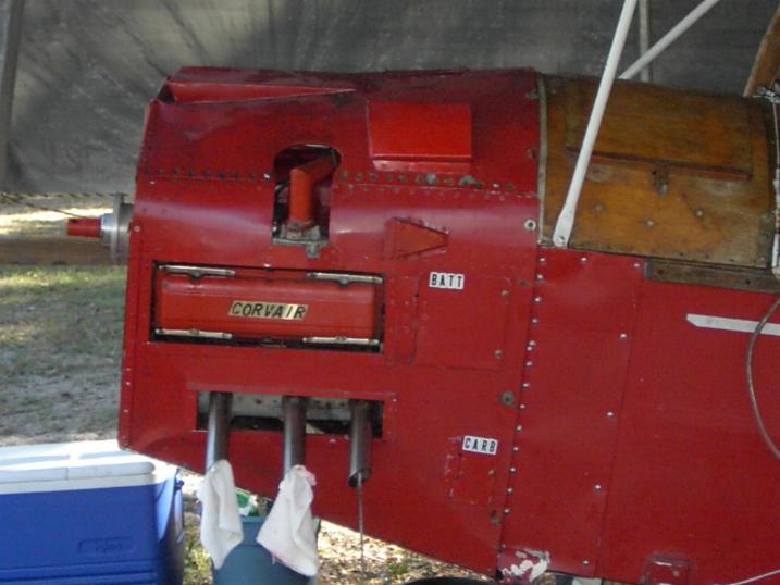

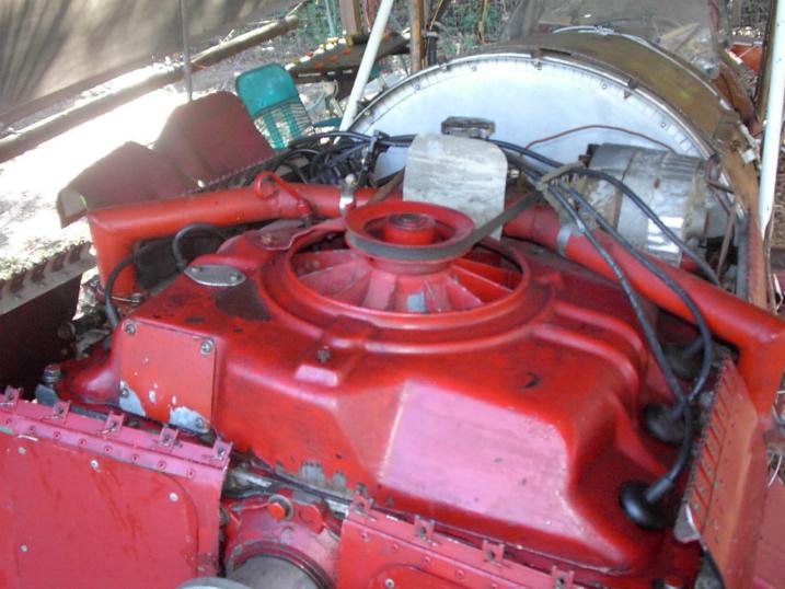

Well, here are the pix of the belt/blower Corvair that I have, but it's not possible to determine whether it had a starter or not. What seems obvious is that the standard conversion parts that William designed will not work with this setup because something has to either bolt to the top cover or to the heads and neither of those is accessible with the old blower in place. You may be on your own here.
