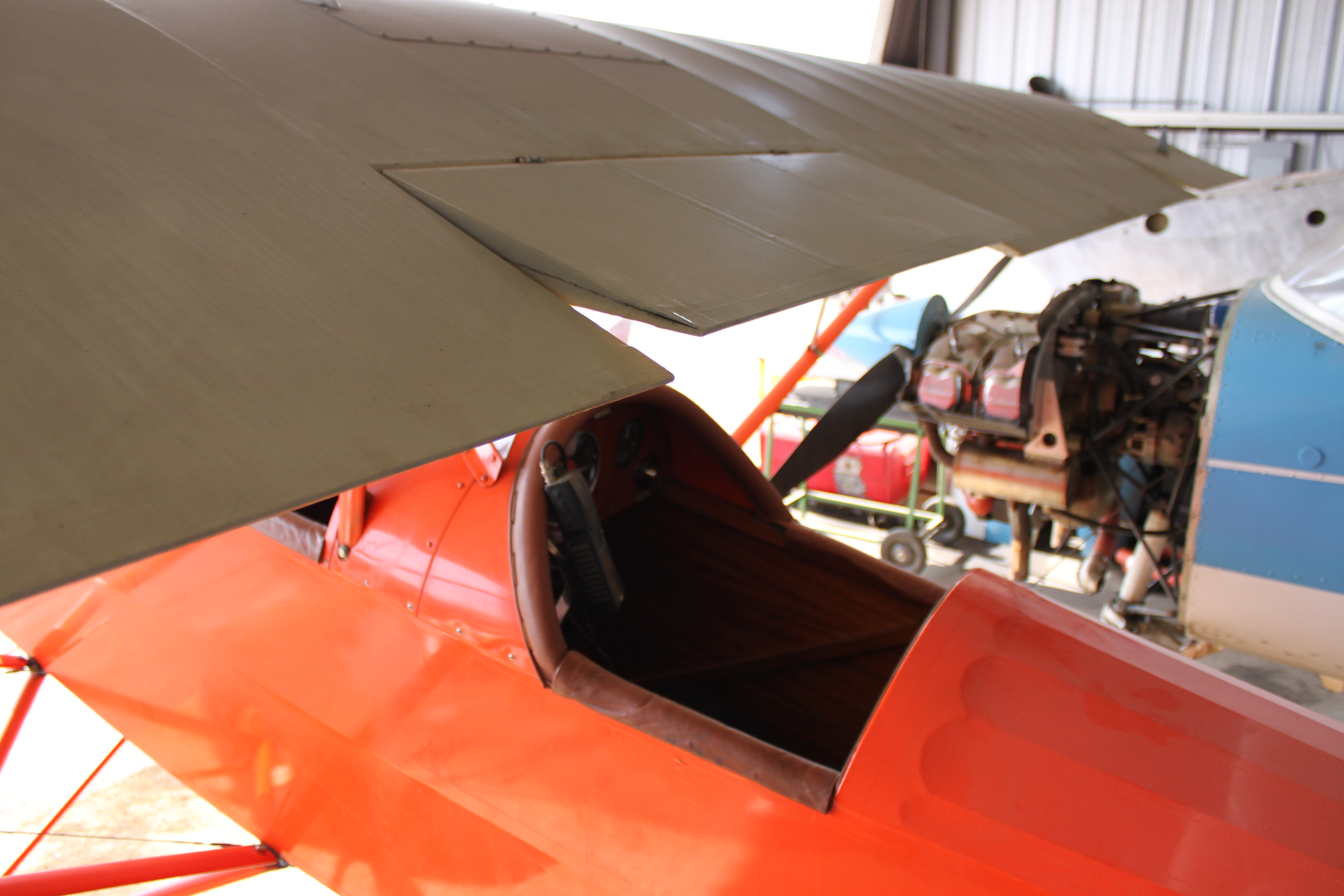

Posts: 325
Re: Centre section flop
Johnny. I fly Ken Perkin's Piet N34KP. I thought I'd post a couple of photos of Ken's center section. I'm looking for a photos of the latch's he made, but you can see how his flop folds flat to the top of the wing. He used strap hinges similar to the original hinges used on the ailerons. In the second picture you see the flop partially open. That's how I fly it, that way it clears my head. It also makes a good stall warning indicator. It stands straight up just before the break!
Posts: 684
Well, now that I've seen the strap hinge version compared to my piano hinge version, I like the strap hinge version better. Much simpler, fewer fasteners, it lays flat. Nice!

Posts: 325
The attachment IMG_4108.JPG is no longer available
The attachment IMG_4105.JPG is no longer available
The attachment IMG_4101.JPG is no longer available
I got a chance to take some pictures of Ken's Piet's flop.
