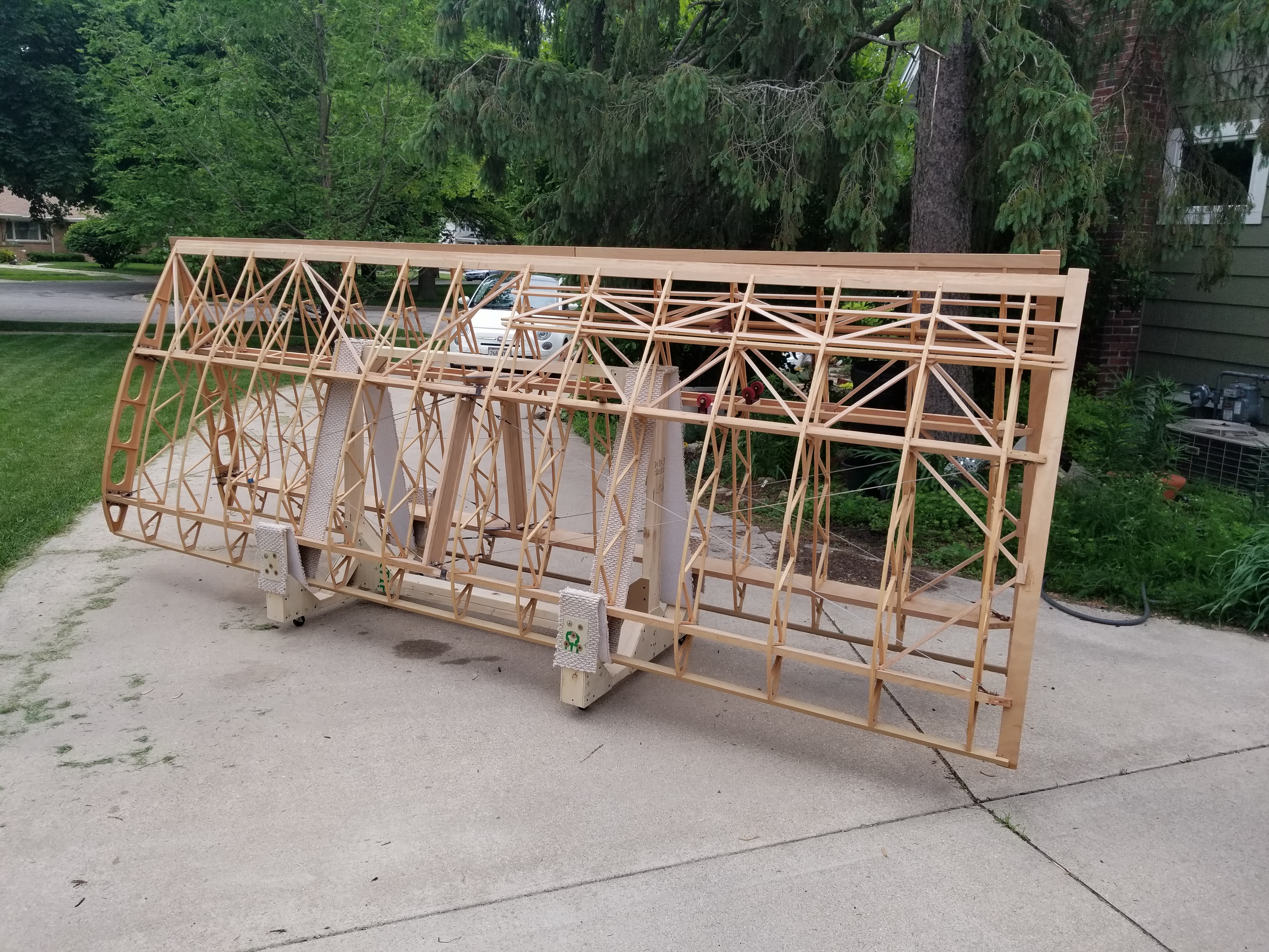

Here are a couple of pictures of my wings on the wing rack I made.

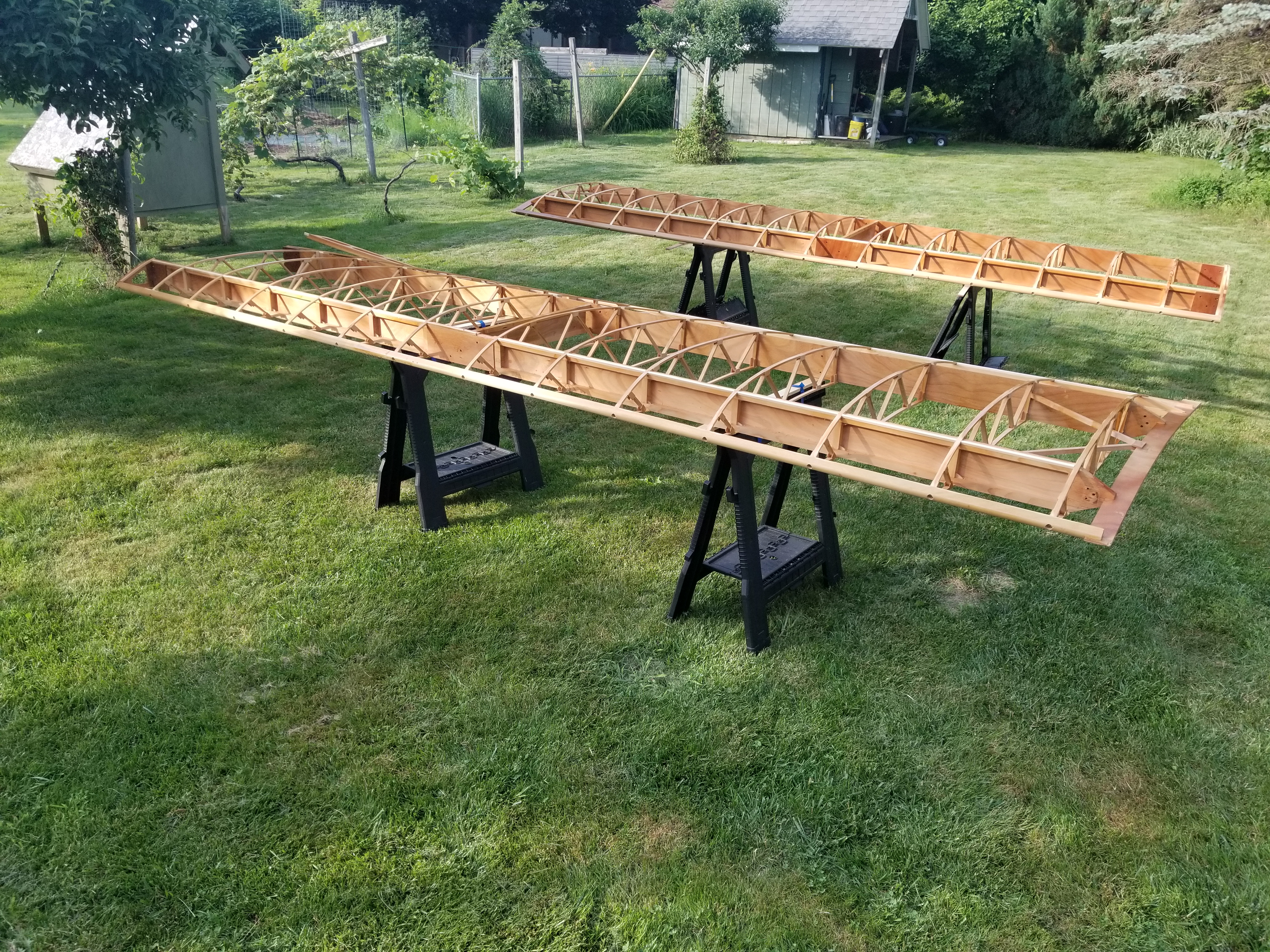

Second picture

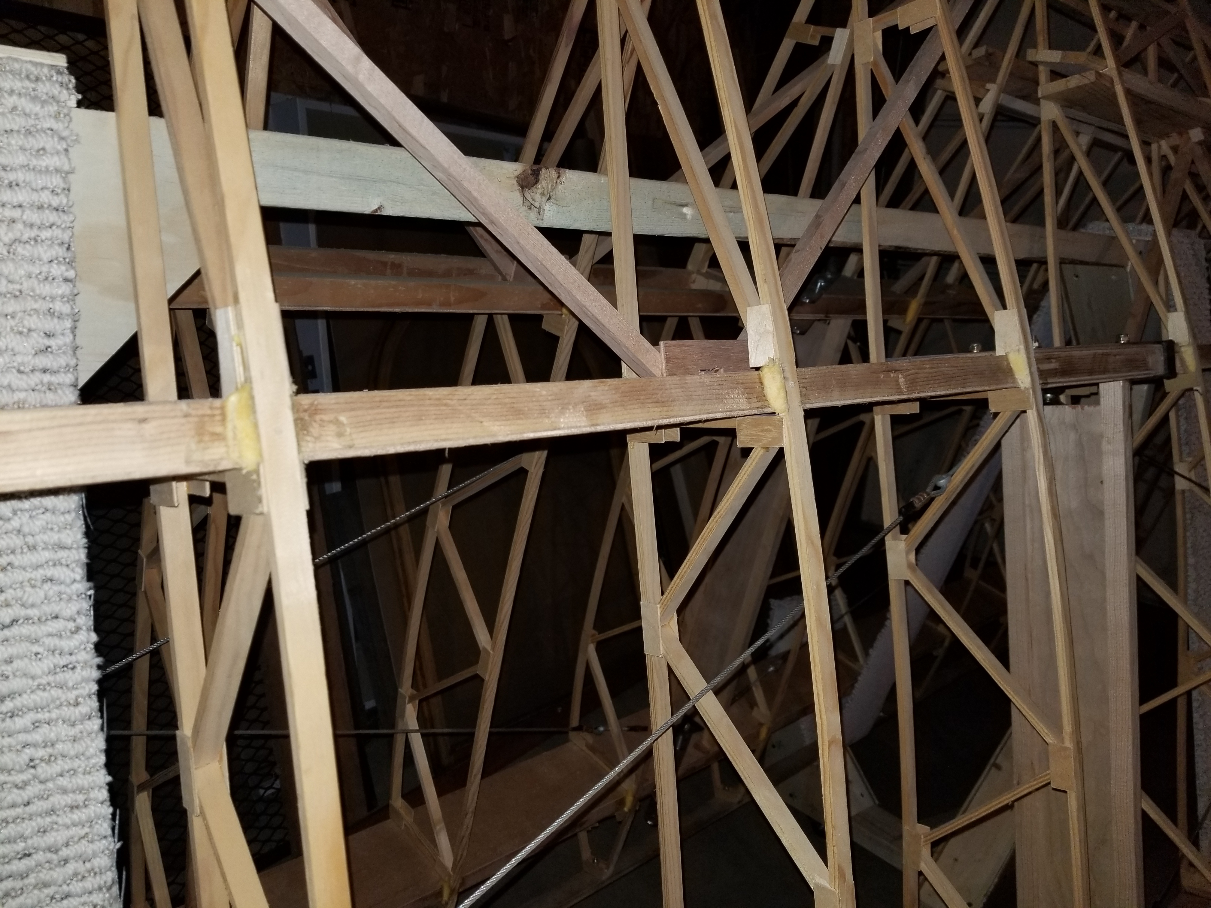

Here is a photograph of the flocked ribs. Herb Rose is the builder who recommended I do this. It worked great. I mixed some cotton flock with the glue and worked it under the colstrip with a putty knife. Then made a 45 degree fitting on each side. It really stiffened it all up.

I didn't understand your original comment about the need to "put flax where the rib meets the spar". Now that I see your photo I understand what you were referring to ... but I also don't understand why it would be needed. This is not a structural joint. Some builders use a small nail, as shown in the plans, to hold the ribs in position. Others choose to use a small dab of epoxy. Some use a small nail and a dab of epoxy. And some don't even attach the ribs to the spars (they will be firmly held in position by ribstitching). So, since there is no structural need for the fillet of thickened epoxy, all you're doing is adding unnecessary weight. Not a huge amount of weight, but it's there, and it's not needed. Then there's the time spent mixing the epoxy, and applying it ... in 240 places.

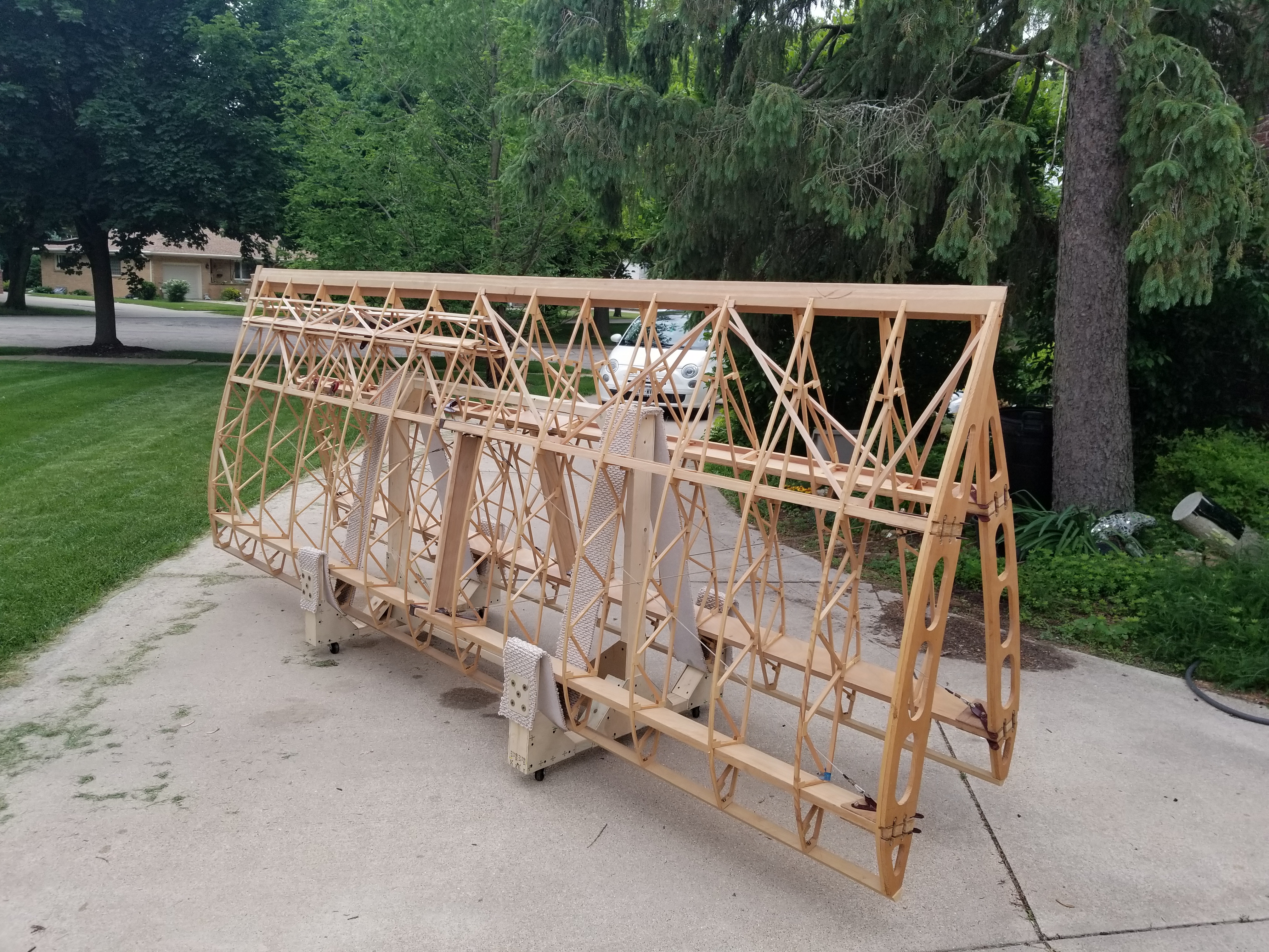

Varnish applied. Closer to cutting in the ailerons.

Dave; those are very interesting wing spars! Pretty, too. They look like C cross-section similar to the UK spars. Would you care to elaborate on how you built them? And are those biscuits locking the upright stiffeners to the capstrips? I've never see that method used before; always just triangle gussets in the corners.

I followed the folks in California and a fella in Australia and of course Tony Bingelis EAA books... It is a box spar of the "C" variety. The gussetes you mention are biscuit joints. I use them in early construction layup. It is an internal gusset. I have used them in most of the construction. I apply the external gussets later after the piece comes out of the jig.
