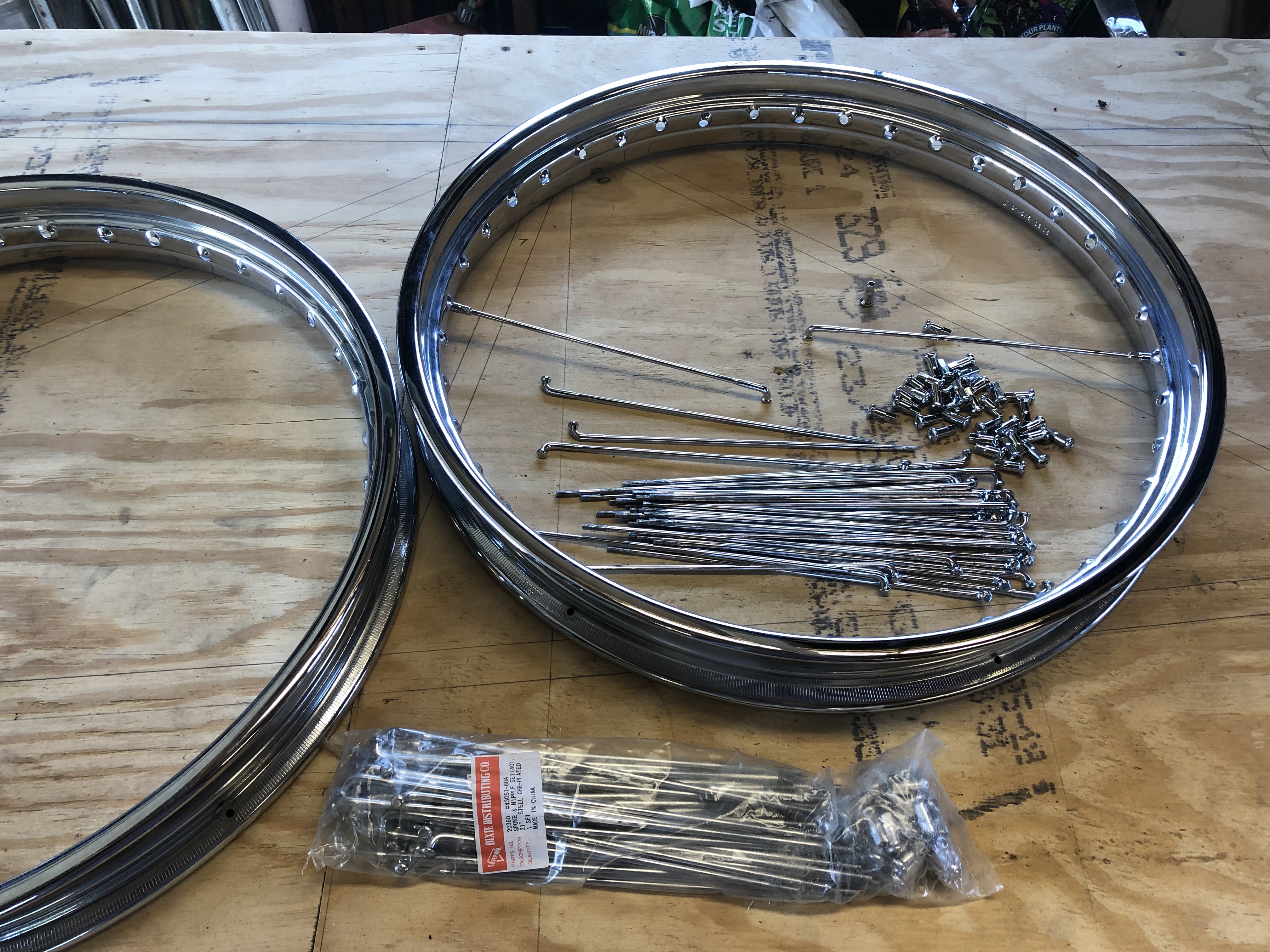

I just bought a set of 21" rims and spokes from BMI Karts in Versailles, OH. https://www.bmikarts.com/
The rims are $20 ea. and a set of spokes is $30.
The guy said they bought some huge quantity of these things from a bankruptcy and now they're just trying to get them off the shelf.
I was skeptical at that price but they seem pretty nice.
I weighed the rims (bathroom scale) 6.4 lbs ea.
Spokes and nipples 3 lbs per set.

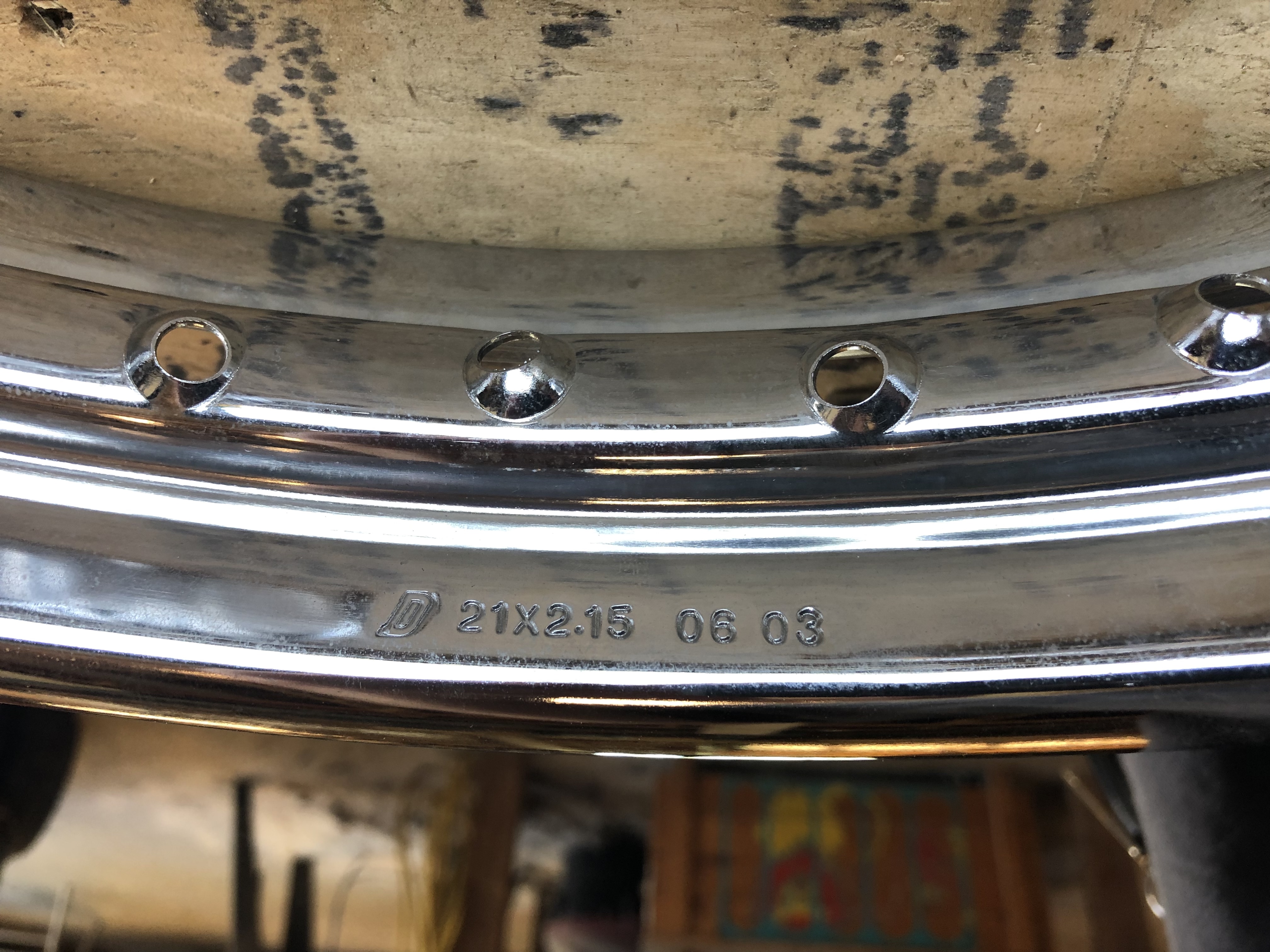

The steel thickness on the rims (including chrome of course) measures .075".
The spokes measure .158" dia with 10-32 threads.
Rather than make hubs first and then order special spokes to match, I'm hoping I can make my hubs to match these spokes. Wish me luck.
