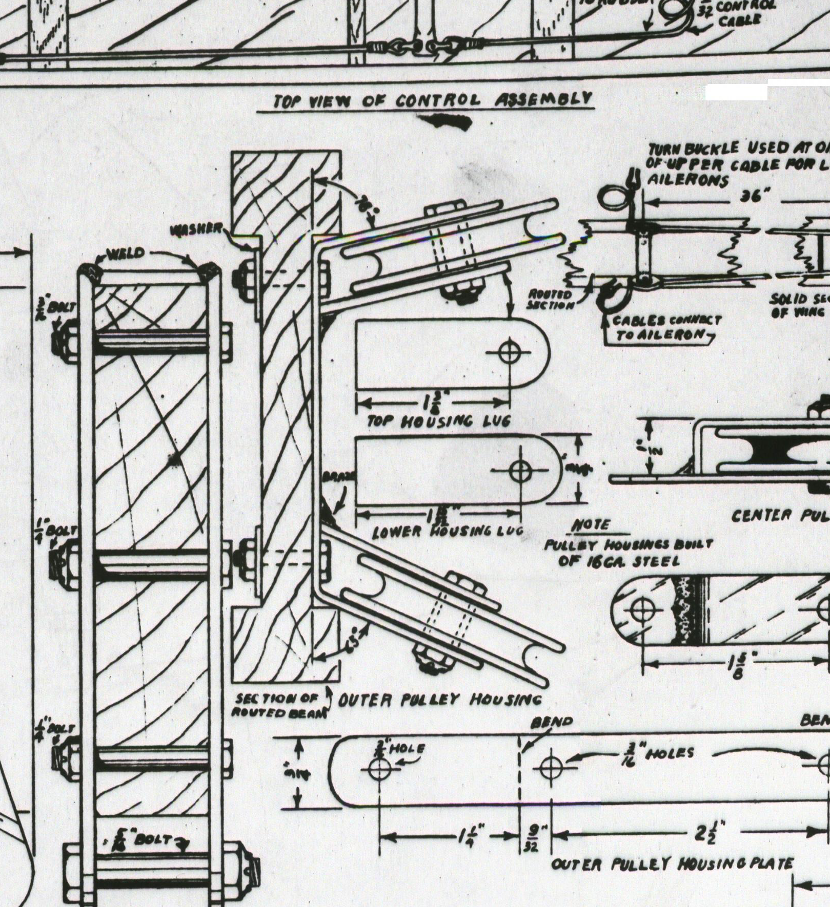

I am working on the aileron pulley bracket this weekend for my Pietenpol. I am seeking any advice you might have.

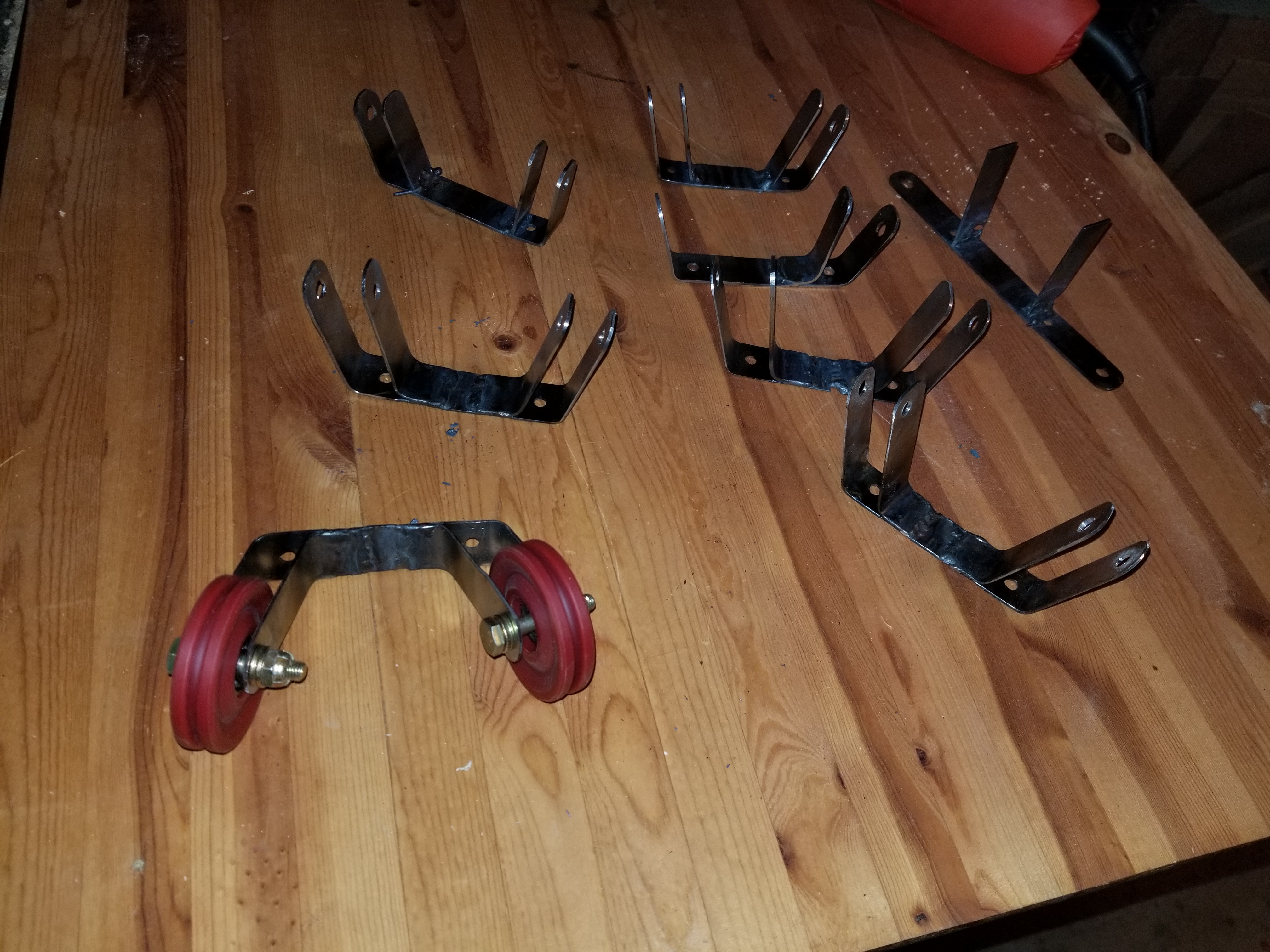

This is one of those deceivingly "simple" parts that take an enormous amount of time. I have a pretty good prototype and 5 scrap parts.....
Welding the thin 4130 is above my skill. But I have found a workable design that I can make.
The bolt does not need to welded in place. You will have to temporarily bend the inner tab in to fit a nut driver on it.

This is a horrible mess.... none of these are airplane parts. Just me trying to figure out how to make the part and work on my welding skills....
The best I got to is a backwards L that I flat weld in place.

I have two winners! the "L" version worked well and I am ready to powder coat the parts tomorrow.

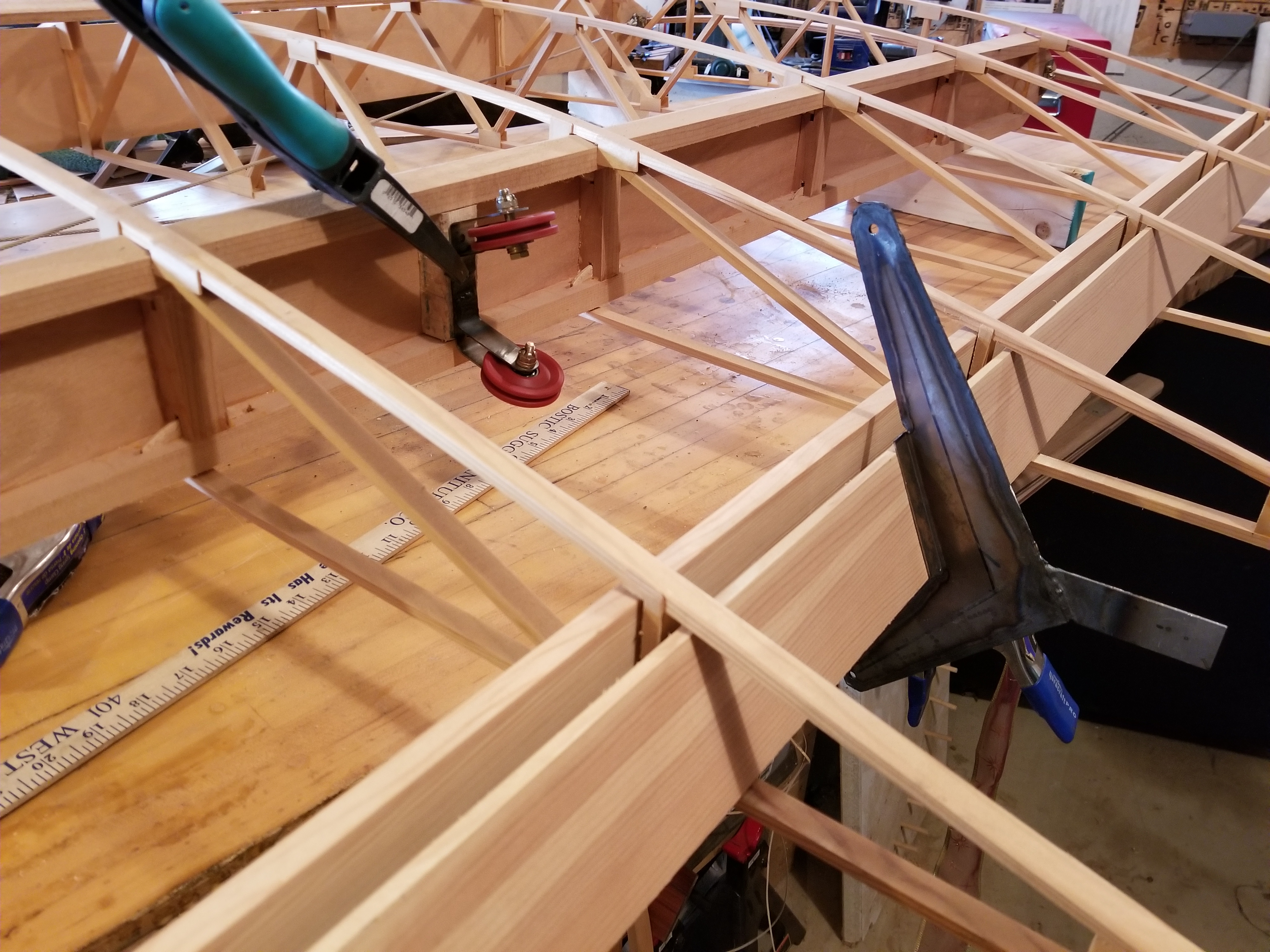

Here are some more photographs of how I make the bracket.
As usual It took me a days to figure out how I would finally make the part. now that i have made it I can make it in about 30 minutes.
However I still cannot make two identical parts. They are really similar, but hand made parts still have slight variances.
Peace
Peace
