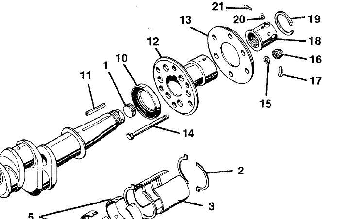

Well, as near as I can tell from the prop hub removal/installation procedure (which, by the way, was also published in the Spring 2014 issue of the BPA Newsletter), the snap ring would be the last thing to go back into the hub after the propeller hub nut is installed and torqued. There is a snap ring retention tool that is slid into the snap ring gap to hold it expanded in its groove in the removal process so that the entire hub pops off of the tapered shaft. I take it that the snap ring is the last piece to be fitted in place, but I've never actually done it. Hopefully, a tapered shaft hub guru will chime in here...
Posts: 328
Re: Prop hub snap ring
The snap ring goes in the hub after the nut is installed. It's what the nut pushes against when you remove the hub from the tapered shaft of the engine.

I neglected to state that the engine is a Continental A 65 with a tapered shaft . I see in the exploded view that the snap ring (number 19) is the last to go on. That is the answer to my question. I received the prop hub nut, key, snap ring and the saftey bolt and nut in a zip lock bag along with the question as to how it all goes back on. Thanks much for the help.

You may find that the safety bolt should be the last part to go in, otherwise you may have trouble slipping the snap over the nut past the safety bolt.
