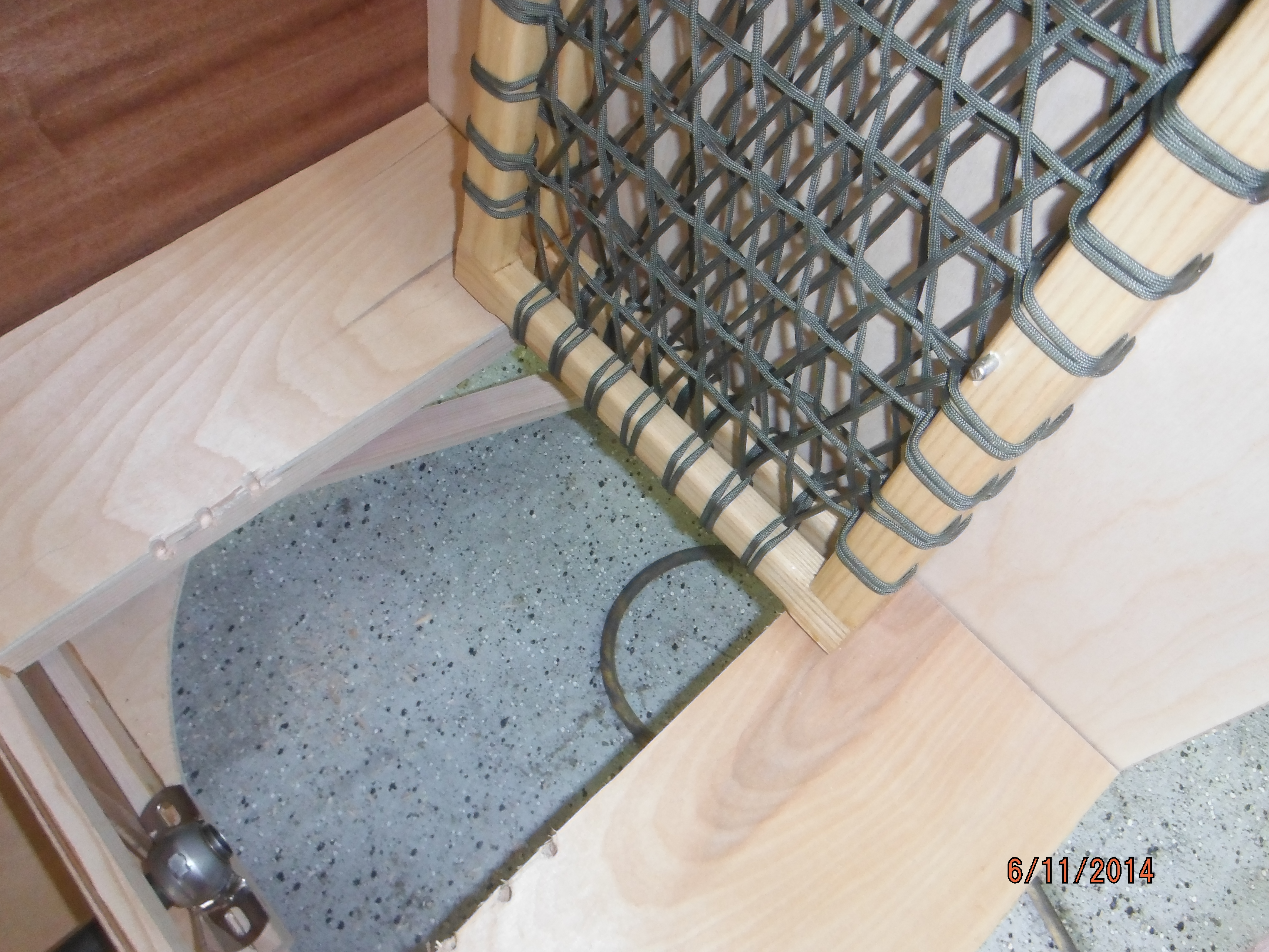

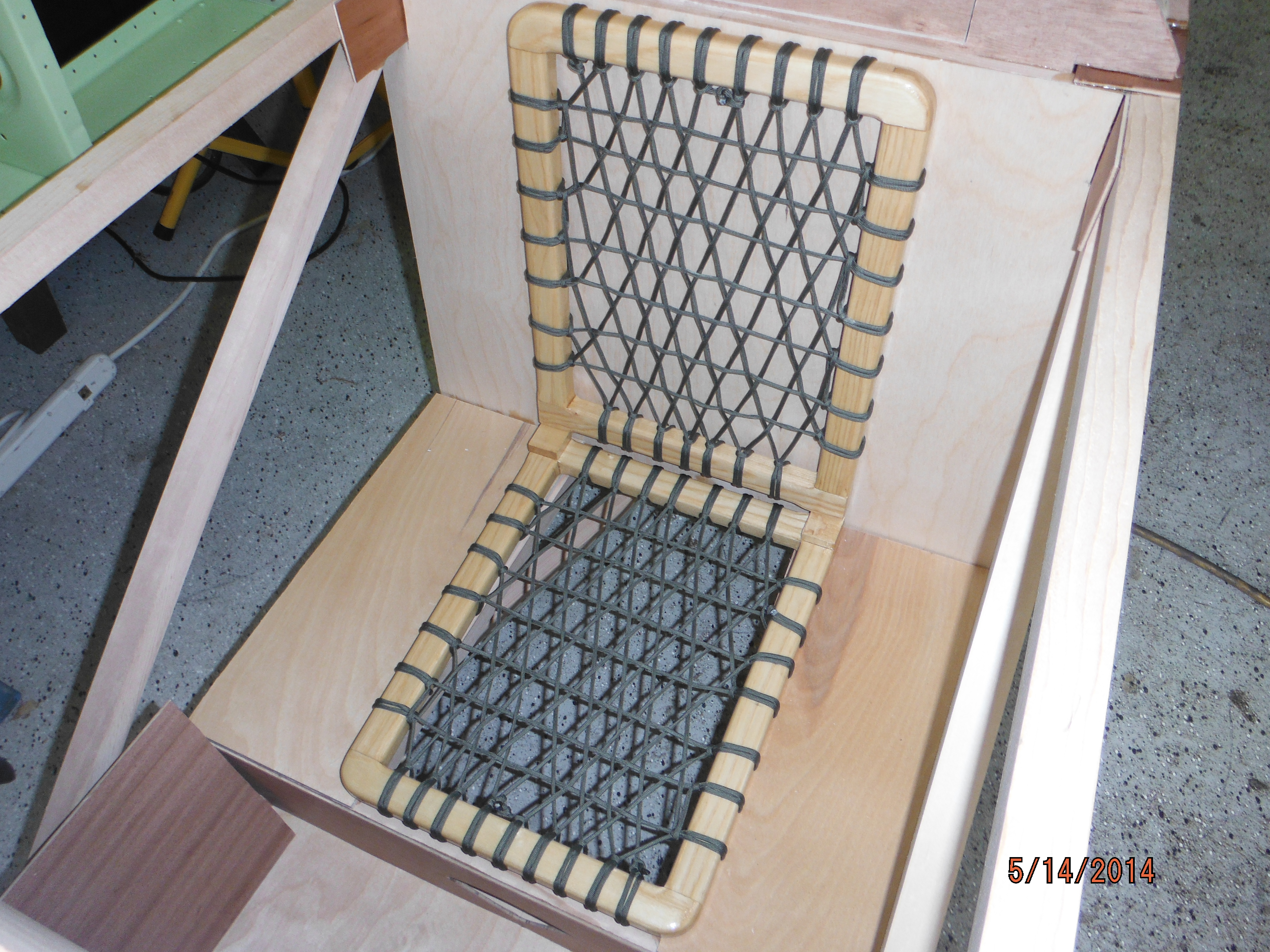

I did. I made a wood frame and attached a snowshoe weave with paracord. Steel pins in the seat frame allow several adjustment positions. Not much, but a little bit of recline. The frame is loose in the airplane - I will depend on seat belt system to keep me tied down. I took out some of the solid seat bottom. Even so, I have added some weight. I intend to cut out a bit of the solid back also to make access to the area behind seat for inspection.
Lawrence Harris, Tellico Plains, TN

I love that snow shoe weave. Light and looks "old timey"
Brian
