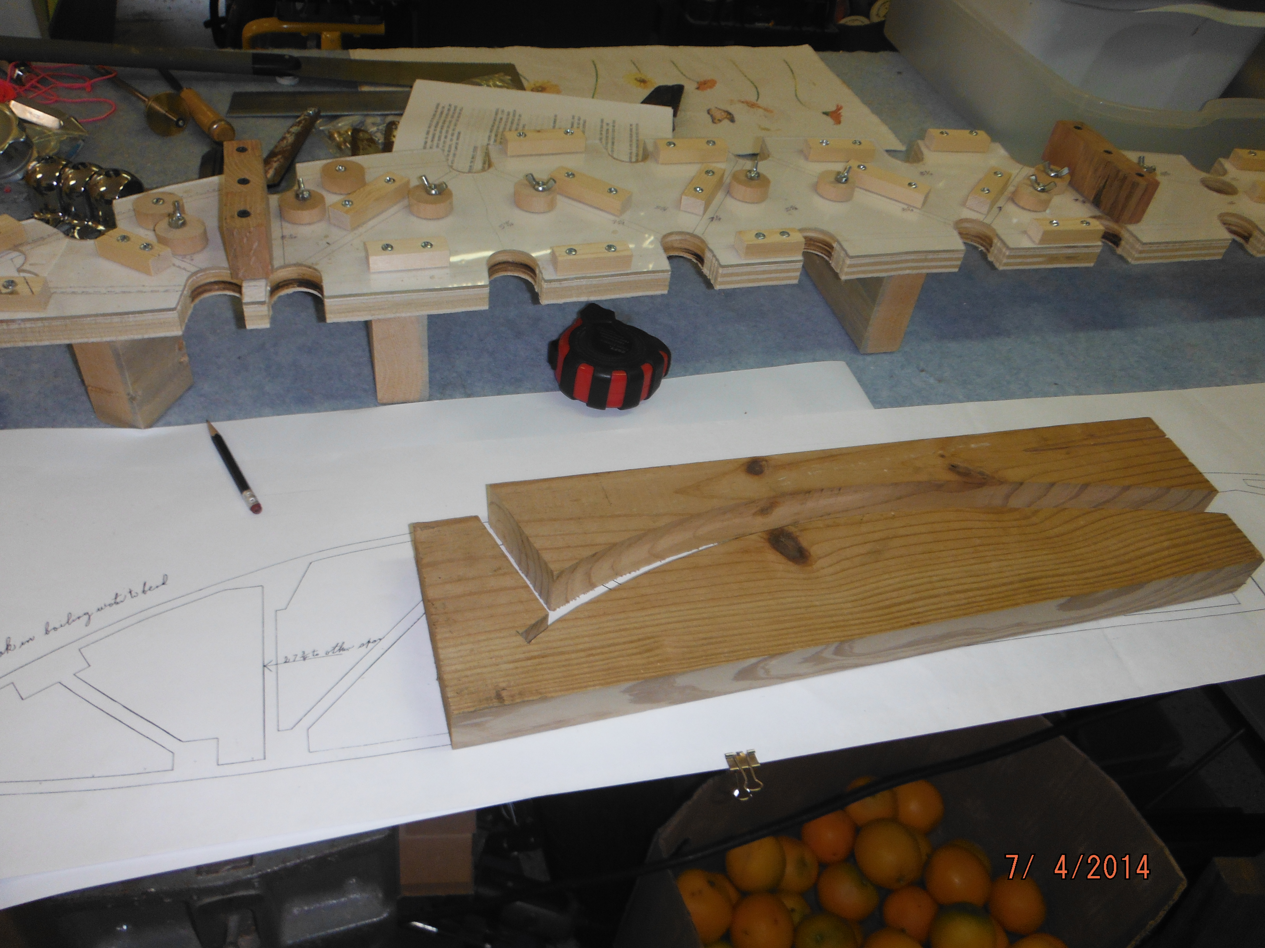

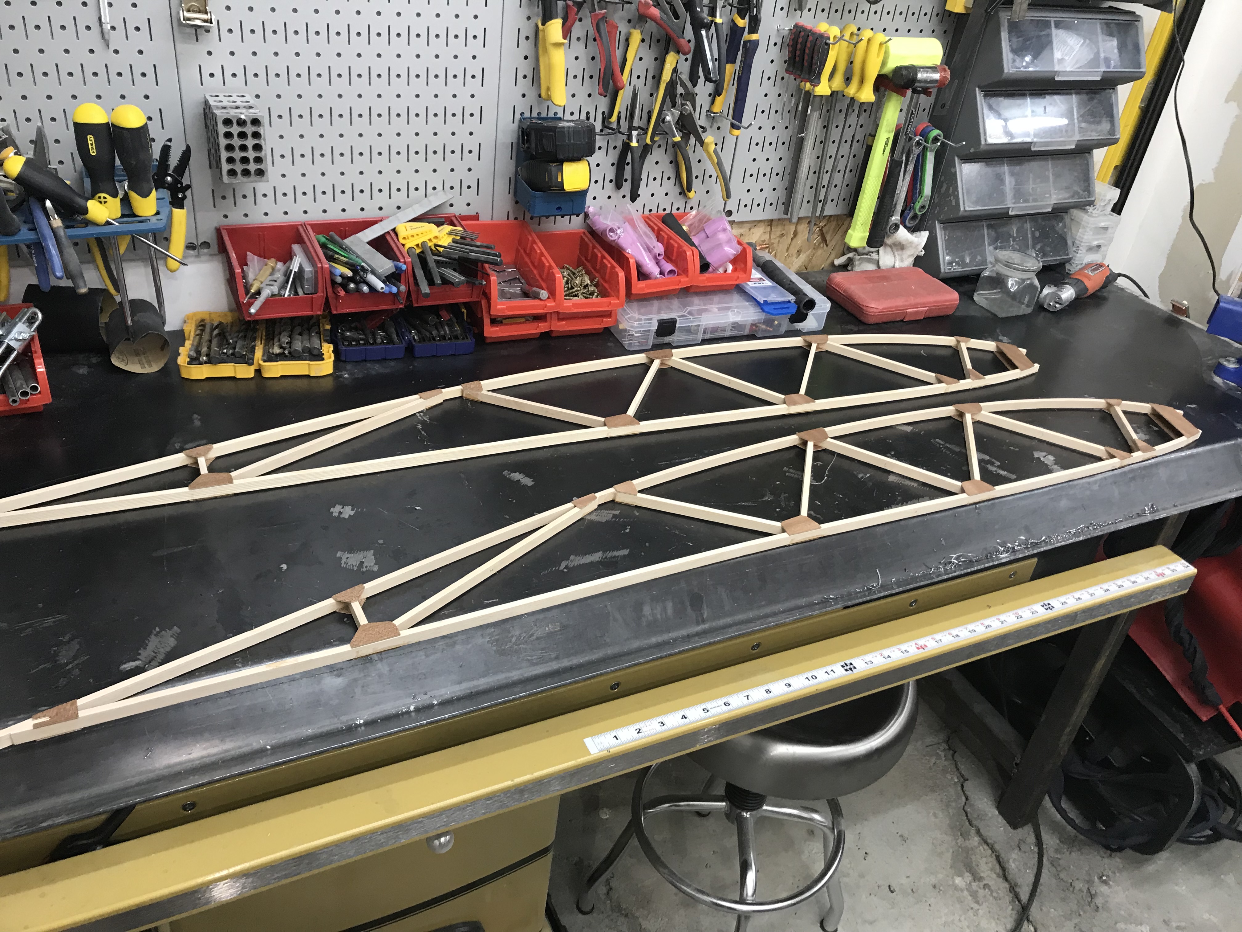

New member here, first time plane build as well.
As I started cutting and assembling the first few wing ribs my decades of woodworking kicked in. What have others done to be able to gang cut multiple parts? I recorded all of the angles for the various parts and was considering making something so I could cut 4-6 pieces are a time.
Prototype master pictured, that’s what I recorded all the angles from. Any ideas would be most appreciated.

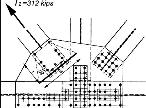

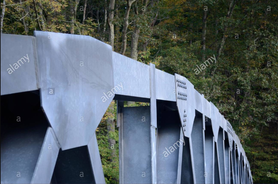

Also, I am enclosing some pictures of steel bridges and their gusset/diagonal construction -
The strength of the joint is not in how perfect your joint is between diagonals. Rather it is the quality of the gusset and gluing. So the reality is this. If you are looking for a fast way to cut ribs, cut them all at 90º angles, as the strength of the joint is in the gusset to diagonal attachment, not the diagonal to diagonal attachment.

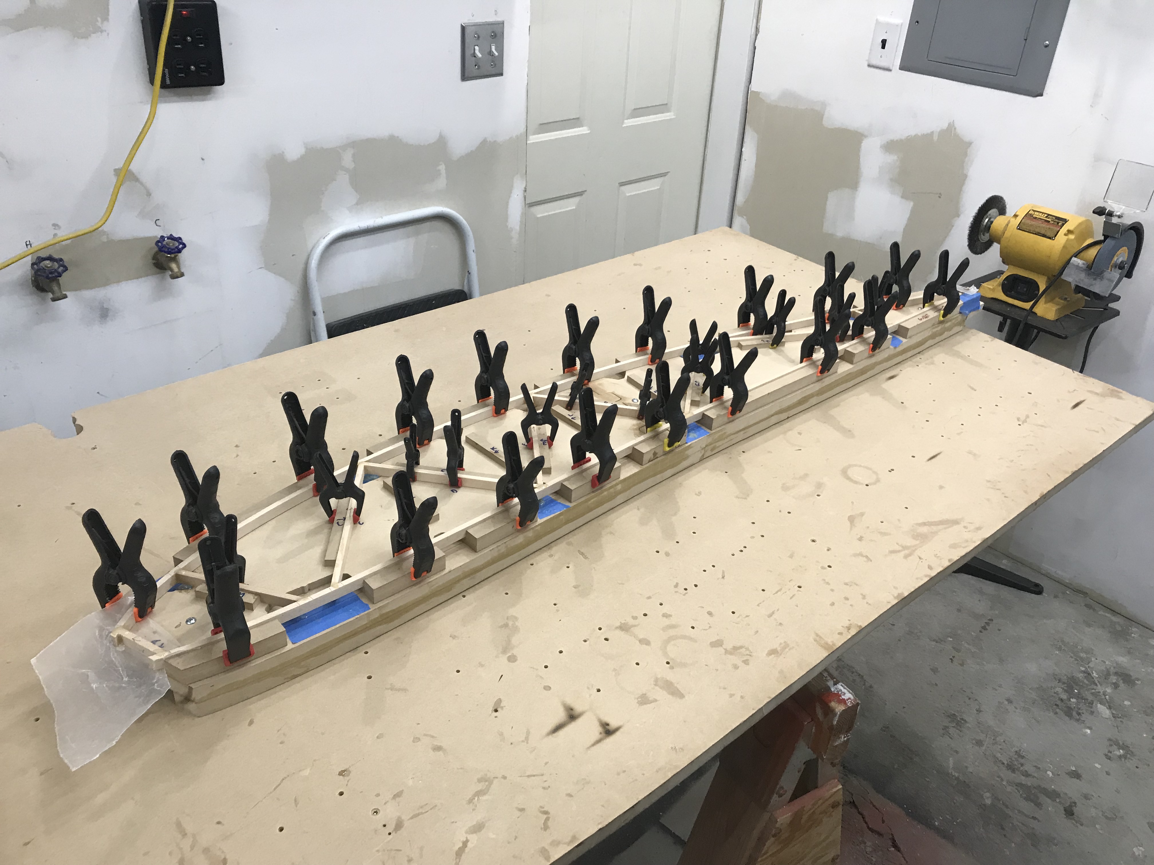

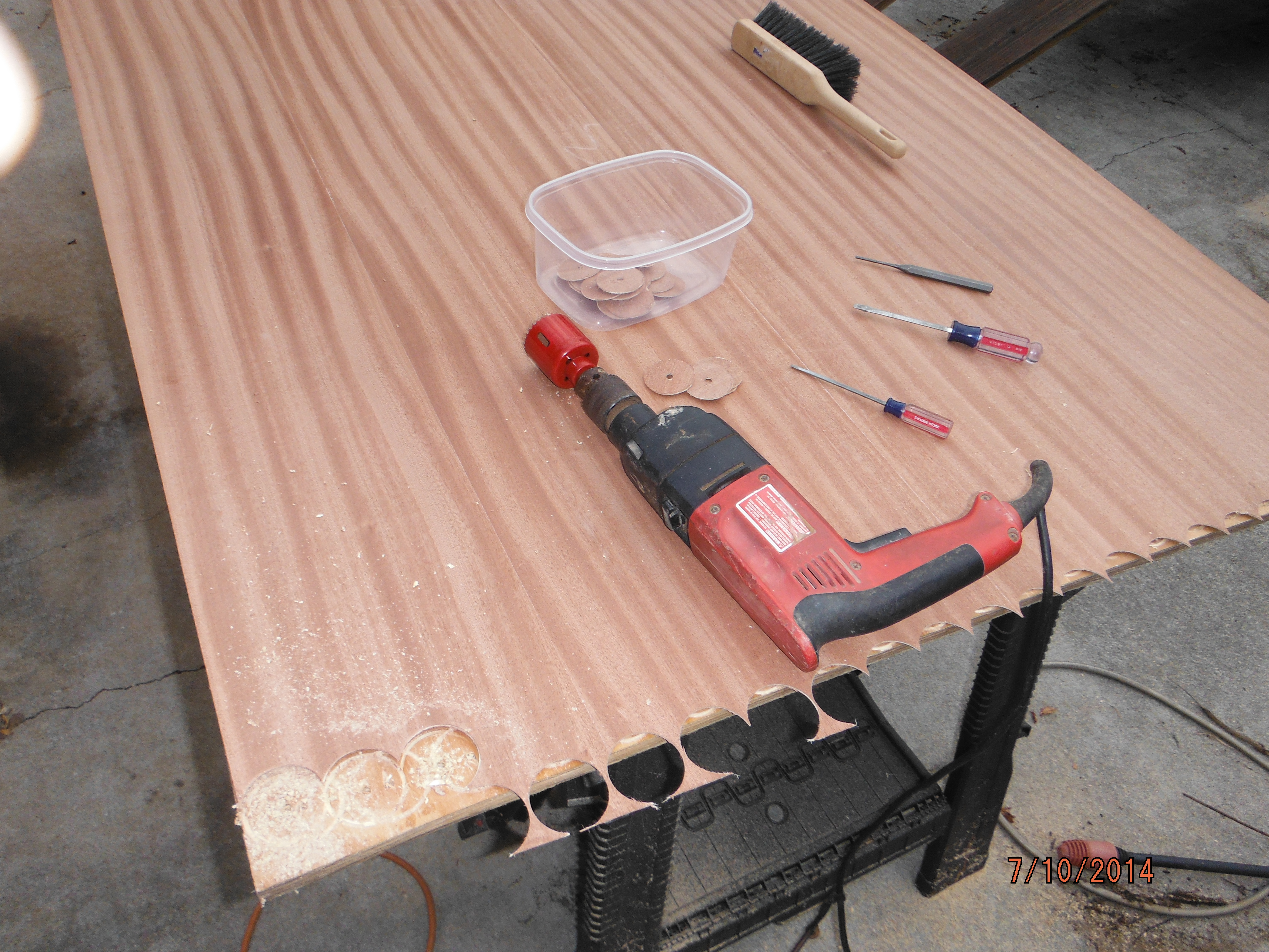

I did not 'gang cut multiple parts.' I cut hundreds of gussets with a hole saw. I steam bent the cambered cap strip lengths and set them aside. Then, during assembly, I cut each gusset to the shape I needed with shears. I cut each set of parts for each rib as I was putting it together. I cut each straight cap strip piece to length on a benchtop band saw. Then a light touch of each end on a 12" disc sander to get a precise fit in my jig. I made sure that each end was solidly against its crosspiece. Terry Hand is correct that the strength of the joint is carried in the gusset - but there is an element of fine craftsmanship here too. Maybe 5-10 minutes to fit parts for each rib. You need to leave the T-88 setting up overnight anyway. Mixing and spreading the glue takes longer than fitting individual parts. This was actually the most enjoyable part of the process.
Re: Rib cuts

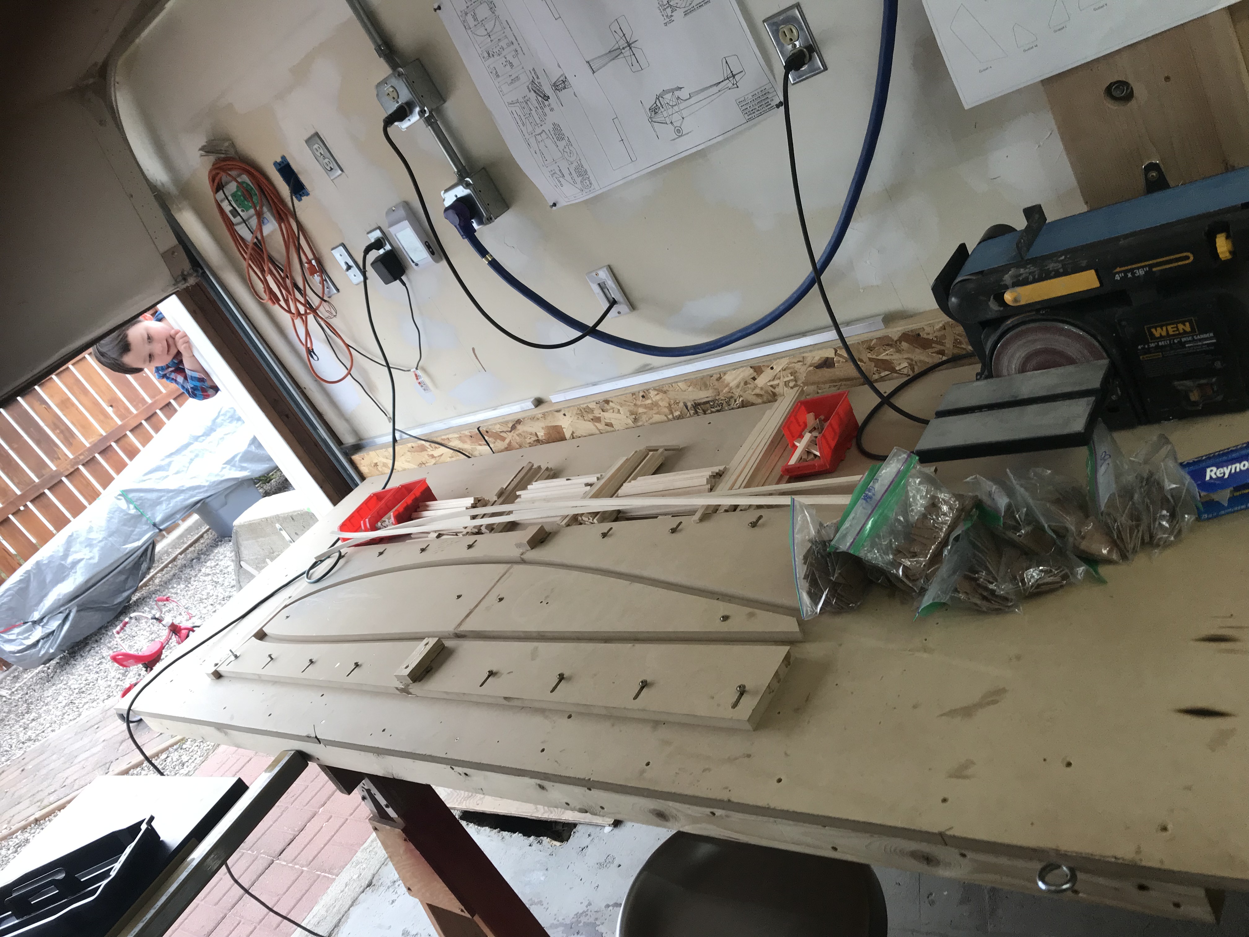

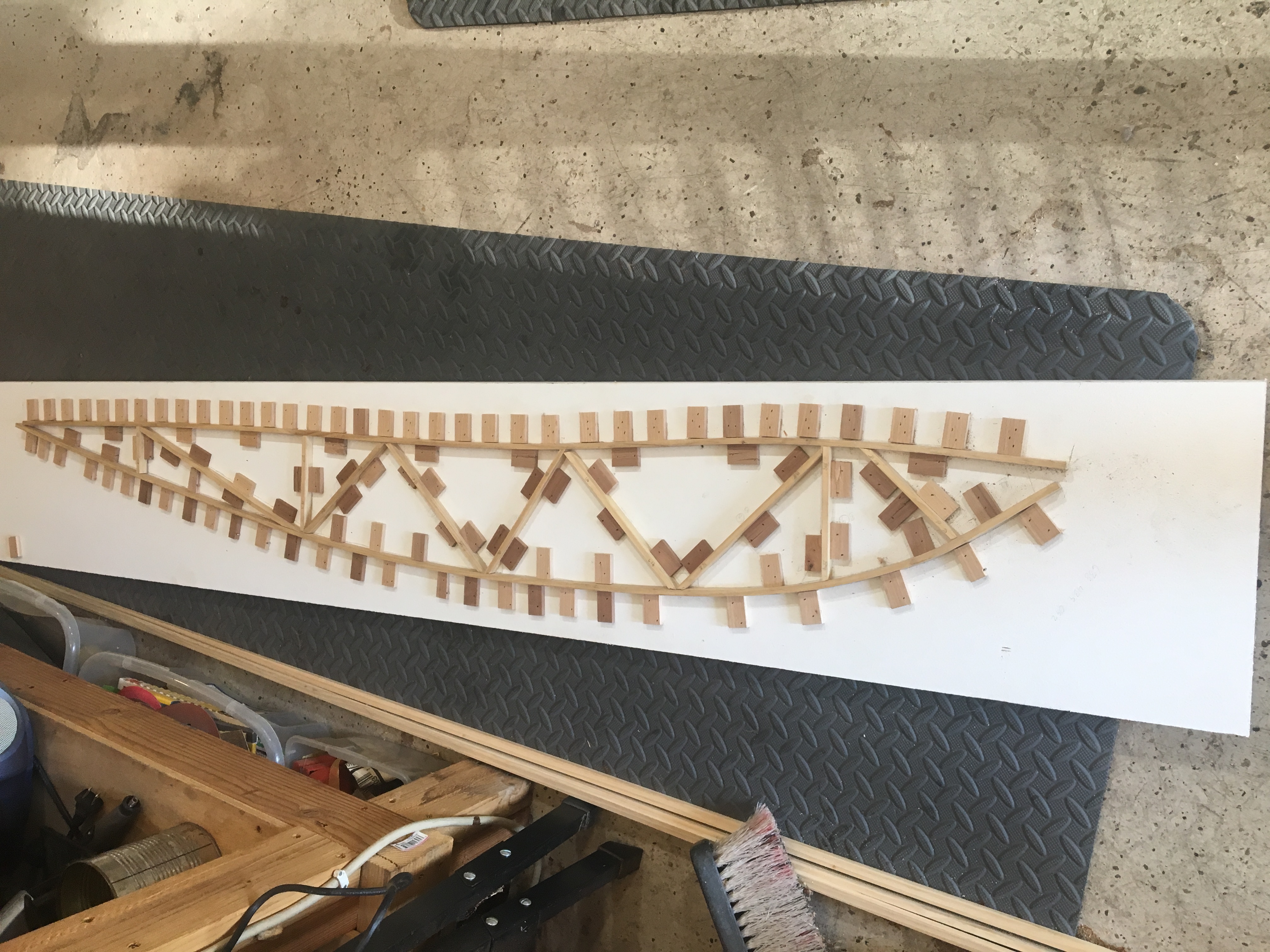

I made all my parts first, then started gluing up in the jig.
Re: Rib cuts

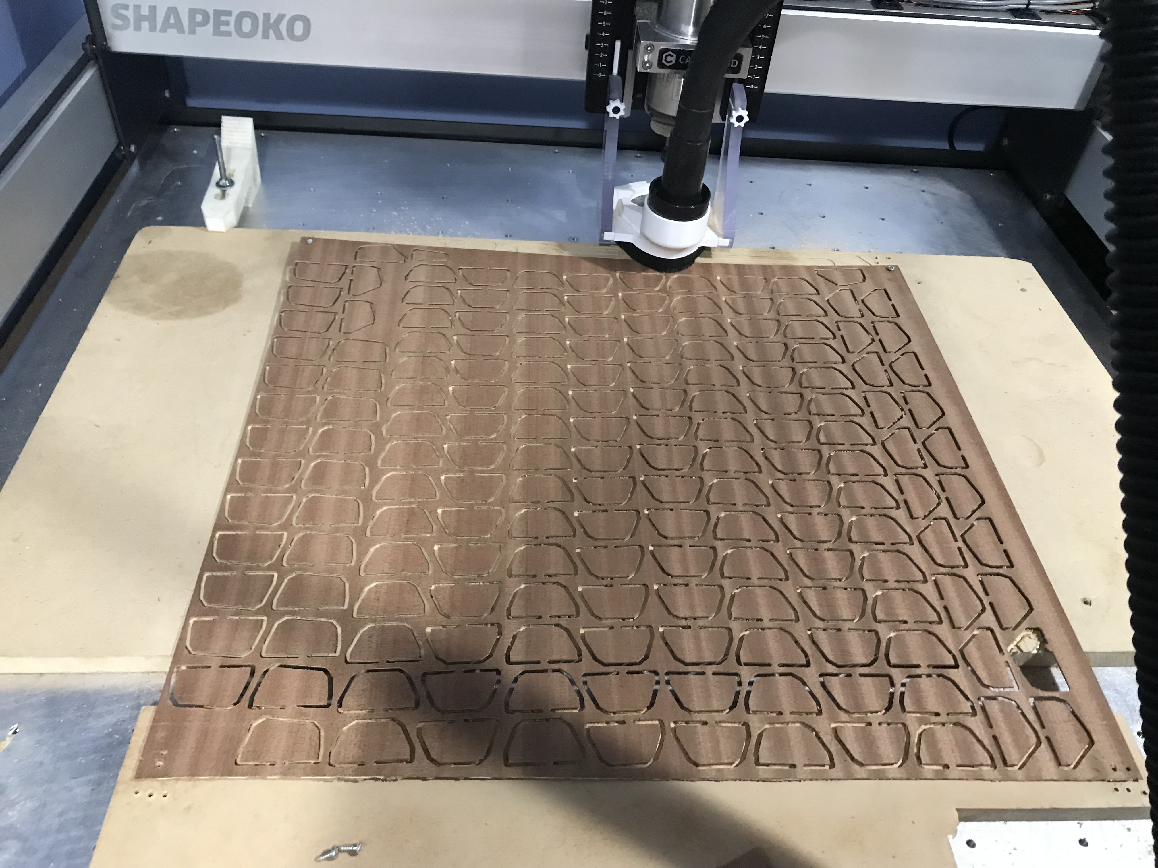

I did mine a little differently. I made use of a CNC router to cut out the gussets, the forms for steaming and the glue-up jig. I rough cut all the cap strip pieces to length and then basically started an assembly line. I steamed the long cap strips and clamped them in the form for 24 hours, then I take them out, clamp them in the glue up jig and just start fitting up the shorter pieces. Fitting up the short pieces is probably the most time consuming part, I got it down to about a 30 minute process. The first set were used to mark the miters on all the other pieces so I could get them all roughly mitered then when I go to fit them up I use a disc sander to fine tune all the miters. The best way I found is to work from one end to the other and get them to fit up to the long pieces before sanding them to fit with each other. I glue these together without putting the gussets on, fortunately t-88 tolerates small gaps although it does tend to drain from the joint if there are any gaps so I did add some milled glass fiber and silica thickener. After 24 hours these are strong enough to come out of the jig and be sanded. They need to be sanded since the glue won't allow the gussets to sit flat. I didn't use any nails on the gussets just put glue on the cap strip sides and slapped them on. Sanded them to 240 grit and they're done.
