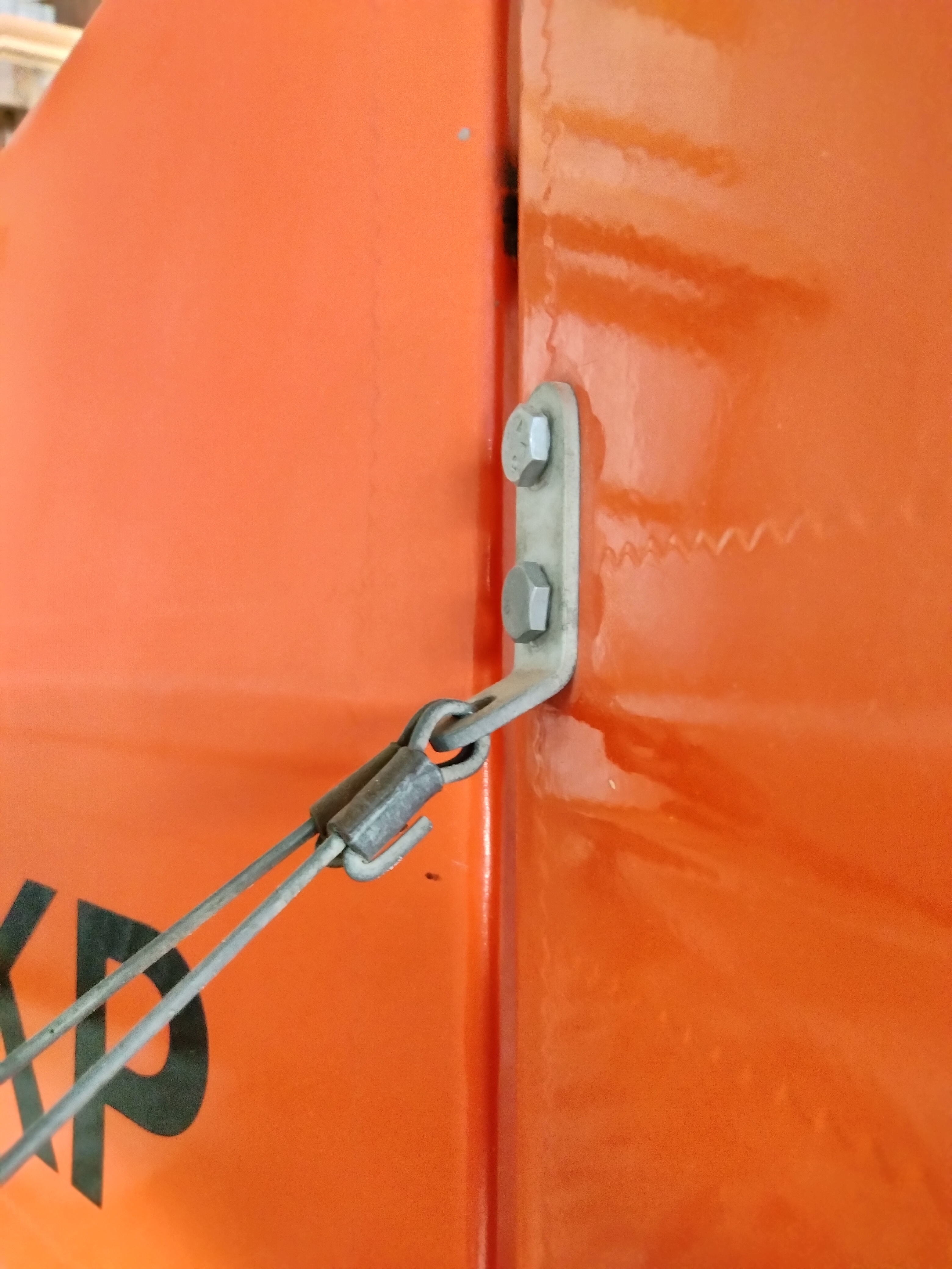

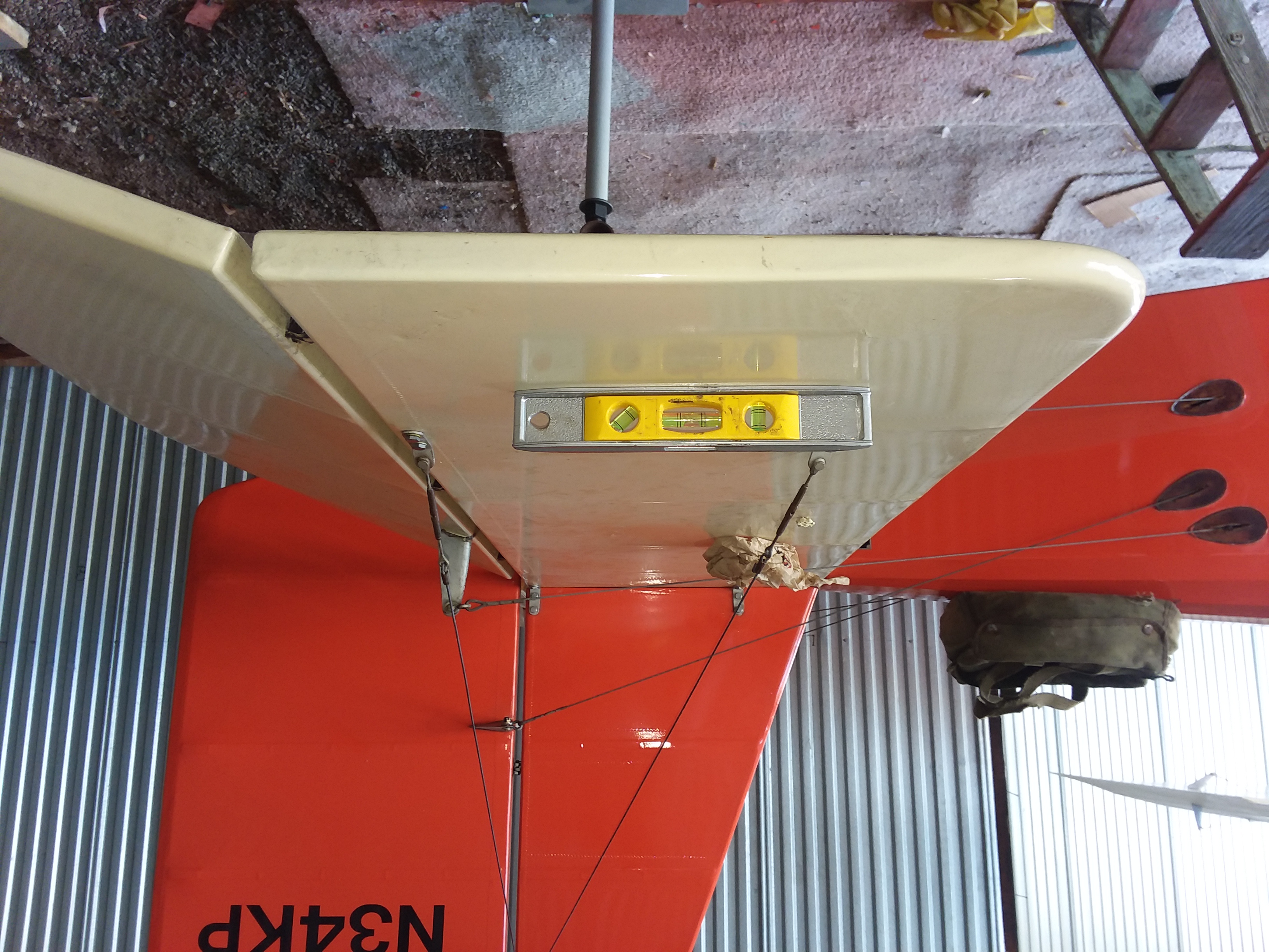

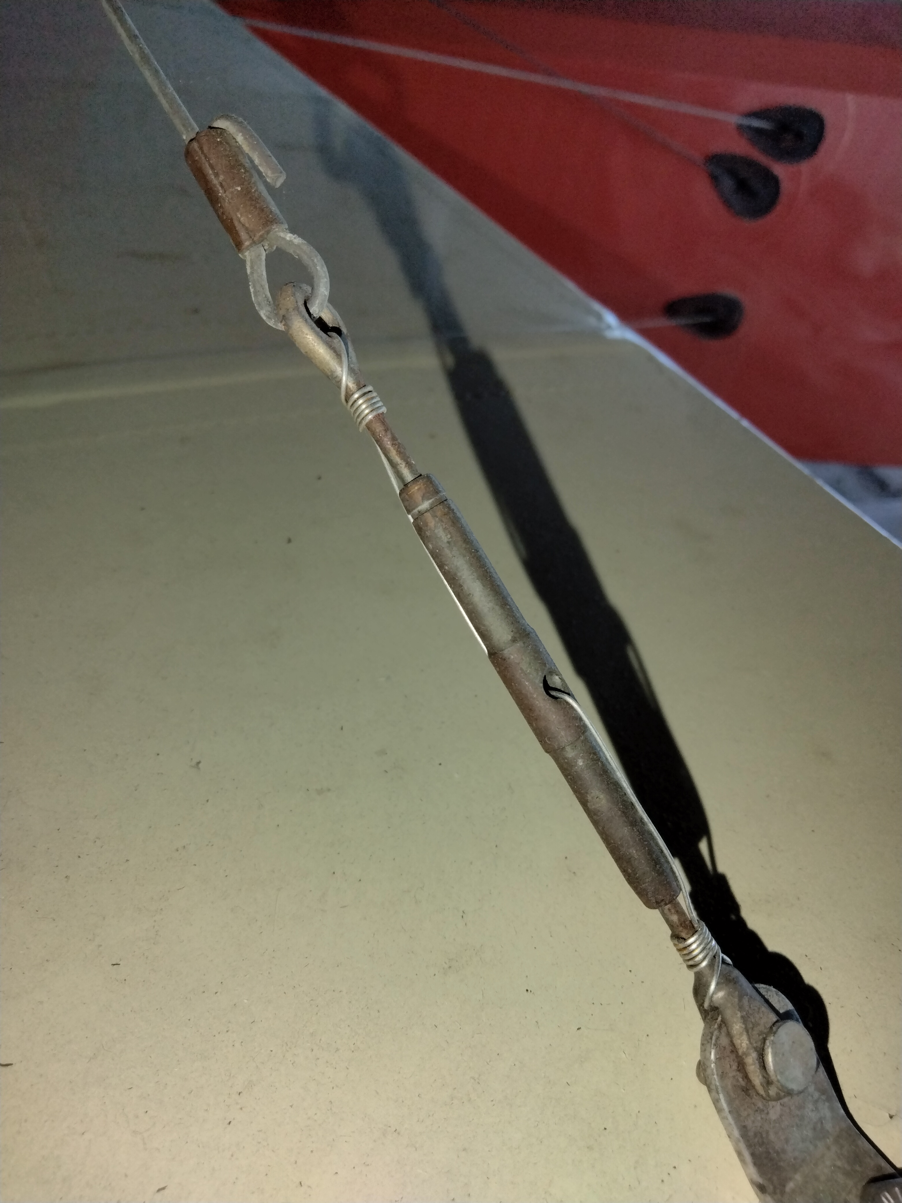

N34KP has tail brace wires of hard wire with nicropress sleeves and turnbuckles. I'll see if it can find a closer shot.

Well I'll be hornswoggled! I don't think I've ever seen one with nicopressed hard wires! I couldn't tell from the photo, but are the short tails of the wires thenbent back up against the nico sleeve like they are with wire-wound ferrules?
Re: stabilizer turnbuckle
Man, that would have to be pretty thin/small ga in order to do that.
- Posts: 372

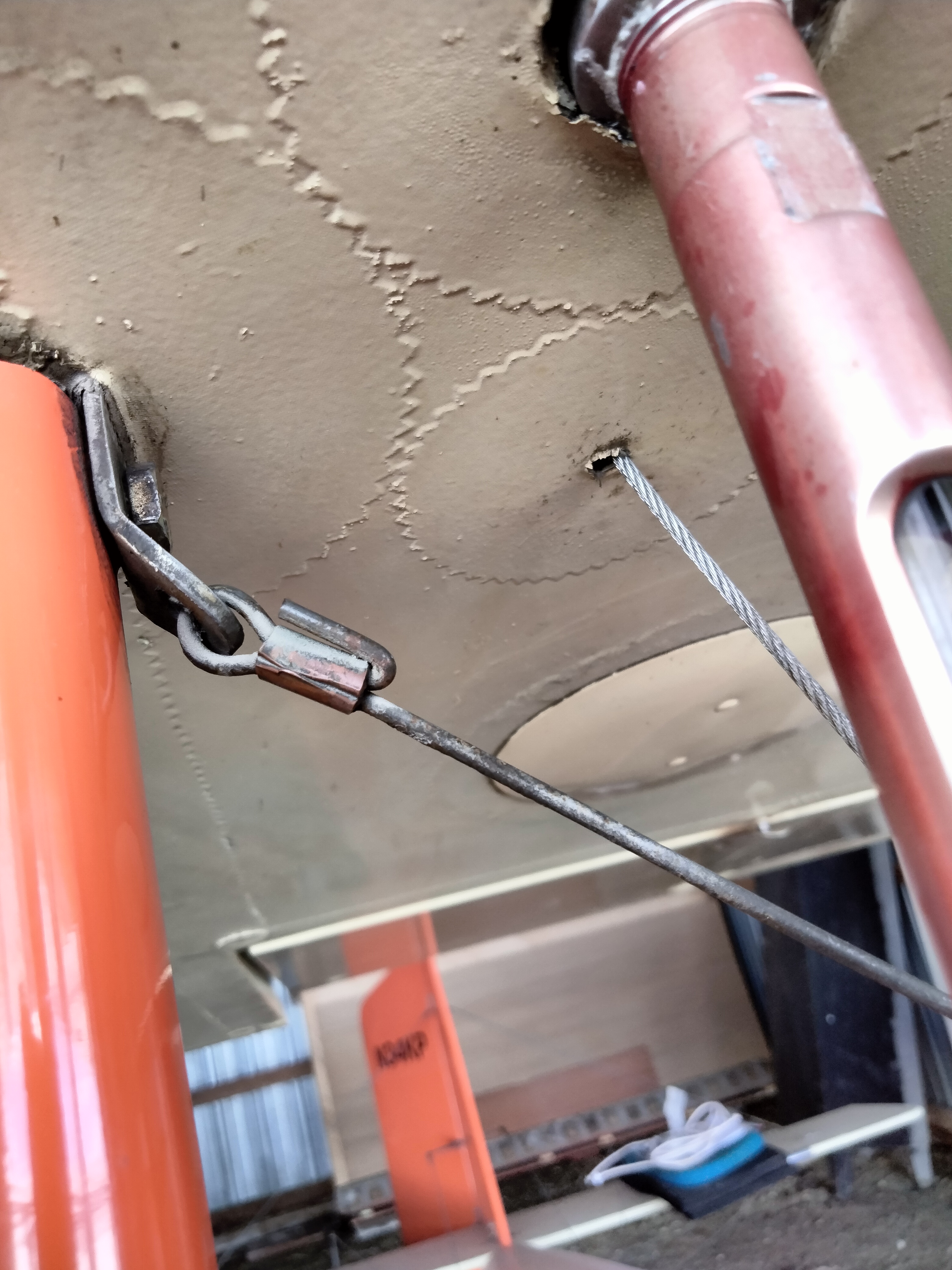

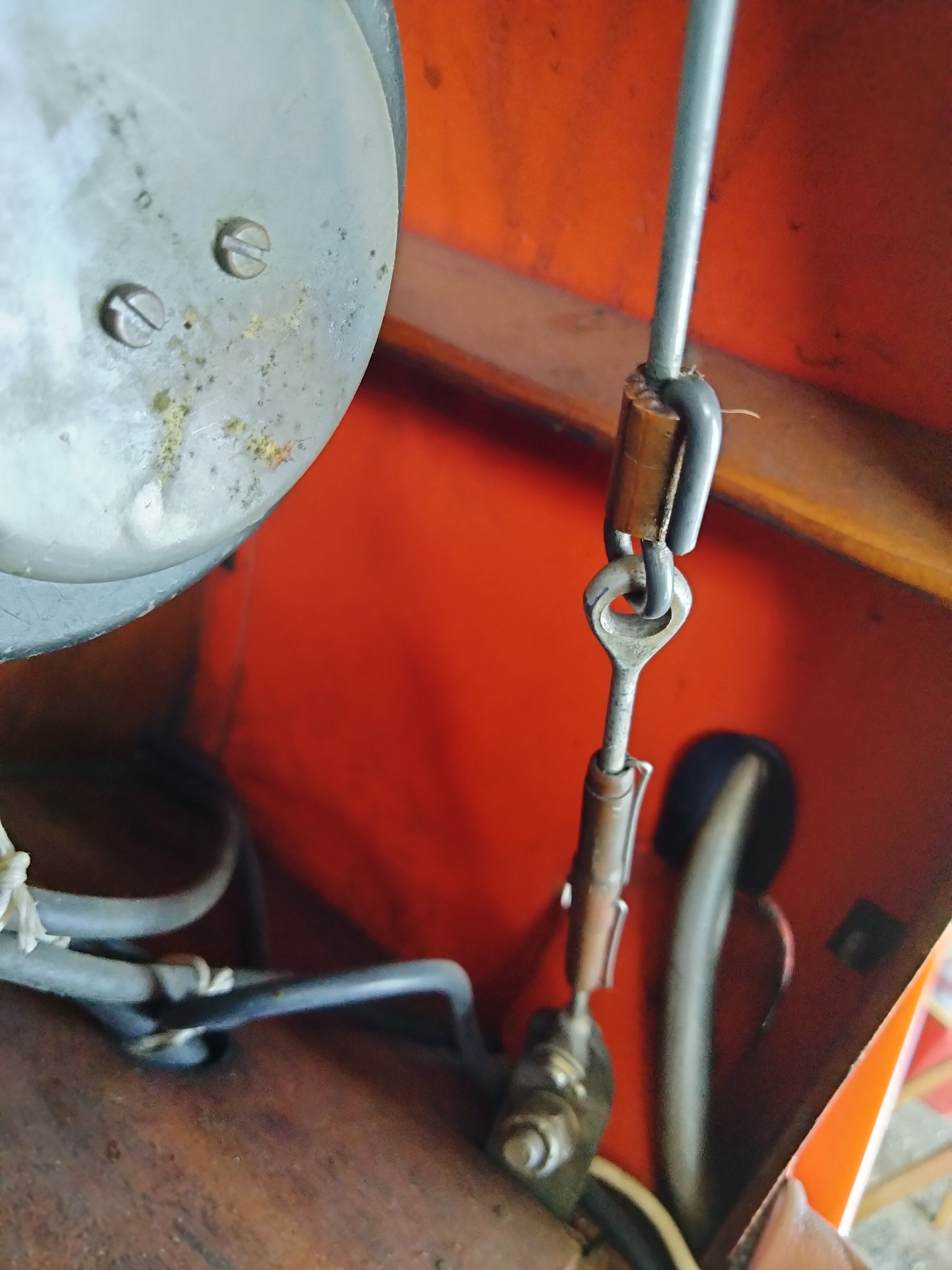

34KP has 12 gauge wire on the tail braces and 11 gauge wire for the center section rack wires. The bends aren't that tight, they bend around the nicropress sleeves.

It may be just the perspective of the picture but it appears that the aileron control cable may be touching some of the fabric as it passes up into the wing. If the fabric is ceconite and the cable is touching it, over time the ceconite will eat away at that cable. Clearancing the cable by making the hole slightly larger will avoid that scenario.
