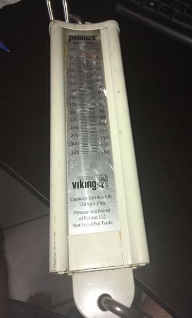

Bob; is the engine together and running, to where you could test a prop on it? I have a Prince 68x42 that is probably more than my A75 can handle but might be OK for your C90 since it was flown on a Skyote with an O200. The Prince P-tip isn't really the best 'look' on a Piet, but if you're looking to test-run an engine, it might get you started. I also have the infamous "fish scales" that have been passed around from user to user in Air Camper circles for thrust testing on the ground.

Bob; I fly behind a Culver 72x36 on my A75 and can spin it at 2600 RPM in cruise to get most of the rated HP out of it. However, I like to ease it back to 2350-2400 most of the time since it just feels more comfortable there and the plane doesn't seem to fly any faster if I firewall it. On the ground, the plane pulled 280 lbs on the unofficial Piet "fish scales" at a static RPM of 2300 at wide-open throttle. My tach was calibrated against a "DynaVibe" digital instrument, so those numbers are pretty accurate. You can see the prop here- http://flysquirrel.net/piets/engine/a75ready002.jpg .

Well, come on, Bob- see if you can break the record ;o) The scales only go up to 330 lbs and to my knowledge, nobody has buried the needle yet. I have 'em in my hangar and can send 'em out to whoever is next in line.
