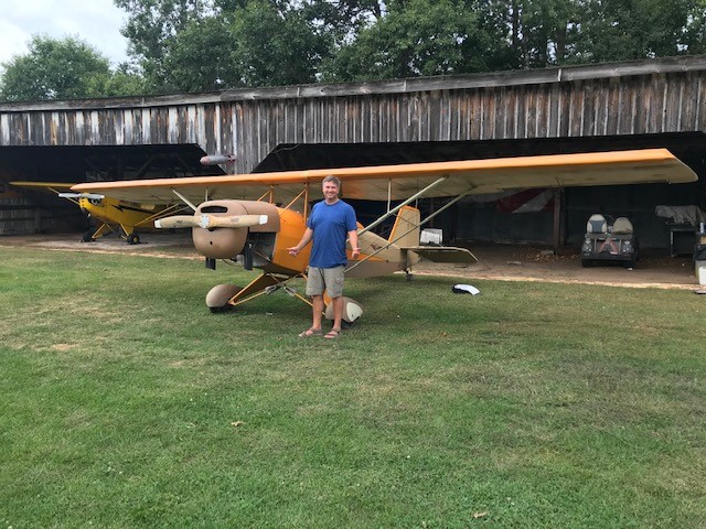

Greetings All,
I recently acquired a GN-1 aircraft and would like a little help looking her over and developing a get back into the sky list. She is in my hangar at KRNH, sans wings for the moment. She is powered by what I believe is a '67 (logbook says '66, but the serial number indicates a '67) Corvair engine, 110 hp, with a Tillotson model X carburetor. The engine has not been converted, as far as I can tell. She has a H. Rehm 66 x 38 propeller, but it is not airworthy due to delamination and several cracks. Additionally, she sports J-3 type landing gear, but I am unsure which type, and what I believe to be a 12 gallon J-3 main fuel tank.
This is one of Bob Ward's birds (N174LS) that sat at the Log Cabin Airport (WS69) for many years. I doubt he ever flew it after he bought if from the builder, Clarence "Sam" Samuels, of Watertown, WI. Any further background information would be very helpful.
The good news- she has a previous FAA registration (circa 1992), so I will be applying for a new Aircraft Registration Certificate, along with a new tail number. The previous N number belongs to another aircraft. I have the airframe logbook and have received the aircraft records from the FAA. The engine and propeller are original. The airframe and wings appear to be of good craftsmanship and are in decent structural shape.
A few obstacles to overcome- there are no engine or propeller logs, so both are MCU, pending inspection, overhaul, or replacement. Also missing is the build log, POH, and equipment list, but I will create the latter two. Am I correct that I do not need the build log since she has previously been registered?
I believe with a little work and some experienced assistance, I can get her back in the air. I appreciate any assistance and advice from the group.
