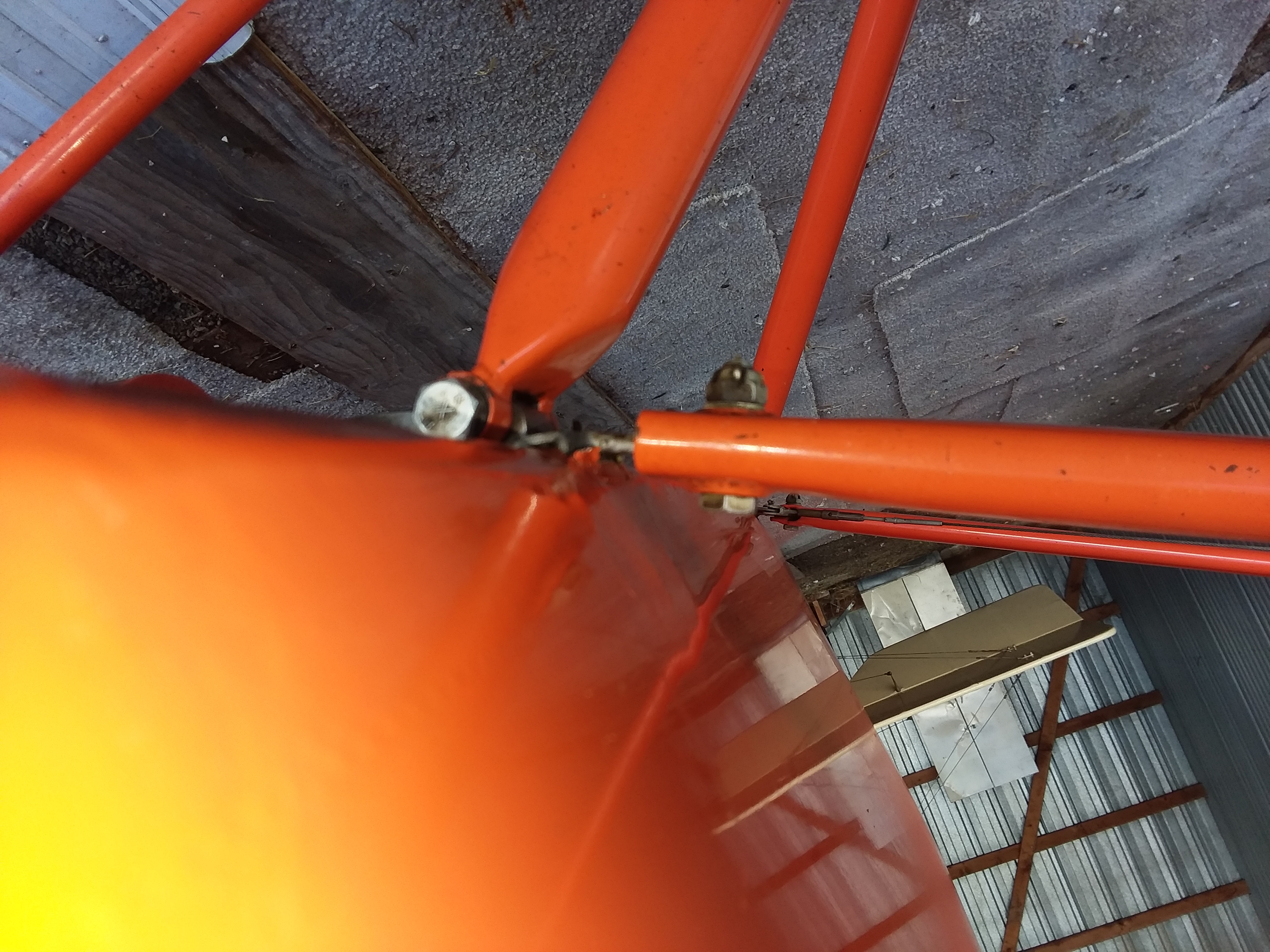

- Posts: 368
Re: strut attach fitting angle
Phone photos. When clicked on they will be upright. This is the right side, forward strut attach point.
Nice pics. Looks like a faithful following of BP's plans. I'm welding my gear up using an idea of William Wynne and Earl Brown- definitely heavier, but stronger as well. A good set of pictures of Earl's gear can be found on the Pietvair forum- it's kind of quiet these days, but still lots of good stuff for when you pull the trigger on your build (the "vair" refers to Corvair engines.). John
I'm sure you noticed, but Ken didn't use the steel straps from side to side (fitting to fitting) shown on the plans. He didn't think them necessary.
This last spring while I was finishing the repair to the tail longeron, I pulled the landing gear/lift strut attach fitting bolts out, one at a time. The bolts and holes were in good shape with no sign of elongation of the holes in the wood or metal. As in the tail I found that the finish on the bolts was corroded off and there was some minor pitting on the bolt shanks. This happened even though the holes in the wood are epoxied. So this winter I will replace them all.
