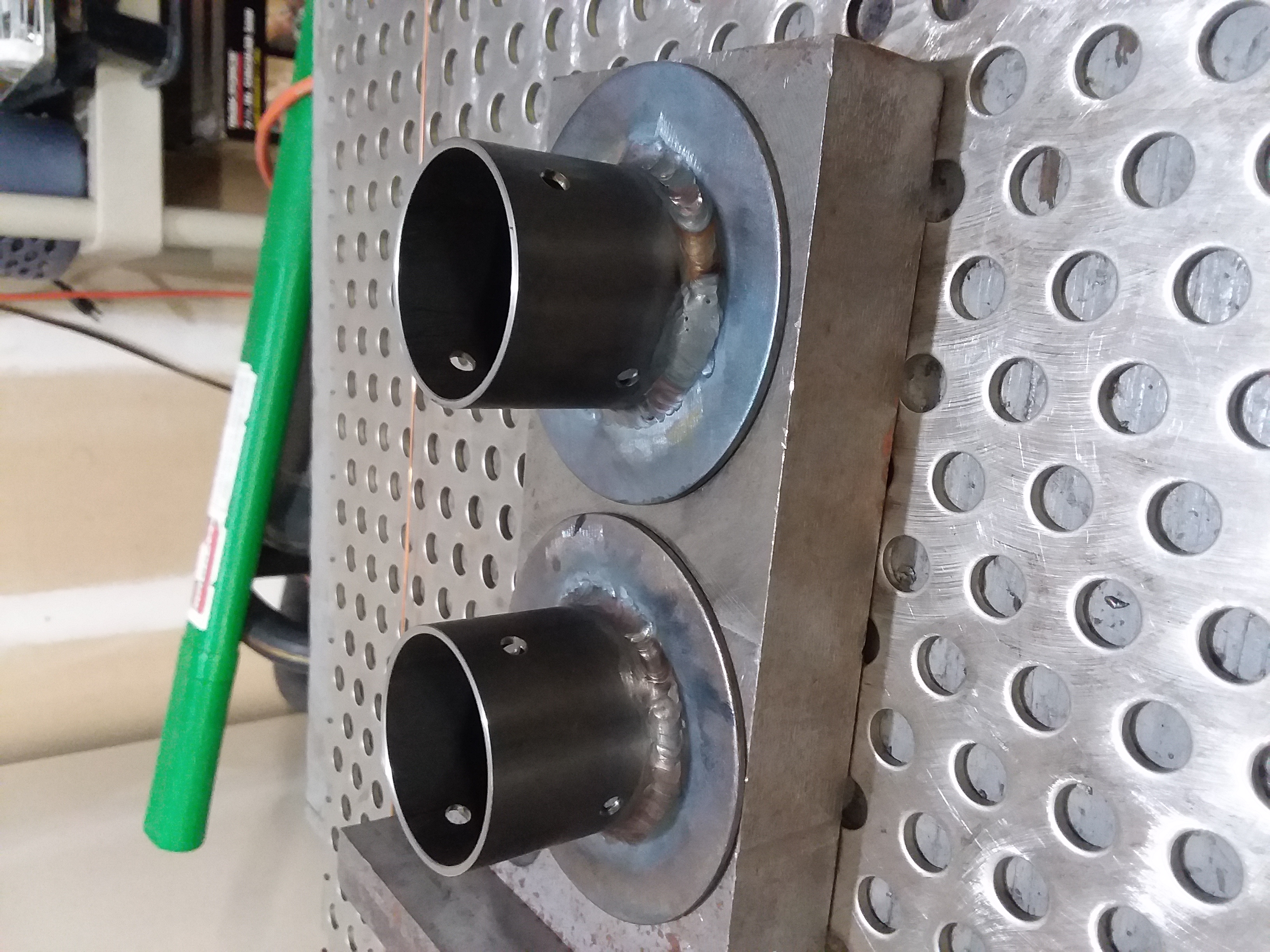

I've cut out all the pieces for the actuators foot pedals. I also have hooked up my tig welder. So...., after I get some practice welds in I'll try assembling the pieces. Wish me luck.

I was going to post pictures of the brake pedals, but I just realized I didn't take pictures of them. So here is a photo of the adaptors for the brake torque plates. They will bolt over the trimmed 1-1/2" axles and the 1-1/4" axles will slide inside.
Posts: 371
Re: Brake master cylinder mountings
Torque plates for the Piets new brakes.
Posts: 371
Pictures of the brake pedals and the finished axles for the Matco wheels and brakes. I will drill the axle attach bolt holes when in place.
