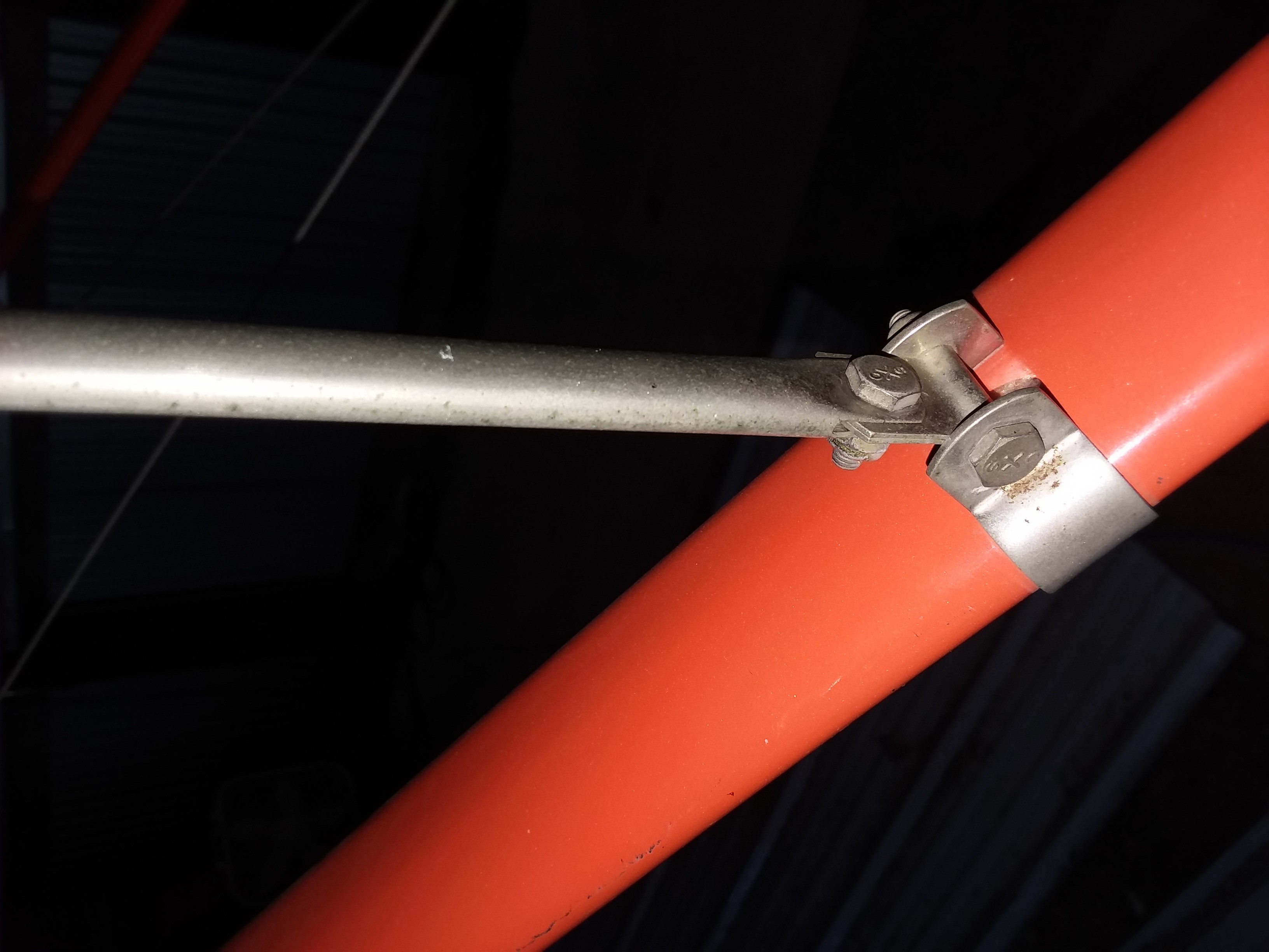

N34KP's jury struts are 3/8" x 9/16" steel streamlined tubes. I don't know where Ken found them. He told me once he'd bought them 20 years, or so, ago when he was buying stuff for his Great Lakes project.
A.E.D. metal products have odd size and small streamlined tubes in different materials.
