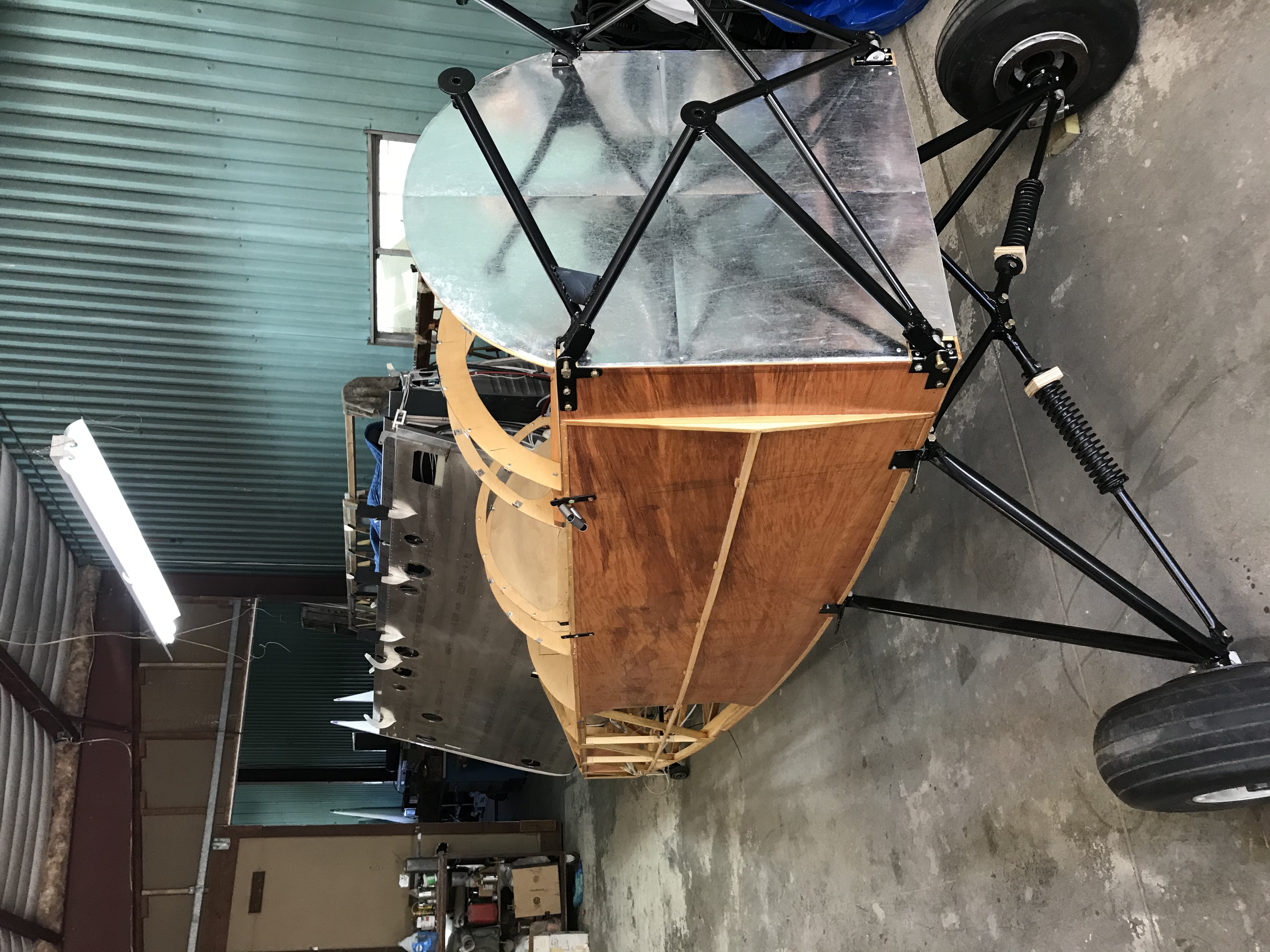

adding pics of current build. this will be cont powered, long fuse, cowings are also complete.

cont engine mount tac weld fixture.

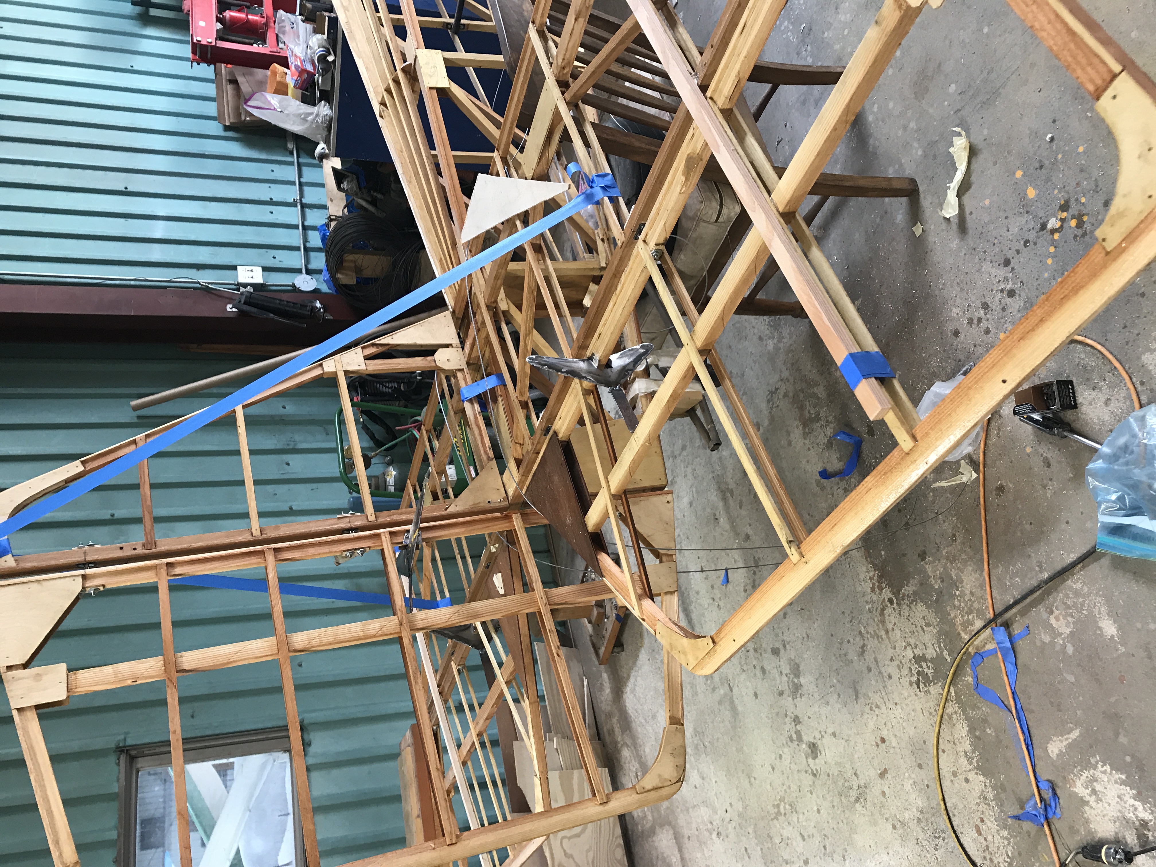

Re: status of current build

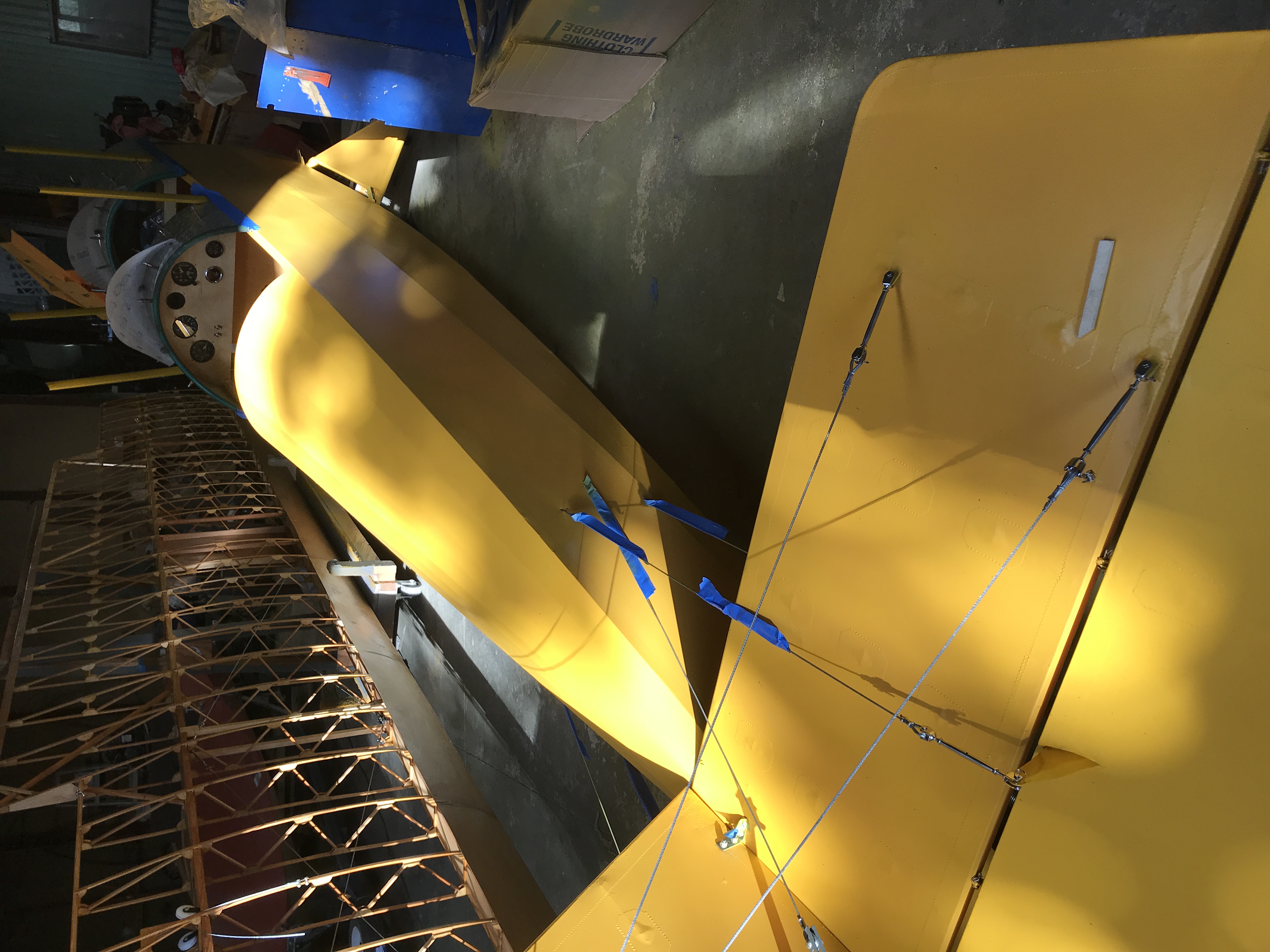

Dan,
Beautiful work, and beautiful work,a ship!
What is the angled blue steel strap at the rear end of the plywood on the S’board side of the fuselage?
SEVENTH BUILD!
At some point I think you can no longer call it amateur built ha ha.
Could we get a photo montage of your life's work?
Tom, the blue fitting is just a U shaped strap for attaching a seat belt to.
Also, I was asked in a PM about the cable clamps on the center section cross bracing. These are temporary hardware store clamps, the airworthy versions will be swaged.

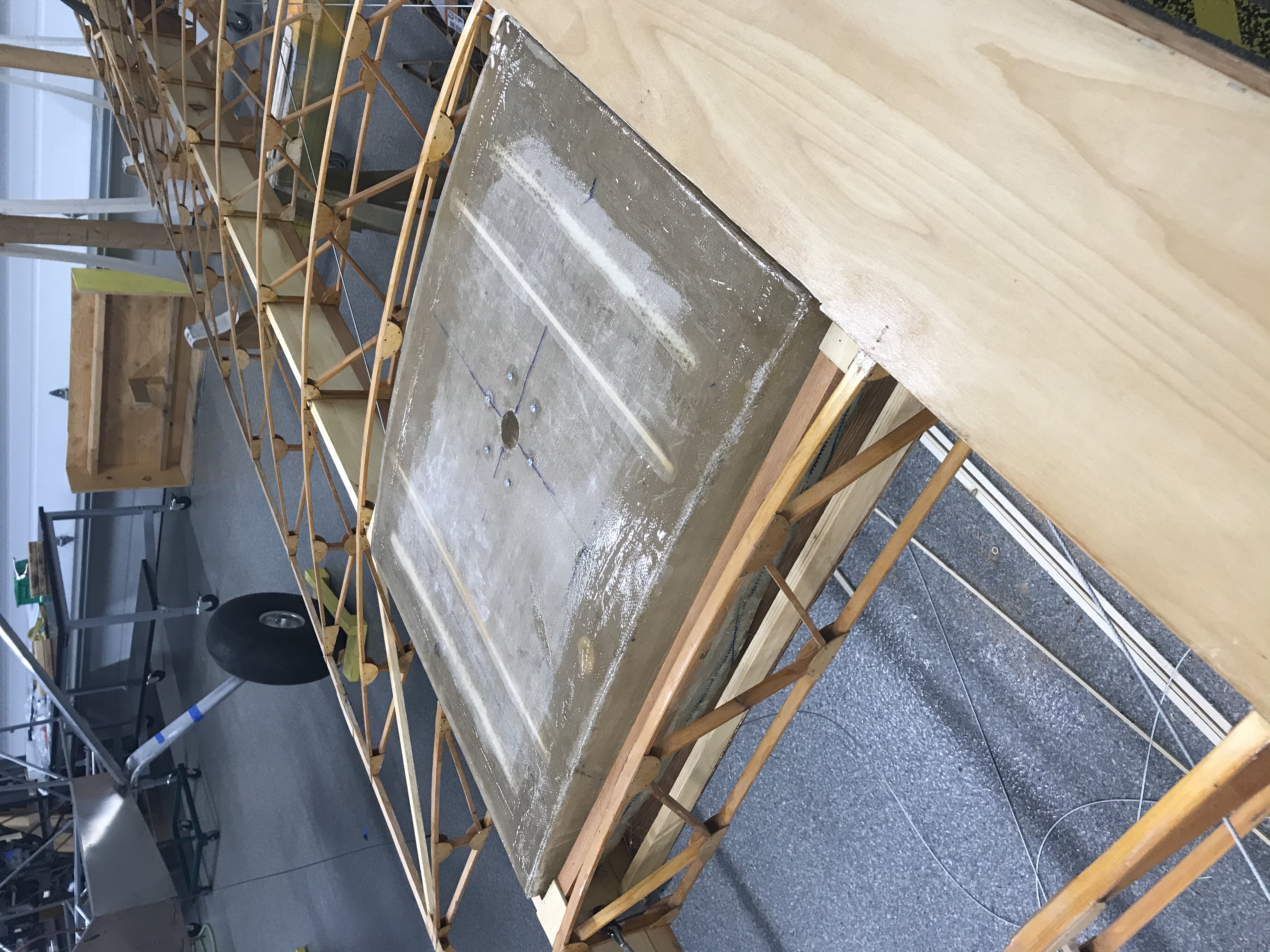

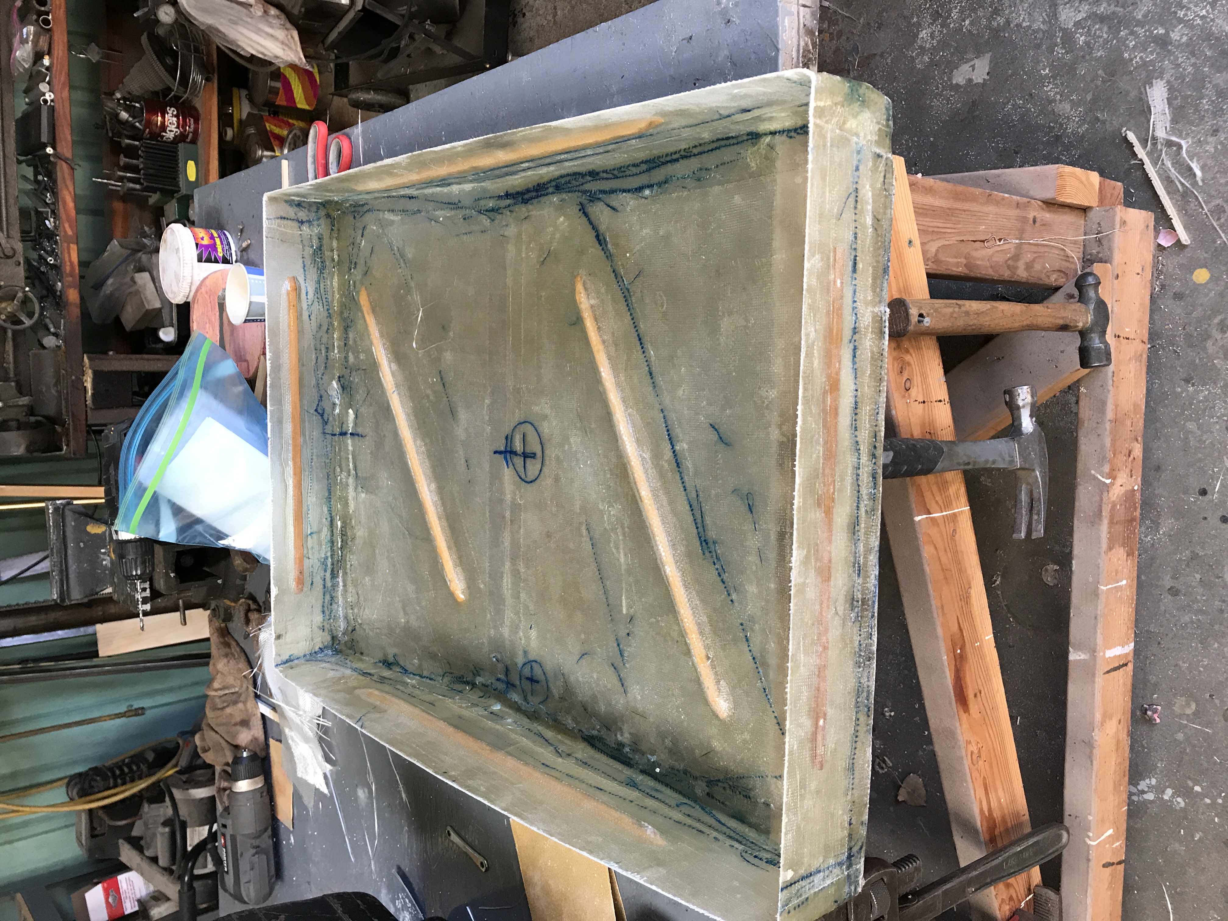

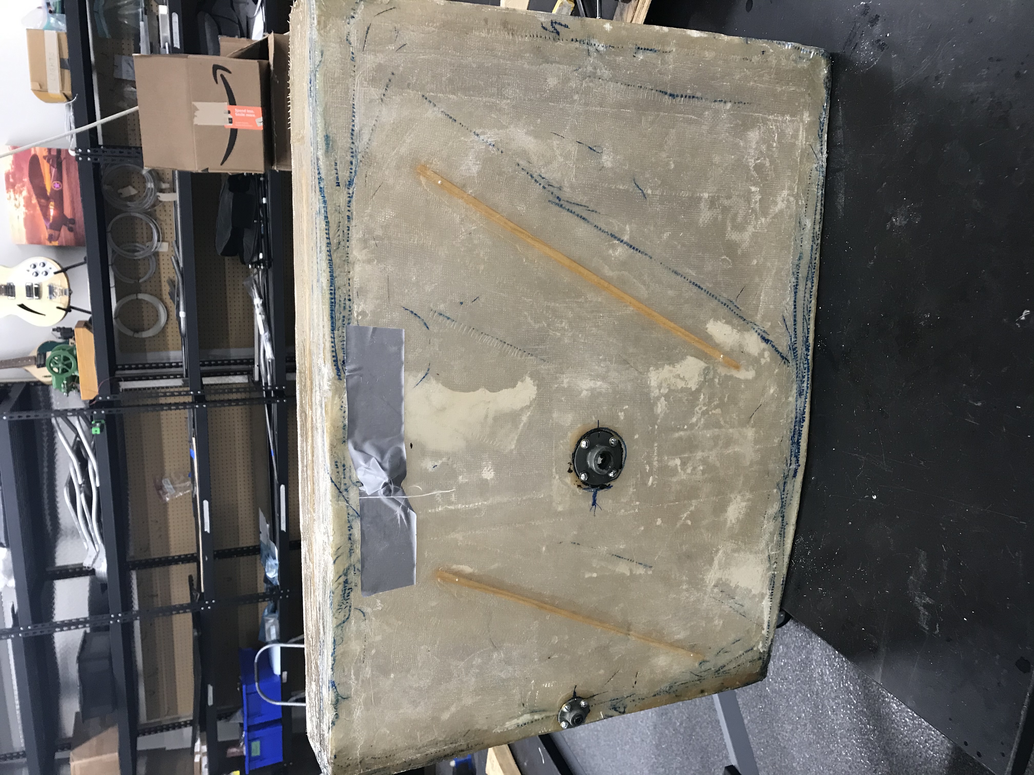

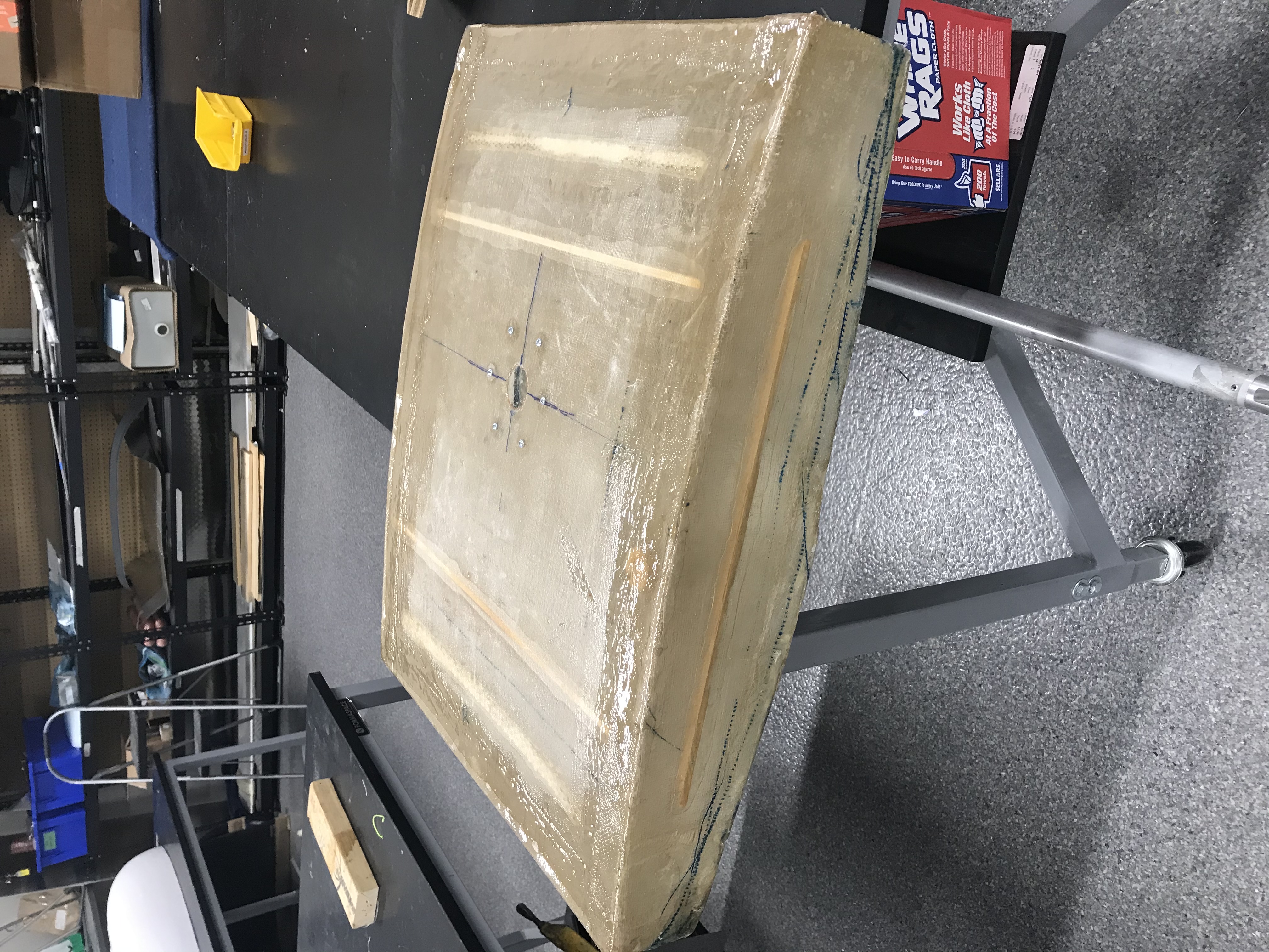

fuel tank complete and ready for filler neck. tank has stesrman type fuel gage.
Which epoxy resin did you use on the fuel tank? Do you plan to run auto gas?
Air Camper NX41CC, A75 power, avgas
- Posts: 46
polyester resin; non-alcohol fuels. i have built a few tanks like this with great results.
OK. It's the alcohol blended autofuels that can cause problems. Sounds like you're all over it!

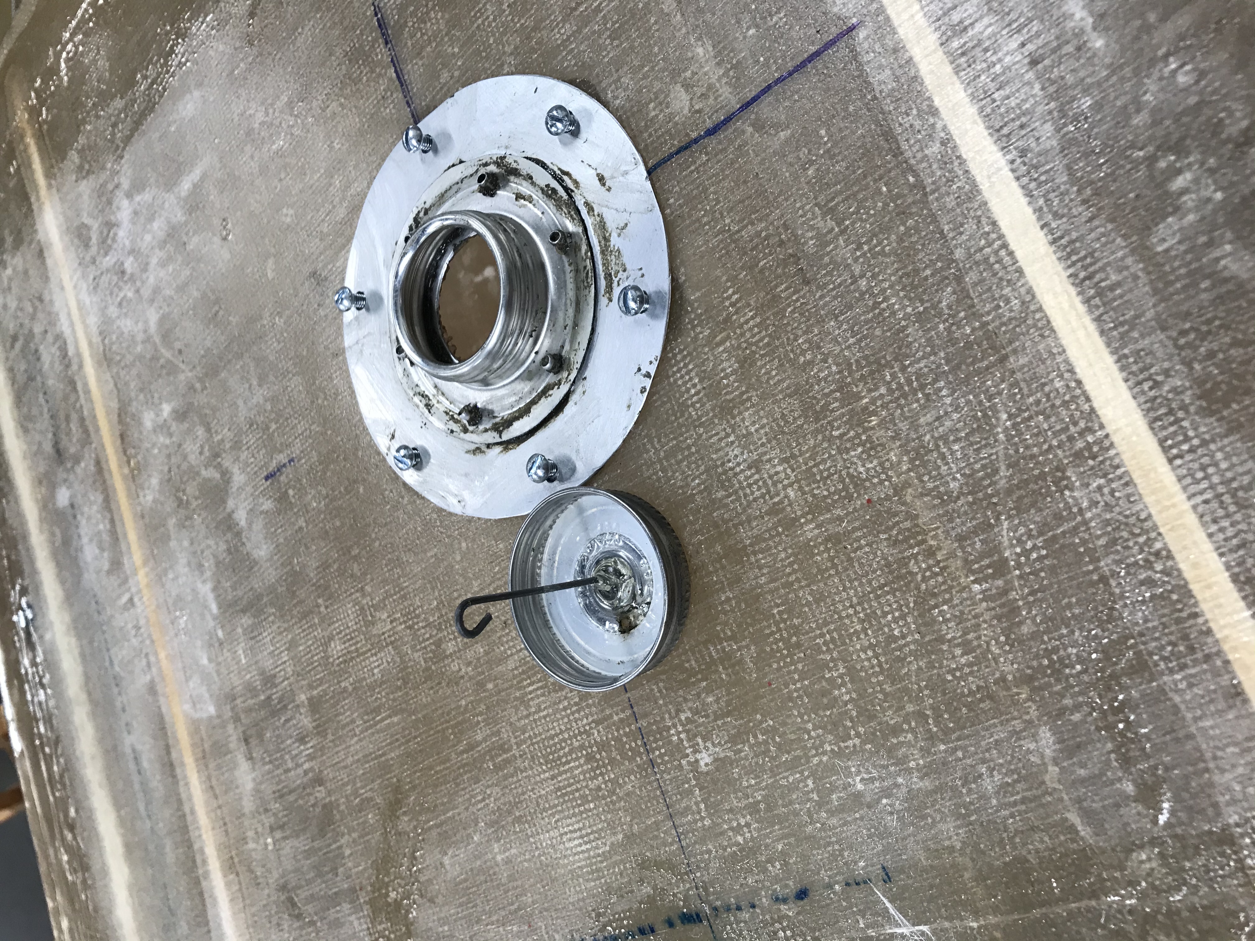

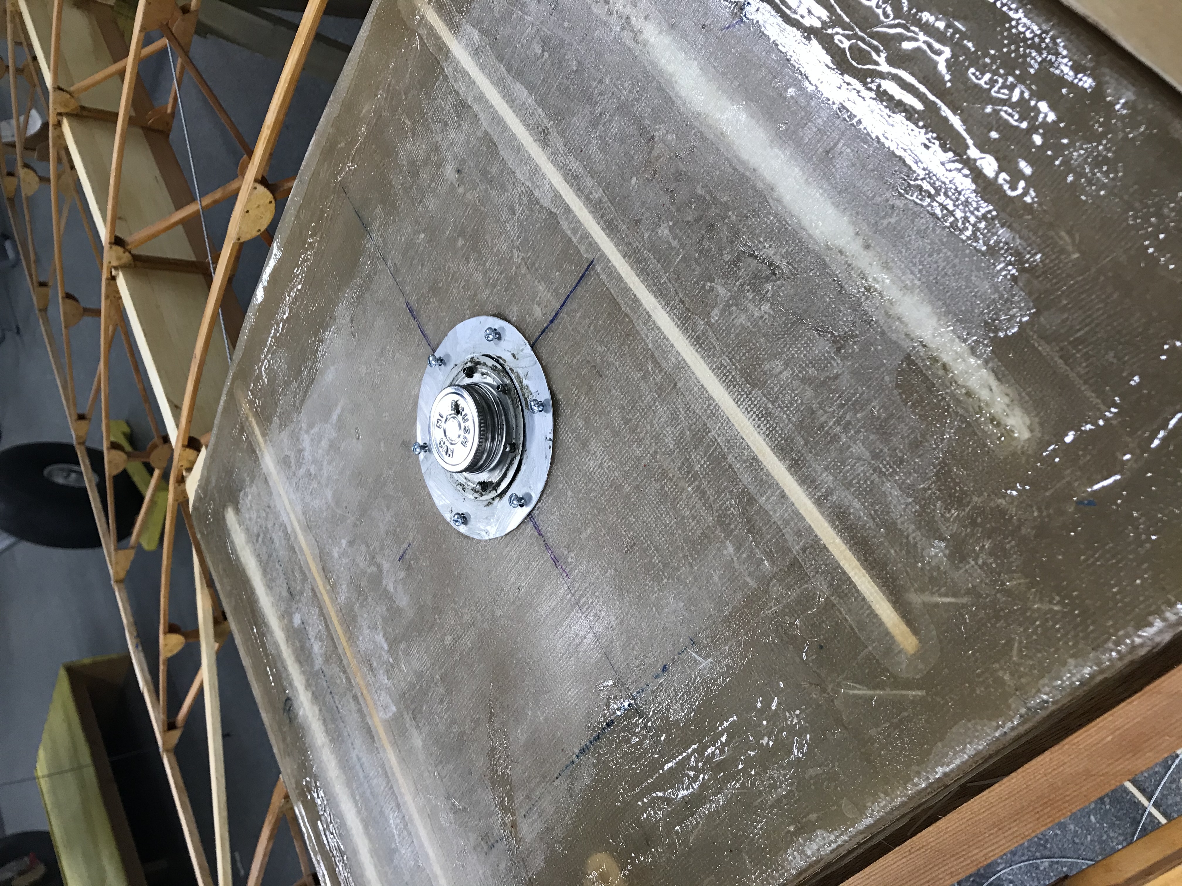

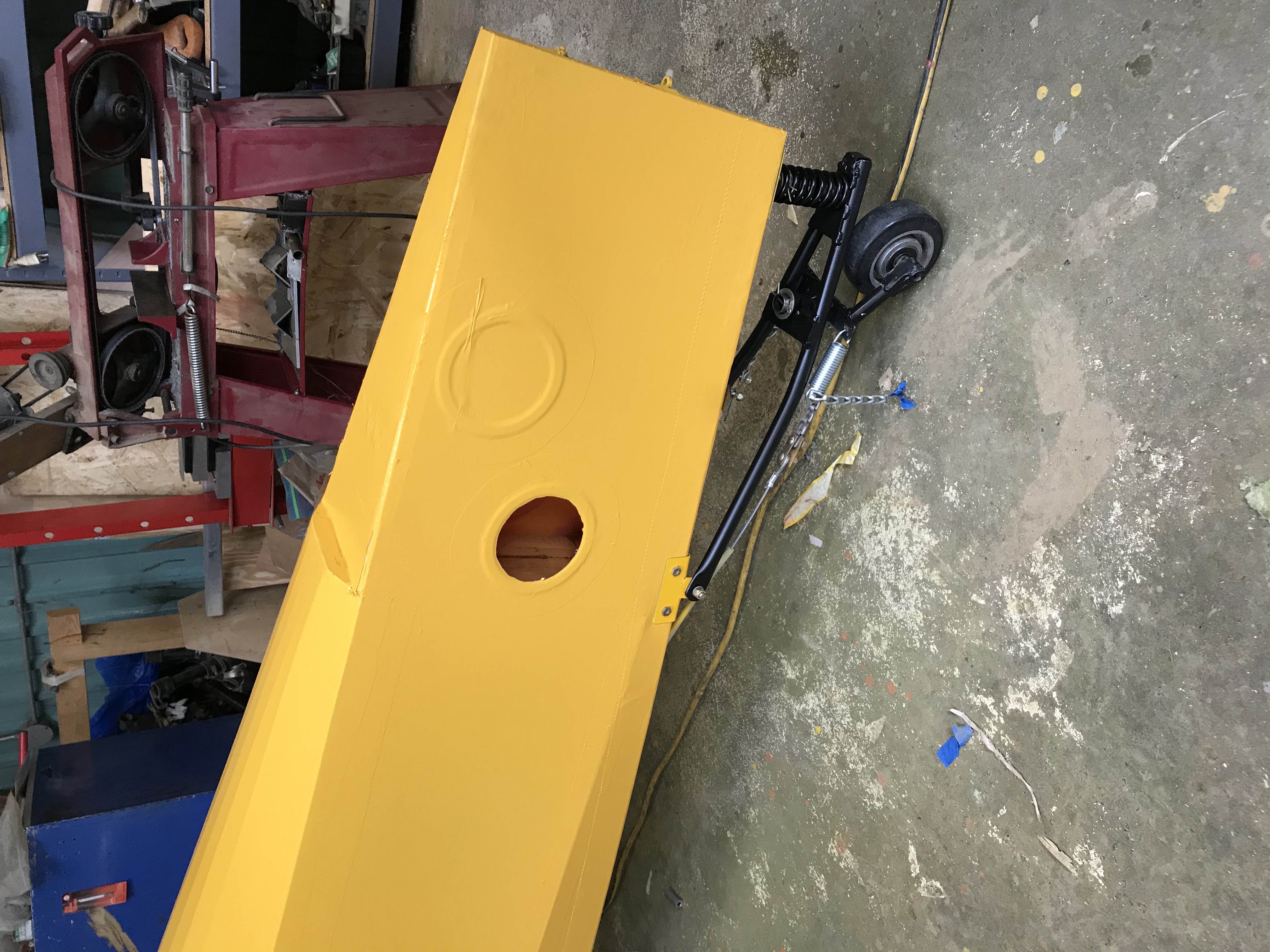

used top from a dried can of pvc glue for filler neck and cap. plywood template is the master tool for all the top division work

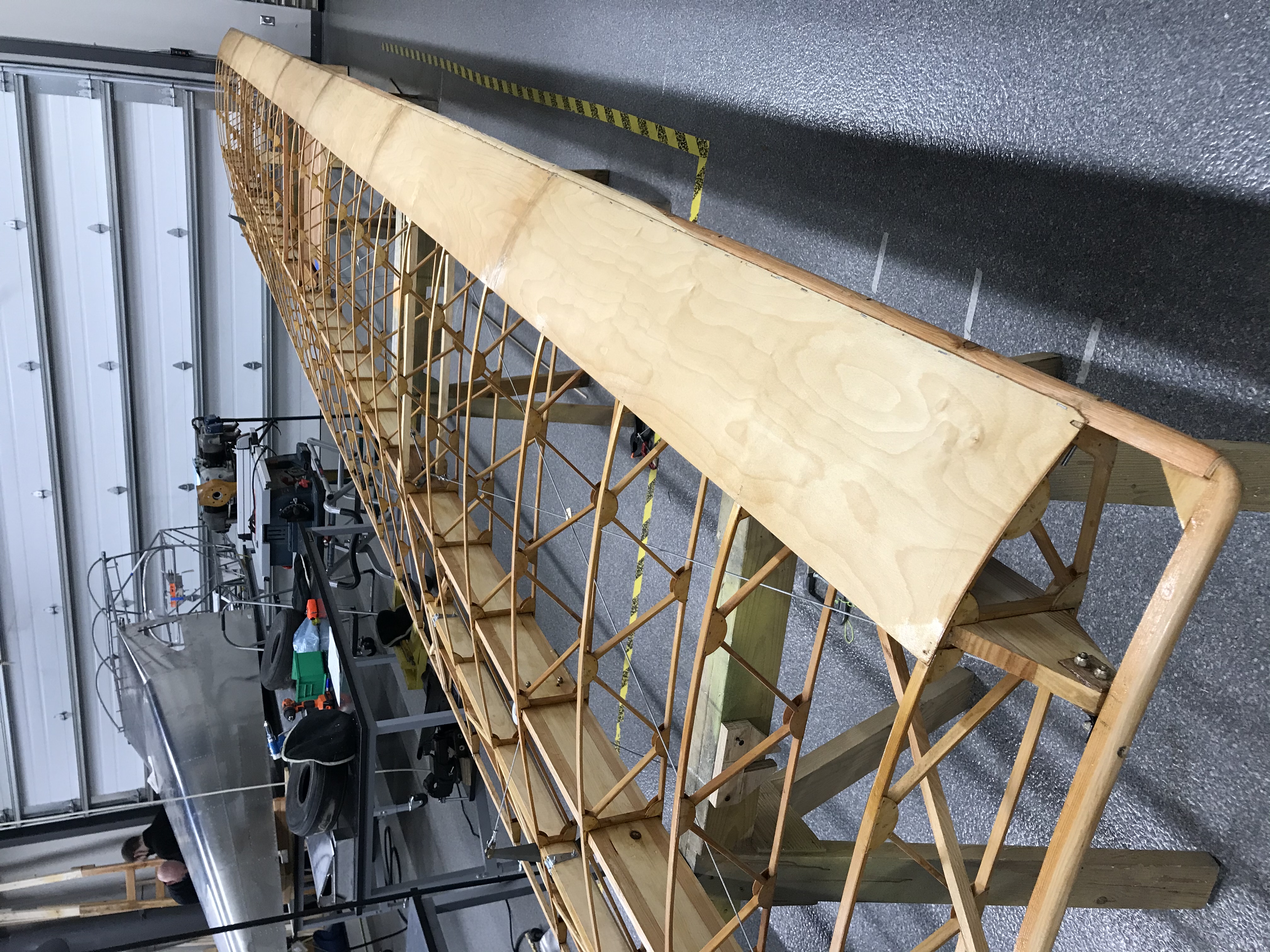

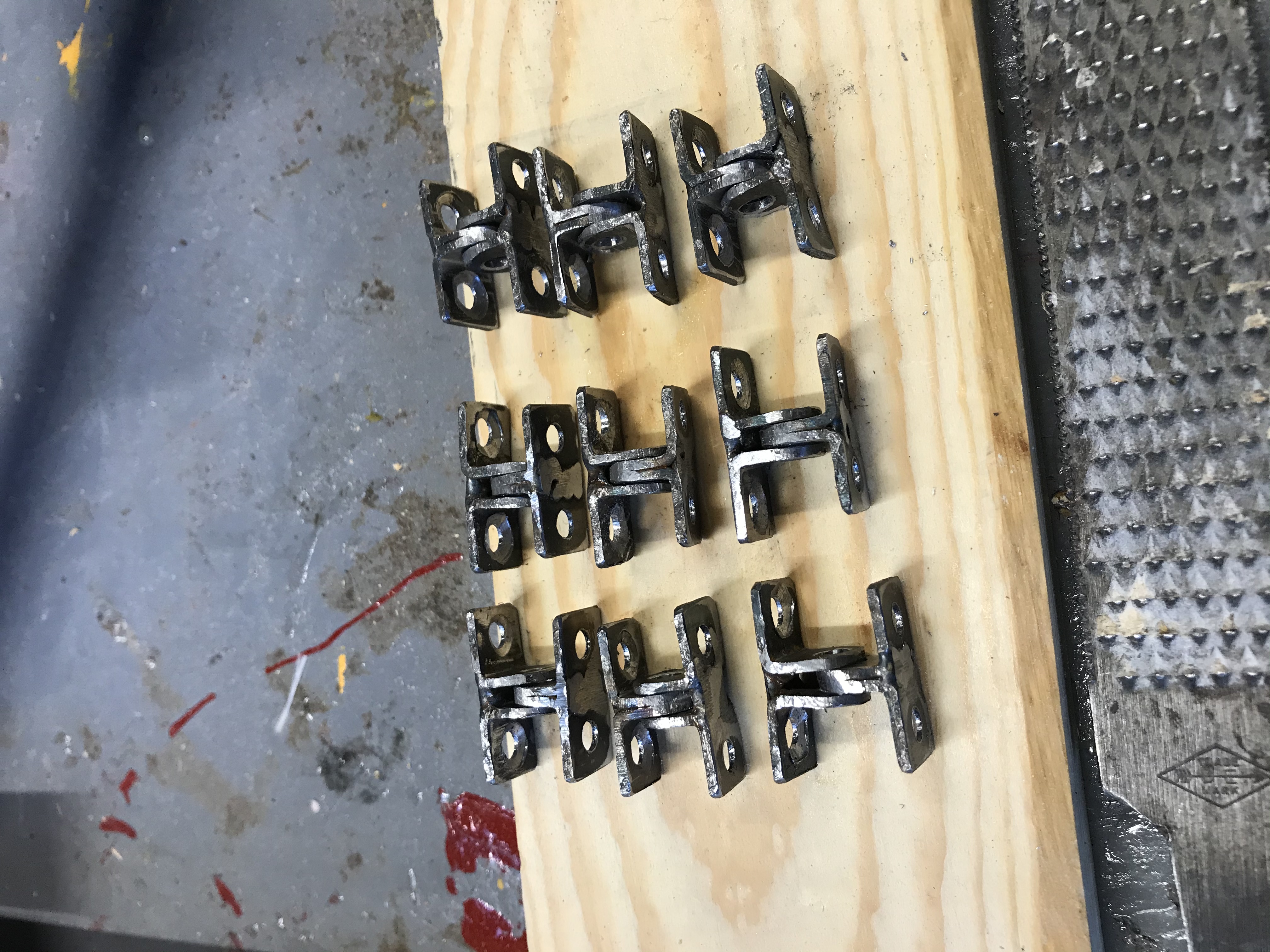

these are the hardest parts to make on the entire airplane; but got them done
These are beautiful builds. It's almost a shame that we have to cover them to make them fly.

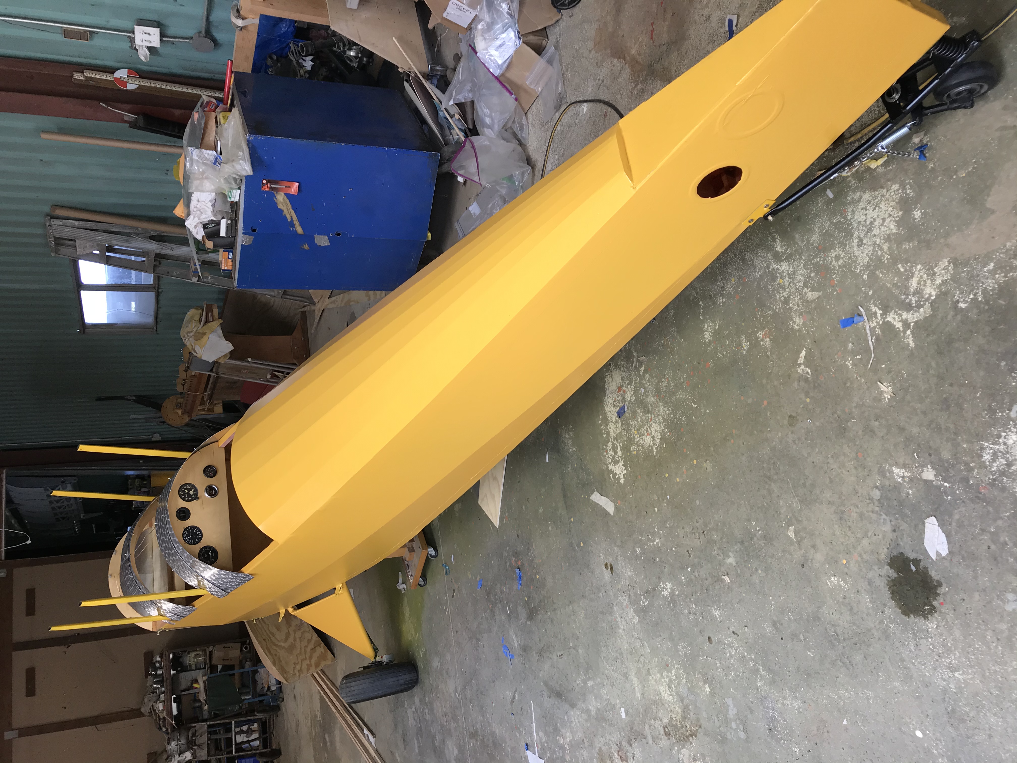

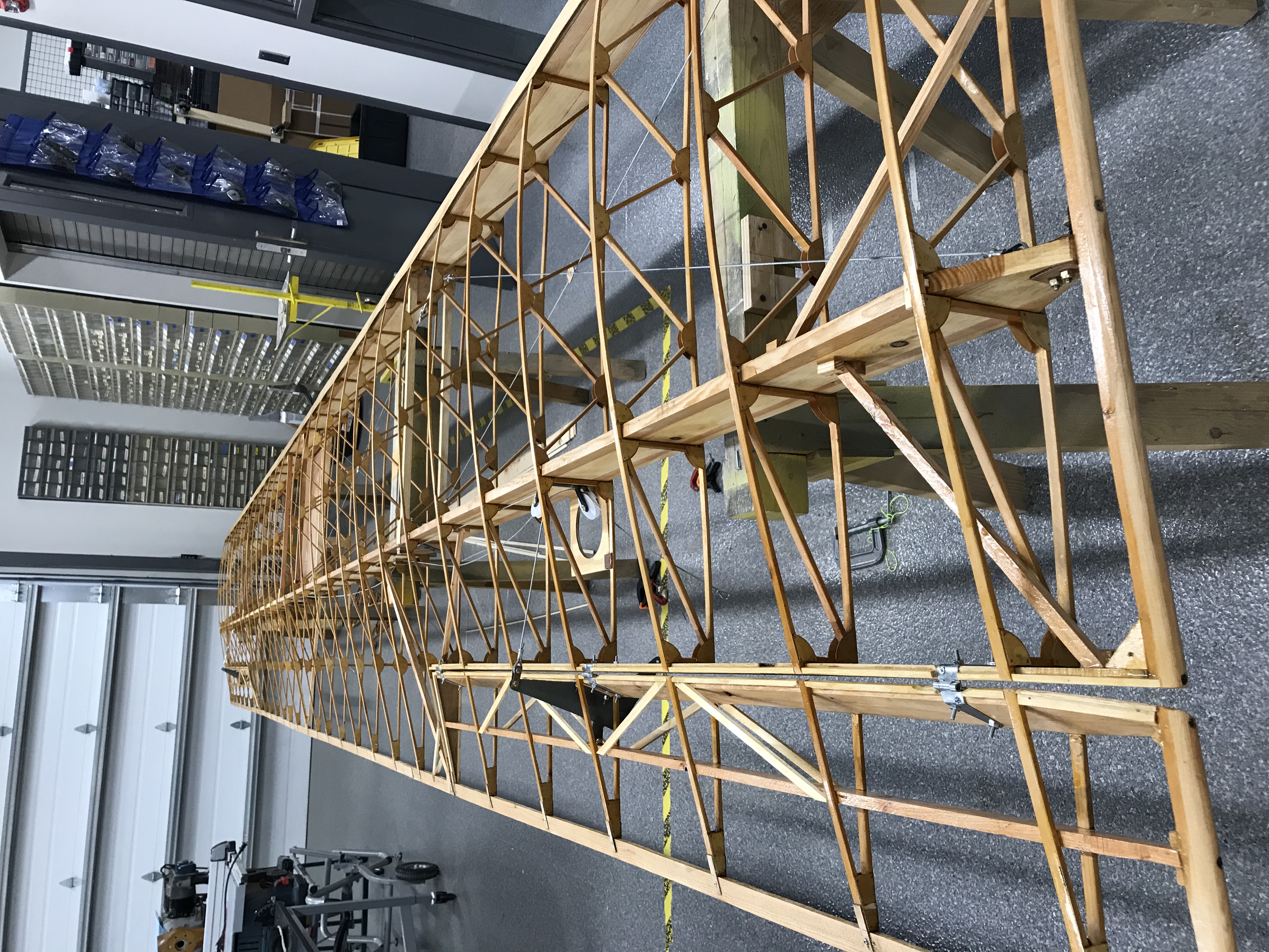

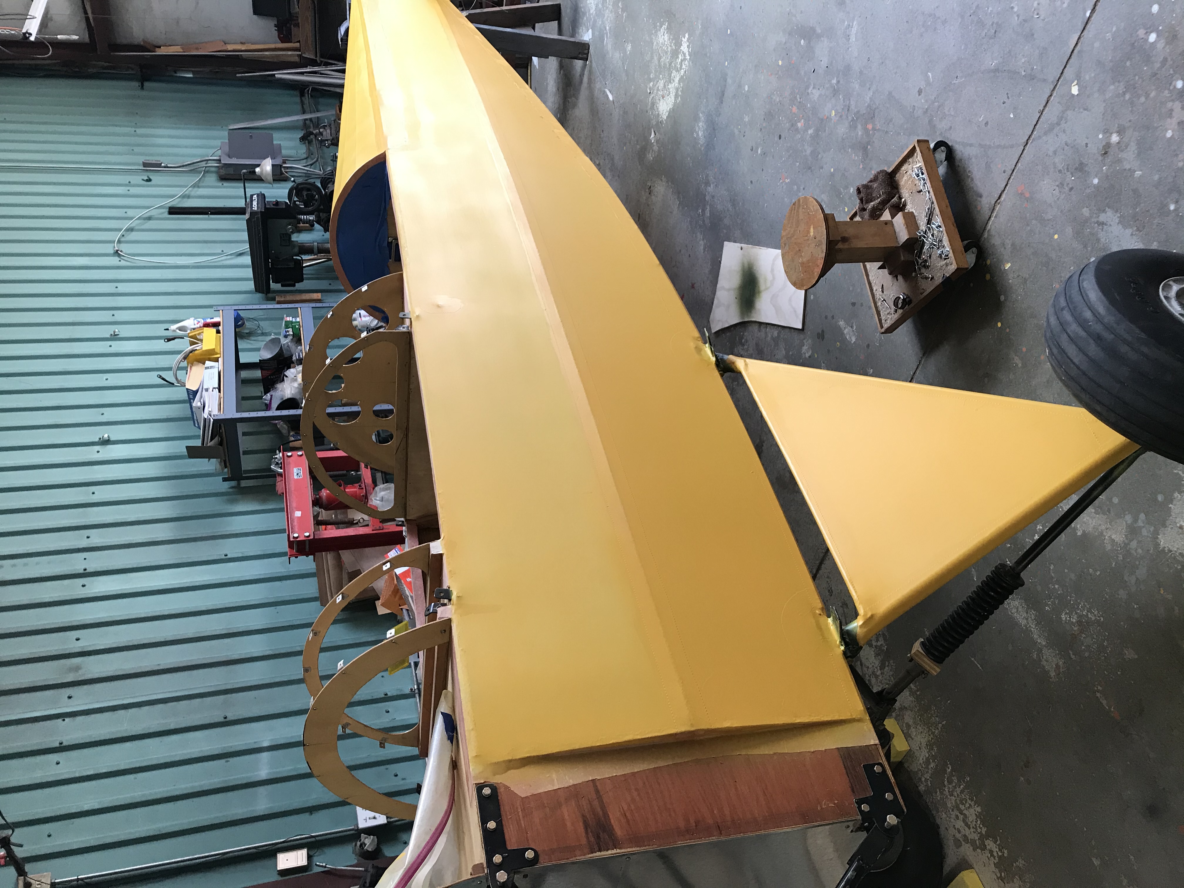

completed tail feather fitting and rigging today. it was a productive day.

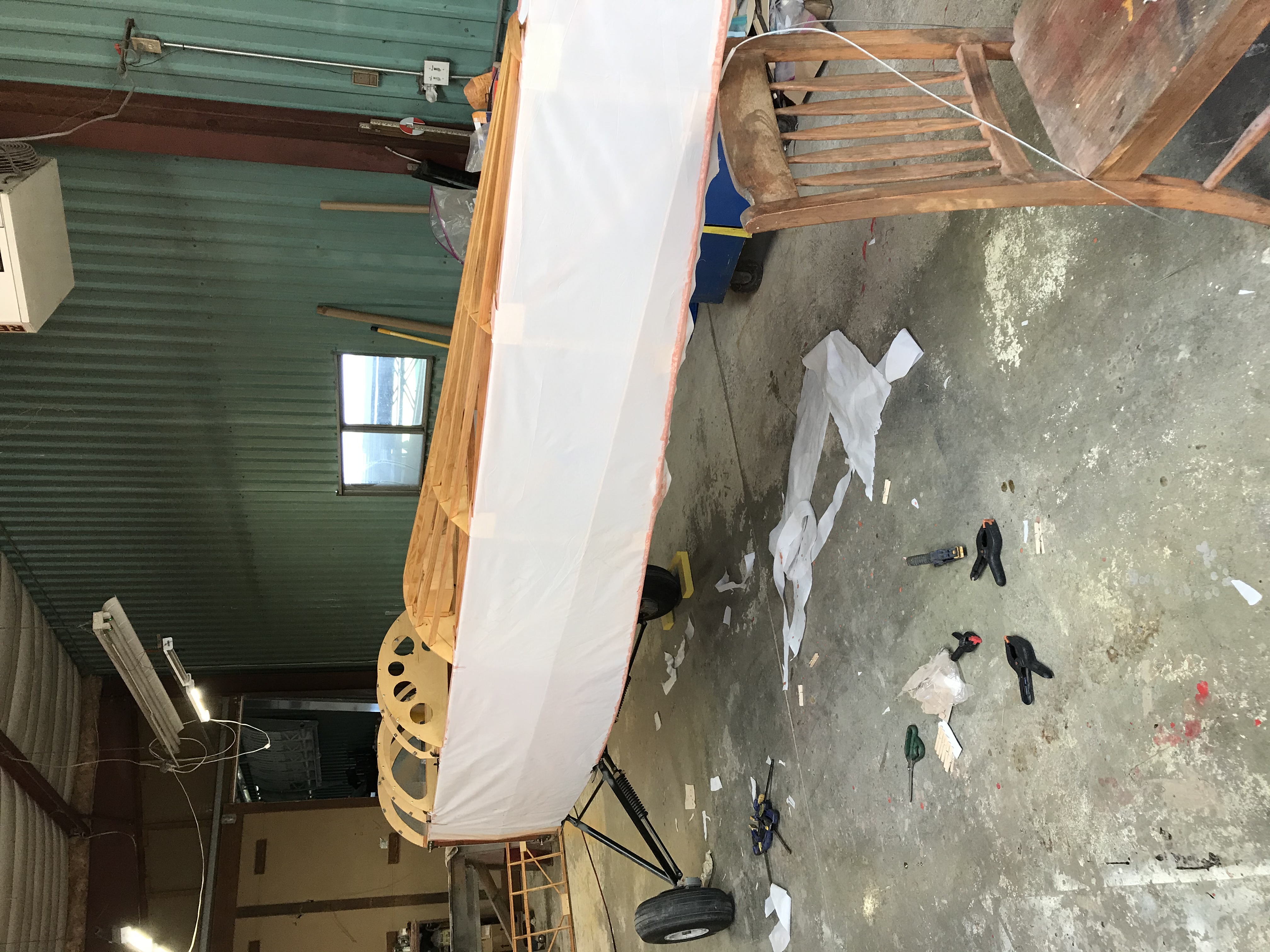

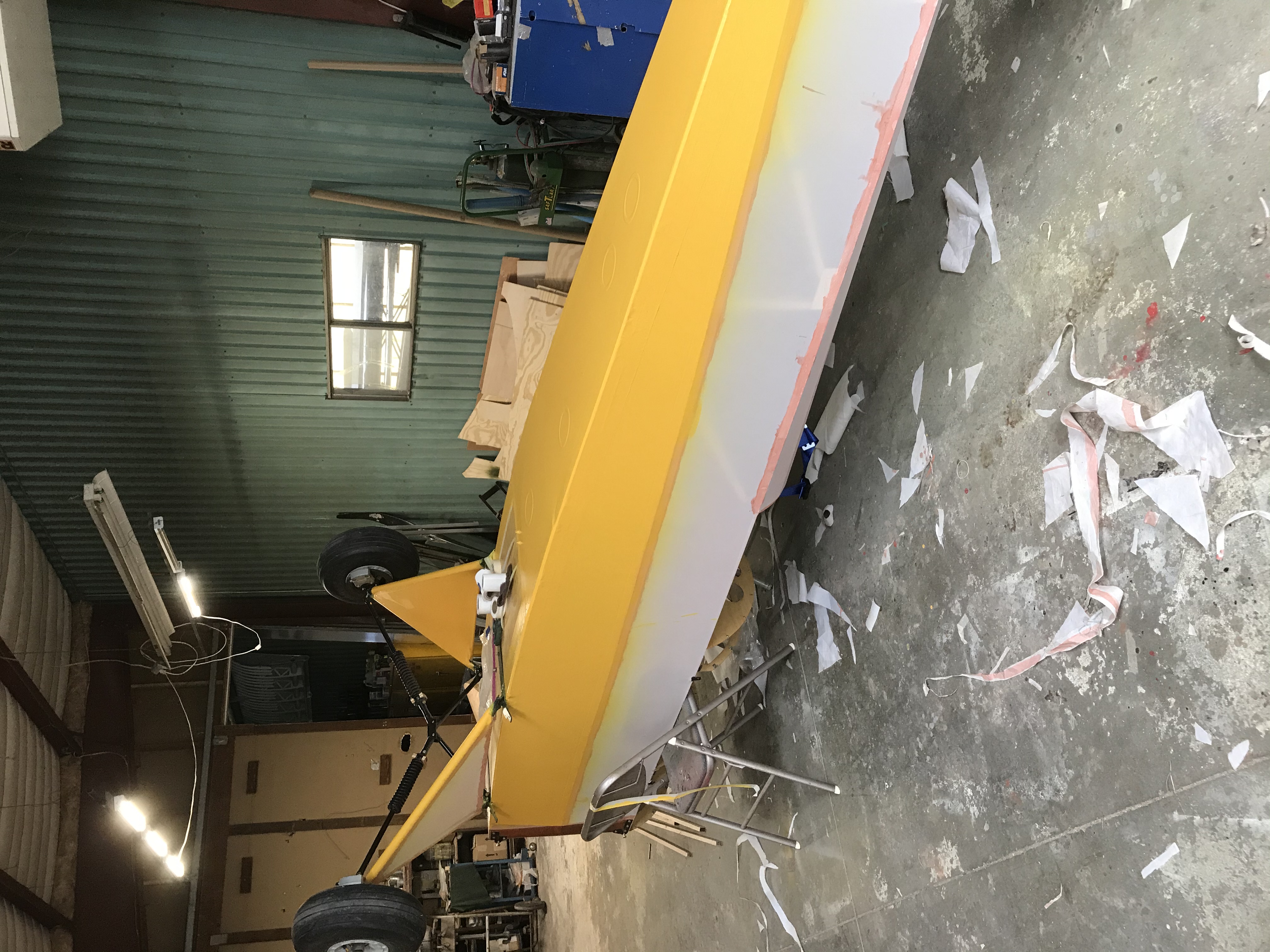

Congratulations!! It's a great feeling to be at the covering stage. Suddenly the light at the end of the tunnel seems much brighter.
- Posts: 46
all true! its a fun build!
- Posts: 46

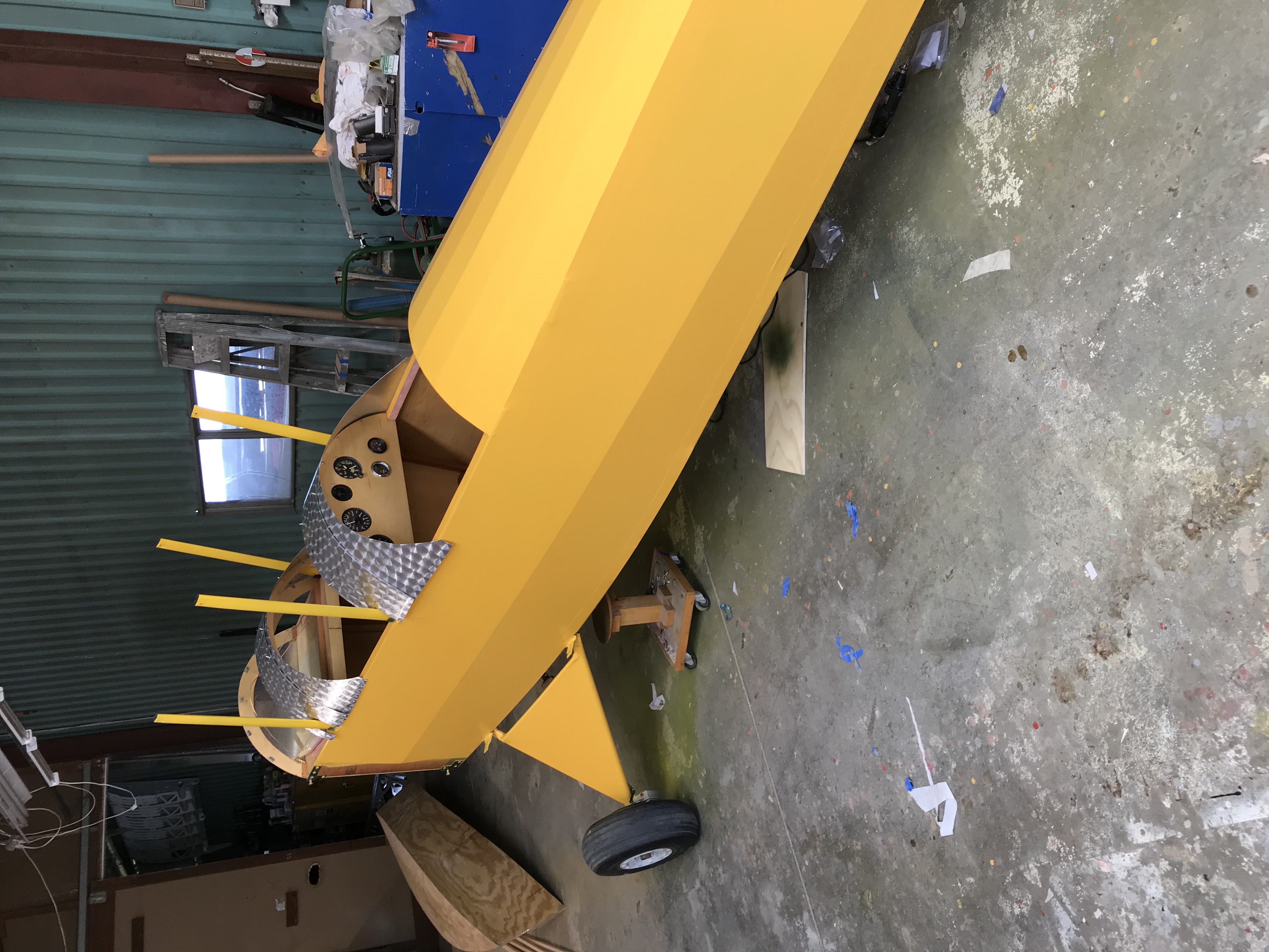

Careful... I see you've got that plane inverted. Note that the Air Camper is Normal category and only good for negative 1.52 G ;o)
-Oscar Z.
-Oscar Z.
- Posts: 46
sure is easier to cover the bottom upside down though

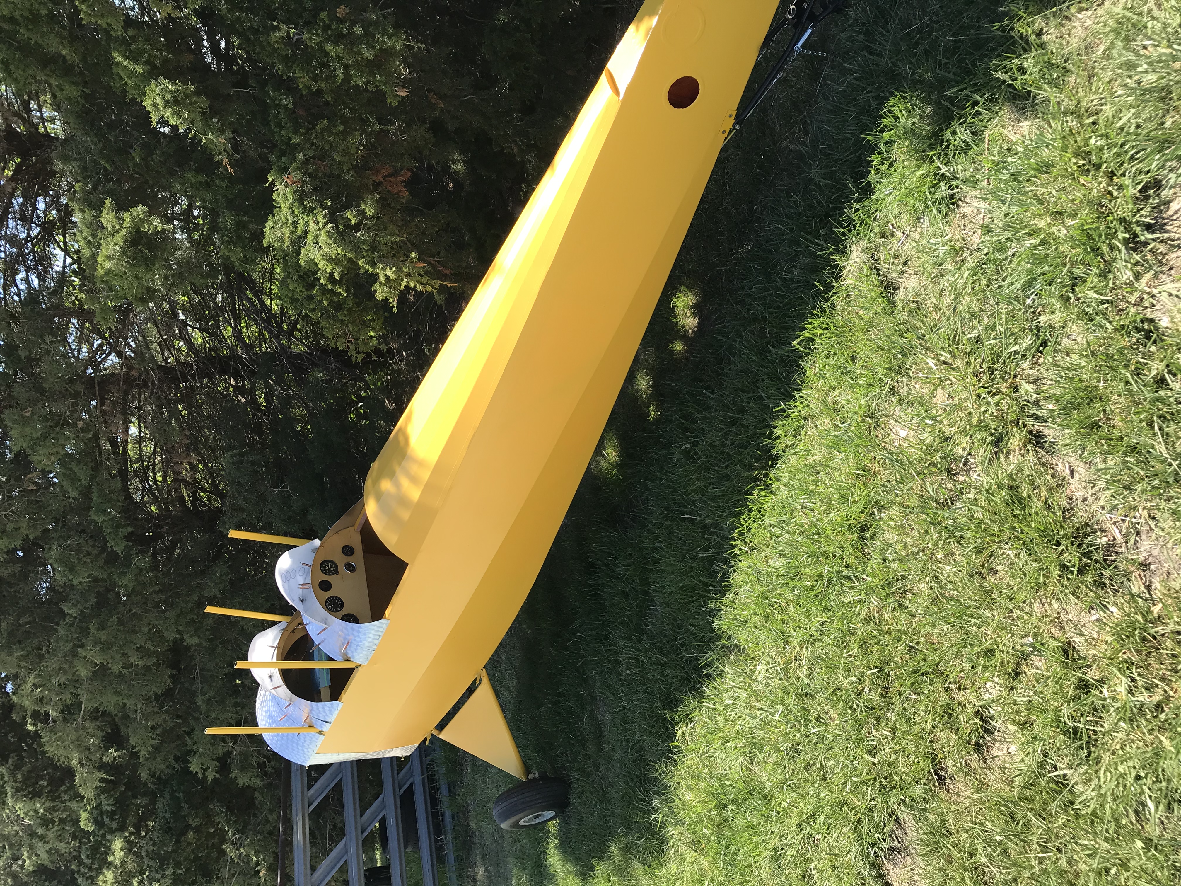

I think one of my former employers bought avionics from the same place you did! (The local photocopy-shop.)doug bryant wrote: ↑Sat Feb 13, 2021 7:56 pm very nice work!! can't wait to see it flying. this one i am building is my 7th. i still need to build some of the tail feathers.

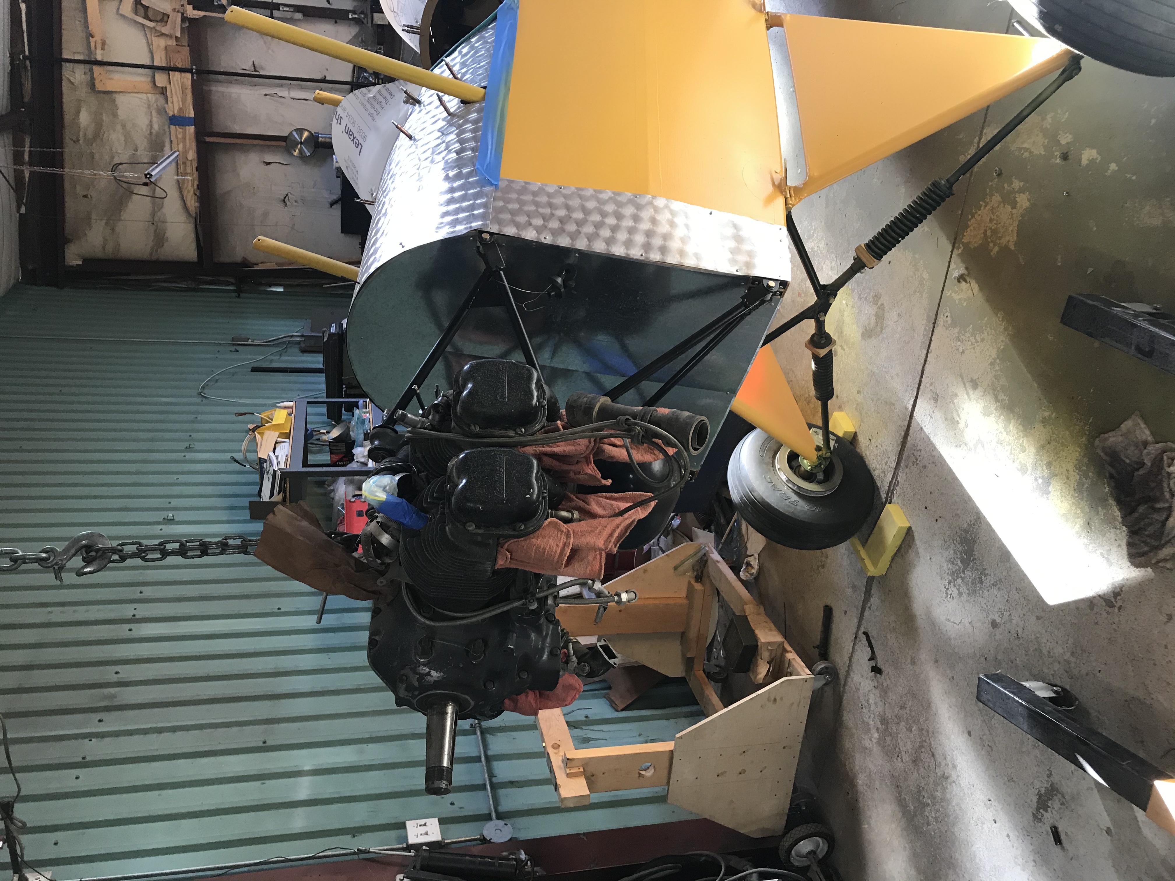

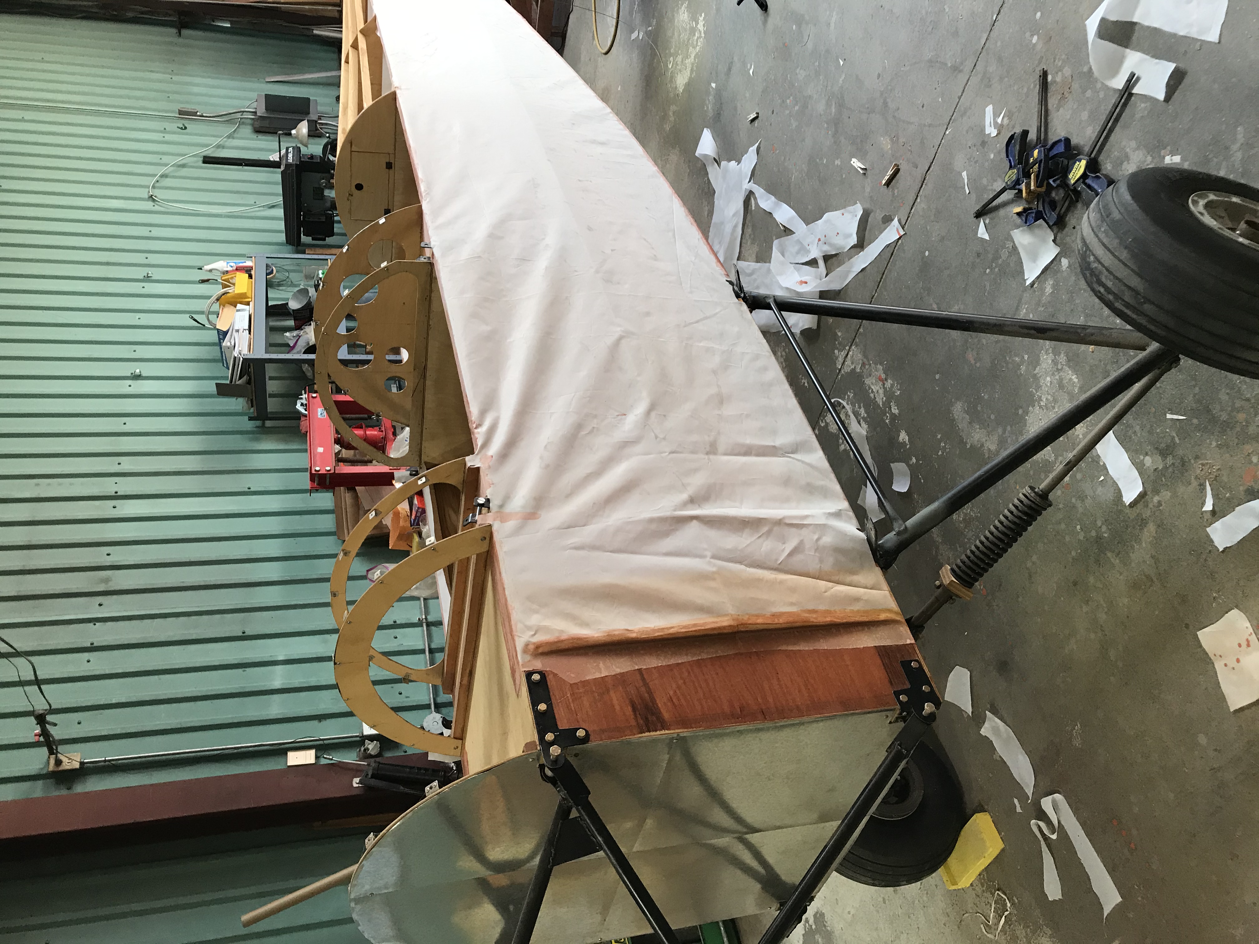

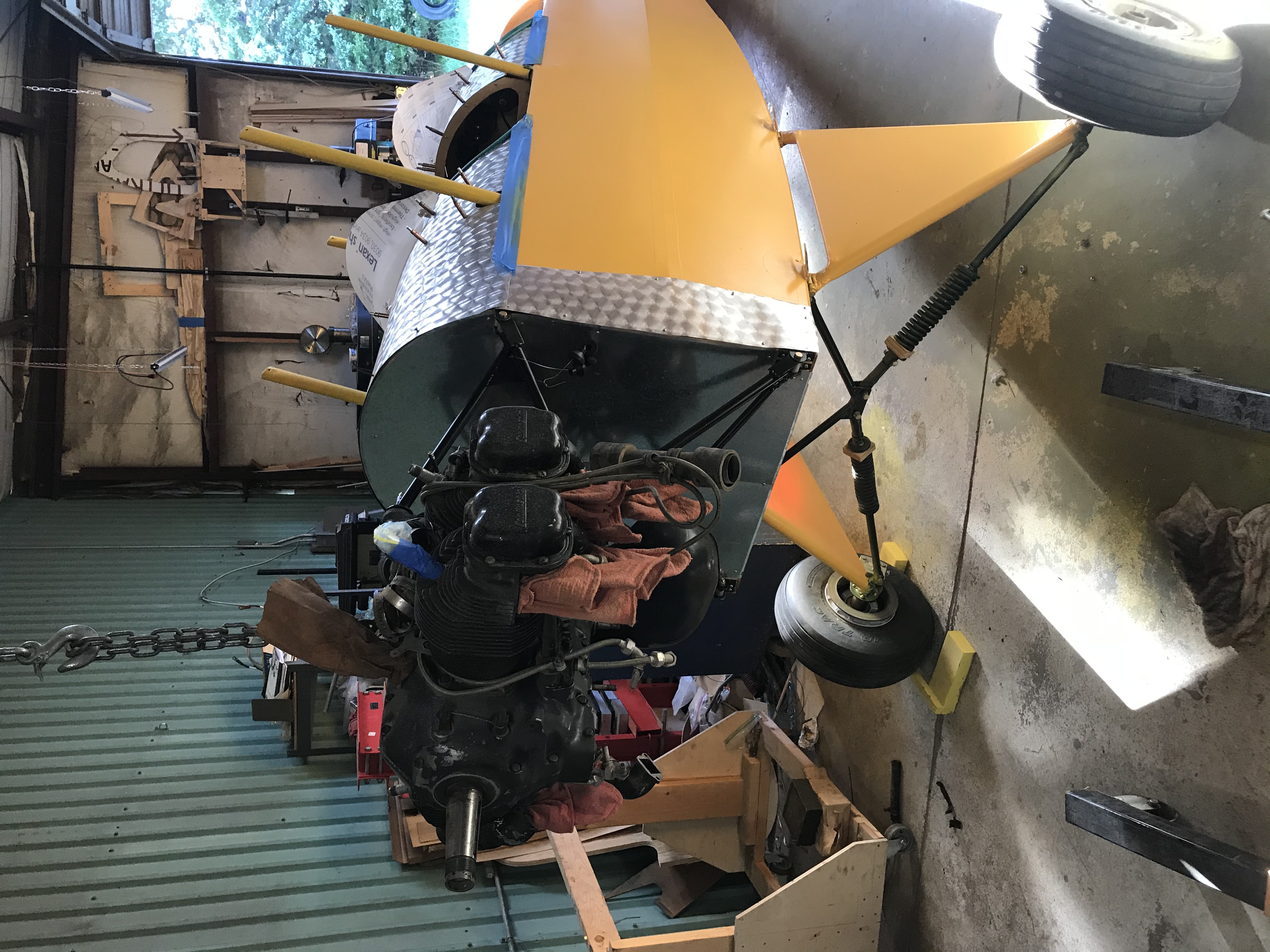

completed more on engine, covered ailerons, wing ready for cover.
