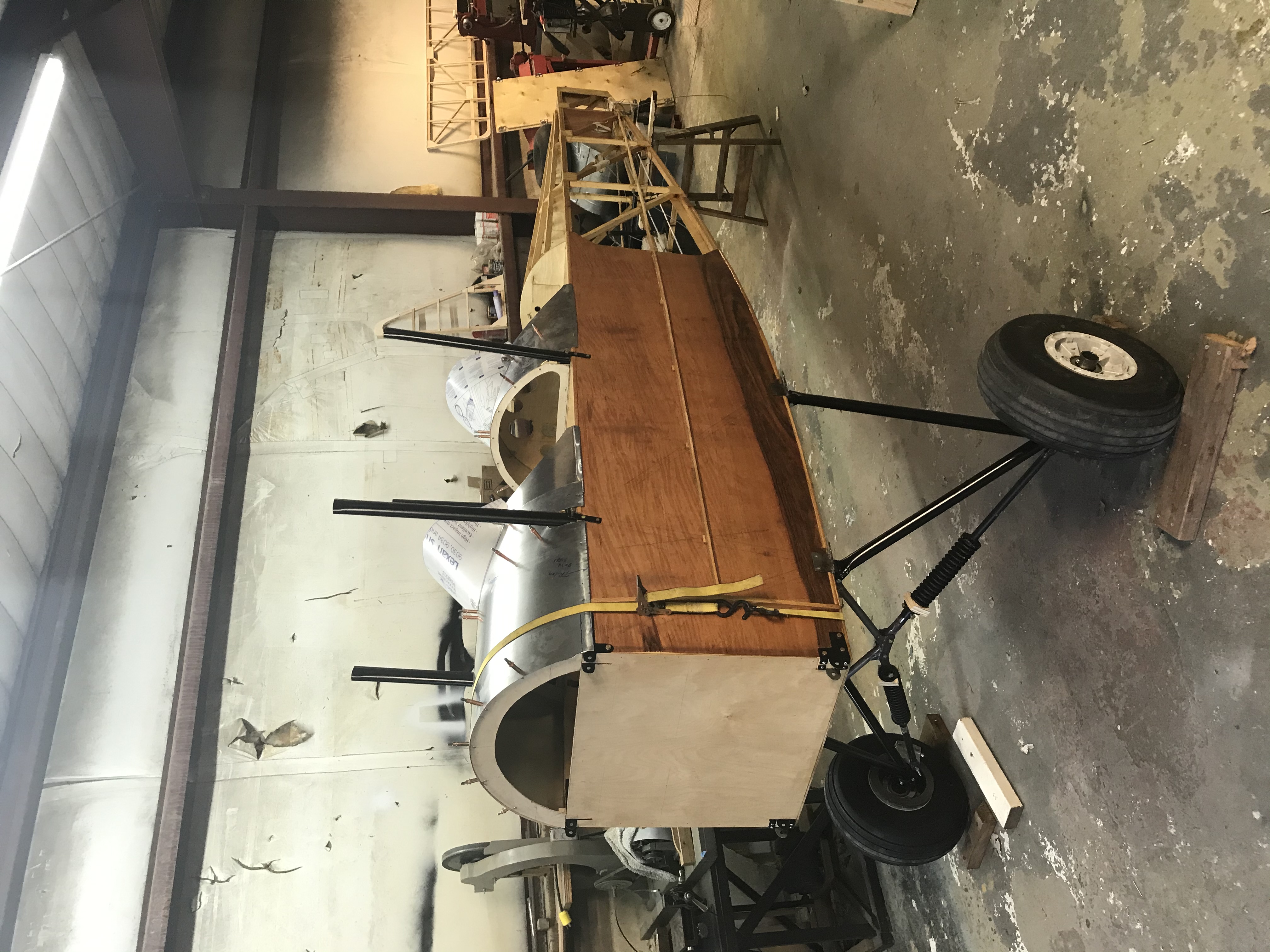

adding pics of current build. this will be cont powered, long fuse, cowings are also complete.

Dan,
Beautiful work, and beautiful work,a ship!
What is the angled blue steel strap at the rear end of the plywood on the S’board side of the fuselage?

Tom, the blue fitting is just a U shaped strap for attaching a seat belt to.
Also, I was asked in a PM about the cable clamps on the center section cross bracing. These are temporary hardware store clamps, the airworthy versions will be swaged.
