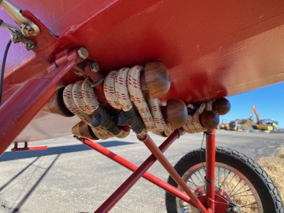

Here's what I found when I checked the invoice for the shock cord that I bought when I installed the split axle gear on my Piet. The invoice from Aircraft Spruce shows "06-12600 TYPE I 5/8" SHOCK CORD." I bought 24 feet. I'm sure that was too much, but I tend to prefer to have a bit too much than have to order more because I bought too little. I made four shock cord rings by whipping the ends together with safety wire.
Somewhere I have some pics and a description if you are interested.

Thanks Ken! I'll check that. I like the spring in a can set-up (like WW shows on his site), but I need plans, so sticking to sheet 3 and that means bungees. Photos are always helpful as are explanations of the work. My project is here: https://imageevent.com/hatz/piet

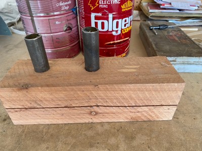

The spring in a can has become popular in recent years. I'm not sure why. It's heavy. It's nearly impossible to tune to get the right amount of tension (technically compression). And it seems like a great place for corrosion to develop without a good way to know. The original design by Mr. Pietenpol is pretty straightforward, light, looks period, and simple to maintain long-term.
[I'm copying here something I posted on the facebook site not too long ago]. If you stick to the plans, you can make shock rings yourself by whipping the ends of a section of bungee with safety wire. This may take some experimentation to get the ring to the size you need. Then, assuming the horizontal tubes on the telescoping gear tubes are built according to the plans, the rest is straightforward. Drill a block of wood with a couple short sections of tubes the same distance apart as the horizontal pieces of the telescoping gear tubes. You'll want tubes with I.D. that is just barely larger than the horizontal pieces of the telescoping gear tube. Chock that block into your bench vise, take a long piece of scrap tubing to use to gain leverage to stretch the homemade shock ring over the short sections of tubing. When everything is nice and tight, slide the horizontal pieces just inside the short tubes in the block of wood and skootch the bungee onto the telescoping gear legs. When the shock ring is in place, Insert the wooden plugs called out in the plans into the horizontal tube of the telescoping gear tube and secure with a set screws Do that four times, and your done. Takes about an hour to make the shock rings and another hour to wrap them on the telescoping tubes.

Awesome Ken! The photo of the gear sure helps. As long as sheet three is accurate, there's a descent chance I can build it. With the one telescoping pole crossing the other, do I need to adjust brackets or axles, or will the plans work? Thank you again.

Look very closely at the plans (i.e., before welding). You'll see that the attachment at the forward fuselage bracket for the telescoping legs is offset a bit on the left side to the right side (not the brackets themselves, but the doo dads to which the telescoping legs attach). That's what gives the legs clearance to pass by one another.
Also, I suspect that I may still have the section of the 5/8" shock cord that I didn't use in a bin somewhere in my hangar. I'll try to find that. By subtracting that length from the 24' that I bought, we'll know how much I actually used.
And one more thing while I'm thinking about the gear, you'll want to use inserts just as the plans show to cap off the horizontal tubes on the telescoping legs. I've seen that some people weld big washers there. What a pain that would be for installing and replacing the shock cords?! Done to the plans, you can do all the tightening of the shock ring hoops on a jig and slide the stretched shock cords easily into place. Then the inserts go in and are held in place with a set screw.
Good luck with this. Ken

Thank you for the photos, advice and your time writing all that. Nothing to do now but order supplies and get 'er done!
