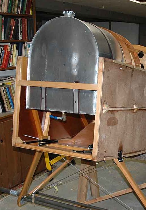

I don't know about a Cub tank but here's what the conventional front-mounted tank looks like. Mine holds about 16 gallons so you can see that with just the curved top part, you could get your 5 gallon capacity.
The Grega GN-1 was designed to use quite a few Piper parts, so looking through the GN-1 plans might provide you with information on the use of a Cub fuel tank. I have the Grega plans and can look for them if you're interested, or I can check to see if they employ a Cub tank in the first place.

On my first attempt at a fuel tank, I made one out of fiberglass ... or tried to, at least. What I learned was that I knew just enough about fiberglass to make a mess of it. It was very heavy and leaked.
On my second attempt, I made it out of cardboard and duct tape. After careful measurements, I sent the specs to Carlsons in Ohio where the main jack-of-all-trades guy welded up a tank for me. I'm not sure but it sounds like Carlsons may have closed its doors after selling its strut supplies to Wicks.
In any case, here's a couple pics. My tank has 16 gallon capacity, 14 useable. That's plenty. My butt and back are tired long before I get anywhere near the reserve level.
