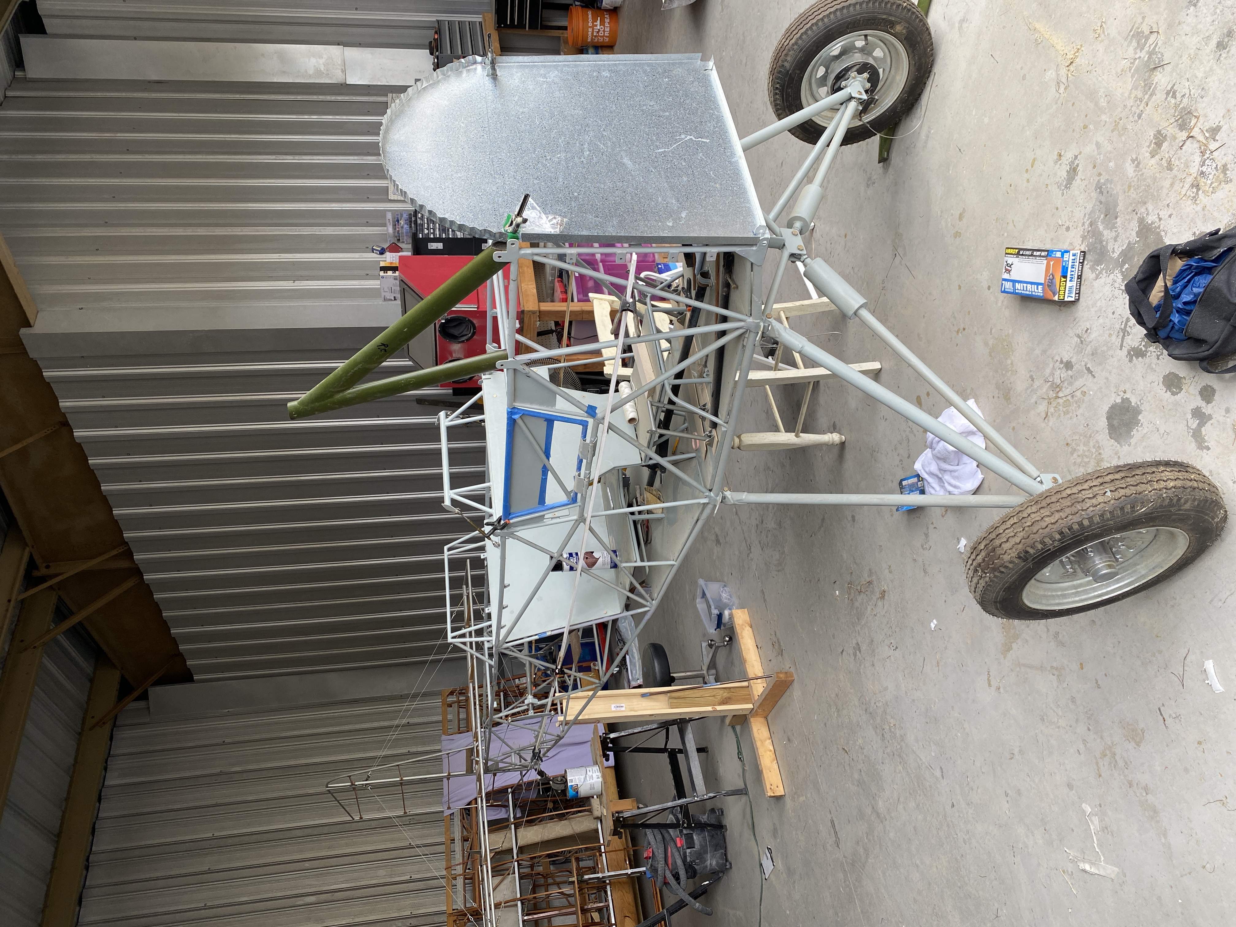

It was Terry Hand's plane, super nice guy. I picked it up a couple weeks ago. I'm still working on my shop in the basement and the lighting is not good. I have some pics from Terry's hanger. So it looks like if you click on the image, it will rotate it 90 degrees.r1200gsDave wrote: Sat Apr 30, 2022 3:53 pm Photographs would be very helpful.

My suggestion was that you try to do anything you can do that's inside the cockpits and empennage as early as you can, because it gets more and more difficult to work inside there as the fuselage sides and covering go on, but you've got a steel tube fuselage that makes it much easier to work on things without having to crawl into the cockpits or fuselage. Sounds like you're reasoning through the building process, which is very good. If you can look at some other Piets, you might get a better idea of things that should be done earlier in the build, or things that might obstruct your work later. One thing that sometimes gets overlooked is the fact that the aileron control cables from the bellcrank on the control stick cross each other on their way up to the pulleys in the wing centersection, and that leads them across the back of the instruments in the rear cockpit. Take a look at some airplanes to get a better idea of which areas get tighter after the cables are installed.

Thank you Mr. Zuniga, that is very helpful.taildrags wrote: Sun May 01, 2022 11:45 am My suggestion was that you try to do anything you can do that's inside the cockpits and empennage as early as you can, because it gets more and more difficult to work inside there as the fuselage sides and covering go on, but you've got a steel tube fuselage that makes it much easier to work on things without having to crawl into the cockpits or fuselage. Sounds like you're reasoning through the building process, which is very good. If you can look at some other Piets, you might get a better idea of things that should be done earlier in the build, or things that might obstruct your work later. One thing that sometimes gets overlooked is the fact that the aileron control cables from the bellcrank on the control stick cross each other on their way up to the pulleys in the wing centersection, and that leads them across the back of the instruments in the rear cockpit. Take a look at some airplanes to get a better idea of which areas get tighter after the cables are installed.
