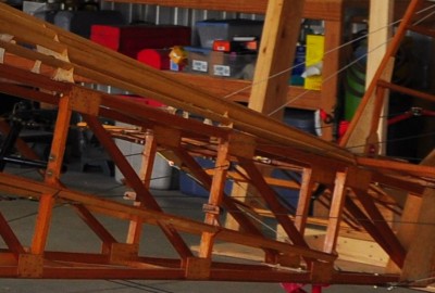

I am joining my fuse together. Q. Which way do the 1/2 x 1” struts and braces lay ie 1” deep as the Longeron or 1/2” deep.
The drawing looks like the 1’ is horizontal x 1/2” deep.

John, I laid mine out with the struts 1" deep across the longerons, such that there would be gussets on both sides of the struts at the intersections with the longerons. The strength is in the gussets. Hopefully this picture conveys what I did. Cheers, Ken

Good morning Ken,thank you for your reply and photo,I will do it as you suggest , i finally got the fuse rear post set up so ready to install the struts.
