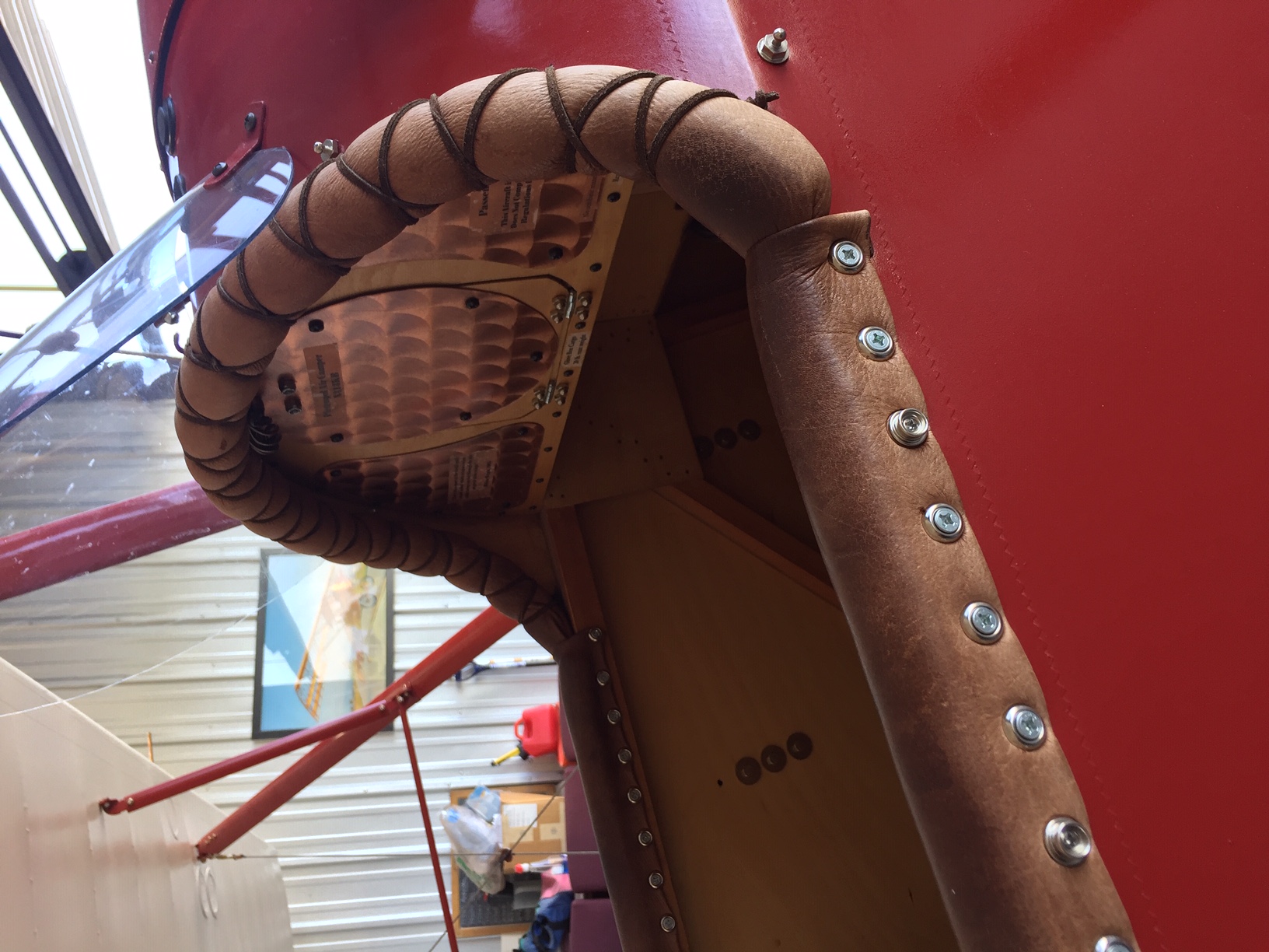

I made my covers using Sunbrella marine grade awning cloth. My seams aren't the prettiest, but they do just fine.

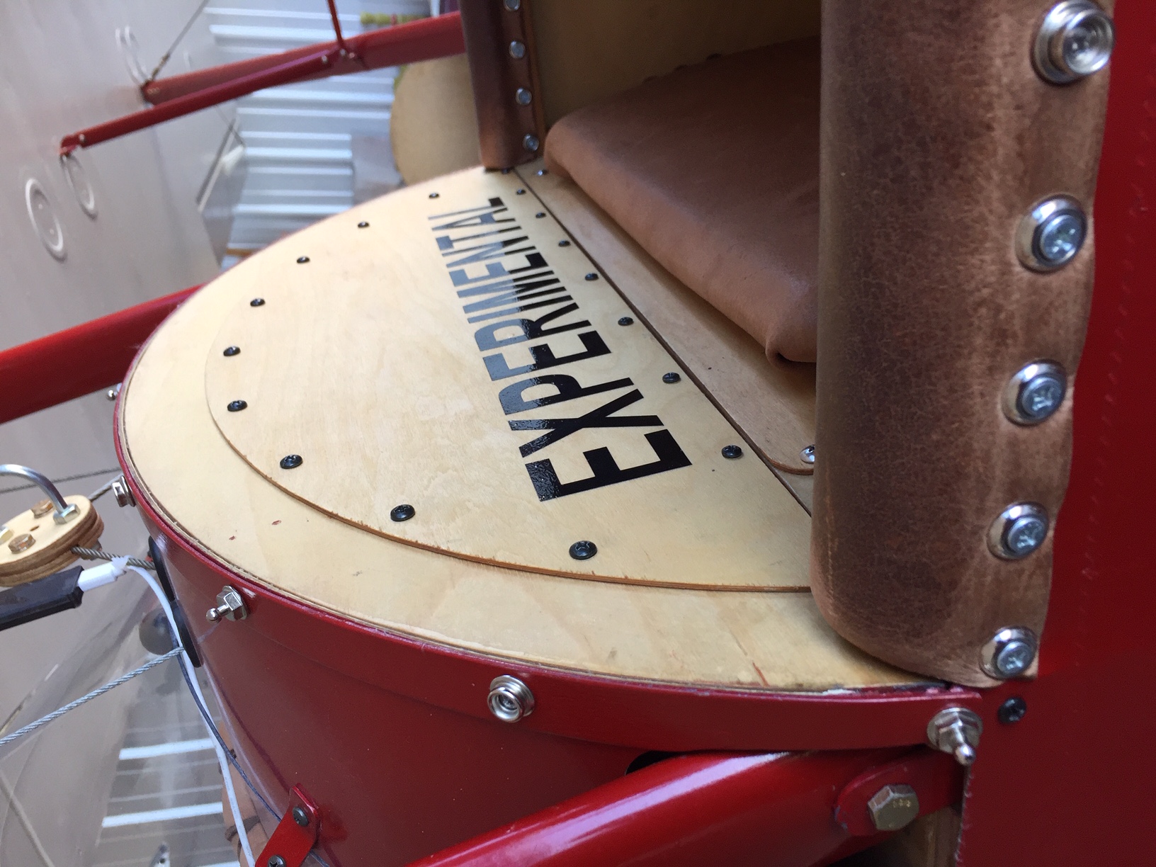

On the forward pit, every other fastener is the a stem and ball type that requires positively pulling on the clip to put the fastener on or take it off, with snaps for the alternating fasteners. My thinking was that snaps might come loose in flight, given all the turbulent air that beats down around the cockpits. I don't want a cockpit cover coming loose and fowling up controls or tangling in cross-brace wires.
On the rear pit, I used snaps all the way around. I only cover that pit when rain looks likely. And obviously it is never covered when in flight -- though that would be a way, I suppose, to replicate IMC conditions in a Piet :)
The secret to making these was a a little tiny tool sold by (I think) Sailrite. It screws temporarily into the position where the permanent fastener will be located on the fuselage. It has a little needle on the top of it. It looks a bit like a WWI German helmet of the sort in Colonel Klink's office in Hogan's Heroes. This allows the fabric to be stretched to remove wrinkles before installing the fastener into the cloth cover. Working your way around, it makes a nice clean installation. Fun, too.
I'll see if I can dig up some pictures from the installation process.

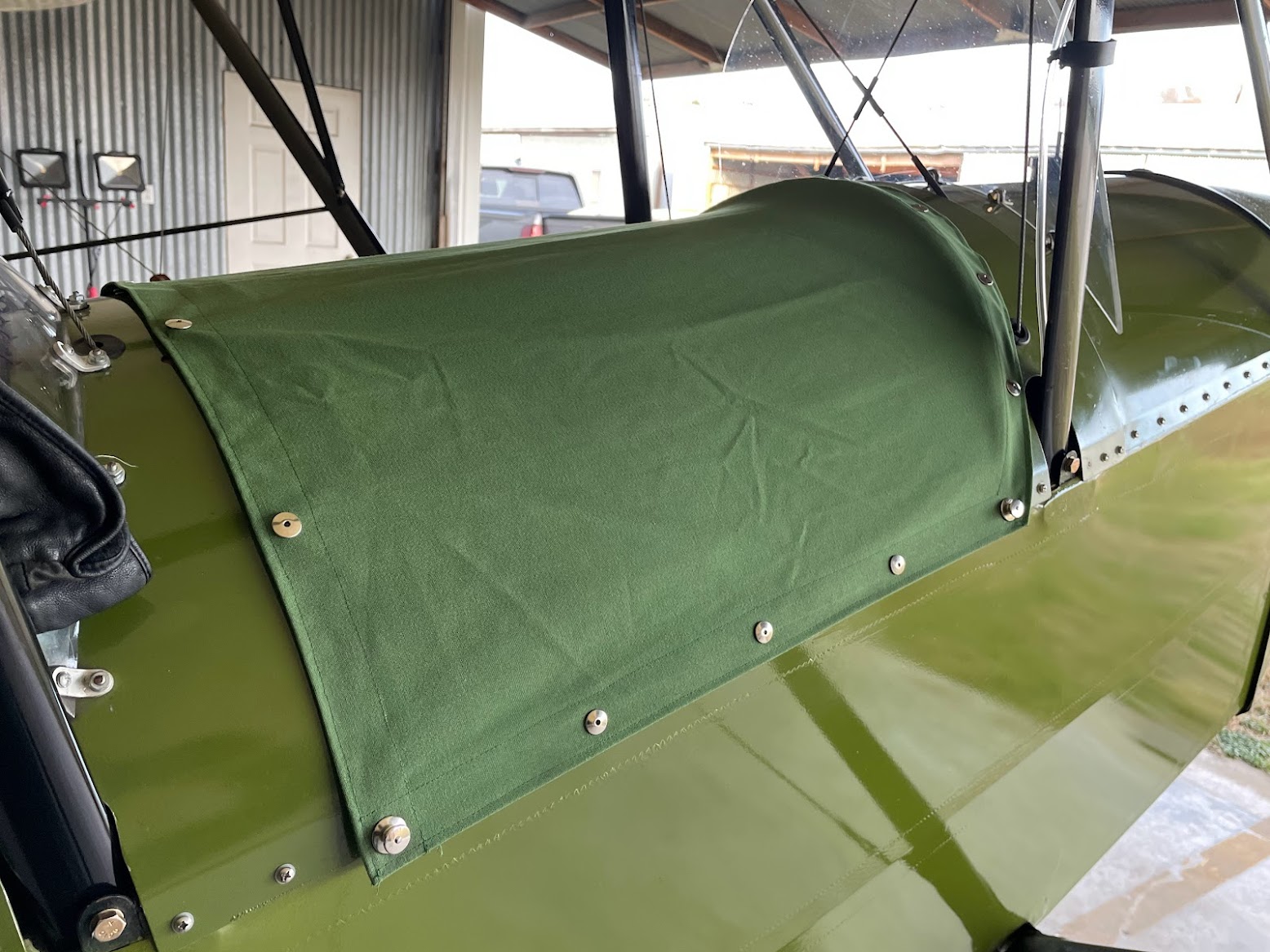

Re: cockpit covers
I tested this cover out today and it seems to work pretty good. It’s just screwed in place for now just to see how it does. Definitely keeps the draft out and I didn’t notice it flopping around at all. I will change to easier fasters at some point. The fabric is “Top Gun” from Joann.

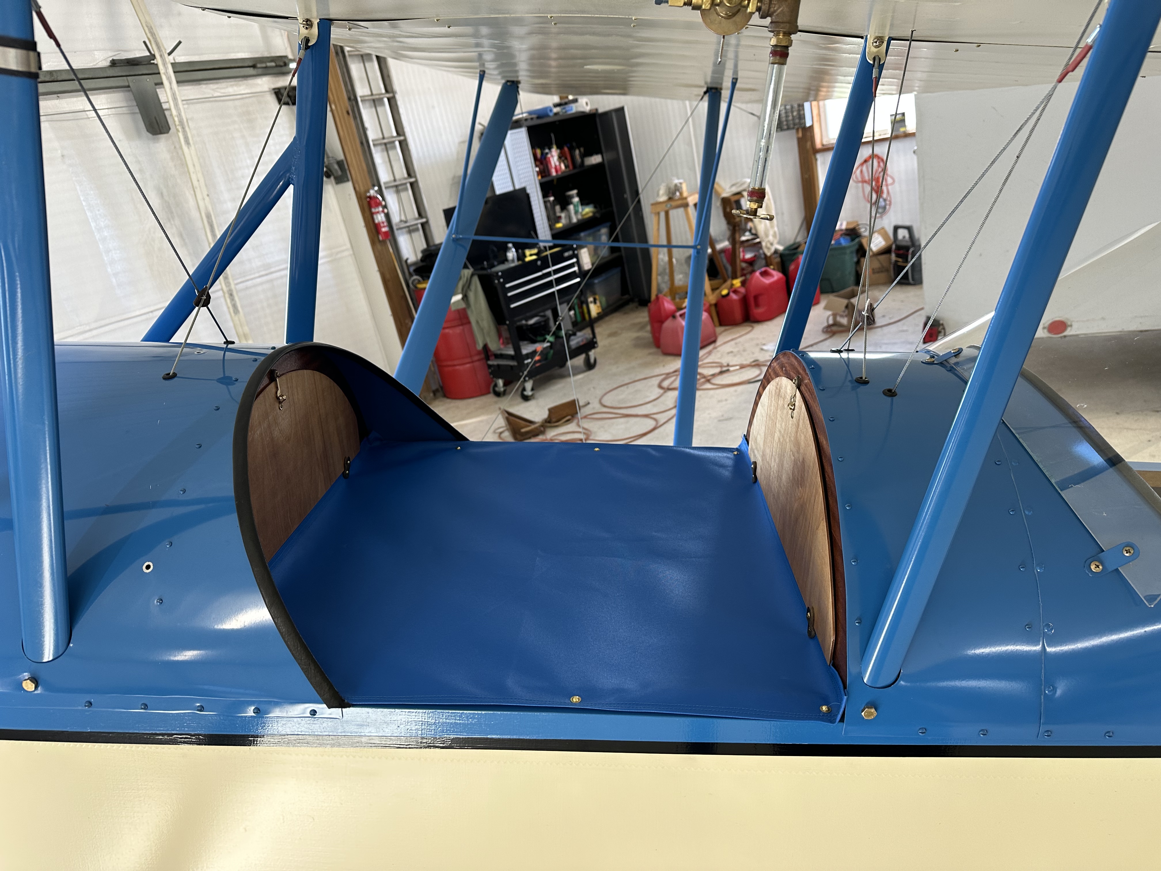

A few weeks ago I made a set of the curved style covers for my piet. I had originally intended to add additional snaps to the forward cover to facilitate flying with it installed but after seeing Dan's across the longerons cover it got me thinking that a simple 1/8" ply plate installed in the same fashion would be a terrific solution for my cold weather flying.
Thanks for the idea!

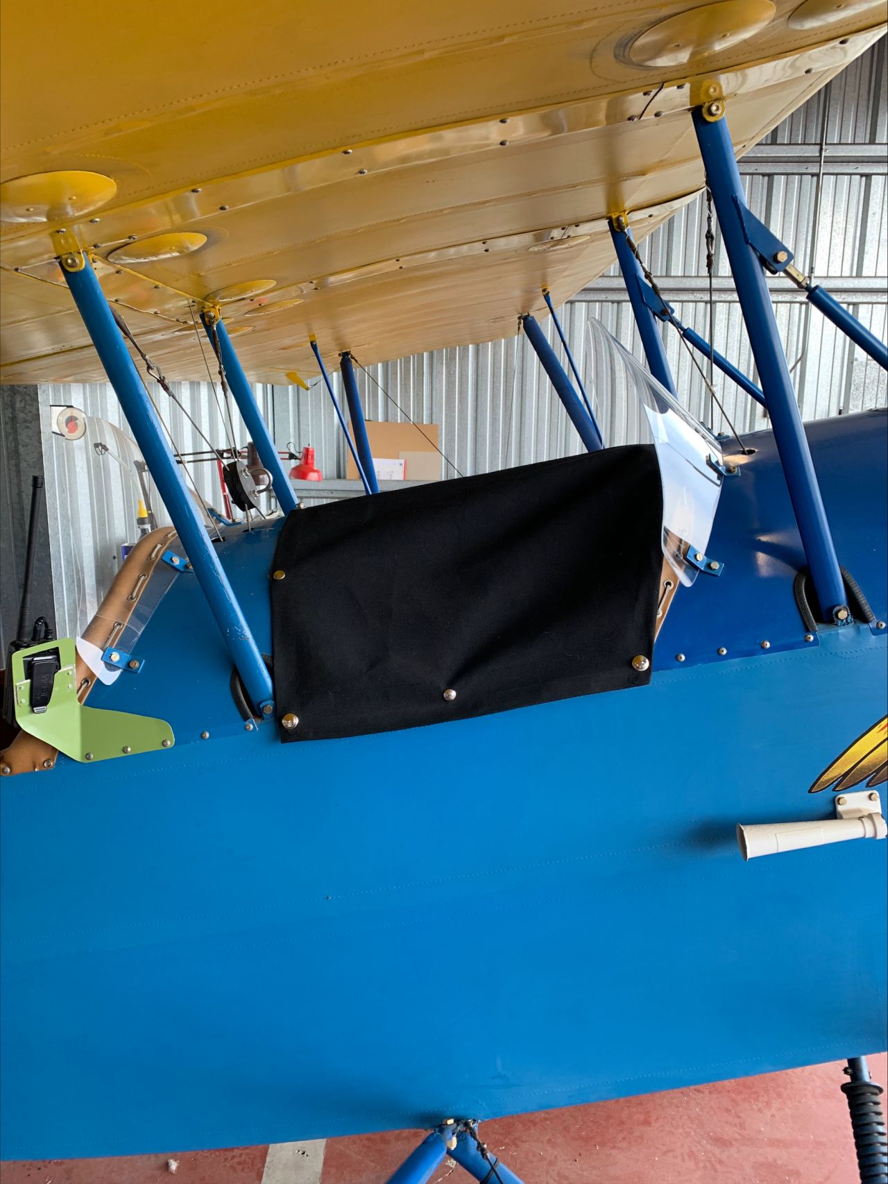

Re: cockpit covers
Okay, so I finally got my front cockpit cover fabricated and installed. My thanks to Ken Bickers for the excellent narrative and photos of how he did his, and also the source information for where he got the fasteners and tools. I followed Ken's design but limited mine to only one cover for the front cockpit since I already have one for the rear, which I would never have in place in flight anyway. I also limited the number of fasteners used on mine so as not to make any new holes in anything. The fasteners are very, very secure but I have yet to taxi test or flight test with the cover in place. And mine is nowhere near as nicely fitted as Ken's is but it should be good enough to cut the gale force wind that comes shooting into the front cockpit and back into the rear when it's cold.

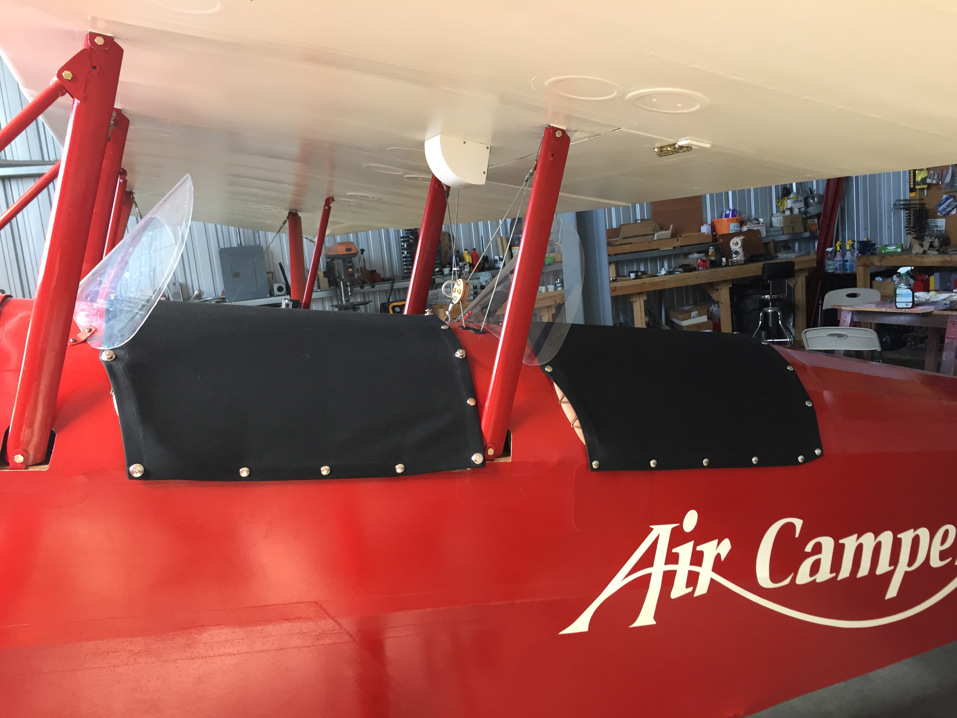

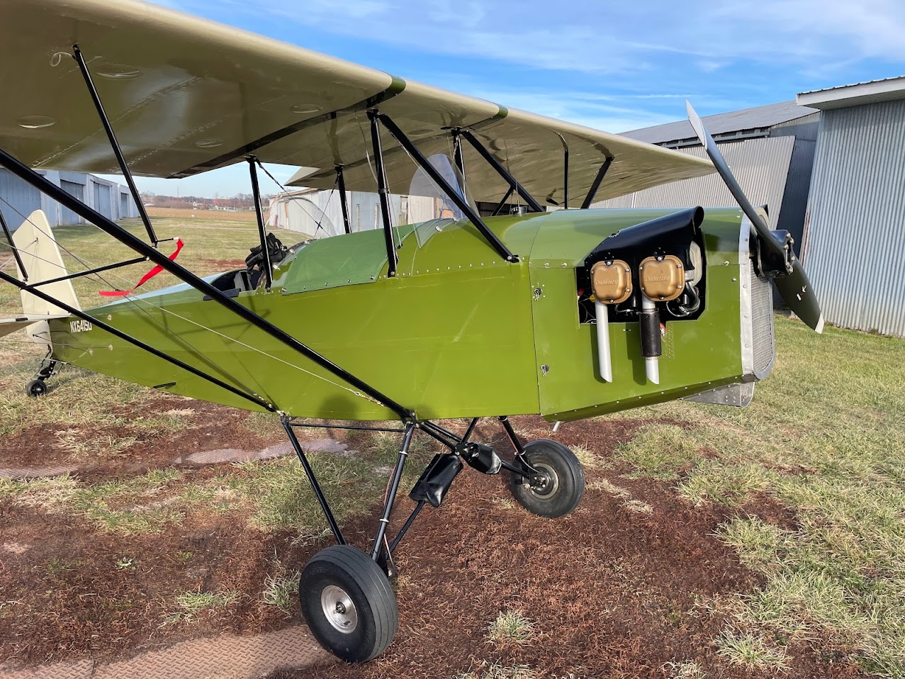

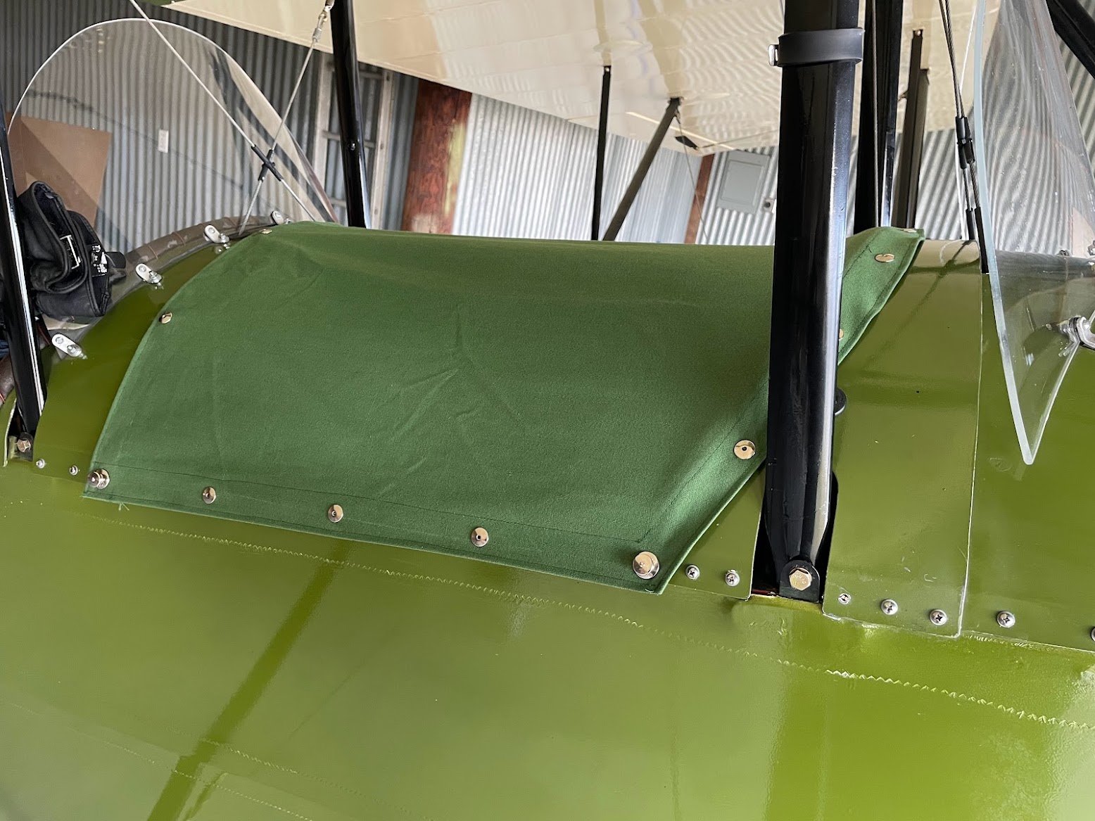

Just finished:
Bob Miller EAA64
GN-1 Aircamper
Based IL91 Columbia, IL
Posts: 641
Re: cockpit covers
Nice job of color selection, very nice installation of the fasteners, and the cover looks nice and taut. Let's have a PIREP once you fly it!
Posts: 129
Re: cockpit covers
Looks good, Bob. Nice job on the cover.
rightforlineup
Posts: 27
Location: St Louie
Re: cockpit covers
Post by rightforlineup »
Thanks for the kind words, Ken and Oscar. Pirep: quieter, warmer and less drafty.
  • I think I have about the right number of fasteners -- I went back and forth on how many to use. Not like a certified plane or kit where you just follow the instructions.
  • Standard snaps from Sailrite. Loxx are super easy to install, after making a hole they just screw on to the fabric.
  • I used a Harbor Freight tarp which is truly tough and has zero stretch. I did try to get it taut without going crazy with it while installing with the spikes that Sailrite sells.
  • I got some samples of stretchier faux leather that color matches better but I have a plan to redo all the aluminum coaming along with the cowl anyway, so the new covers will be different.
  • Happy with just the 4 Loxx fasteners in the corners. They are an insurance policy, as there is no way the cover is coming off of those 4 points. Fear would be damaging the plane with a flopping cover.
  • folded back and marked a 1" hem and had a local tailorshop do the sewing - $35
