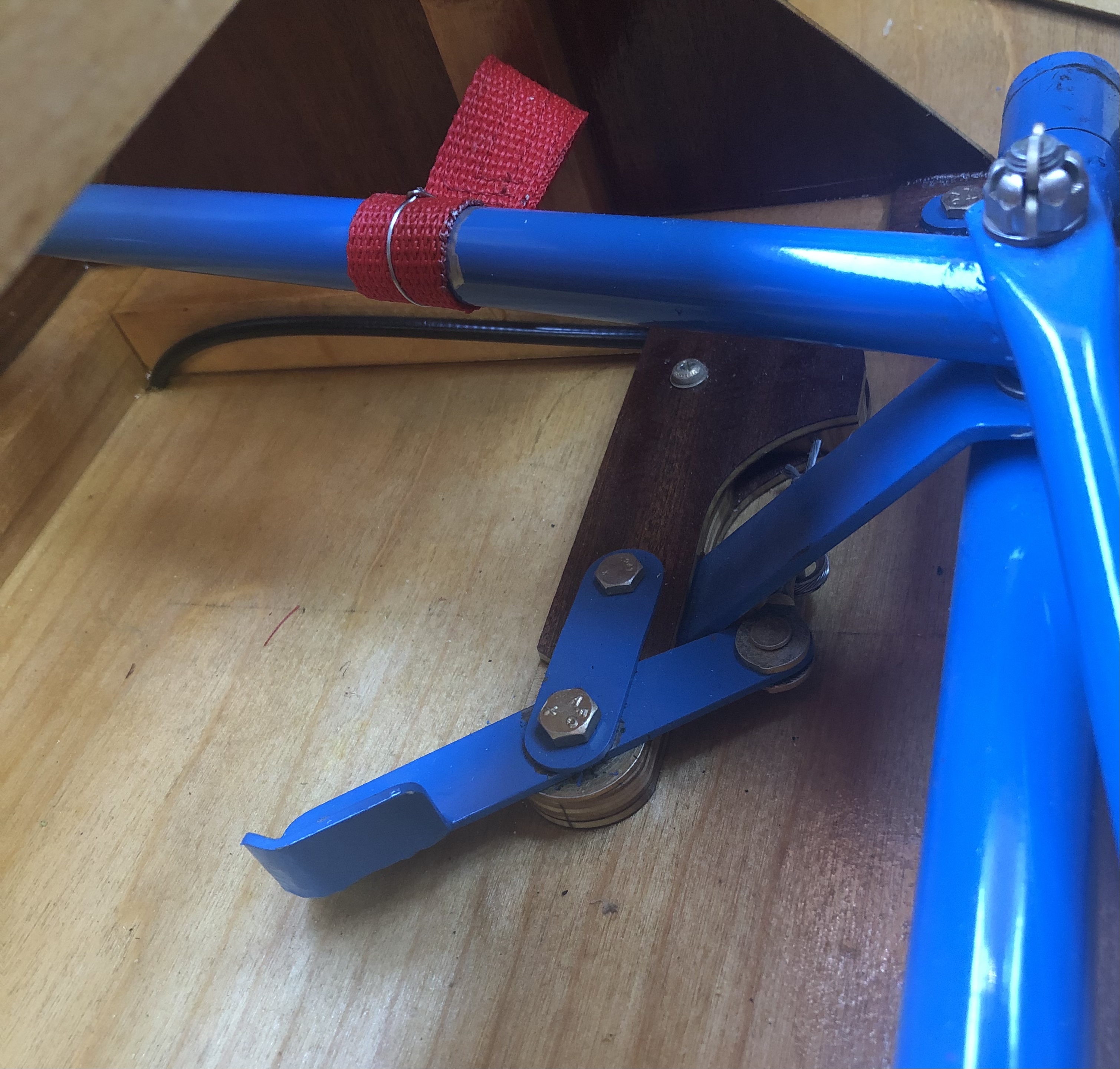

I’m still in the building stage so who knows how well my setup will actually work but for what it’s worth here’s a couple shots of how I did mine. The design is inspired from pictures on West Coast Piet of Charlie Miller’s design.
It’s really hard to get a good picture under there.
And here’s the mess makes underneath.

Dan; does the brake cable go around a pulley to change direction before entering the outer sheath? Looks that way but I can't be sure.
-Oscar Z.

Dan. Are the red straps control stops?

Oscar, the cable does not currently go around a pulley. It just bends 90 degrees around a wood curve. I figured that would be a simpler installation (always on the quest to reduce parts count). However, I made the dimensions match that of a pulley so that if it proves to be a problem then it would be relatively easy to add them.
Richard, yes the red straps are my rudder control stops. I was going to add the wood blocks in front of the rudder bar as stops but they would of been like an inch and a half deep. looked like a lot of block! So I decided to try straps instead. The only thing I could think of that might be an issue is if the strap slid in or out on the bar then your travel would lessen. That's why you see the safety wire clamping them in place.
None of this stuff has been tested in the field mind you.
I posted mostly just to point out that heel brakes can also be installed sideways.

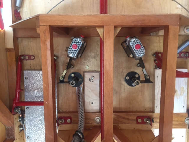

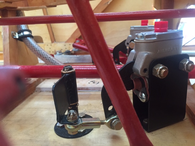

I have heel brakes and master cylinders under the front seat on my Piet. I used AirHeart Small Master Cylinders. They are attached to flagpole heel brakes, rather than lever arms.
Here are a couple pics, from the top and the side.

Ours has that bar, going completely across the aircraft. I can see right now that I need higher, more Cub-like pedals. The ones in front would be perfect, but are too wide.
Will I run into trouble raising the pedals and cables a couple Inches?
Tough to see exactly what you did there, but it is clear you have individual pedals. The bar seems like a not-so-good idea.

Looks like a nice installation, but I don’t see how it works. It appears the heal pedal is under the front seat. What am I missing ?

Yes, the "flags" of the flagpole setup are under the front seat, but only barely. As with all heel brakes, when you want to apply brakes, you shift your heals just inboard of their regular, natural position. After a couple minutes of practice, it is as natural as the motion to slide your feet up when using toe brakes.

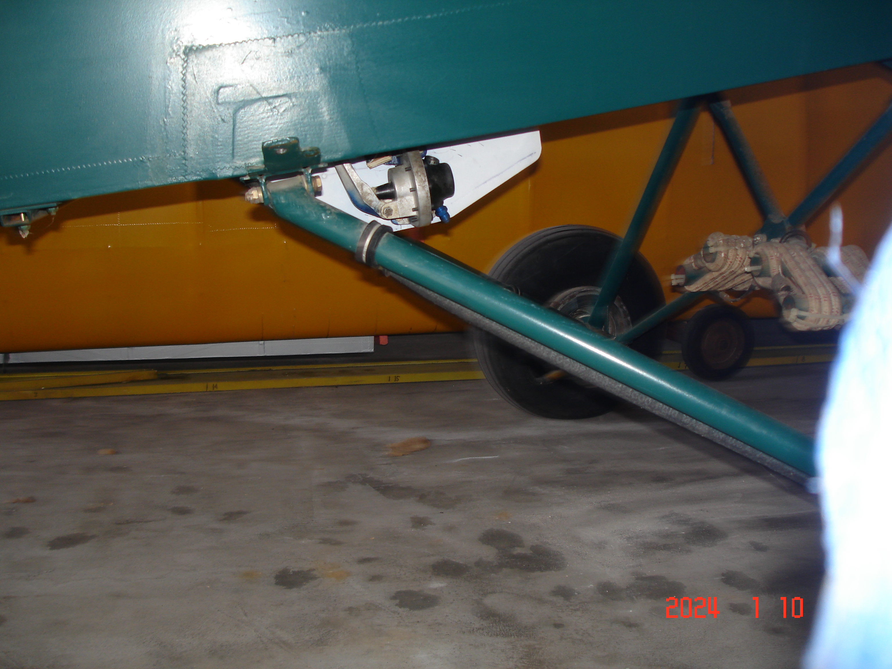

I got all the mechanical stuff done - all that remains is to add hydraulic fluid and test. As I mentioned above, I could not picture a clean installation inside the cockpit, so chose to mount the Scott masters under the belly. Grove 95-1/2 would work the same, with the same mounting.
I also straightened out a tailwheel kingpin problem, and will, within about the next two weeks, begin taxi tests. I have to figure out the com radio, which shouldn't be a big deal even if I have to re-wire it, and the final step will be yellow and orange, so folks can see us as we commit aviation with this thing. Photo of the installation below - not nearly as ugly as I first thought it would be. And I can put them in little fibreglas bomblets if I really want to go to the trouble . . .

Thanks. Where are these O -rings? Under the bungees?
Re: Heel Brakes
Master cylinder plungers.
