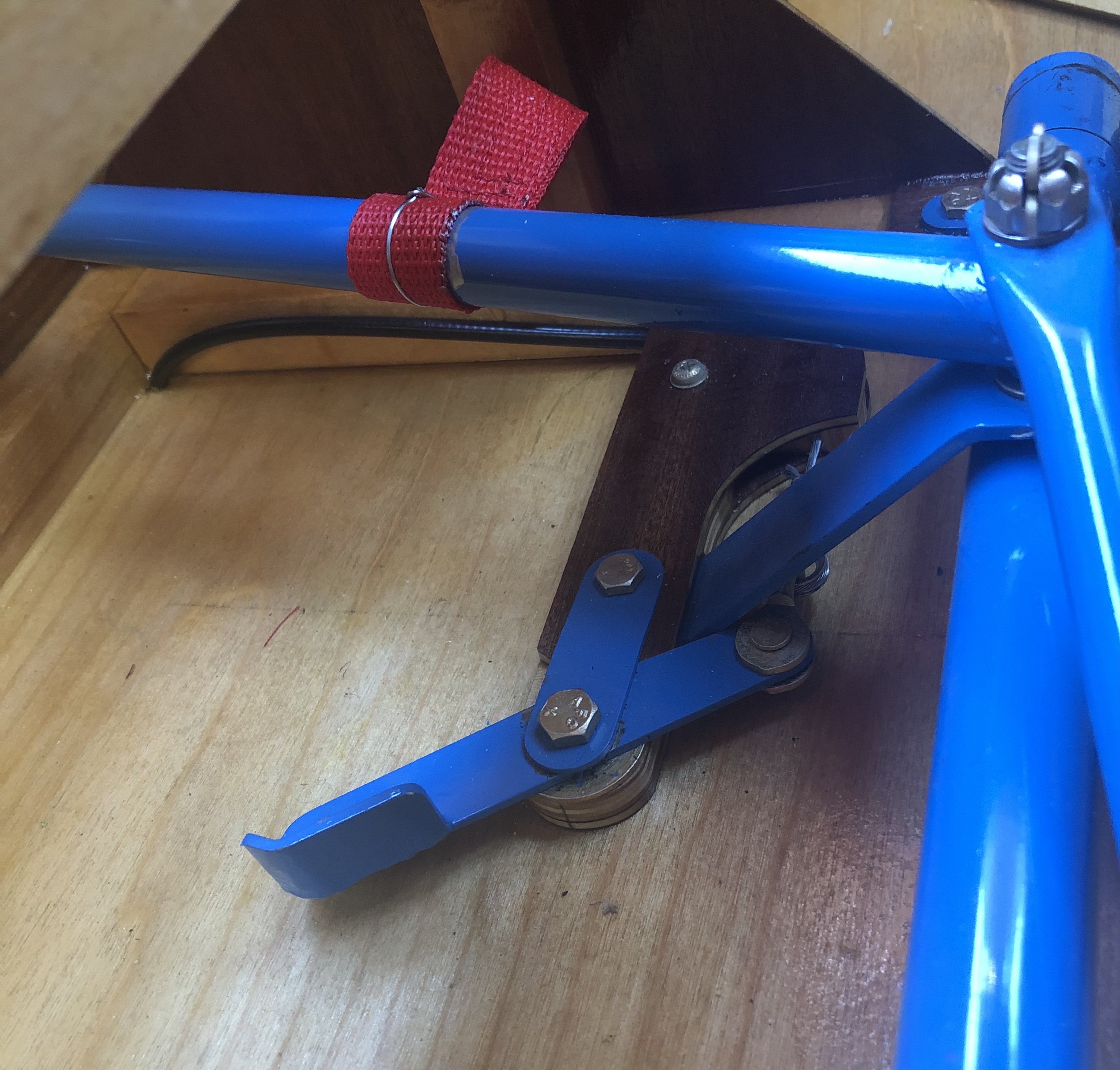

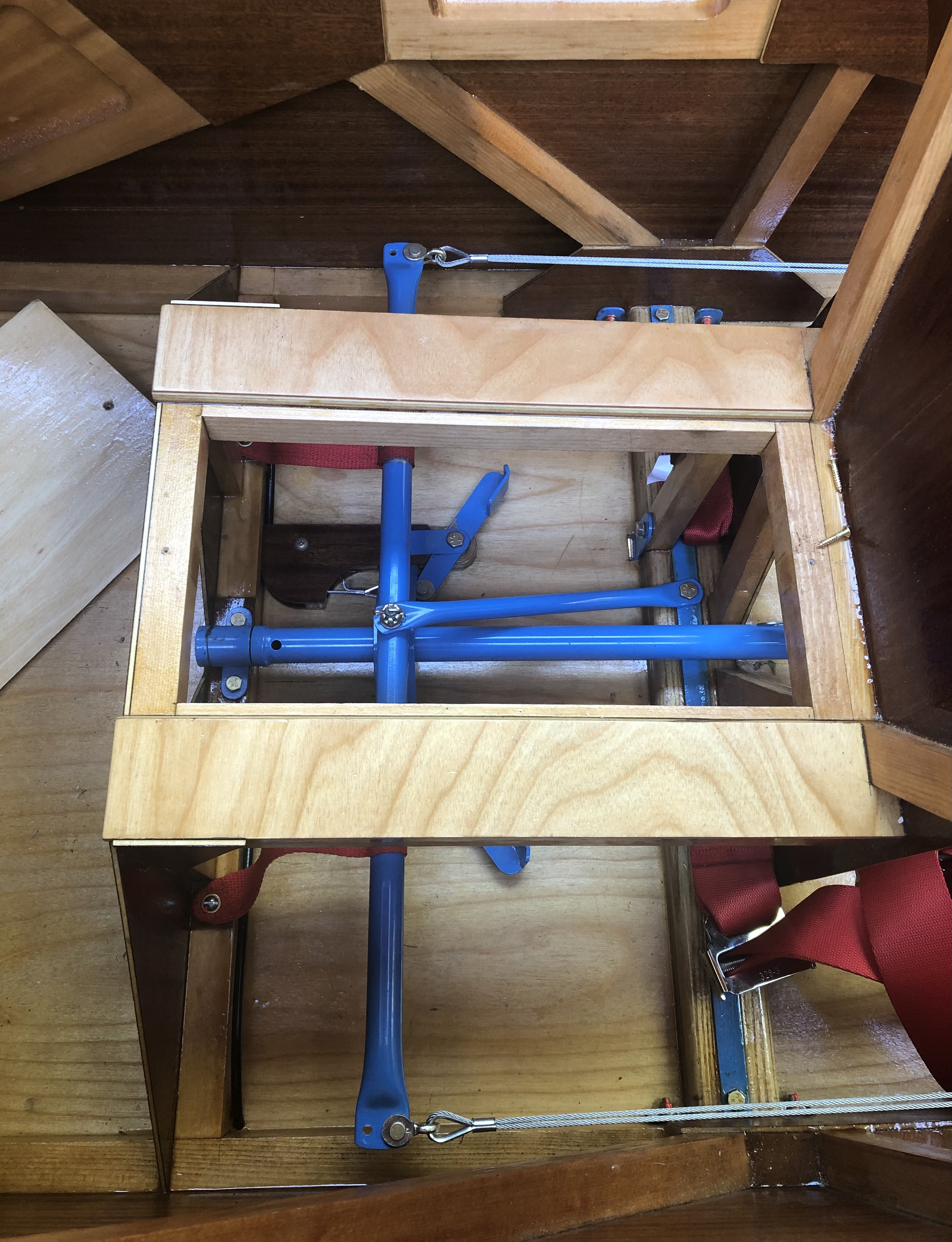

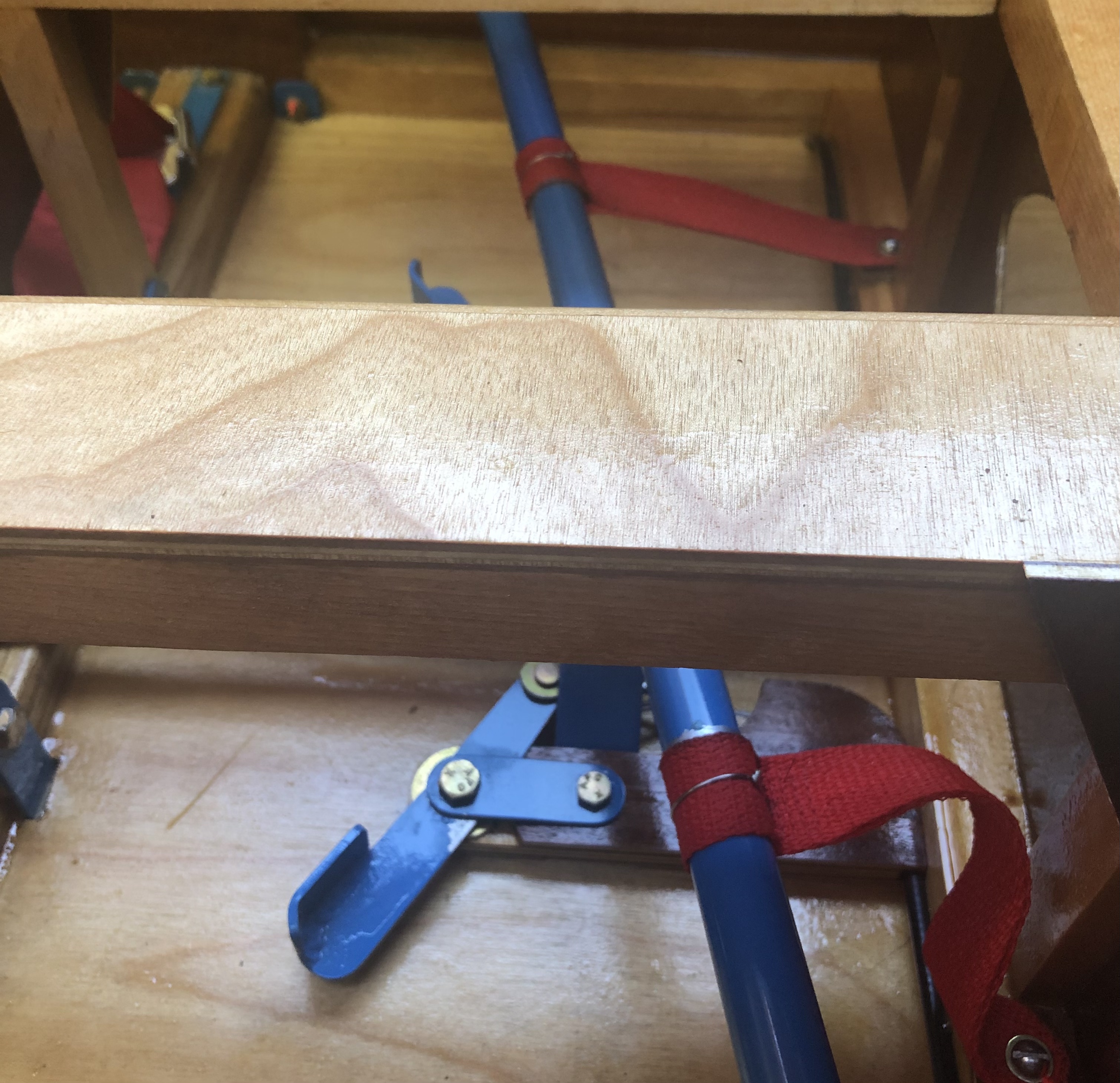

I’m still in the building stage so who knows how well my setup will actually work but for what it’s worth here’s a couple shots of how I did mine. The design is inspired from pictures on West Coast Piet of Charlie Miller’s design.
It’s really hard to get a good picture under there.
And here’s the mess makes underneath.Re: Heel Brakes
Dan; does the brake cable go around a pulley to change direction before entering the outer sheath? Looks that way but I can't be sure.
-Oscar Z.
-Oscar Z.
- Posts: 319
Re: Heel Brakes
Dan. Are the red straps control stops?
- Posts: 319
Re: Heel Brakes
By the way Terry, good to see you back on the site.
Re: Heel Brakes
Oscar, the cable does not currently go around a pulley. It just bends 90 degrees around a wood curve. I figured that would be a simpler installation (always on the quest to reduce parts count). However, I made the dimensions match that of a pulley so that if it proves to be a problem then it would be relatively easy to add them.
Richard, yes the red straps are my rudder control stops. I was going to add the wood blocks in front of the rudder bar as stops but they would of been like an inch and a half deep. looked like a lot of block! So I decided to try straps instead. The only thing I could think of that might be an issue is if the strap slid in or out on the bar then your travel would lessen. That's why you see the safety wire clamping them in place.
None of this stuff has been tested in the field mind you.
I posted mostly just to point out that heel brakes can also be installed sideways.

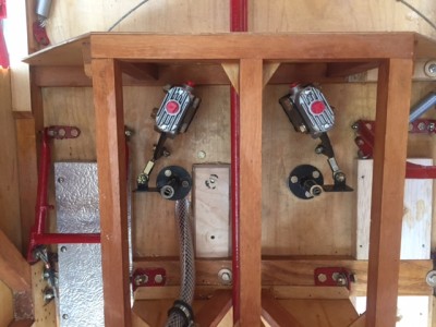

Bump. After trying several geometries I have decided that something like this (only hydraulic) would be optimum. Semi-easy for Cub drivers to get used to.
Hopefully someone can steer me to the “West Coast” photos/info?
My old Cub Scott masters will not fit anywhere down there, even if I pulled the (inaccessible) front seat.
- Posts: 15
- Joined: Thu Dec 07, 2023 2:03 pm
Re: Heel Brakes
There just isn't any room anywhere for a hydraulc master cylinder with heel brake. Today I decided they would have to be in the slipstream. Guess percentage-wise, it will be a blip on the profile drag. Mocking it up this week.

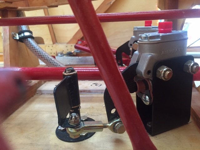

"Outside box, think we must," Yoda might say. Or put differently, there's more than one way to skin a cat.
I have heel brakes and master cylinders under the front seat on my Piet. I used AirHeart Small Master Cylinders. They are attached to flagpole heel brakes, rather than lever arms.
Here are a couple pics, from the top and the side.

Ours has that bar, going completely across the aircraft. I can see right now that I need higher, more Cub-like pedals. The ones in front would be perfect, but are too wide.
Will I run into trouble raising the pedals and cables a couple Inches?
Tough to see exactly what you did there, but it is clear you have individual pedals. The bar seems like a not-so-good idea.

Looks like a nice installation, but I don’t see how it works. It appears the heal pedal is under the front seat. What am I missing ?

Well, I opted for an "under the floor" installation. I mocked it up today, and two of us tried it out. Seems very "Cub-like" to us.
The actual installation will be very "dirty" for the test flight period - then maybe we will make some little streamlined blisters. Maybe.

Yes, the "flags" of the flagpole setup are under the front seat, but only barely. As with all heel brakes, when you want to apply brakes, you shift your heals just inboard of their regular, natural position. After a couple minutes of practice, it is as natural as the motion to slide your feet up when using toe brakes.
