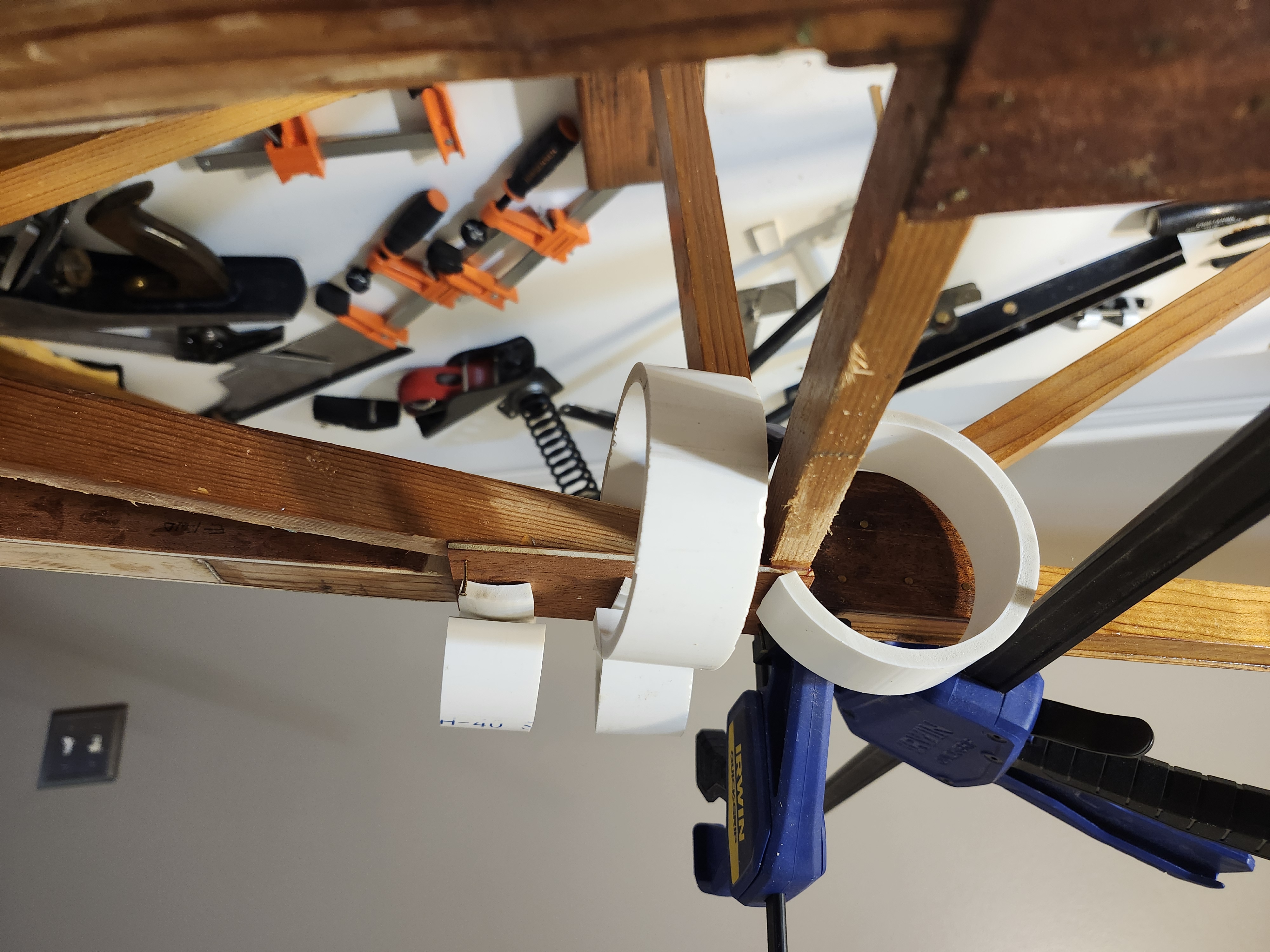

Back from visiting my sisters and mother. I planed the doublers on the lower right longeron this morning. Time to glue up the lower left.

Glued up the lower left longeron doublers today.

The rear splices are complete. Station piece and pulling them together at the tail post next.

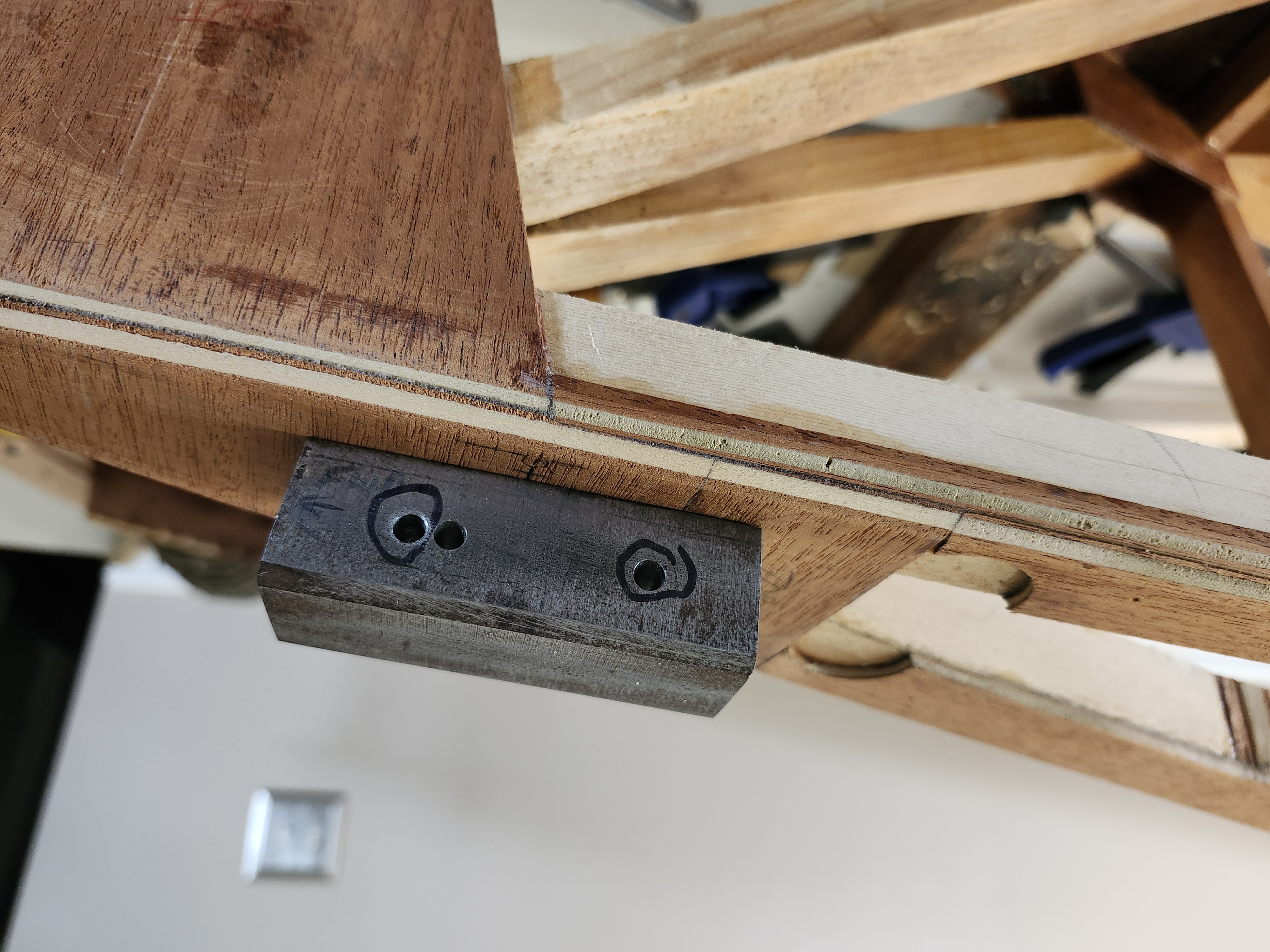

Re: N34KP's rebuild

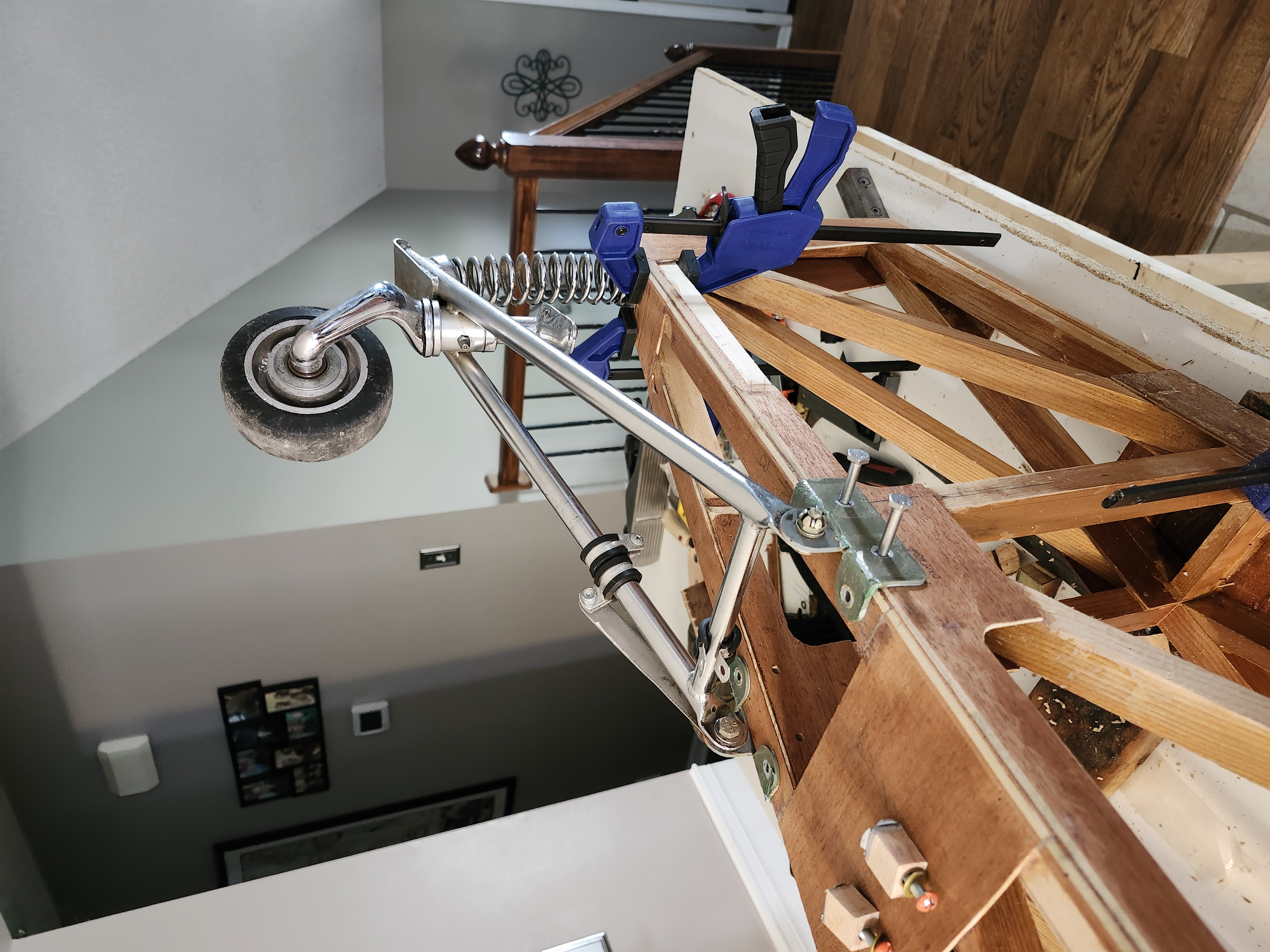

The holes for the forward tailwheel brackets are drilled.

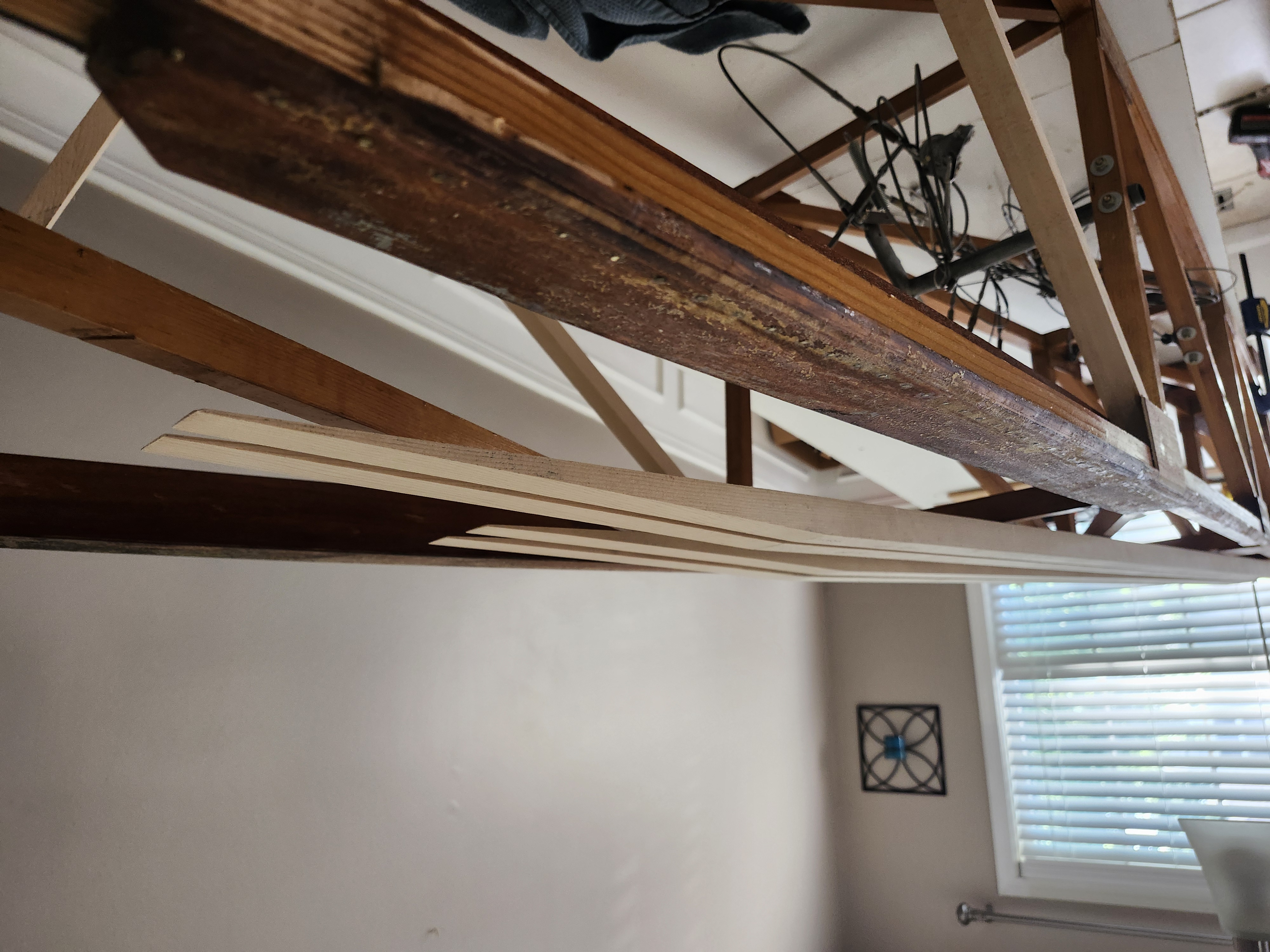

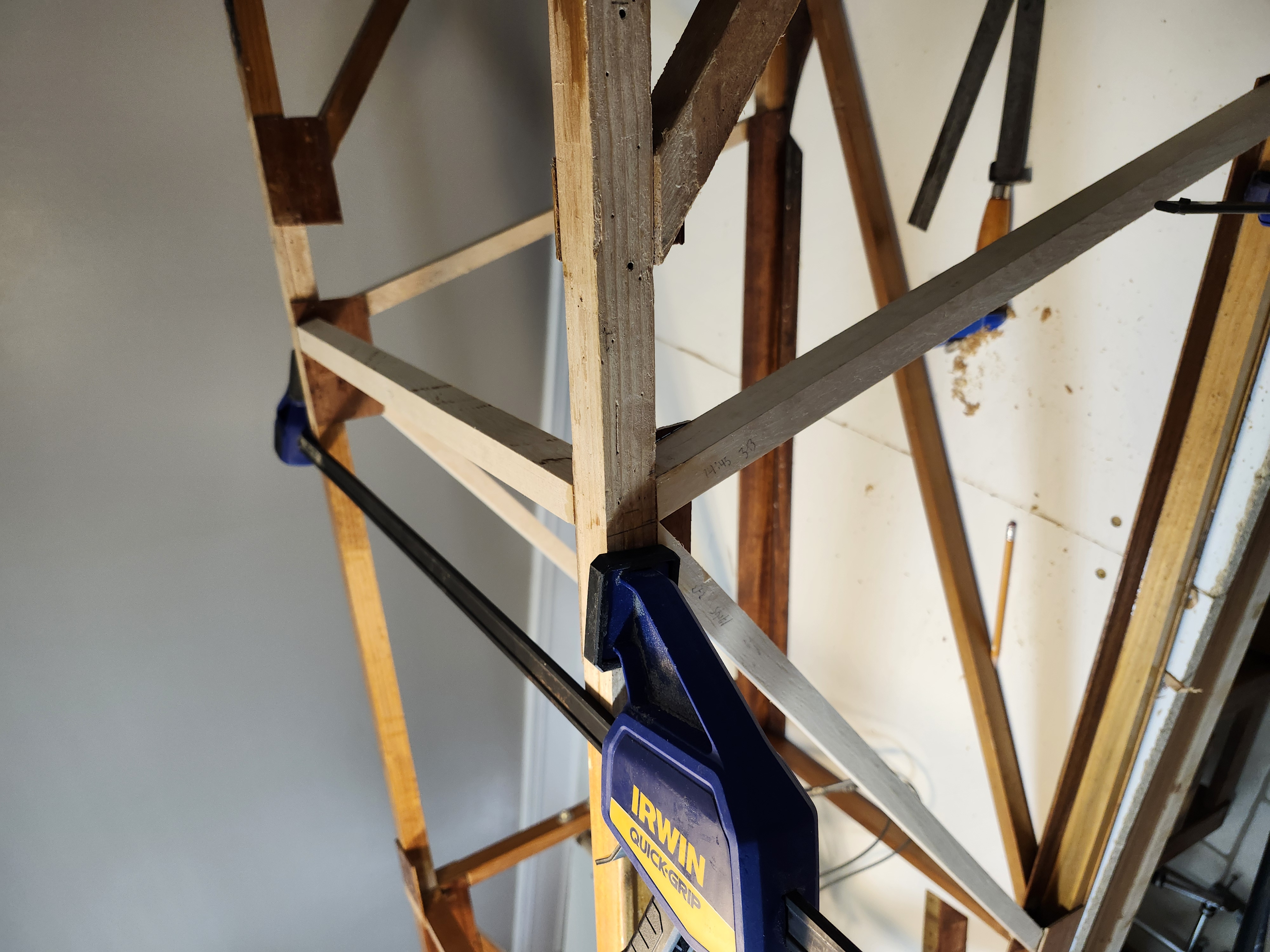

Well crap...., while marking up the longerons for cuts for the splices, I found a crack in the lower left one, right where I wanted to do the splice. Always something. Time for another inspection for additional damage I might have missed and to re-evaluate the splice location on the lower left longeron.
Re: N34KP's rebuild
Good eyes. I'm glad you caught the crack now and not when it might matter later. It seems you're doing this just right!

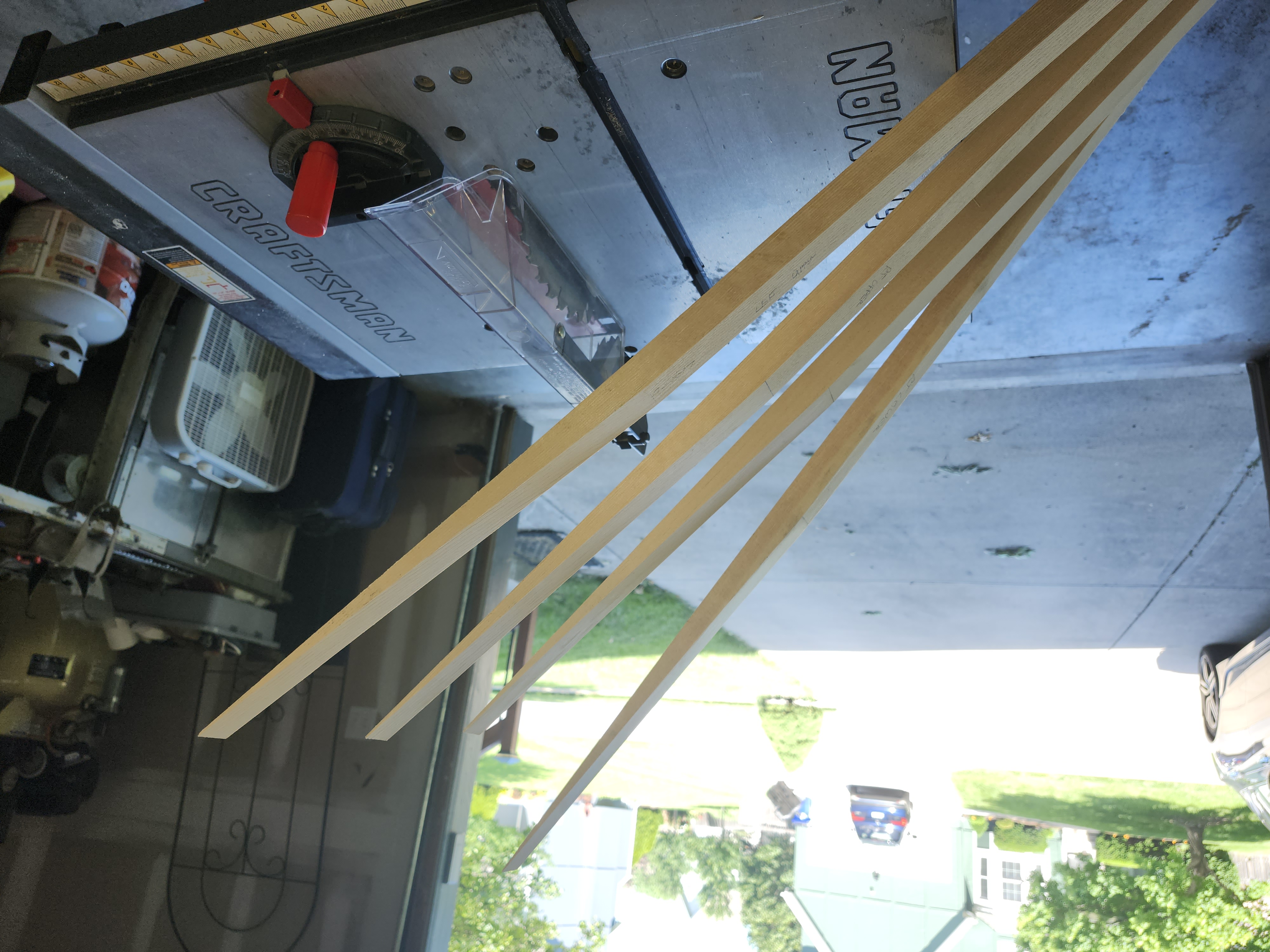

The first two splices cut.
Posts: 714
Re: N34KP's rebuild
Wish I had thought of that nifty scarfing jig. It's nice when you have the working room for nice jigs and clamps and planes and spokeshaves to work with! It seems like anytime I need to make repairs to something, I have to work with small tools and work by eyeball in very tight spaces.

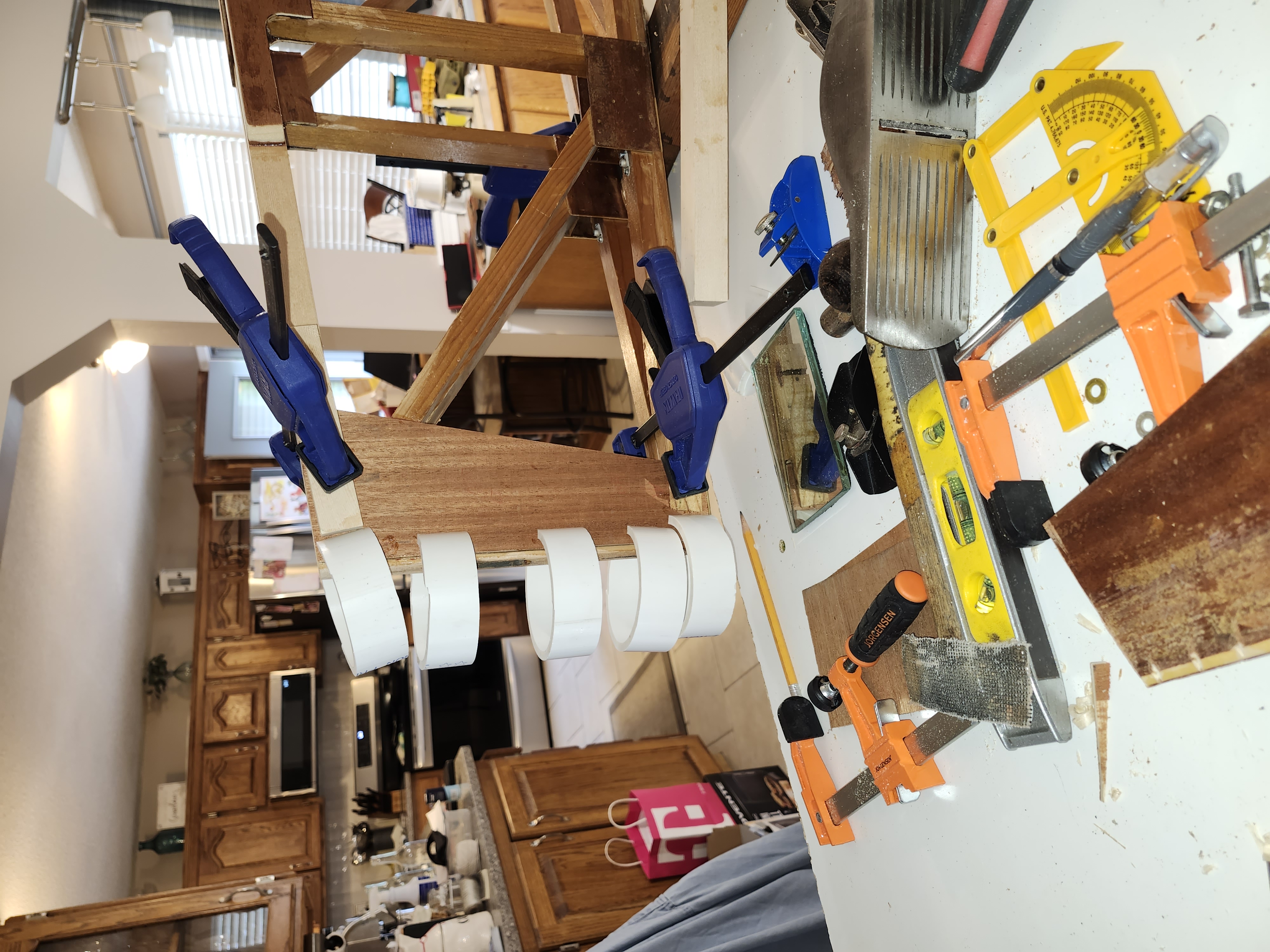

What did you use to get rid of the biggest part of the scarf?
Posts: 348
Re: N34KP's rebuild
On my first try, back on one of the tail longerons, I tried a saws all and chisels. It was practically uncontrollable. Vibration and catching the wood it jumped all over the place.
Now I use a small draw knife I bought at Rocklers. It takes 3 to 5 minutes to cut down to just shy of the guide, then I finish with a block plane.

All four fuselage forward longerons scarphed. Now to do the repair pieces.

Inquiring minds want to know.. did you just run the plane down the steel jig?
Posts: 348
Re: N34KP's rebuild
After cutting close with the draw knife, yes.

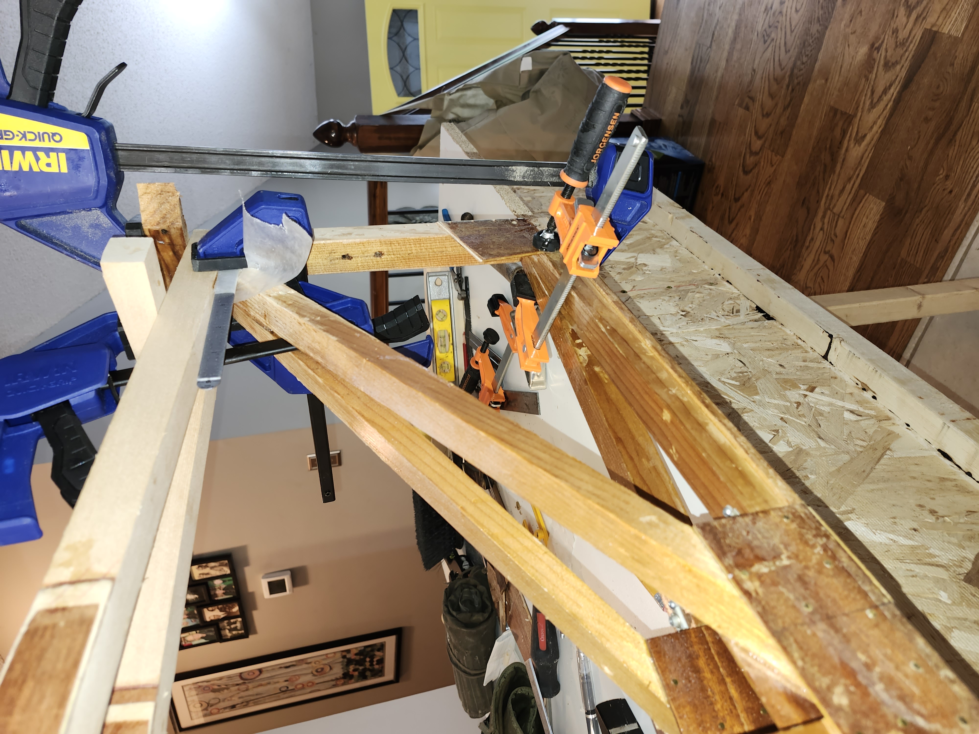

Re: N34KP's rebuild

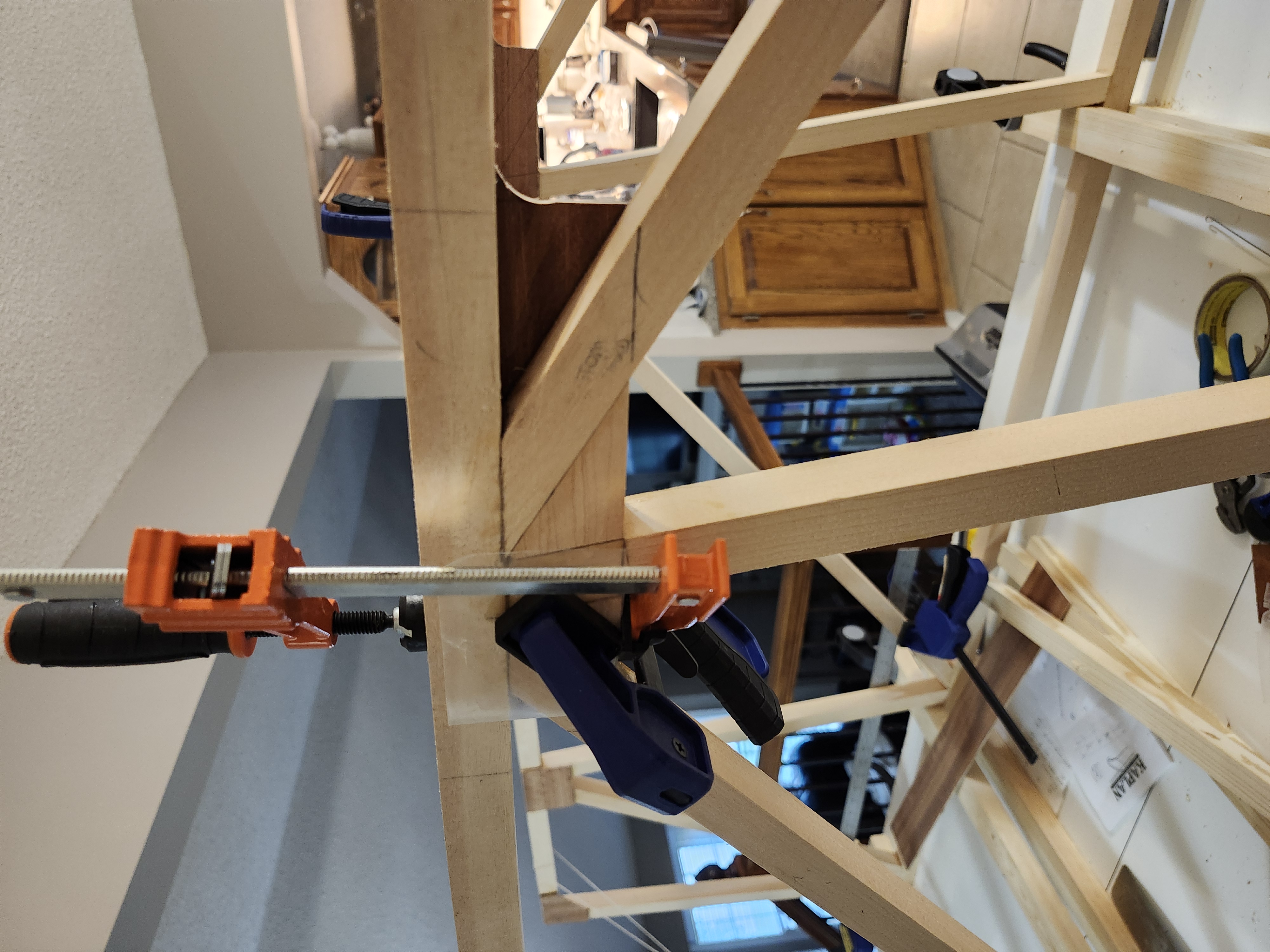

The four pieces for the front of the fuselage are ready to be glued on.
Posts: 348
Re: N34KP's rebuild
The bottom longerons are gluing.
Posts: 348
Re: N34KP's rebuild
The two upper longerons are gluing.

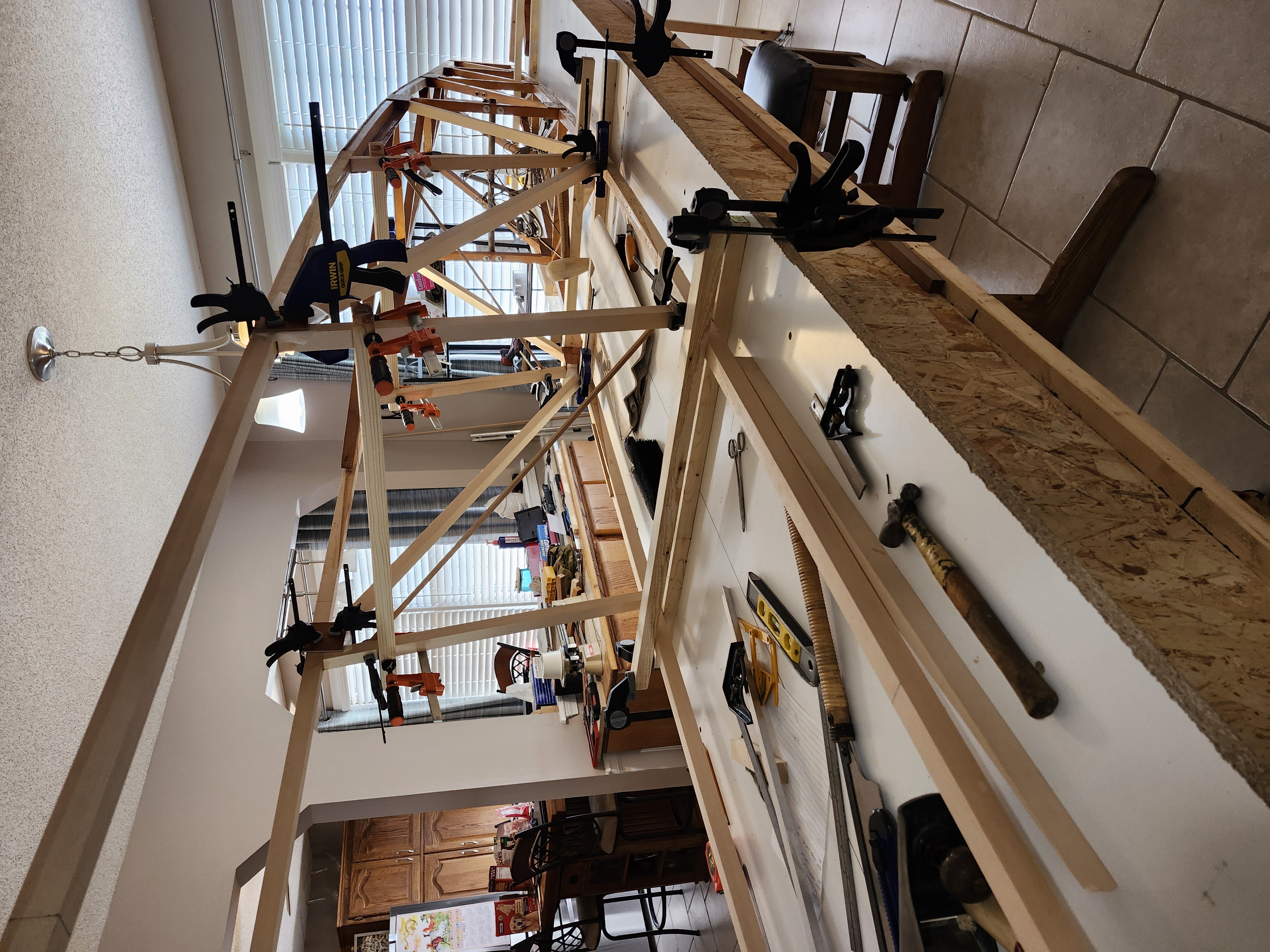

Posts: 348
Re: N34KP's rebuild

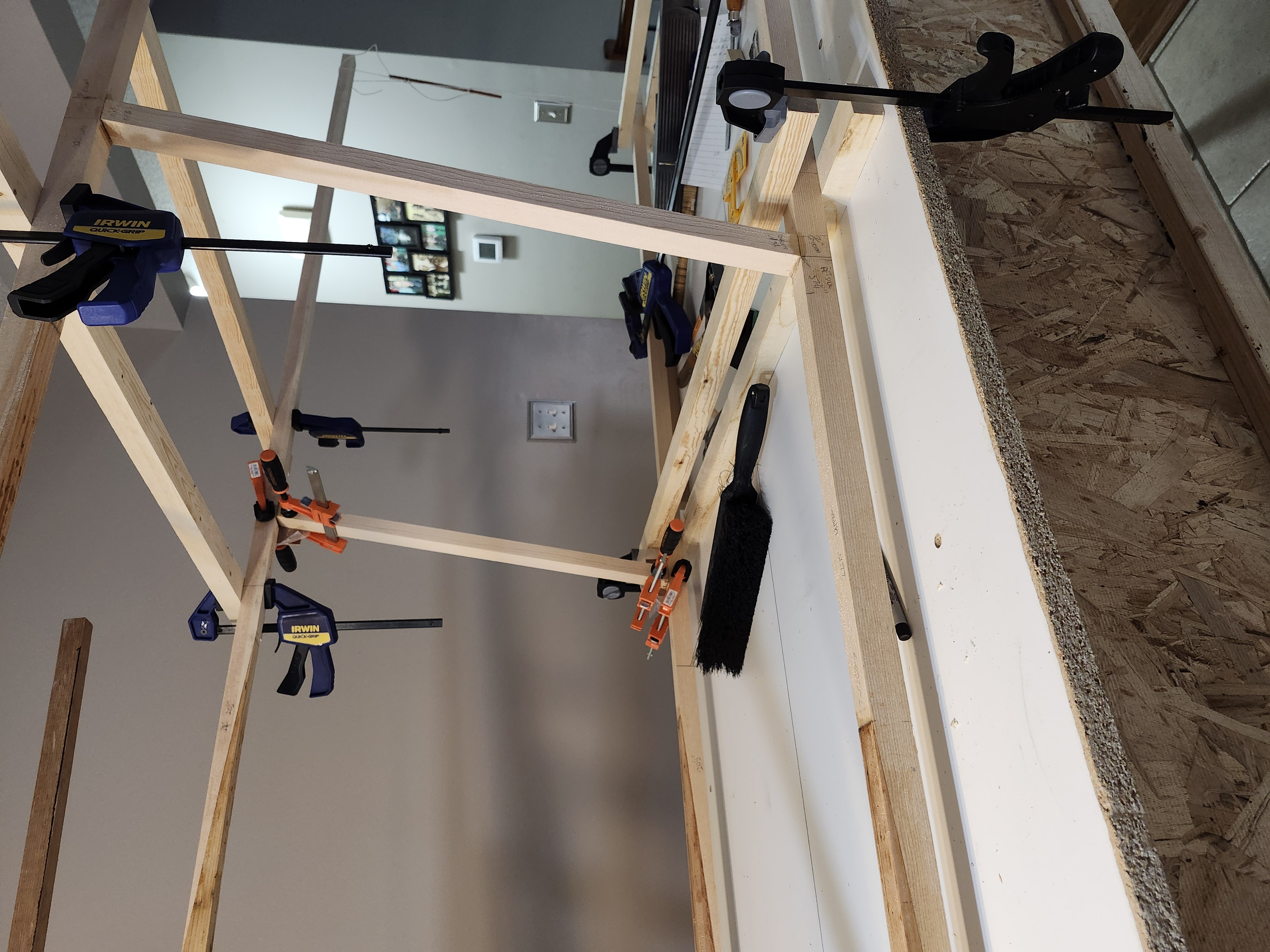

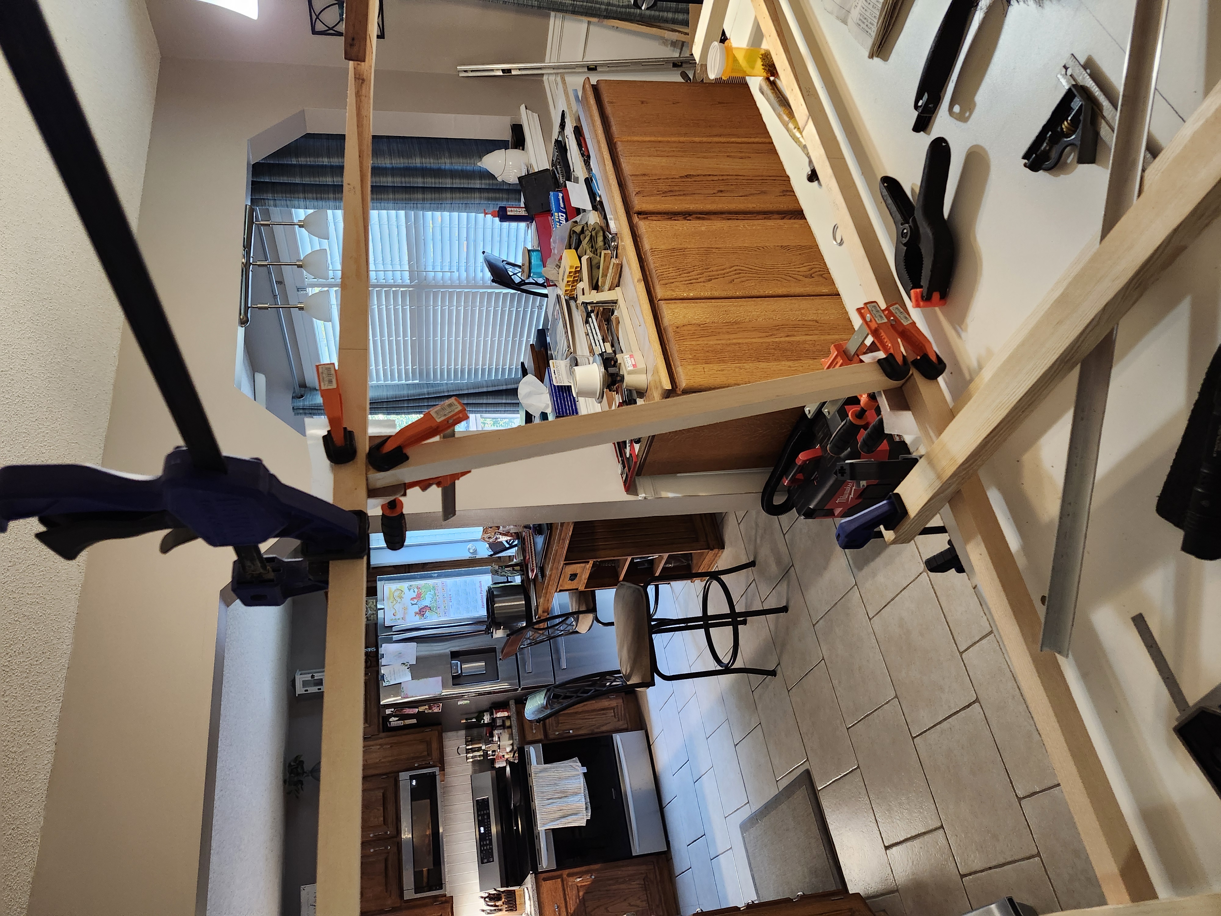

It's been a while since I could work on the Piet. Yesterday I glued in one piece of the left rear cabane station.
Posts: 714
Re: N34KP's rebuild
Richard: even the pyramids were built one stone at a time, and so it is with building an Air Camper. You can't rush this stuff and if you do it right the first time, you'll only have to do it once :)
Posts: 348
Re: N34KP's rebuild

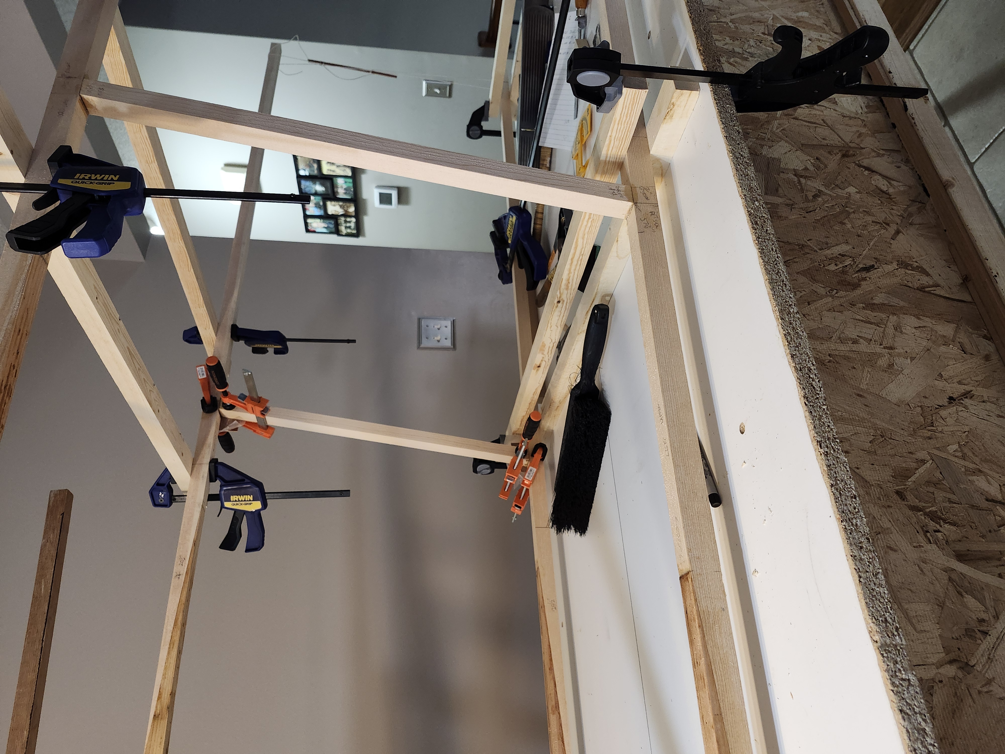

Opposite side gluing

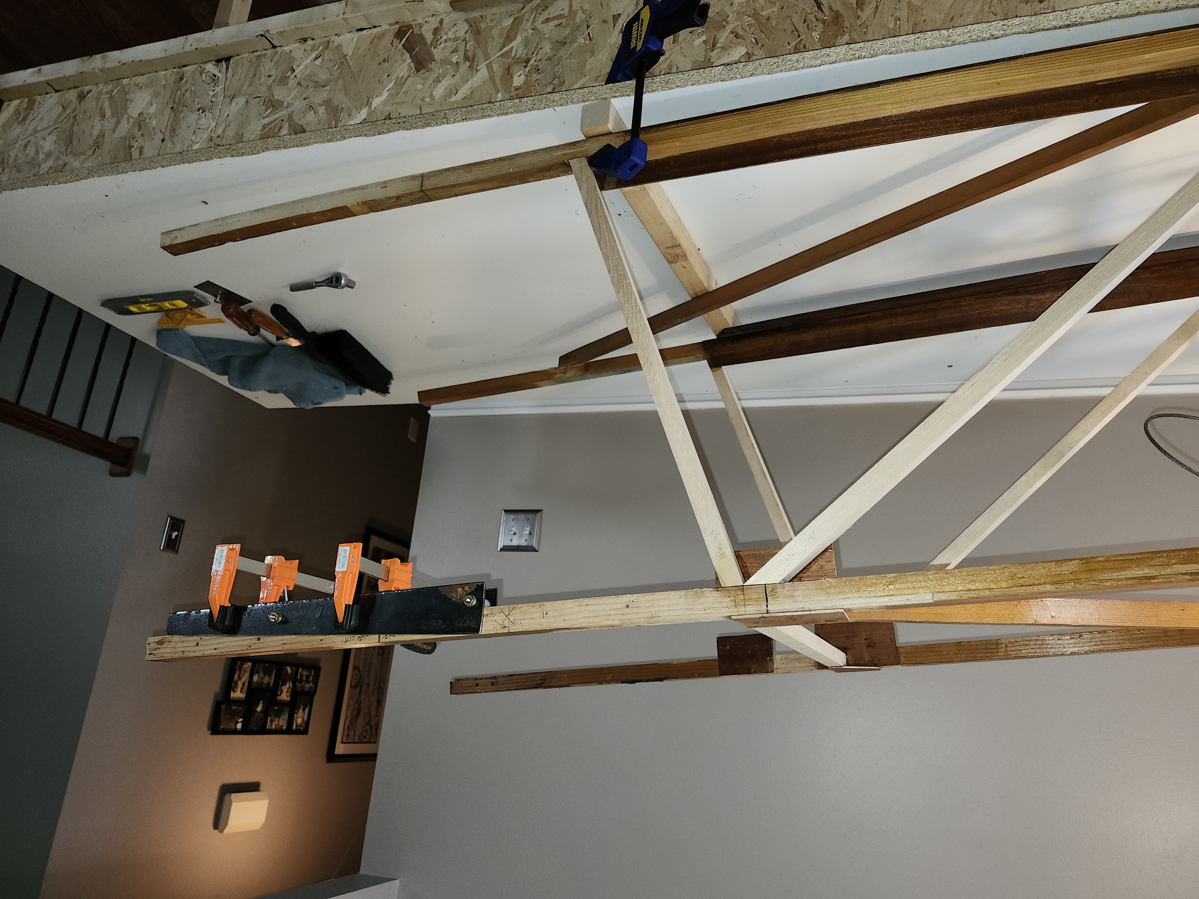

Posts: 348
Re: N34KP's rebuild
Gluing in diagonals.

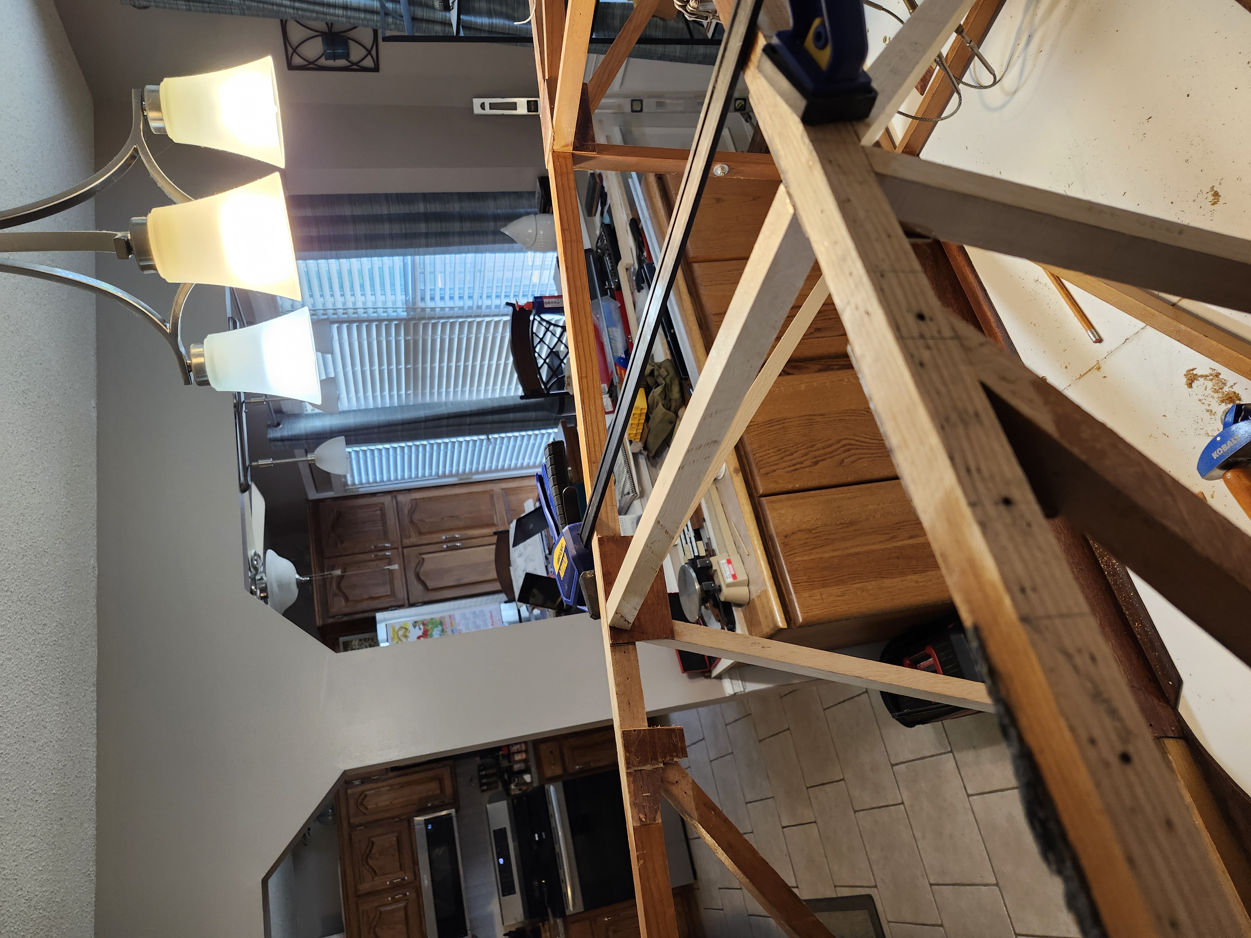

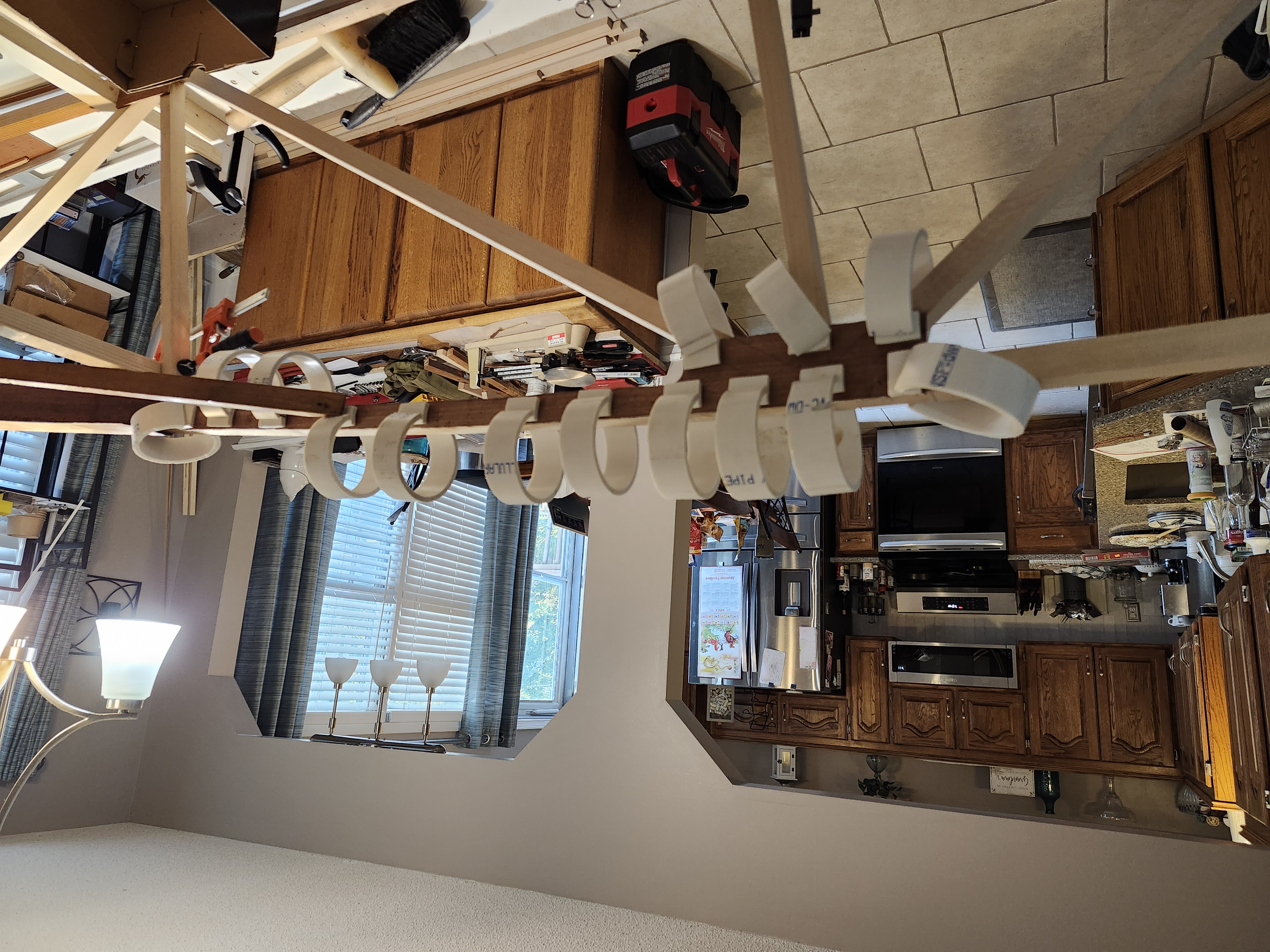

Posts: 348

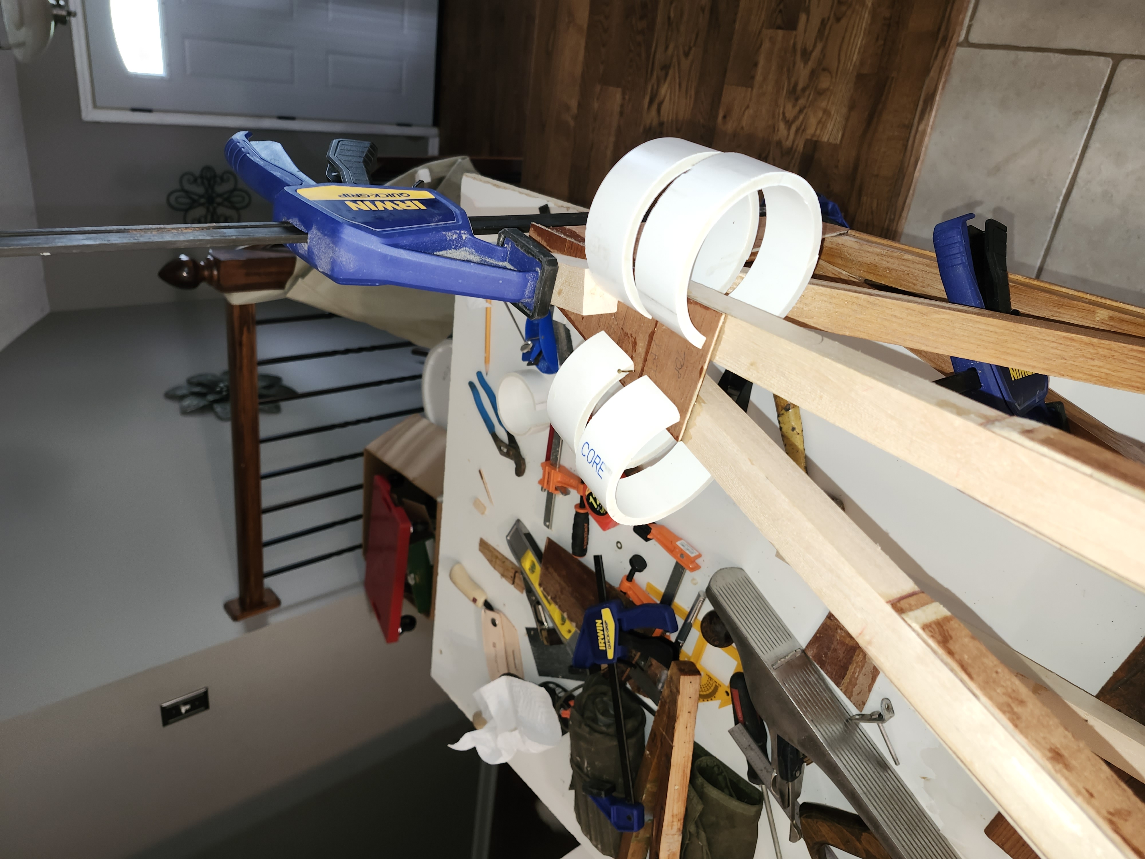

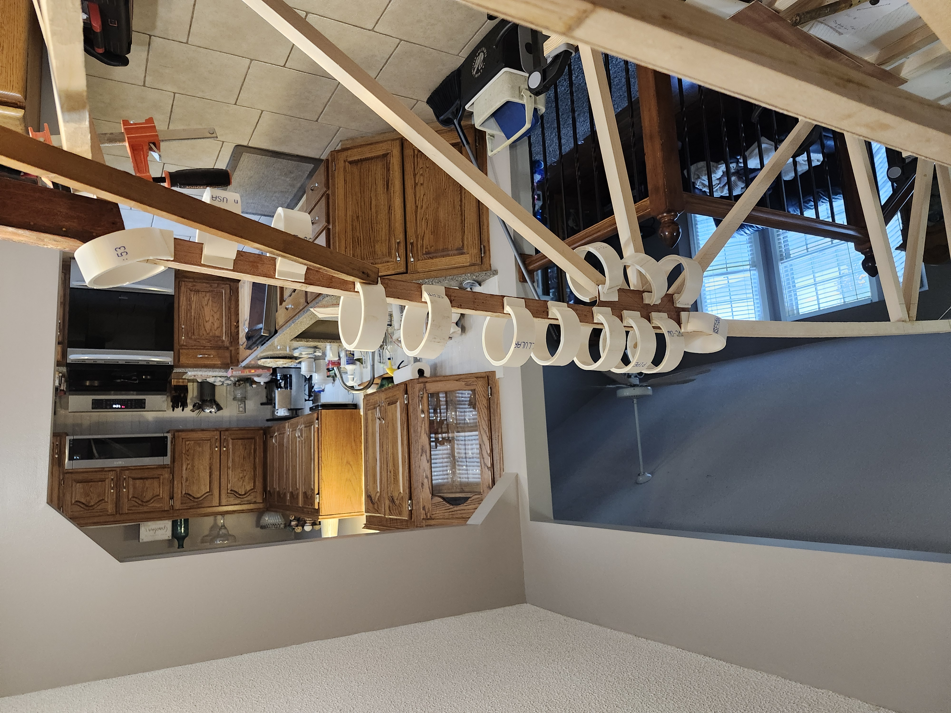

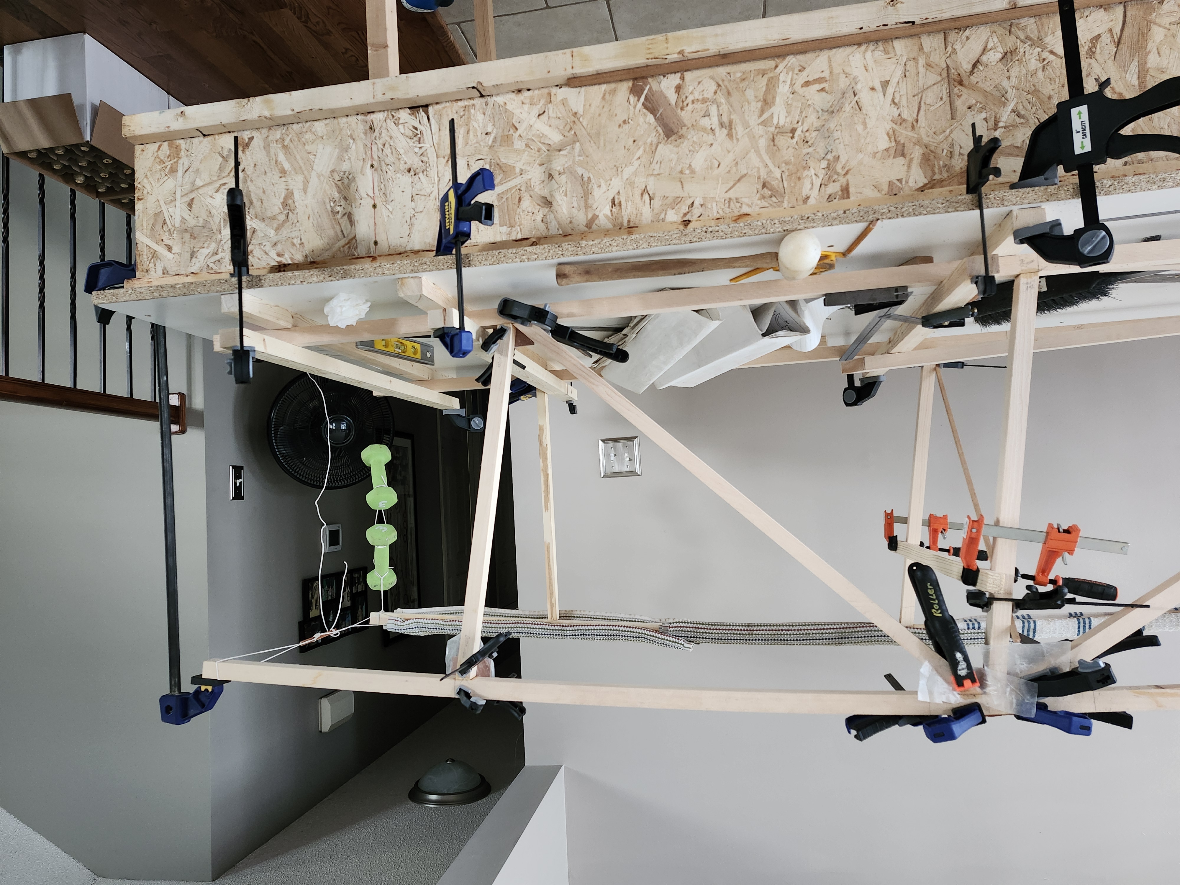

Re: N34KP's rebuild

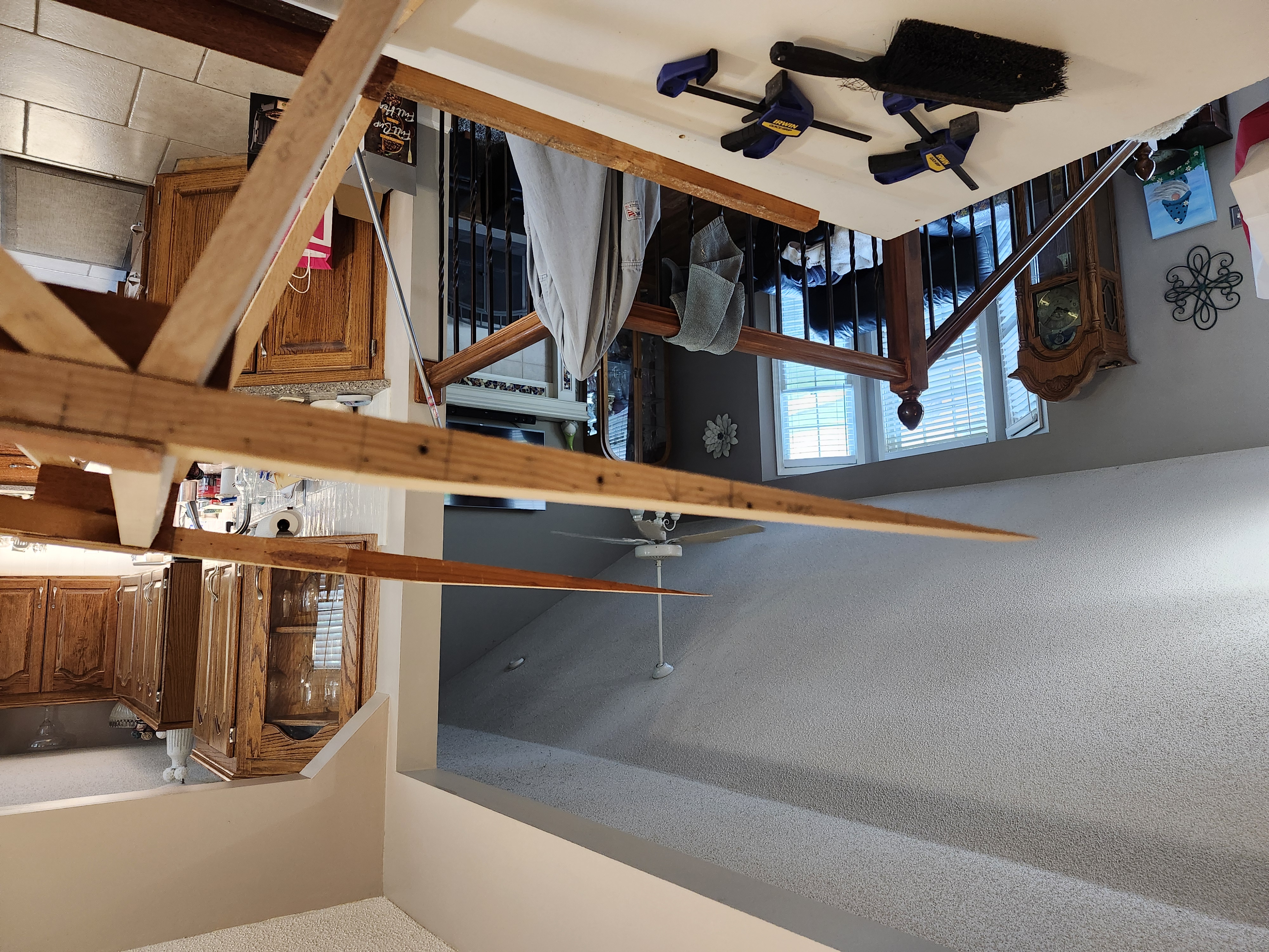

Bending a longeron. It dropped 2-1/8" at the end overnight. 6 lbs of weight hanging on the end.
Posts: 348
Re: N34KP's rebuild
Posts: 348
Re: N34KP's rebuild

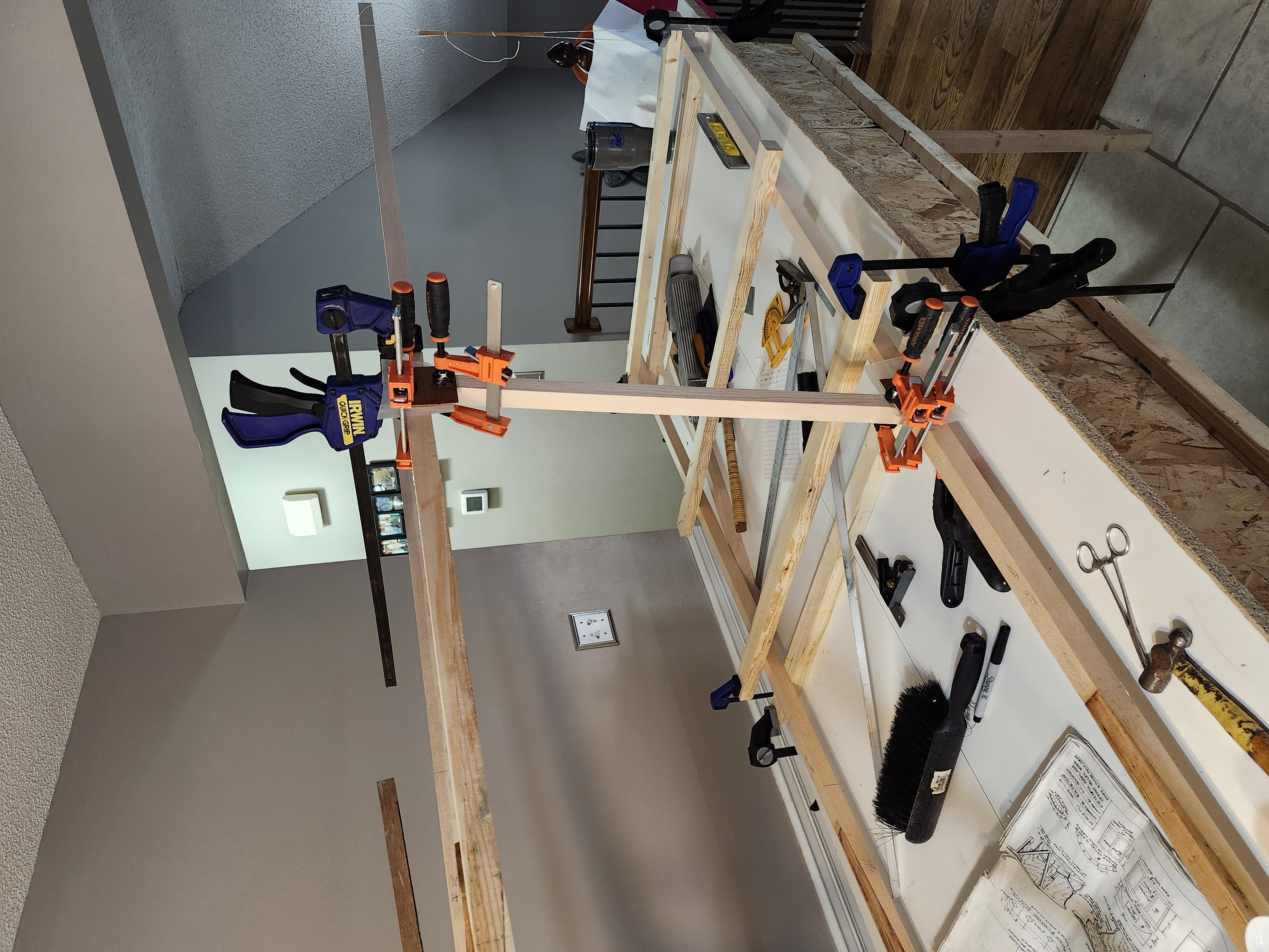

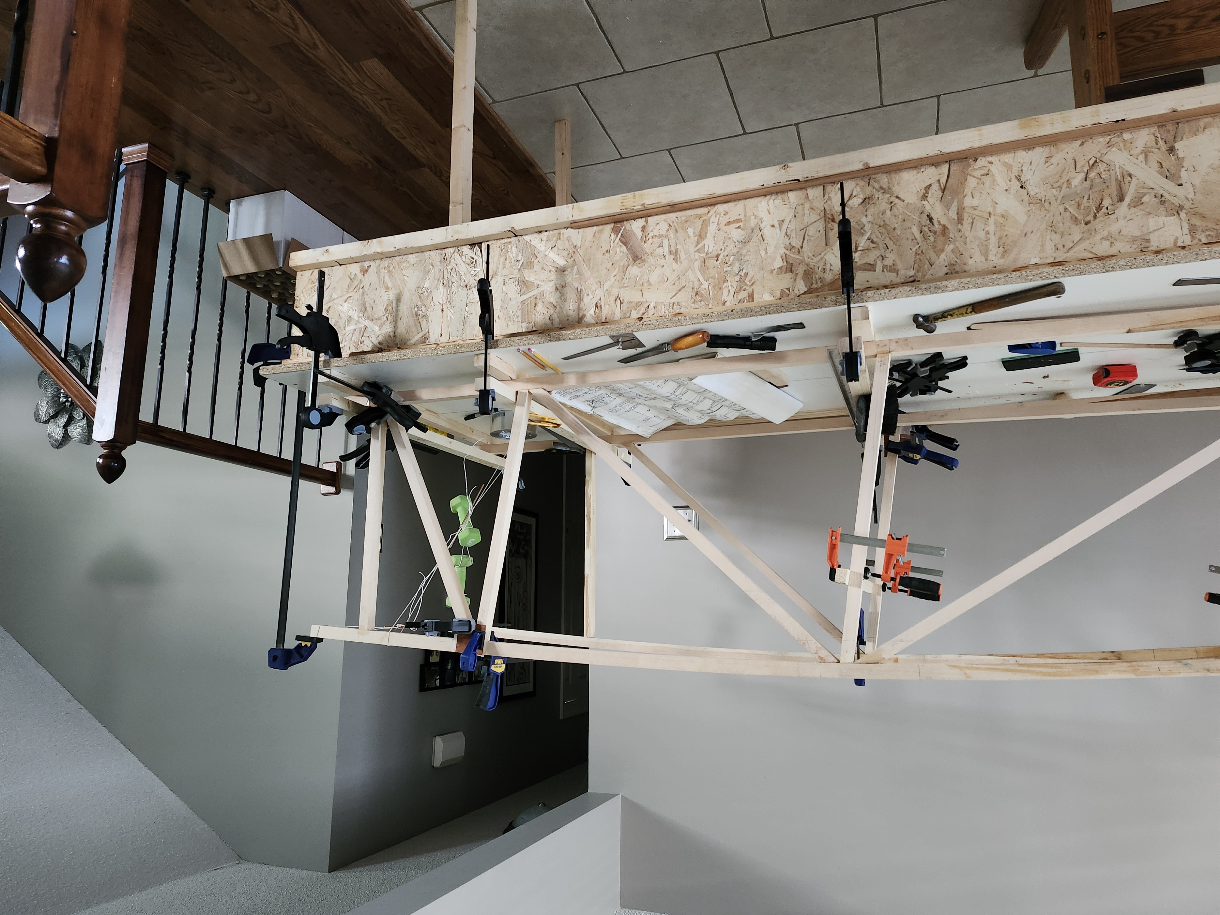

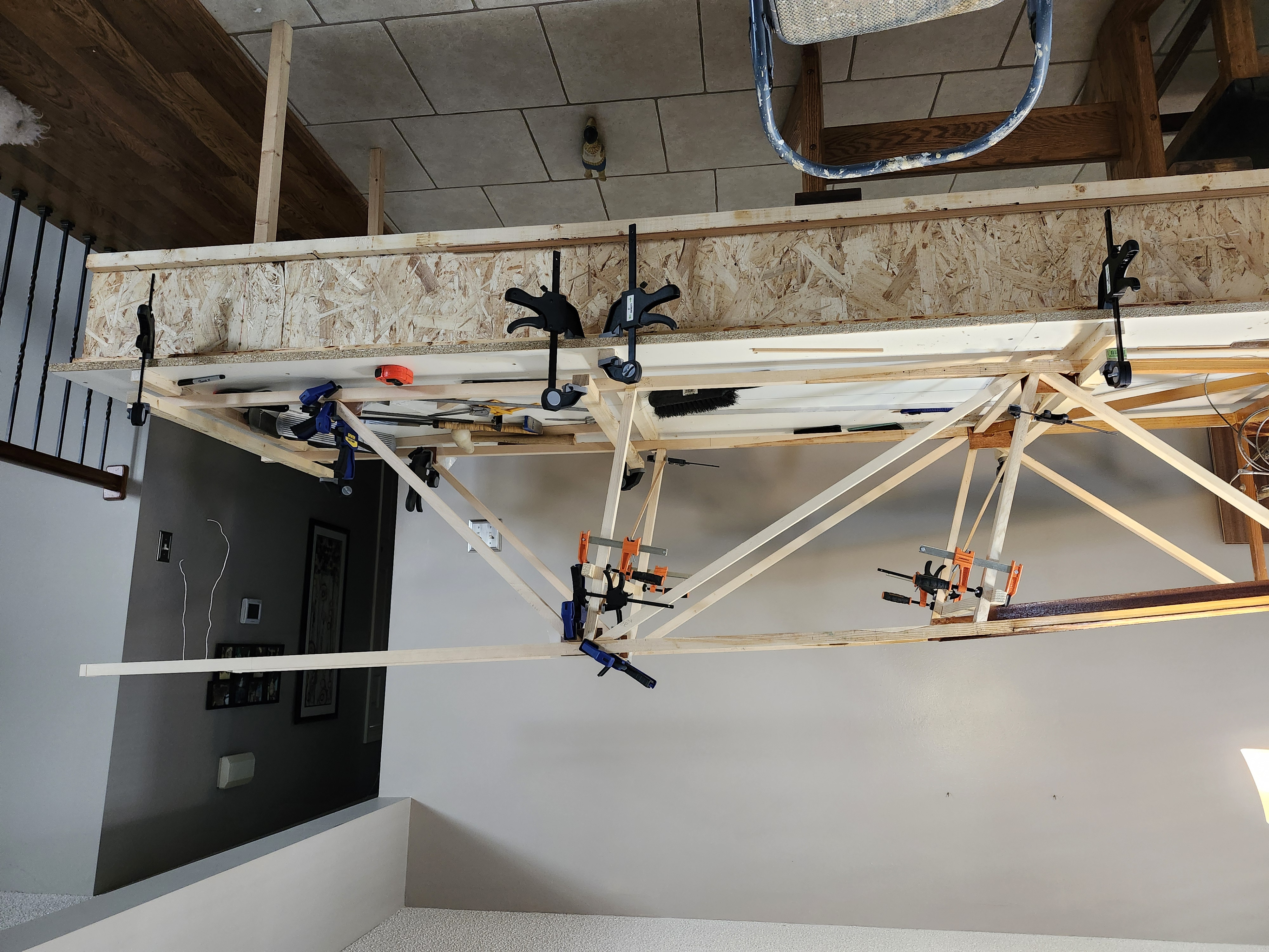

Up to the firewall on the left side.

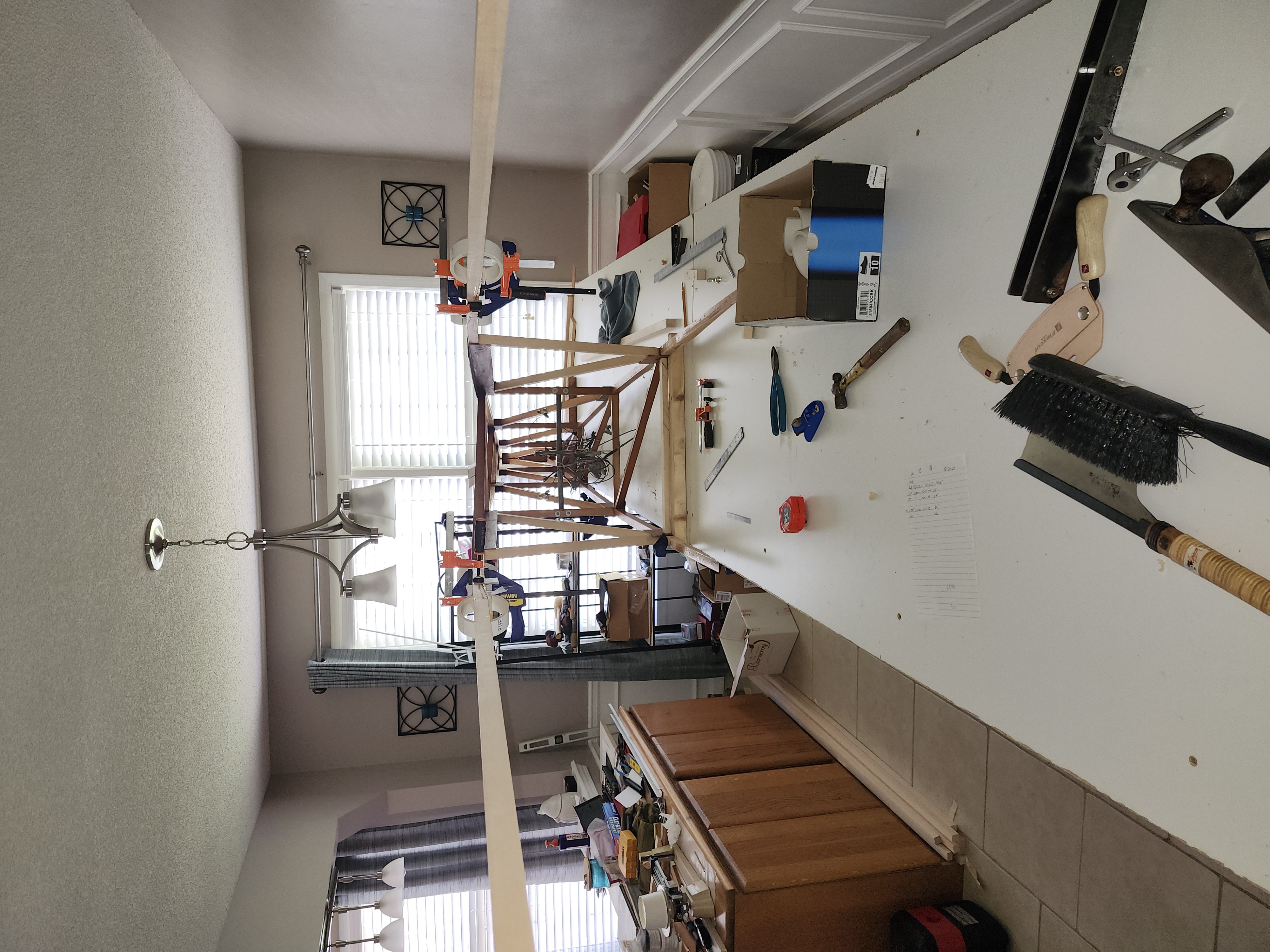

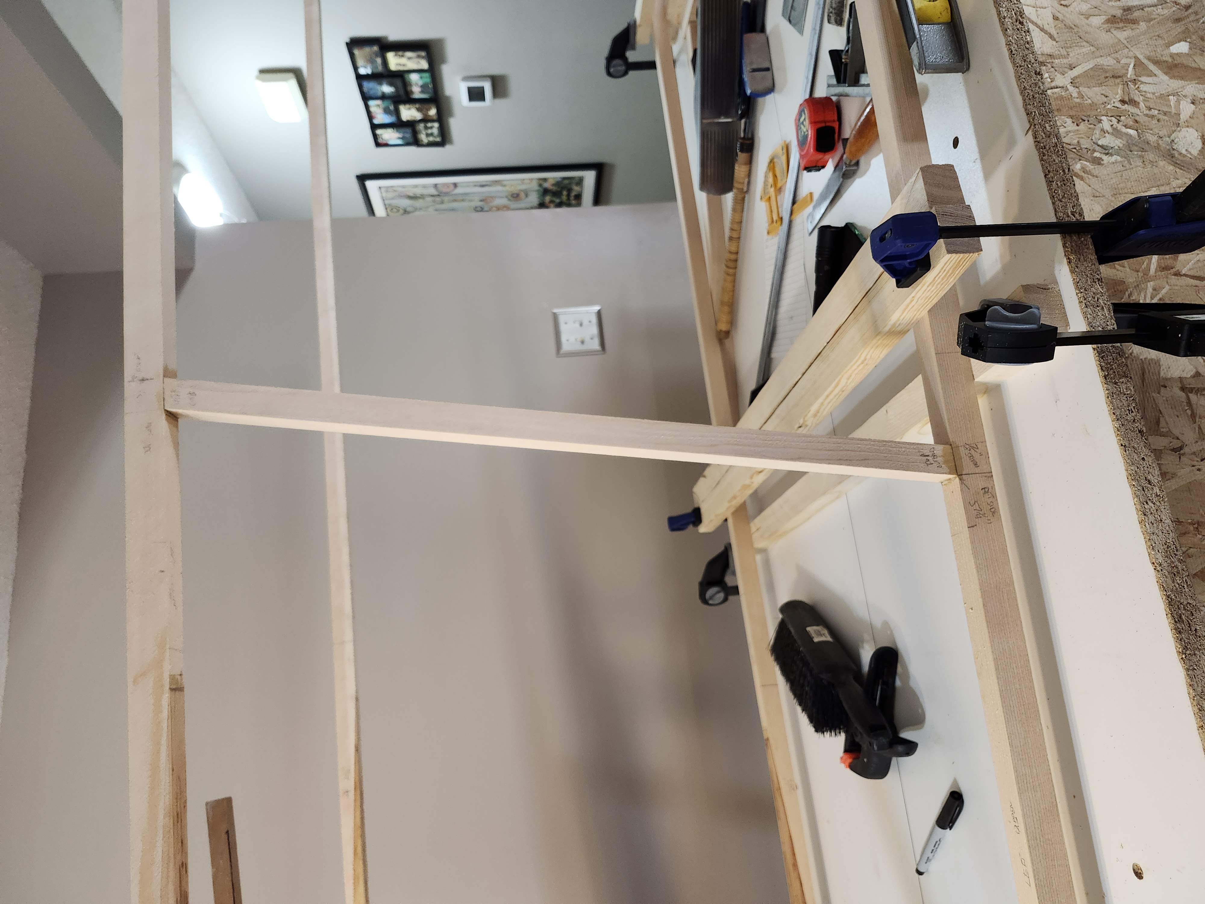

Posts: 348
Re: N34KP's rebuild
The side trusses are done. Time for inside gussets and station cross pieces.

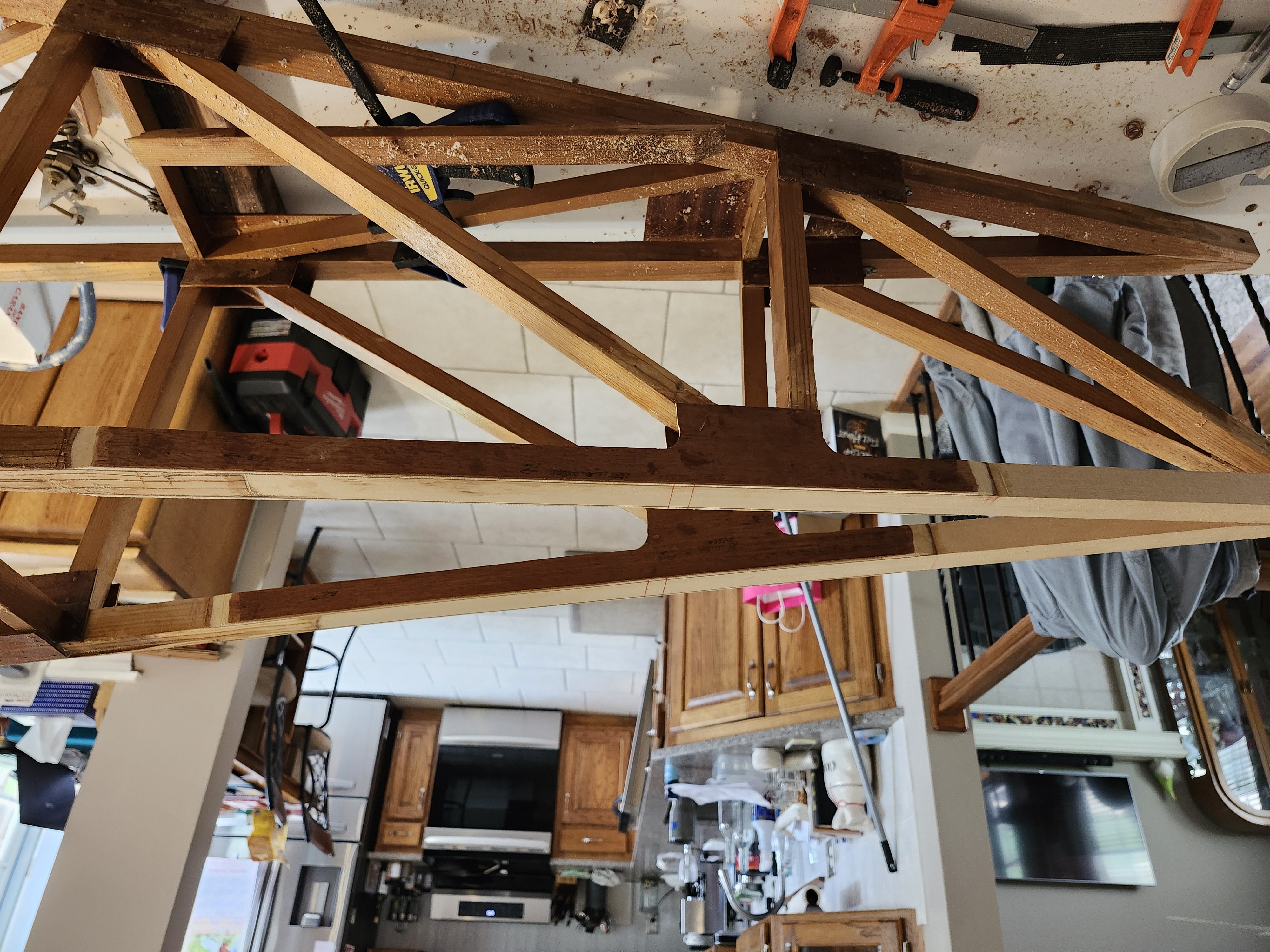

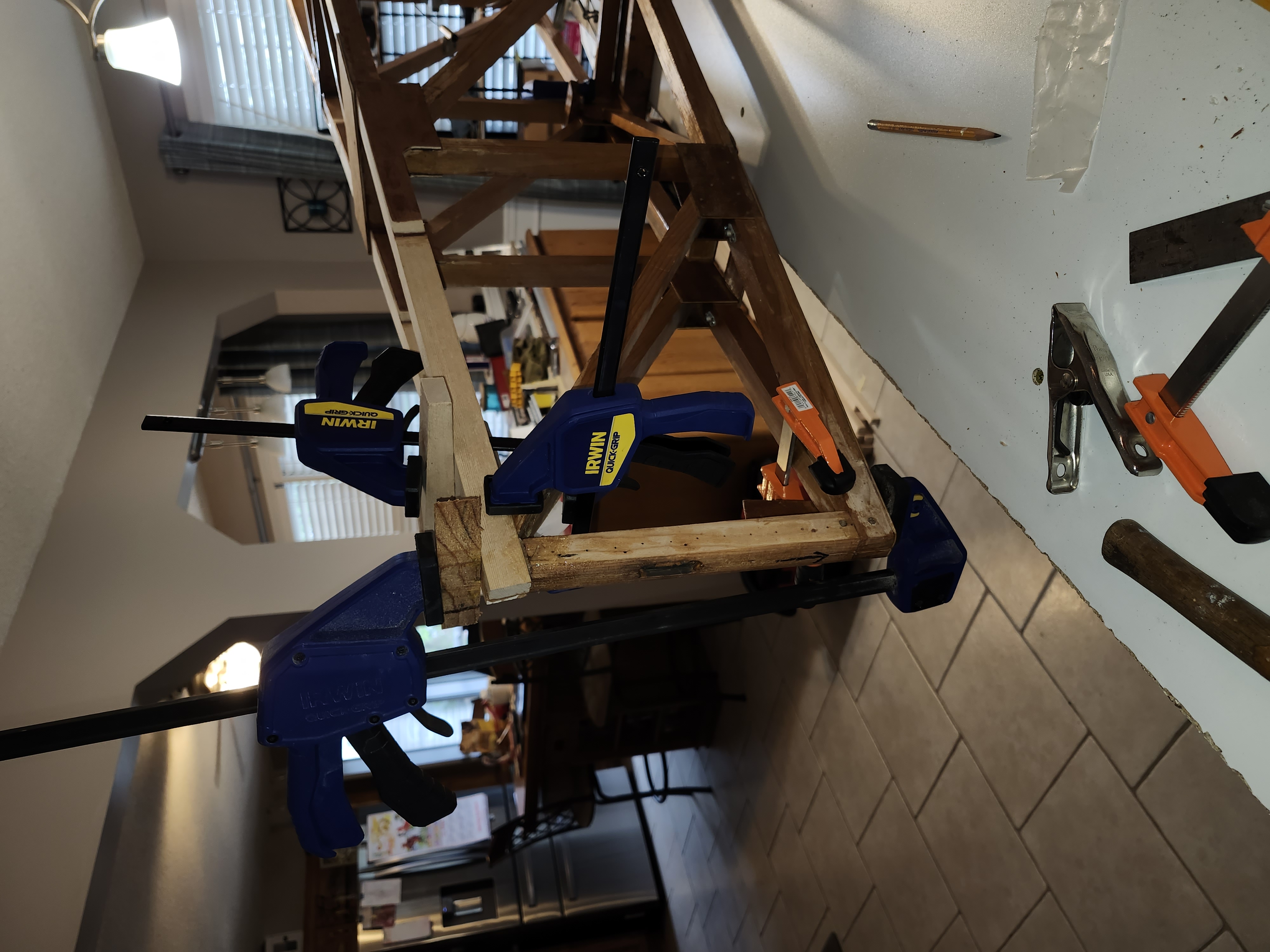

Posts: 348
Re: N34KP's rebuild

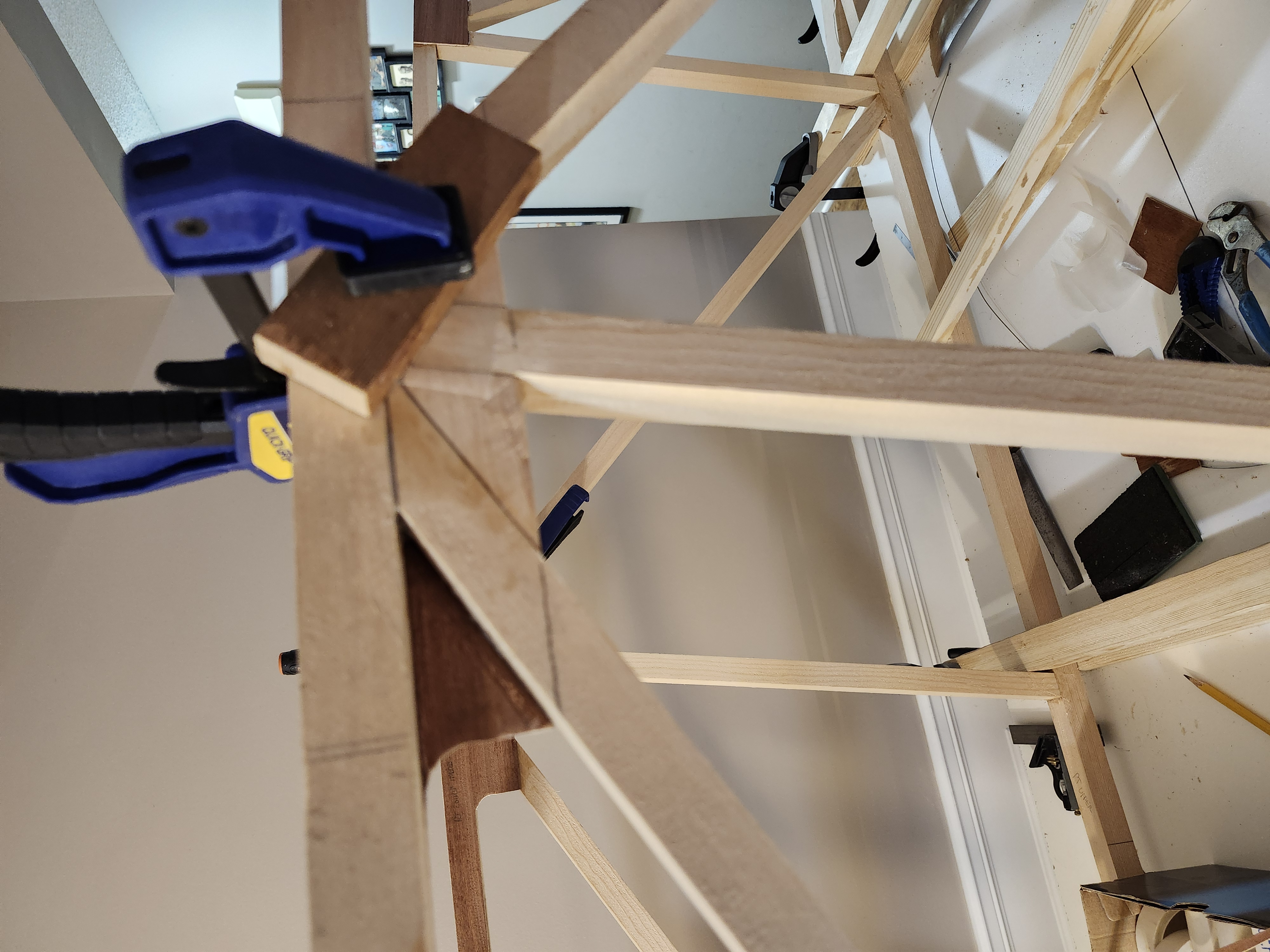

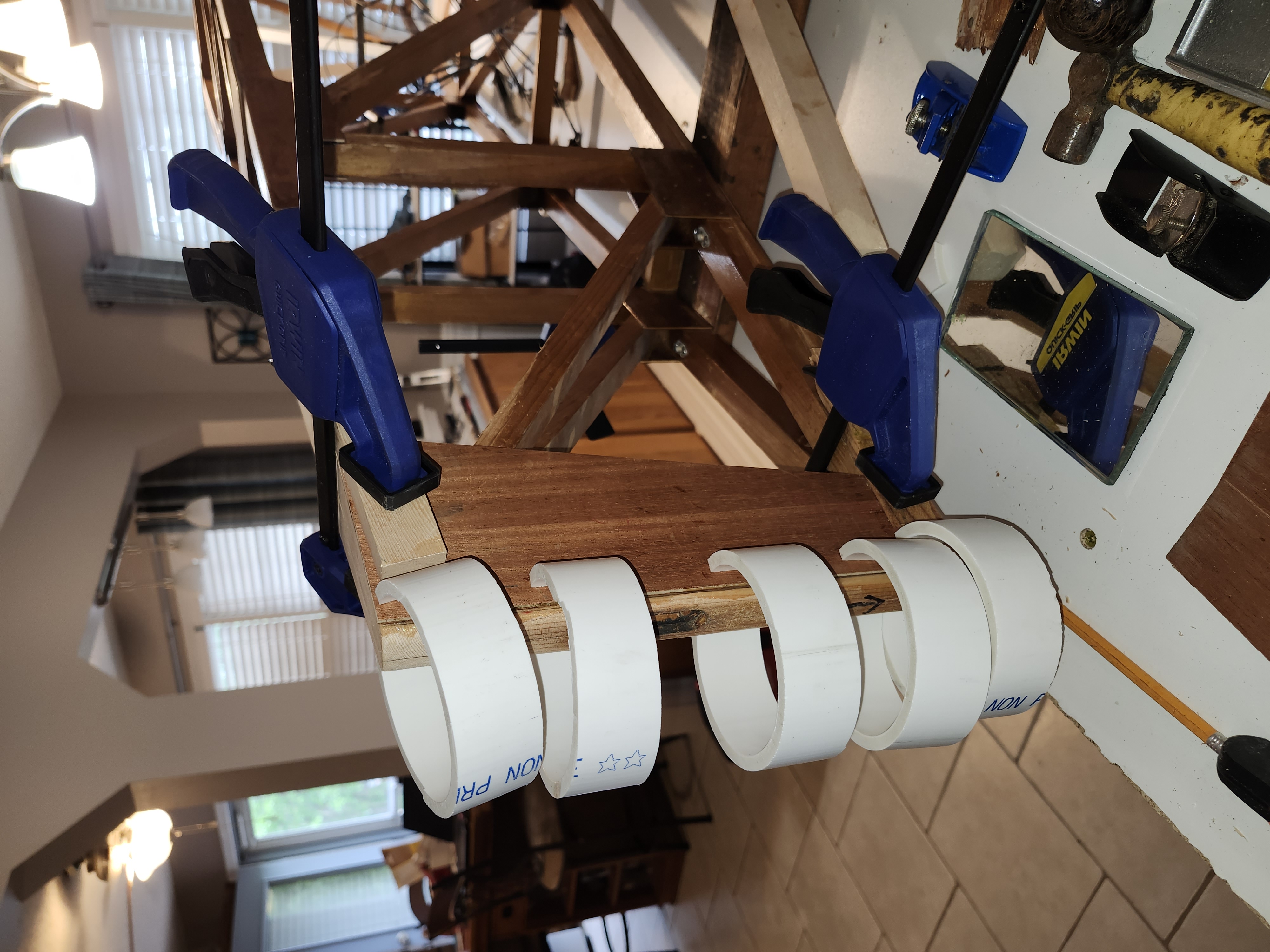

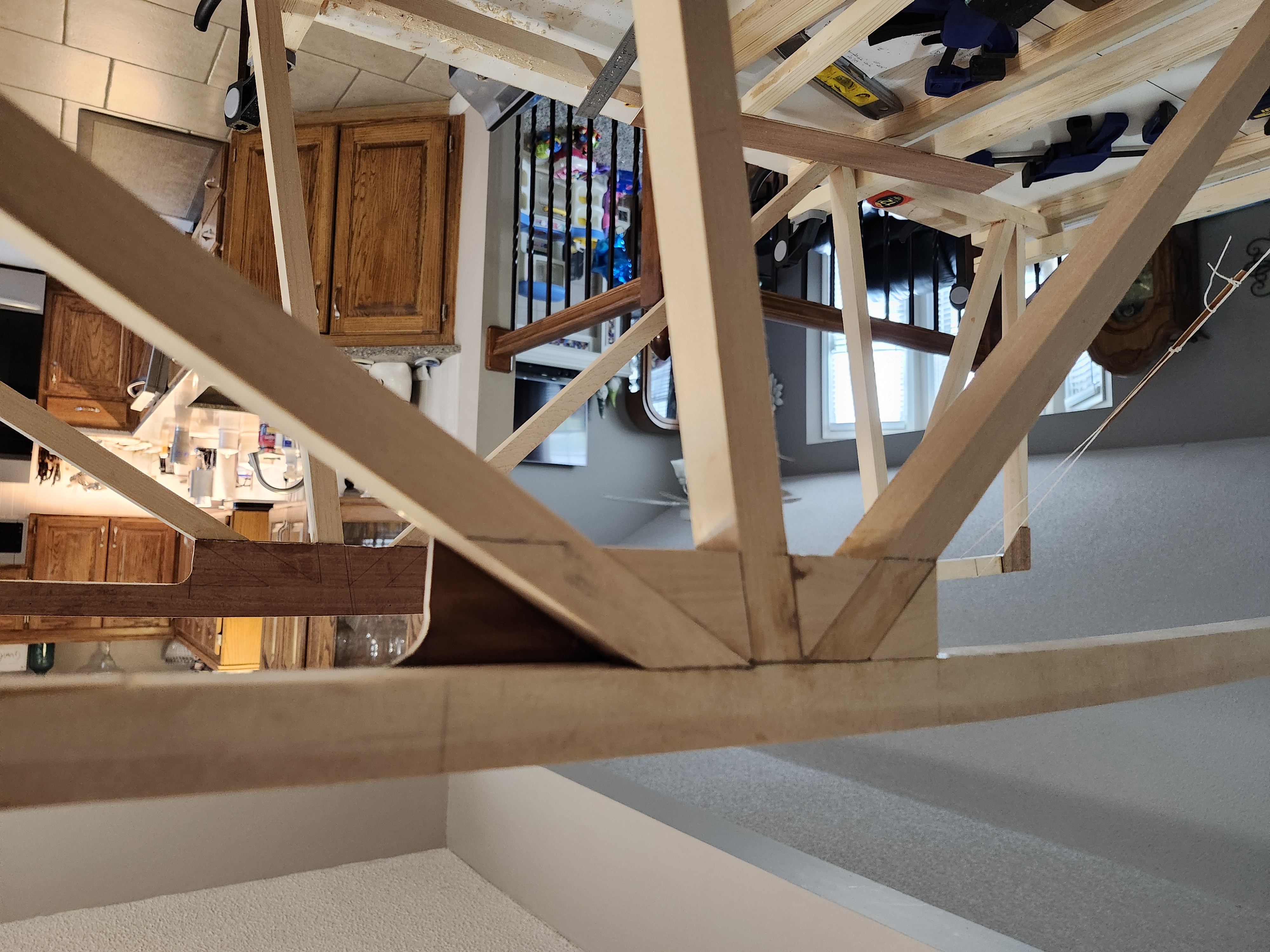

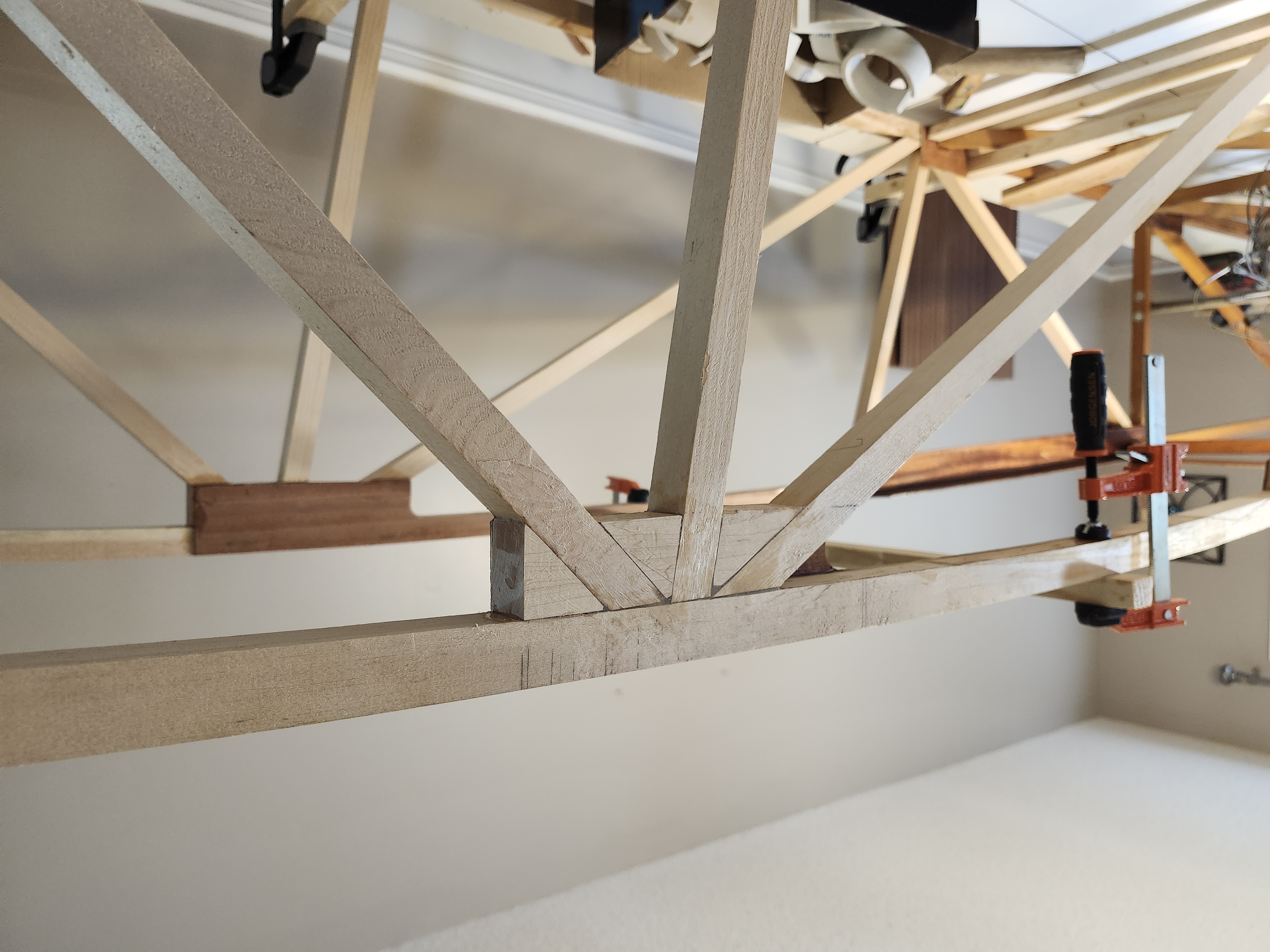

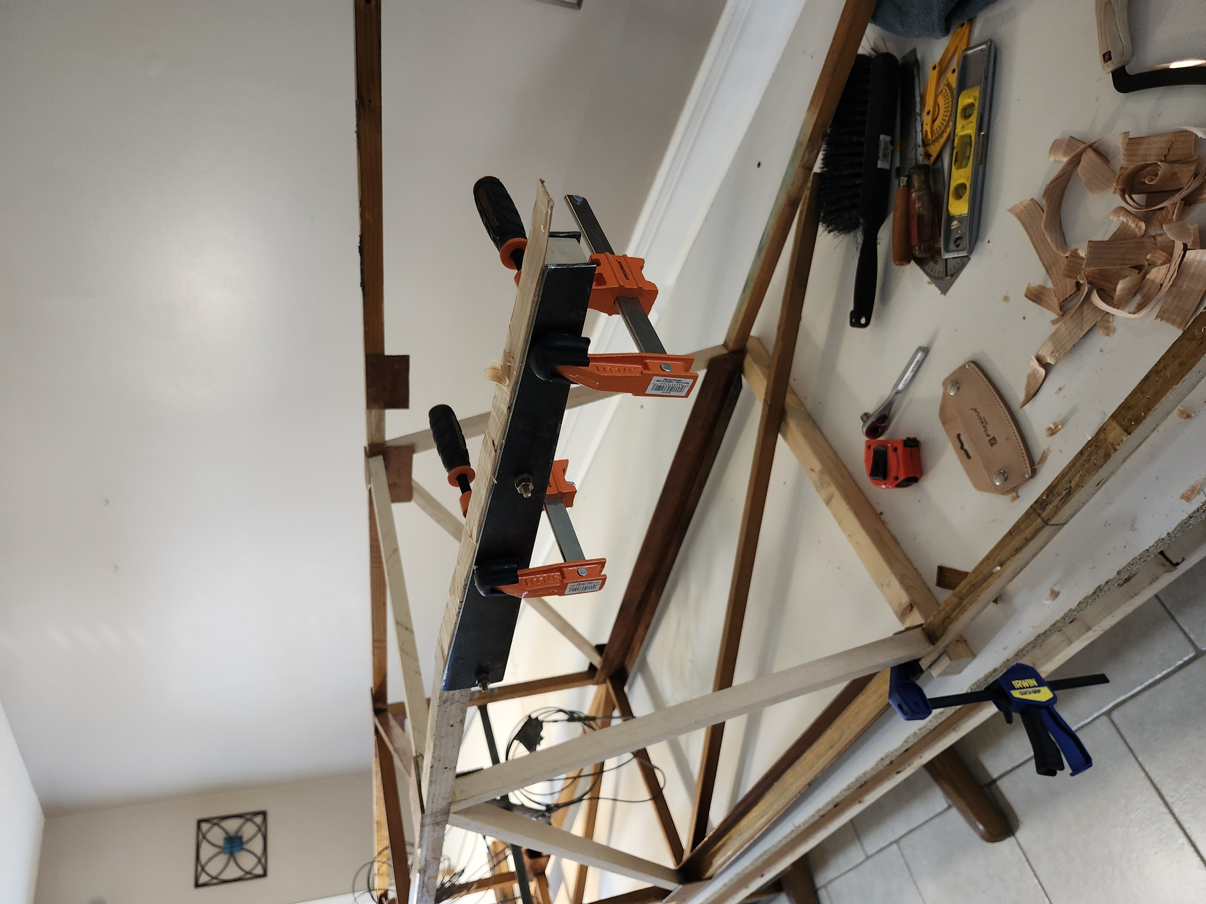

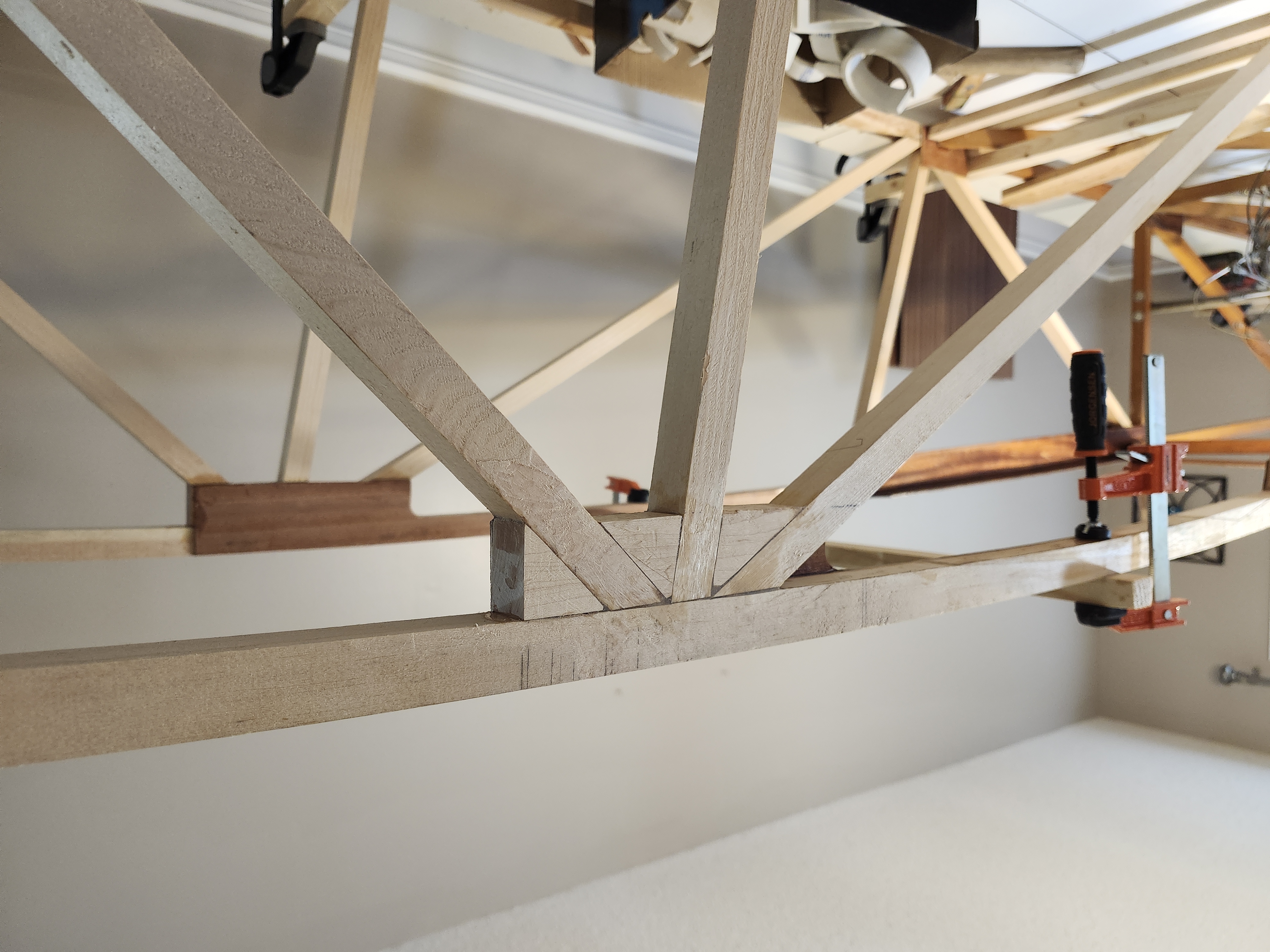

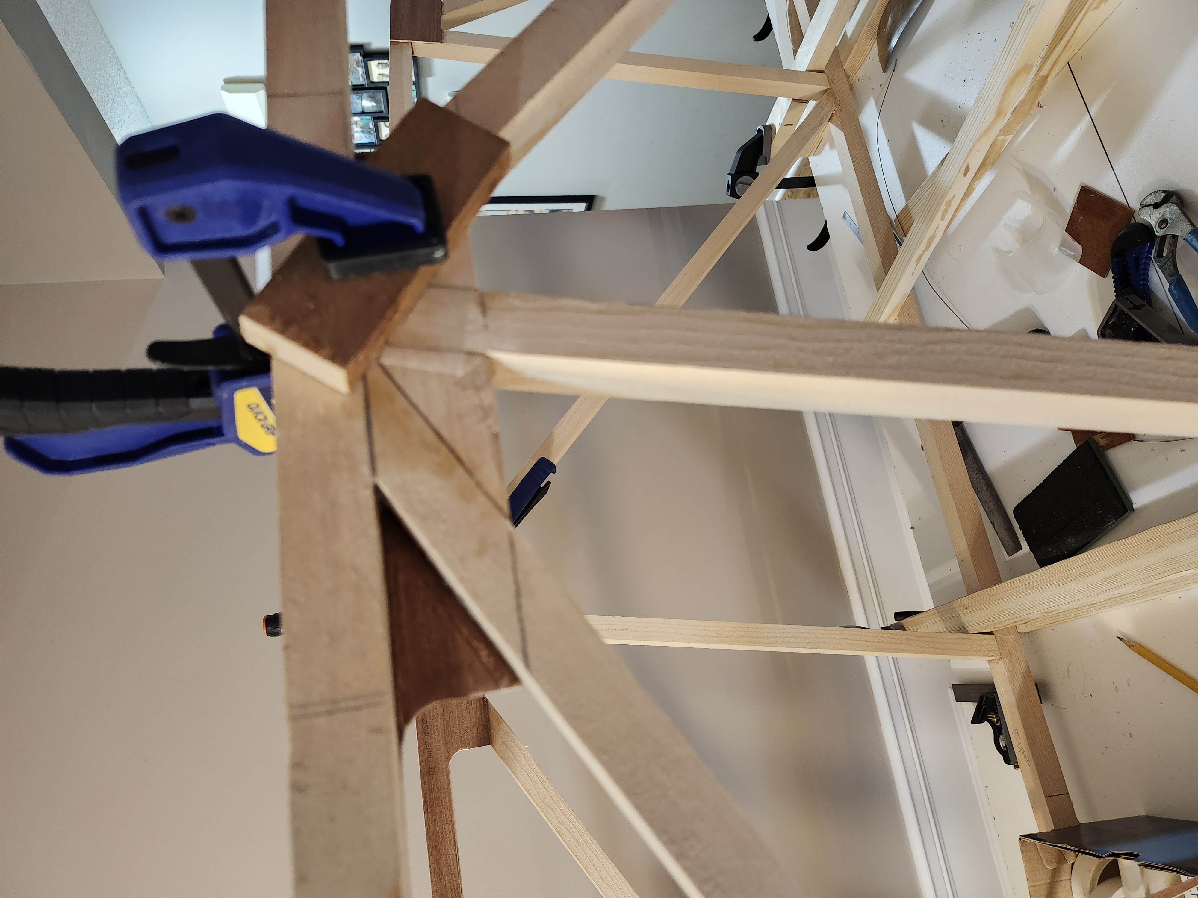

I hadn't worked on the Piet since the third week of June, due to my wife's memorial and my general lack of desire to do anything. But today I started cutting inside gussets. The one shown, inside lower right, has a long one. The gussets for the longeron splice and the station came so close together I decided to combine then. It'll be the same way on the opposite lower longeron.
Posts: 348
Re: N34KP's rebuild
After the clamps and final shaping.

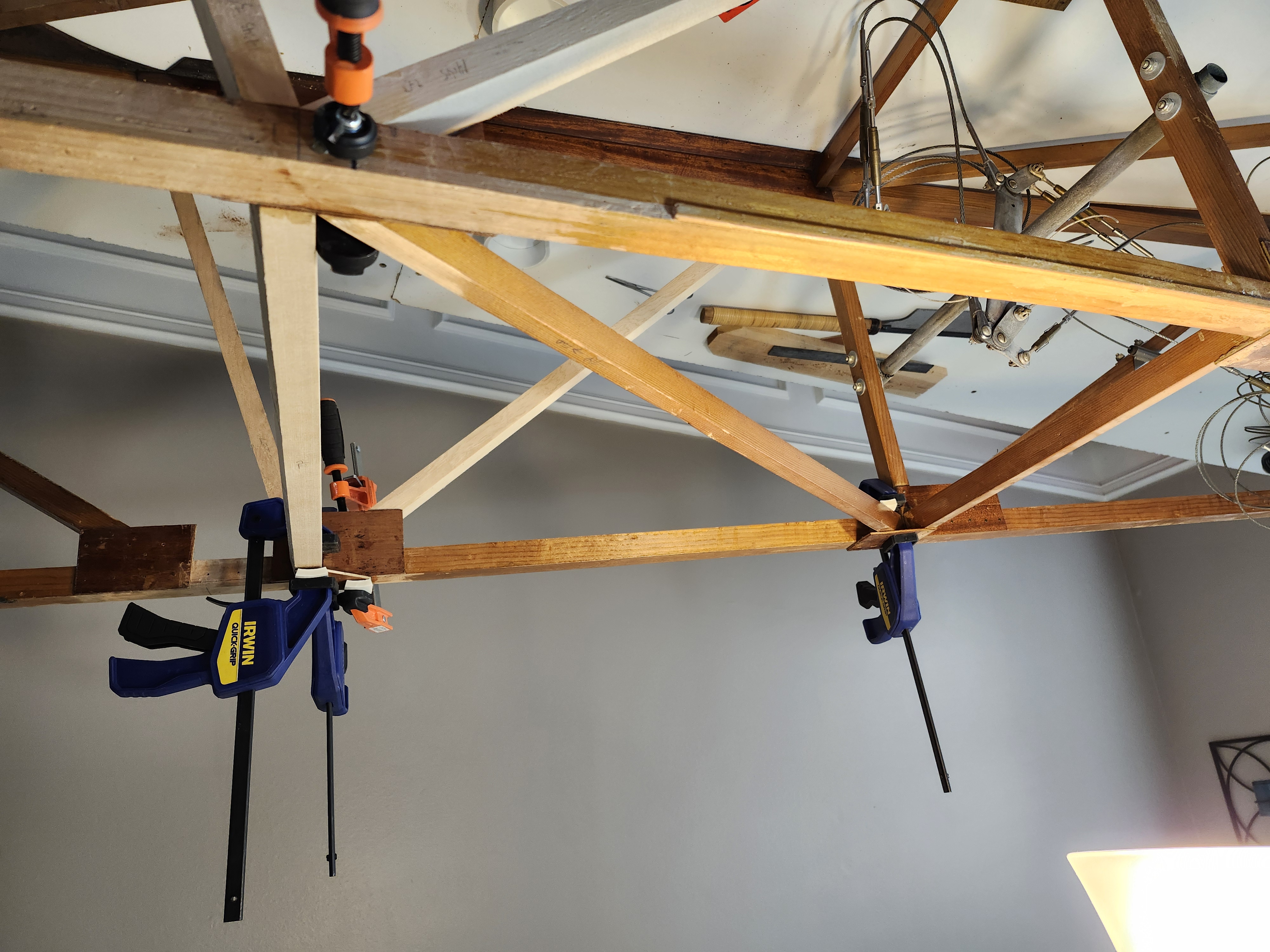

Left lower longeron splice and station.
