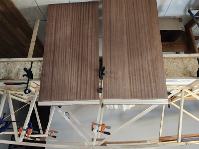

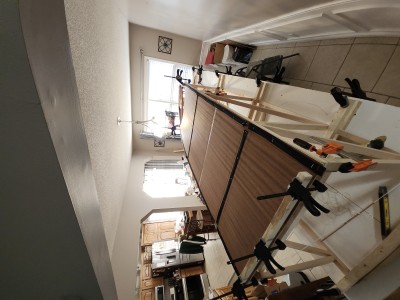

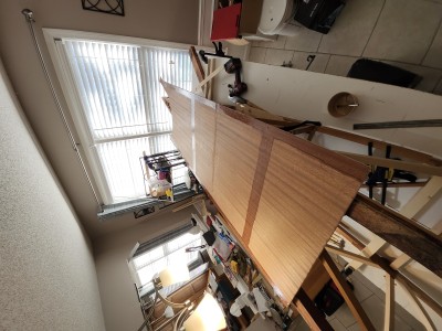

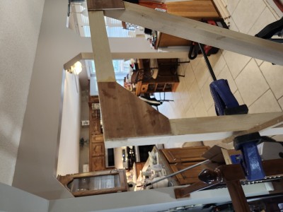

I have to scarph 2 pieces together for the floor board. Here goes nothing!

The second one (left) turned out nicer than the first. I'll clean up the first one and glue tomorrow.

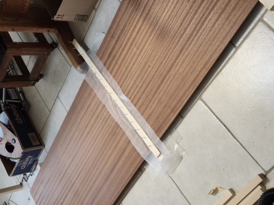

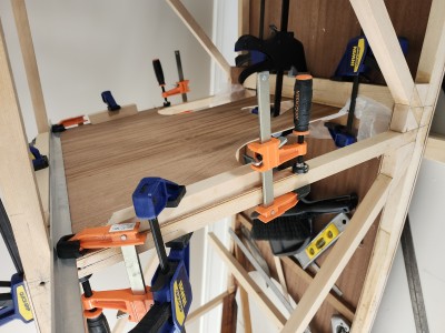

Attempting to glue the two pieces together.

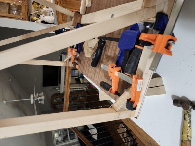

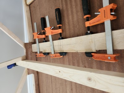

I forced myself to do something today on the Piet. I cut out the ash cross members for the landing gear and started the glueing of the forward cross piece. The floor board is ready to glue on as soon as I get the rear one in.
Posts: 319
Re: N34KP's rebuild
Forward cross piece glued in.

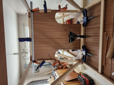

The rear crpss piece is in and I'm fitting the floor board.

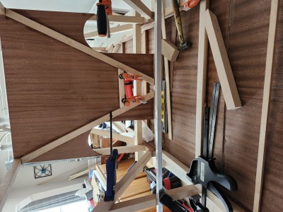

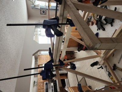

Re: N34KP's rebuild

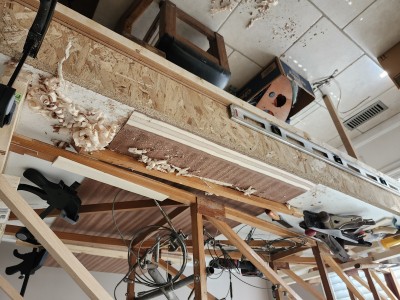

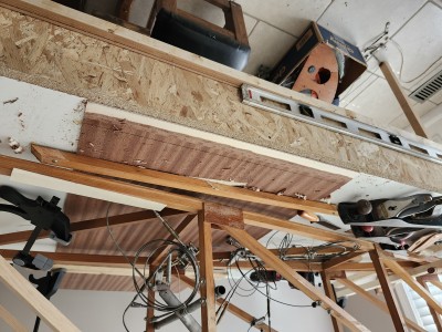

Glued the floor board on just now. No help, that was a busy 30 minutes!
Posts: 676
Re: N34KP's rebuild
They don't call it "working time" for nothing. Spread and smooth on all glue areas for all you're worth... you can feel it starting to get a little tacky... get it into place... lift and shift, align and clamp, unloosen and readjust... hurry! Hurry!. Then it's past the point of no return and you just have to clamp and staple and figure you can shave any little overhangs and squeeze-out later. Don't you love it?

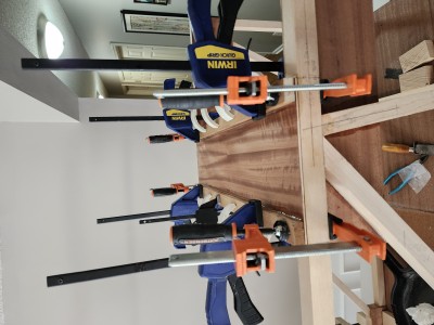

The glue up on the floorboard worked well. I've planed the edges flush and removed the staples. Several staples broke while trying to remove them. Glued in I guess. I'll have to think about this a little.

I wonder if you could heat the staple with a soldering iron to soften the epoxy locally?
Posts: 319
Re: N34KP's rebuild
I'm going to ignore the broken staples. They broke off flush with the plywood, and I can't get hold of them short of digging away some of the plywood.

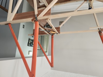

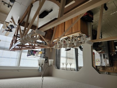

Slow progress. I've flip the fuselage back upright and started the last gussets. Currently glueing the last two inboard splice doublers.

Plugging along.

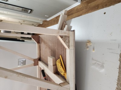

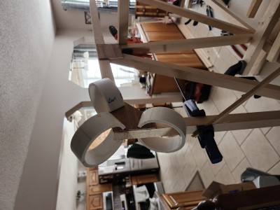

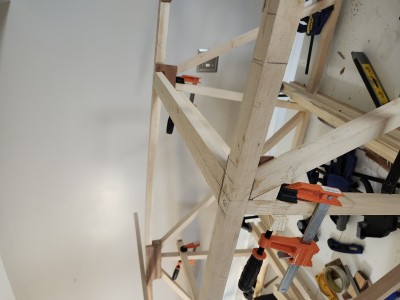

I decided to block the corners of the firewall station truss.

I'll bet that fuselage frame is stiffening up nicely, what with the blocking and crosspieces and gussets getting installed. One of the most comforting things about a Piet is the robustness of its basic structural 'cage'.

Yes. It's getting pretty sturdy even without the side plywood.

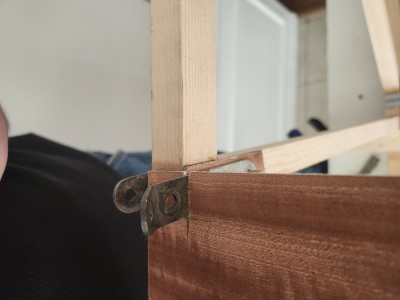

While test fittings controls today, I discovered the aileron torque tube between cockpits was bent a little in the crash. Always something.
Posts: 319
Re: N34KP's rebuild
Test fitting rear cabane attach fittings in the upper longerons. Nice fit.

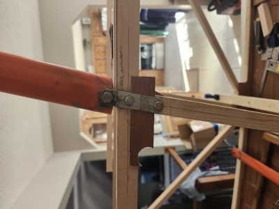

Posts: 319
Re: N34KP's rebuild
Test fitting cabane attach fittings in the upper longerons. Nice fit.

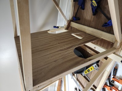

Test fitting the front cockpit seat back.
Posts: 319
Re: N34KP's rebuild

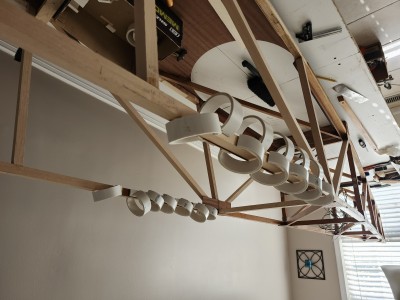

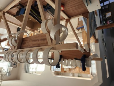

I glued a wedge into the area of the seat back to the gear/liftstrut carry though. Also cutout the torque tube opening.

Richard; the area that I had some problems with over the years that I flew N41CC was the front seat's front face vertical support plywood. On more than one occasion it got kicked by the pilot hard enough to break the plywood free (not by me though). I finally ended up tearing out the entire assembly including the passenger's seat bottom, which didn't have adequate uprights to hold it up, in my opinion. Especially as I had a passenger over 200 lbs get in and out of the front by stepping onto the seat. It didn't give under his weight and strain to climb in, but I didn't want it to. For the front face plywood, I added a block outside the front face of it, secured to the floor.

Glued up and curing.
Posts: 319
Re: N34KP's rebuild
Done.
Posts: 676
Re: N34KP's rebuild
I see that little wedge shim filler at the bottom ;) Nice work.
