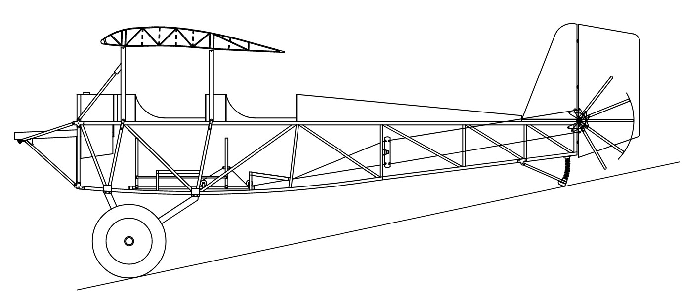

Just for the heck of it and for studying where things are relative to one another with the plane in the straight and level position, I've attached a plot of a CAD layout that I did of a conventional Air Camper pretty much by the plans (no brakes; Ford A engine mount; vertical cabanes)- except that I added the forward fuel tank that is on 41CC just to see where it fell relative to the axle, wing, and everything else. I don't think that a Ford can be installed with a fuel tank in that location though.
- Posts: 346
Re: Oddly Sized Piet Fuse
The tank would be in the magneto bay.
