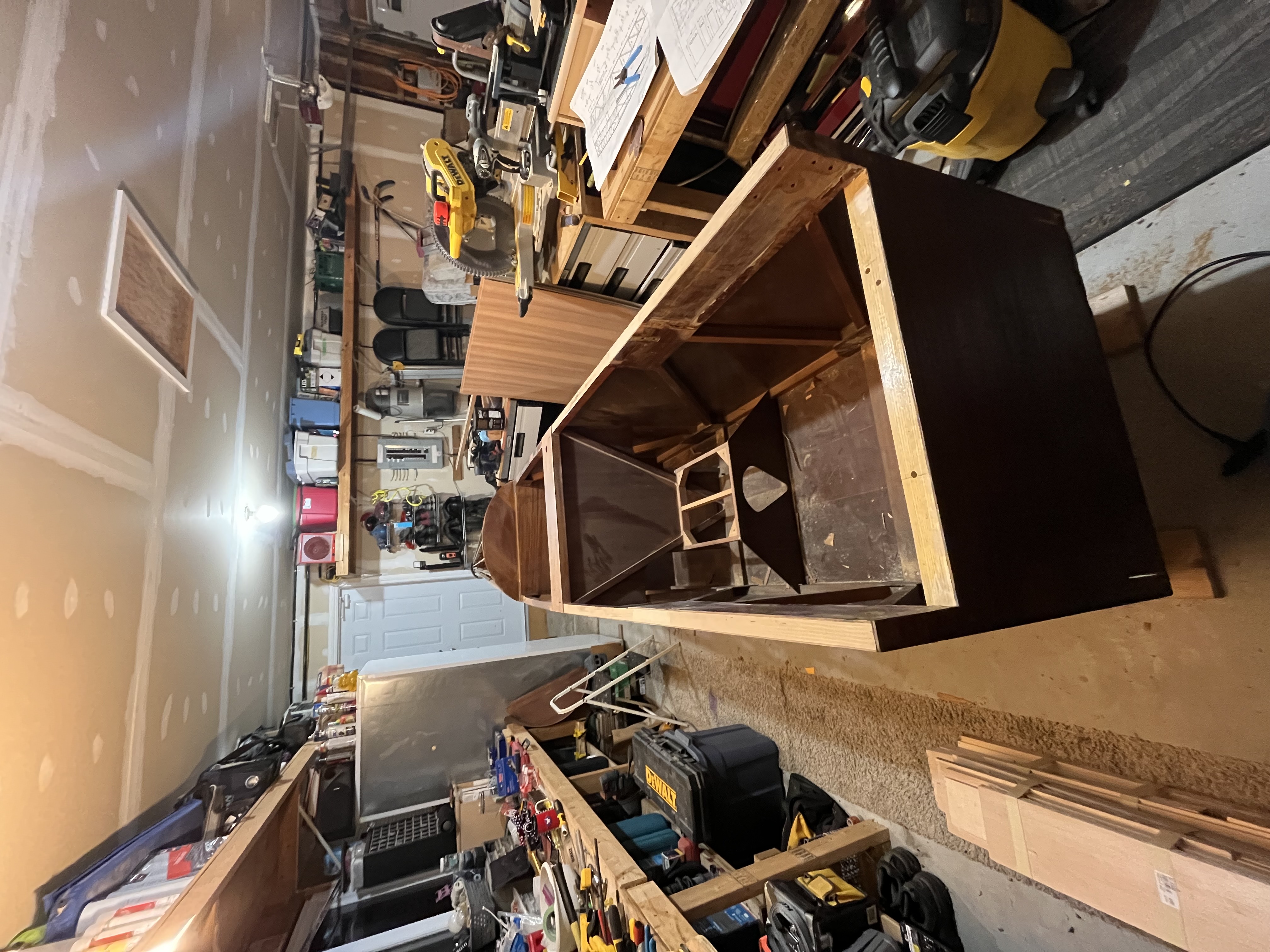

I’m not at home now so can’t take a pic but here’s one that shows at an angle. The first vertical support you see on the right side is set back 20” from the firewall.
I’m located in Brampton, ON.
Chris
Chris

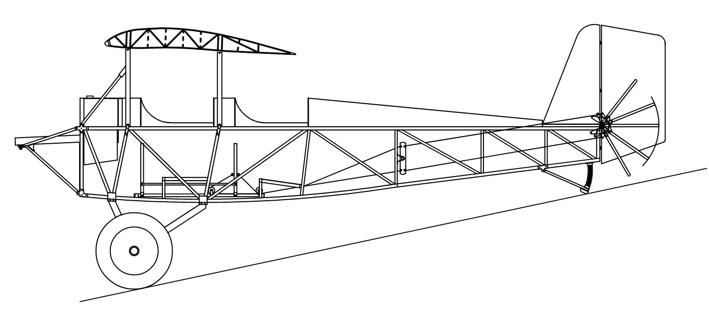

Just for the heck of it and for studying where things are relative to one another with the plane in the straight and level position, I've attached a plot of a CAD layout that I did of a conventional Air Camper pretty much by the plans (no brakes; Ford A engine mount; vertical cabanes)- except that I added the forward fuel tank that is on 41CC just to see where it fell relative to the axle, wing, and everything else. I don't think that a Ford can be installed with a fuel tank in that location though.
- Posts: 365
Re: Oddly Sized Piet Fuse
The tank would be in the magneto bay.
