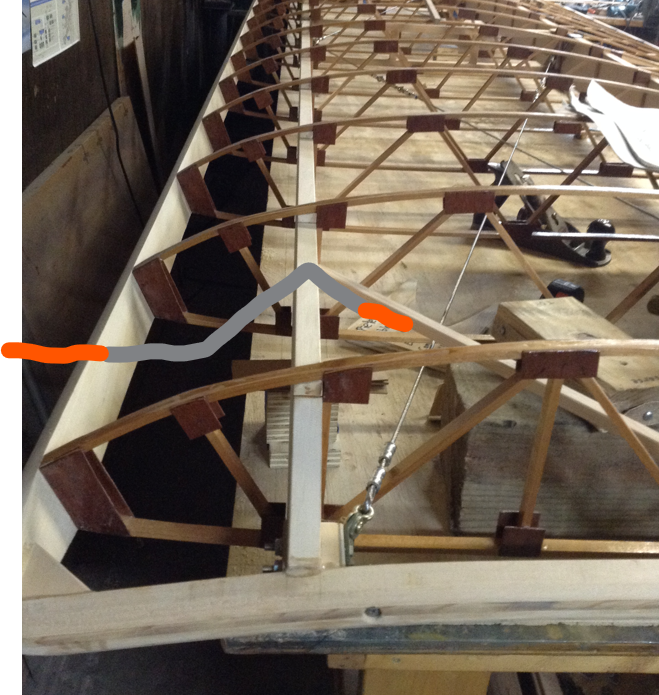

I overthought this alot on my build, but it seems to have worked out well. I drilled a 3/8 hole in the leading edge, and epoxied in a 3/8 aluminum tube that is bent to go over the spar. I then threaded a piece of 1/4" brass tubing to thread in both ends. The aluminum tube is cut off flush with the leading edge, which makes covering a breeze. The plastic tubing that runs to the cockpit is fastened behind the front spar, which makes access through one of the inspection holes possible. And I figure if the pitot tube ever gets bent, I simply unscrew it and screw a new one in. Oh, and I used one of those wind operated flappers to keep the bugs out when it's parked in the hangar. Somehow I don't have pictures of it, but maybe my sketch will help.
Posts: 95
Re: Pitot tube
I did mine similarly. But, I poked it out at about the jury strut location. That is too close inboard though I think. Whenever I do my run up I register 20 knots on my airspeed indicator.
