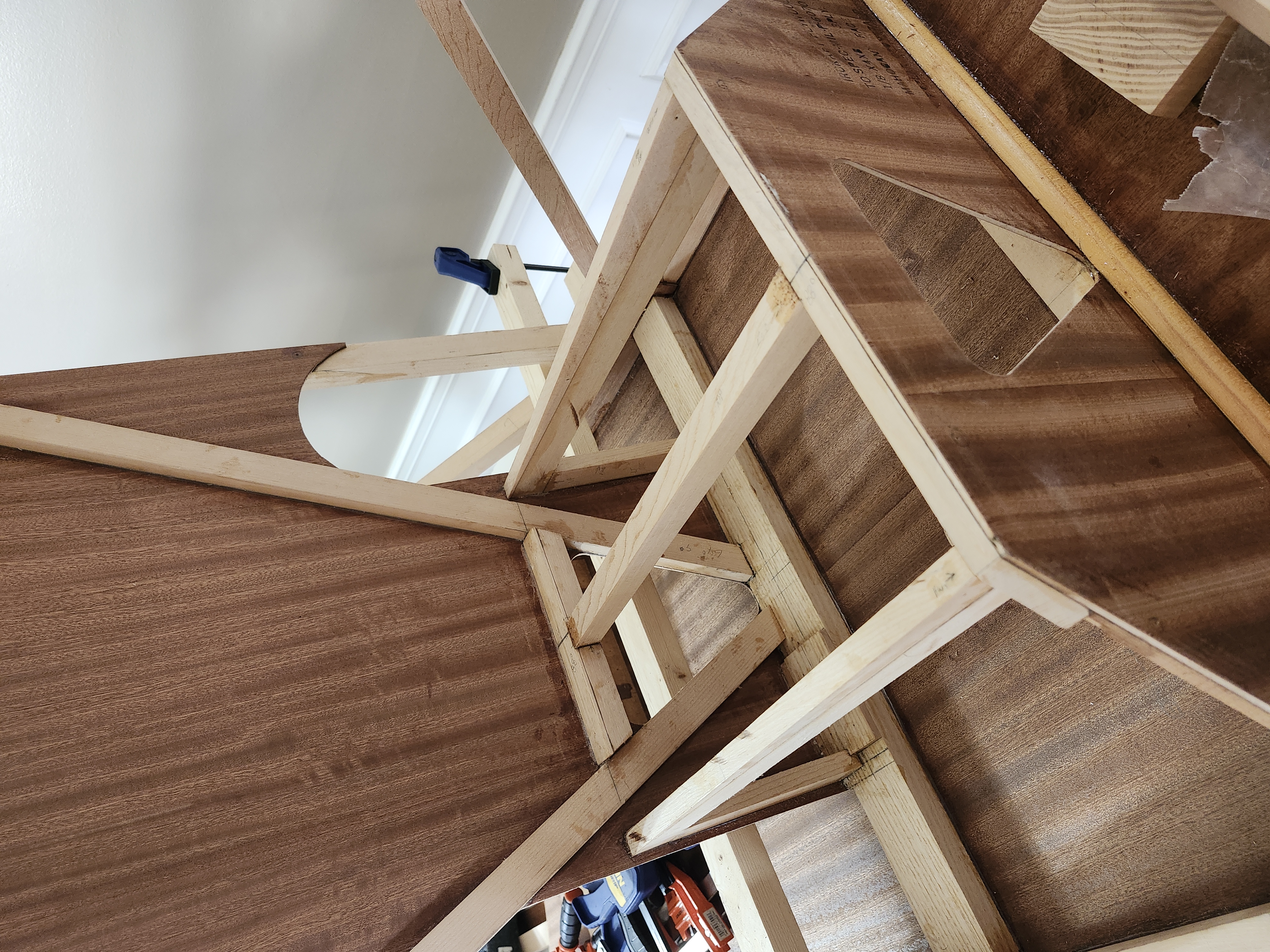

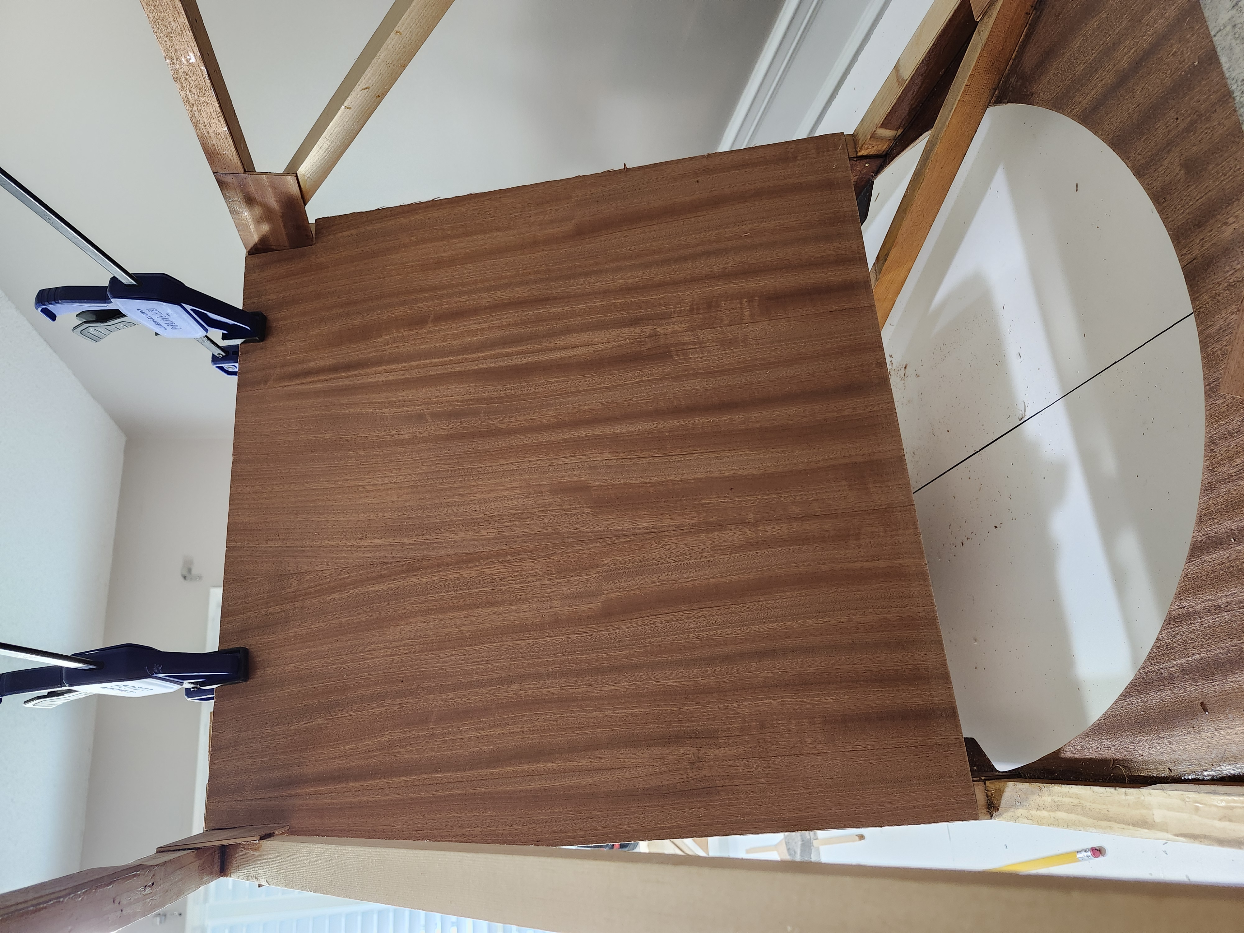

The same happened to NX41CC. I repaired the seat front twice during the time that I owned the plane, and the last time I did that I also added some supplementary framing similar to what you've done to provide more glued surface area to transfer the load from the plywood to the framing. I should also have used heavier plywood for the seat front as long as I was redoing it.

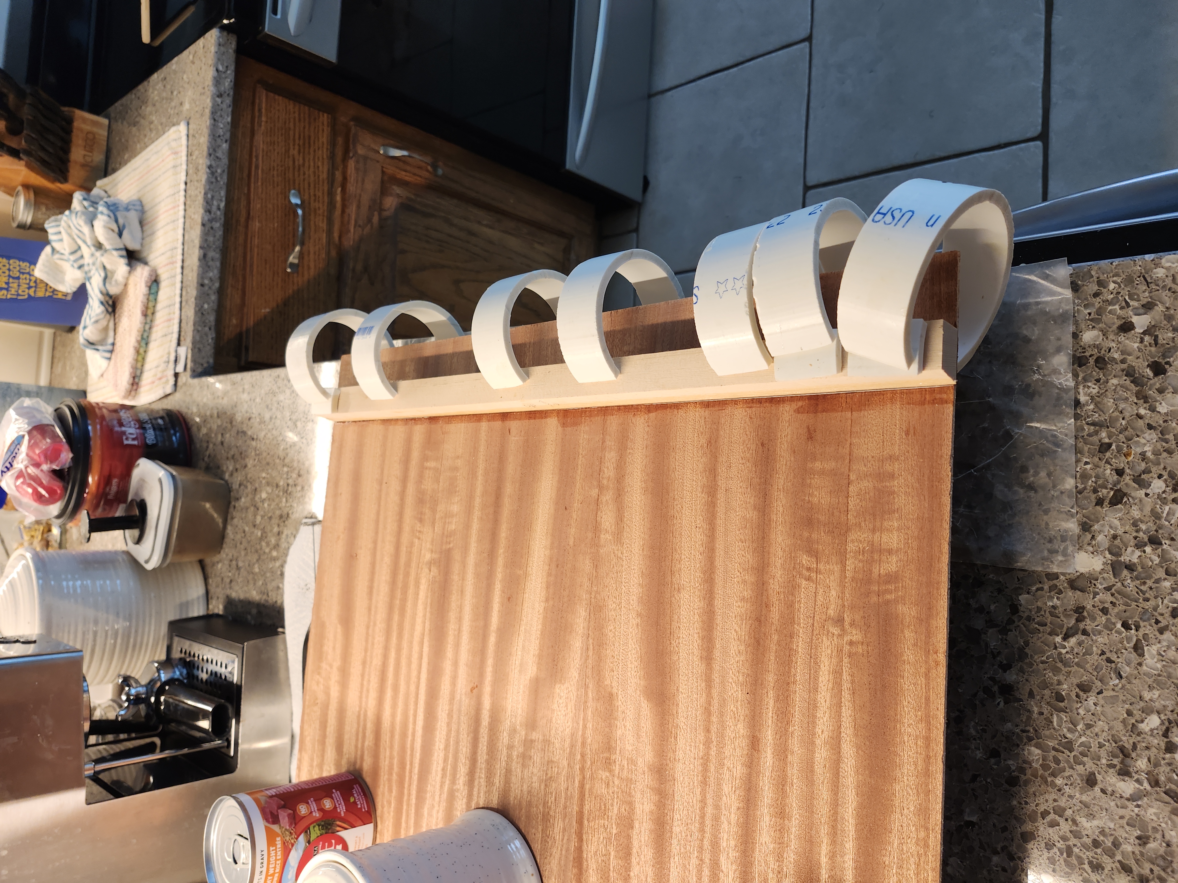

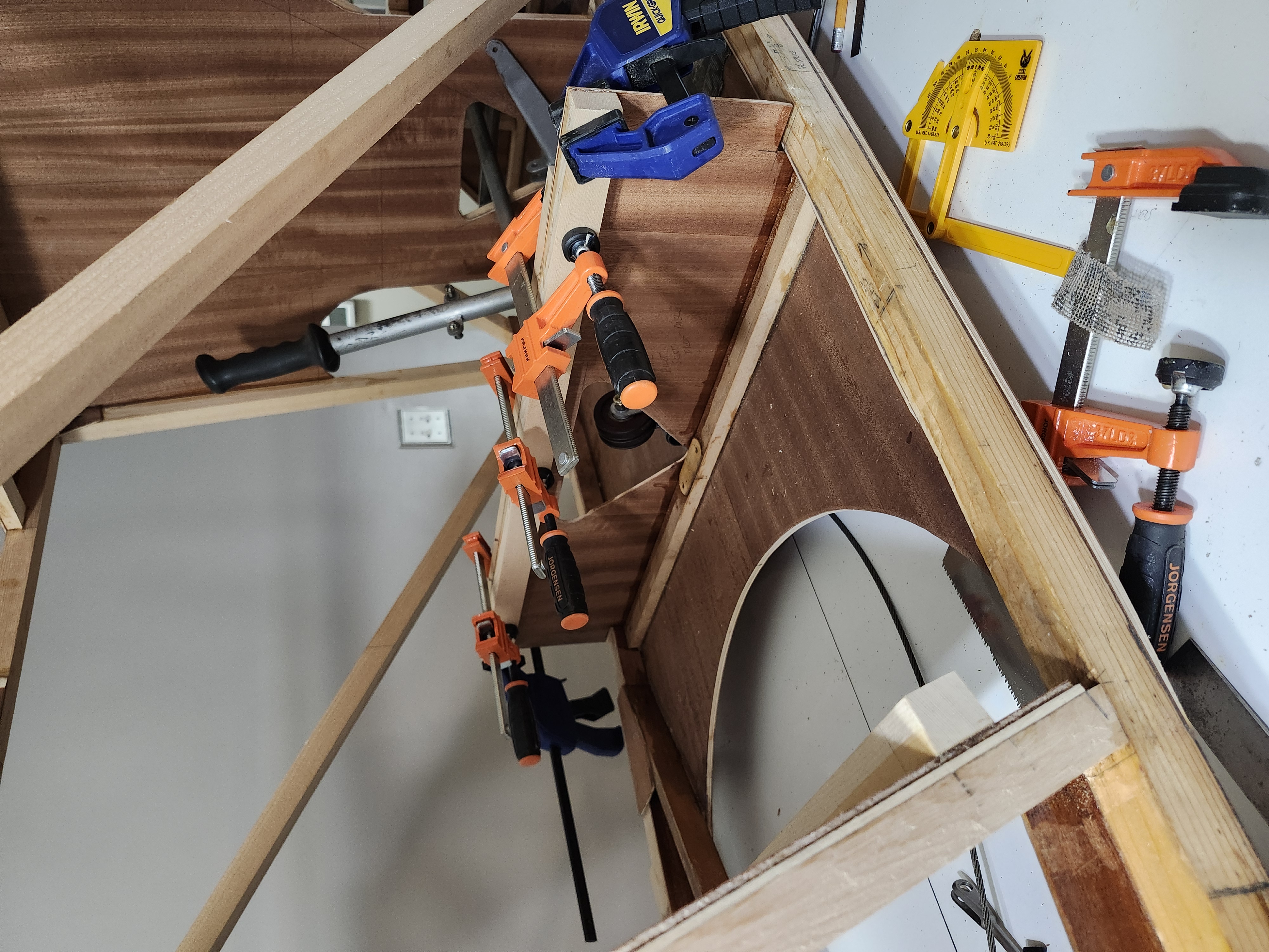

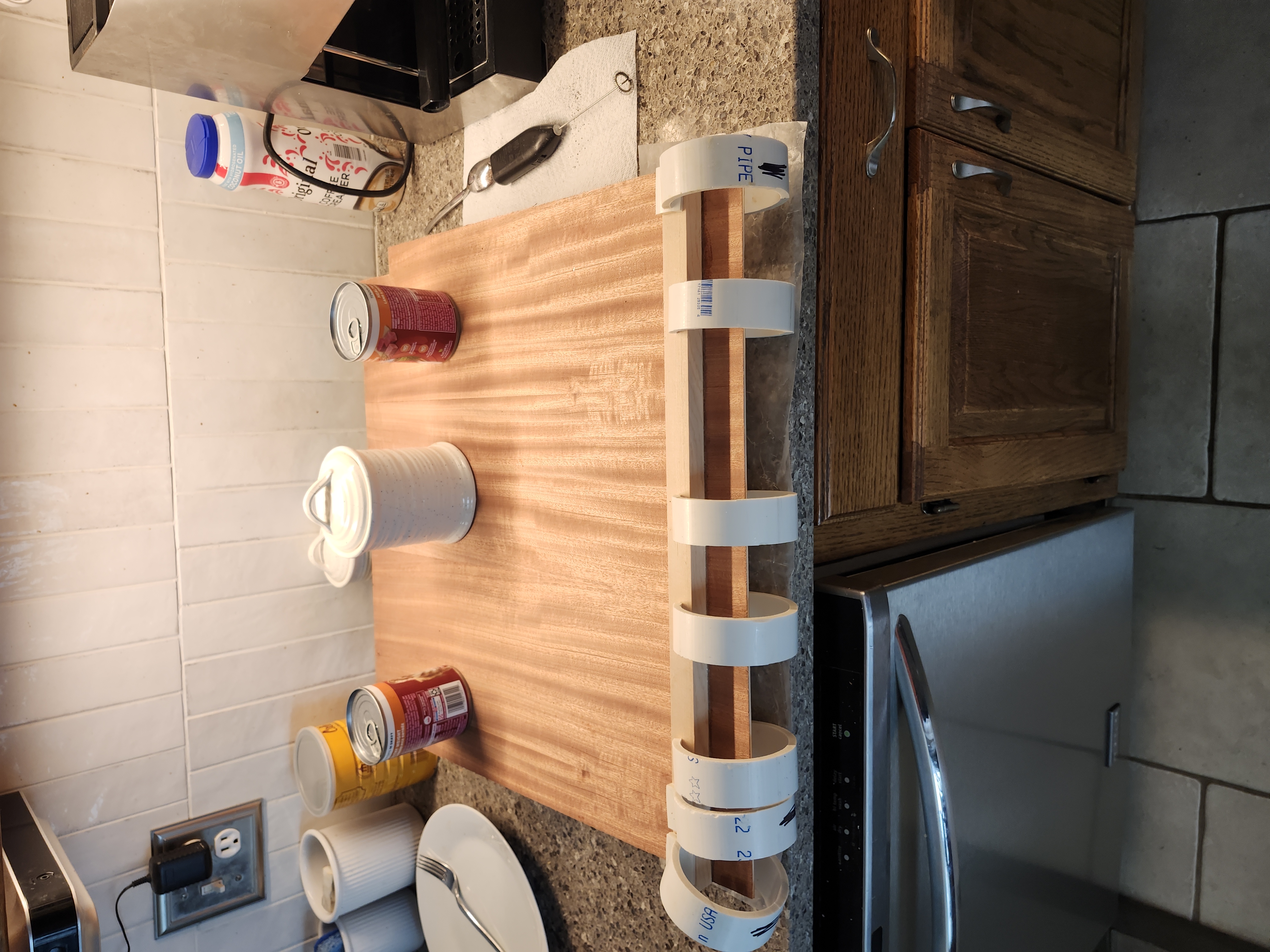

Center seat support glue up.

Interesting detail: the tapered wedges that slope the front seat bottom just a tad. Improves the pax comfort over a flat seat bottom. Was it originally that way, or is that improvement yours?
