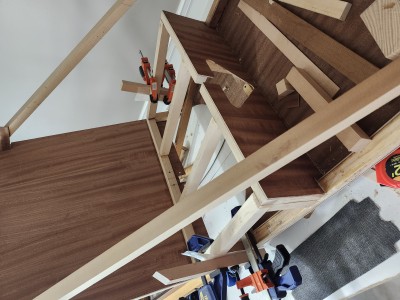

Trying to get re-motivated on the repair. So, rough cut out and test fit of the rear seat back.
Re: N34KP's rebuild
Roger, three-four kilo papa. Proceed on course.

Pilots seat bottom cross brace.

Re: N34KP's rebuild
Pilots seat back glue up.
Re: N34KP's rebuild
Good to see you back at it, Richard. Steady progress wins the day.

Re: N34KP's rebuild
Another piece of the rear seat.
Re: N34KP's rebuild
Keep that T-88 flowing...

Re: N34KP's rebuild
Two vertical pieces gluing into the the rear seat structure.
Re: N34KP's rebuild
Makes me want to build one. I've done a lot of work on them, but never built one from scratch. So enjoyable to work on these planes.
