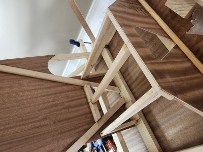

Re: N34KP's rebuild
Center seat support glue up.

Posts: 699
Re: N34KP's rebuild
Interesting detail: the tapered wedges that slope the front seat bottom just a tad. Improves the pax comfort over a flat seat bottom. Was it originally that way, or is that improvement yours?
Posts: 339
Re: N34KP's rebuild
That is my fix to reading the print wrong and screwing up the pieces when I cut them. The glue lines and fits were so good, I didn't want to tear everything out and start over.

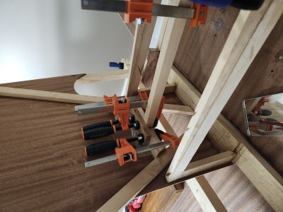

Posts: 339
Re: N34KP's rebuild
Pilots seat bottom cross brace.

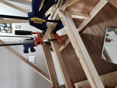

Posts: 339
Re: N34KP's rebuild
Pilots seat back glue up.

Posts: 339
Re: N34KP's rebuild
Impressive how much those two seat backs stiffen up the structure.

Posts: 339
Re: N34KP's rebuild
Two vertical pieces gluing into the the rear seat structure.

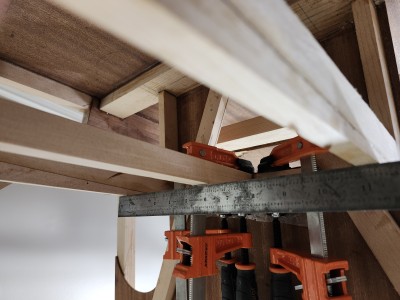

Posts: 339
Re: N34KP's rebuild
Gluing in a couple of rear seat supports.
