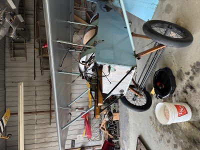

I gave myself an education today in how not to remove a Model A engine. Nothing broke, it was just more work than it needed to be.
Looking back, I should have pulled the wood engine rails and their steel braces off along with the engine. It doesn’t seem obvious at first glance though so let it be a caution to anyone else removing an A from a Piet they didn’t build.
Anyways, it’s off and ready for teardown.

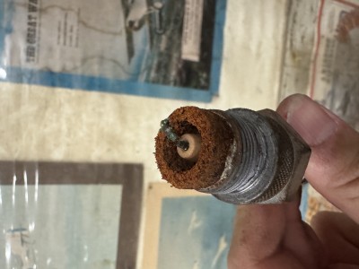

I’m not great at reading plugs, what’s this one trying to tell me? Lol
Other than that, the engine so far has been about what I was expecting. The head gasket shows signs of being blown in two places, most of the valves are sticking, there’s rust but so far nothing critical.
