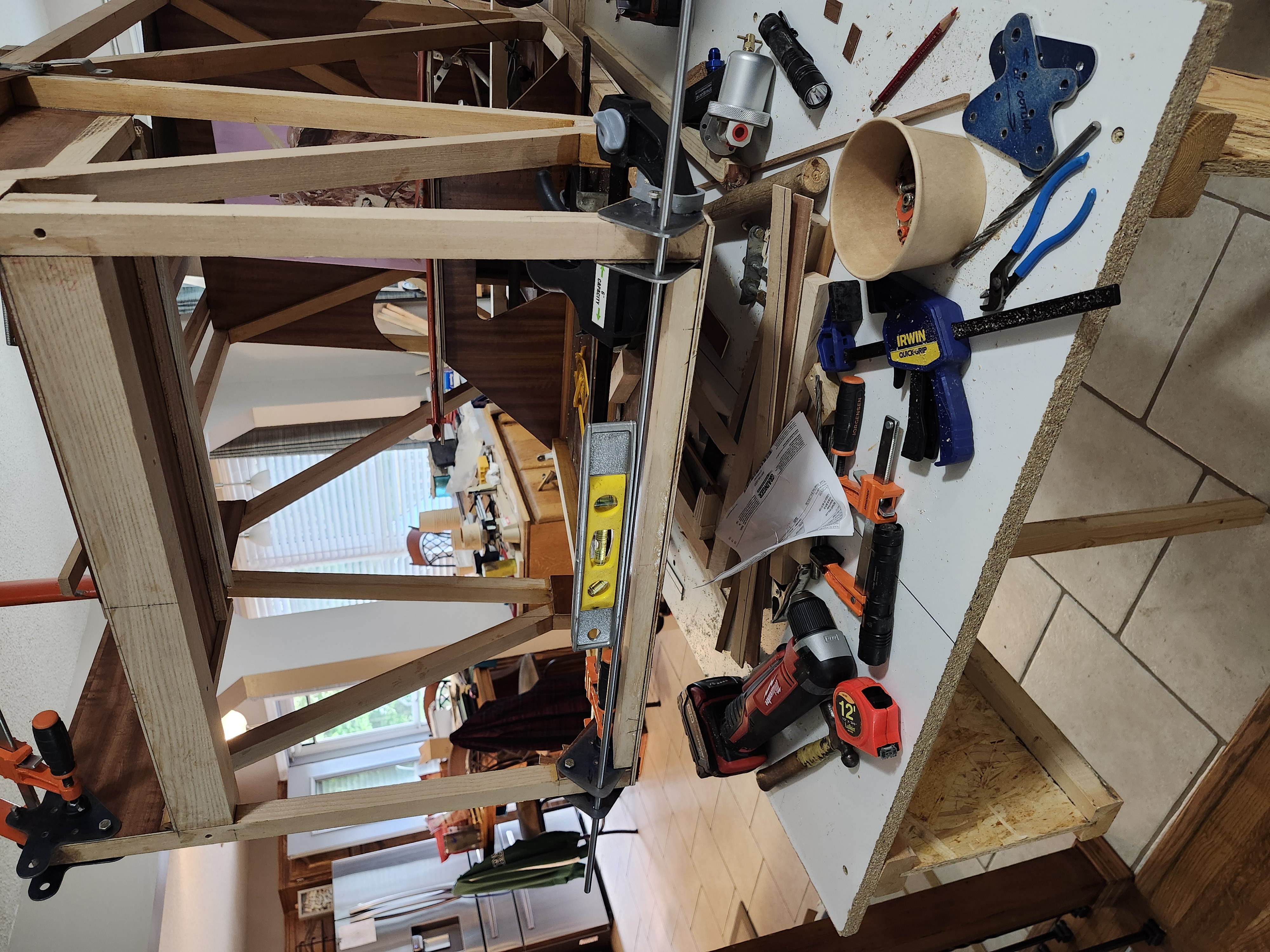

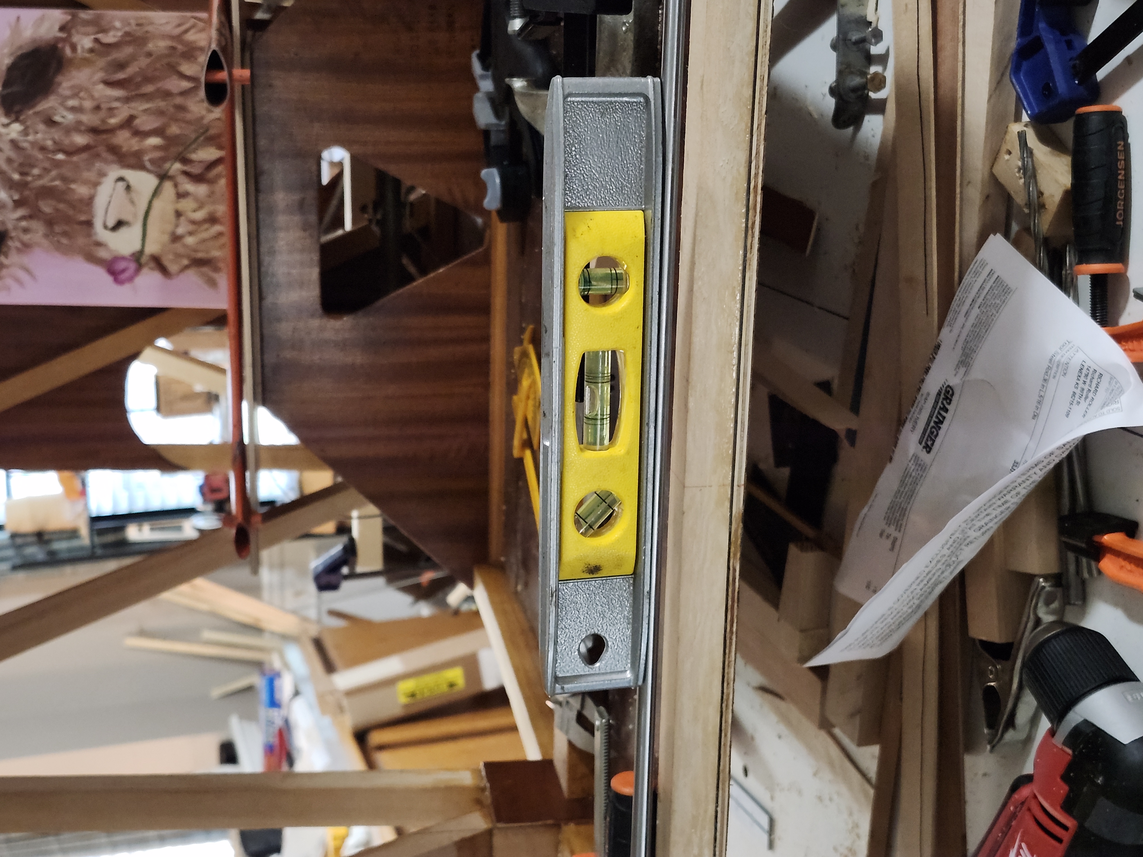

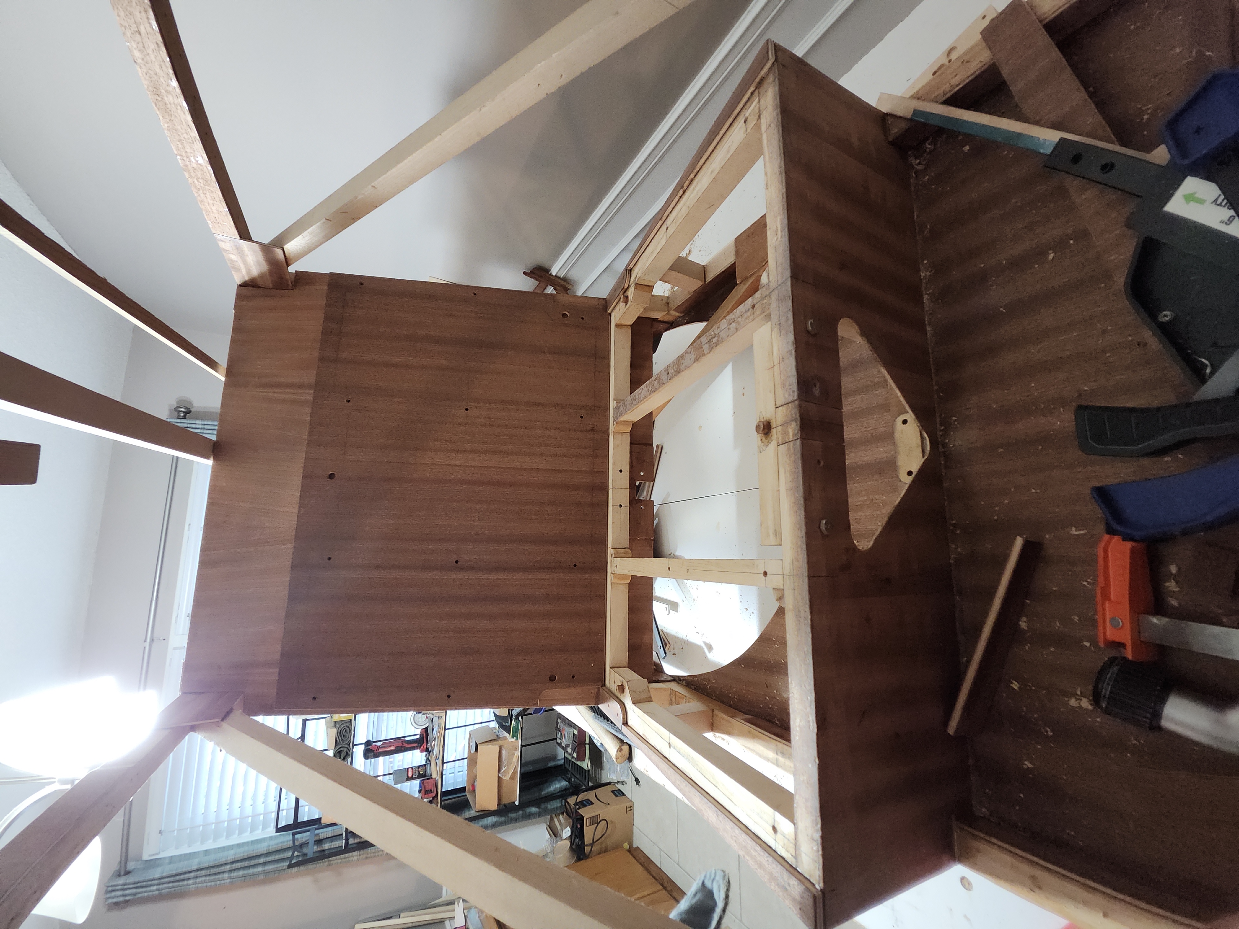

Still plugging along. I've made the 4 lower longerons to engine mount pieces. I don't have a picture of all four, but I do have pictures of the process.
I've laid out the upper longerons pieces and will be starting cutting them out today.
