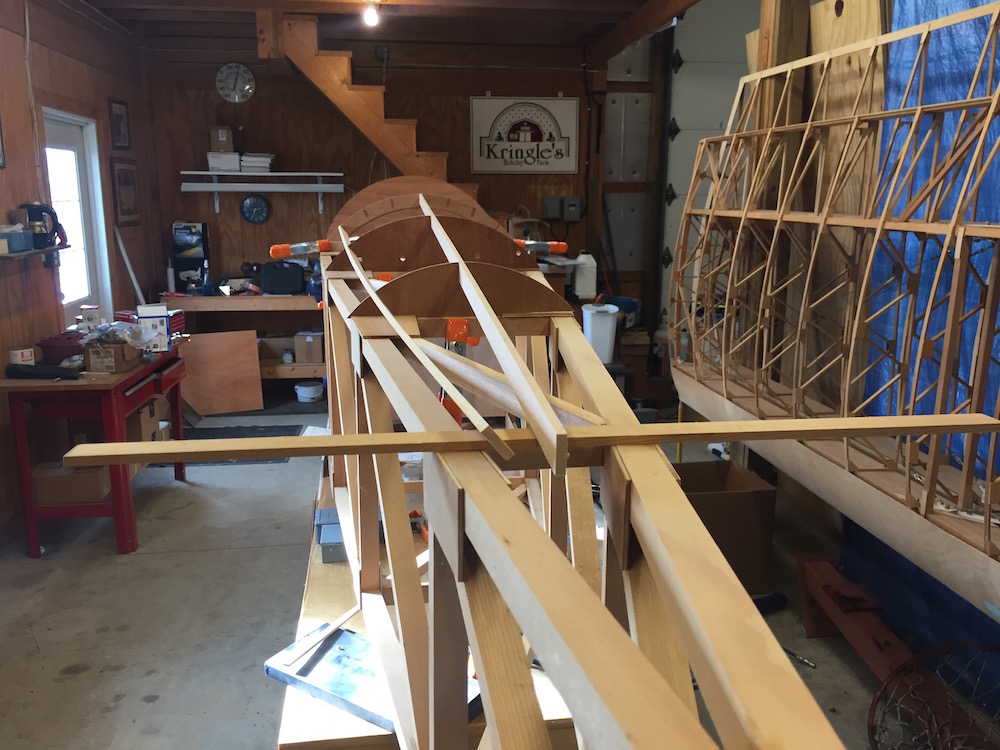

Original Posted By: Timothy Willis
Ive been working on this myself for too long. I have the most forward support(head rest) done and am going to do the most rear one. I tried working my wayback one at a time and it just wasnt coming out. This is an old post I am attachingto here. Is there any newer ones with current pictures?Thanks,John--------John FrancisRead this topic online here:http://forums.matronics.com/viewtopic.p ... __________

Original Posted By: Richard Schreiber
Thanks for the suggestions. I have not abandoned my first attempt at this yetwith scrap pieces of plywood as supports. This is starting to look pretty goodto me now. Does anyone see any problems with this?--------John FrancisRead this topic online here:http://forums.matronics.com/viewtopic.p ... ttachments: http://forums.matronics.com//files/img_ ... ___Subject: Re: Pietenpol-List: Re: Turtle Deck Help!

Original Posted By: "taildrags"
John,The bottom line is do what looks good to you. On the other hand, when planes with turtle decks are judged at Oshkosh, the judges look down the stringers to make sure the are perfectly straight. They are looking for stringers that have no bows in any direction. It can be done, but is more difficult to lay out and perfect. See the attached photos.Rick SchreiberNX478RSValparaiso INOn 11/22/2016 2:22 PM, john francis wrote:>> Thanks for the suggestions. I have not abandoned my first attempt at this yetwith scrap pieces of plywood as supports. This is starting to look pretty goodto me now. Does anyone see any problems with this?>> --------> John Francis>>> Read this topic online here:>> http://forums.matronics.com/viewtopic.p ... 965#462965>>> Attachments:>> http://forums.matronics.com//files/img_1980_173.jpg> http://forums.matronics.com//files/img_ ... ___Subject: Pietenpol-List: Re: Turtle Deck Help!

Original Posted By: "john francis"
John;It does seem to be taking on some pleasing lines! And I realize that you're justgetting underway with it, but if you'll look at the image "tdeck1" that I sent,that piece of plywood over the stringers just aft of the rear seat back isvery important. I rest the palm of my hand right there every time I get outof the cockpit, and if the plywood wasn't there, I would be pushing on the fabricand not much else. You don't have to scallop the aft edge of the plywood,but I think the scalloping helps the fabric lay down smoother and not form avisible ridge where the plywood ends.--------Oscar ZunigaMedford, ORAir Camper NX41CC "Scout"A75 power, 72x36 Culver propRead this topic online here:http://forums.matronics.com/viewtopic.p ... ___Subject: Pietenpol-List: Re: Turtle Deck Help!
