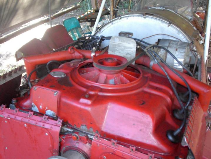

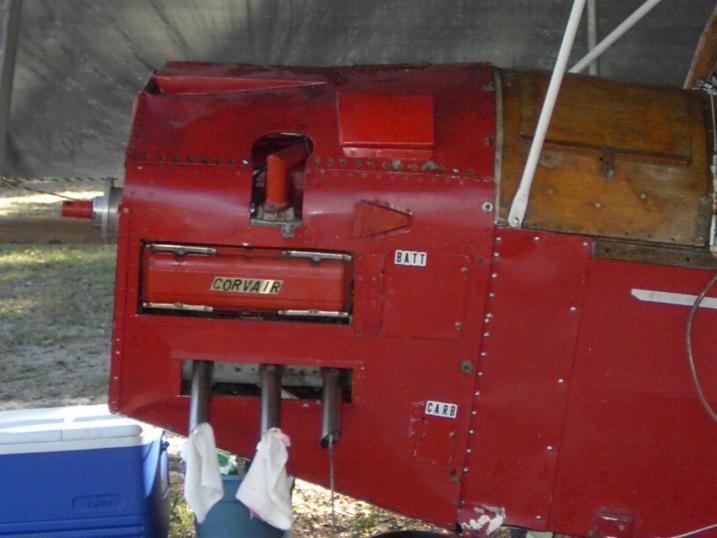

Well, here are the pix of the belt/blower Corvair that I have, but it's not possible to determine whether it had a starter or not. What seems obvious is that the standard conversion parts that William designed will not work with this setup because something has to either bolt to the top cover or to the heads and neither of those is accessible with the old blower in place. You may be on your own here.
I will point out, however, that there is an electric starter conversion that used to be available for early small aircraft engines like my A75-8, using a cordless electric drill as the starter and engaging it mechanically by pulling the drive teeth into engagement with the starter ring gear that way. You can see pix and a description of it on the National Aeronca Association bulletin board right here: http://joea.com/phpBB2/viewtopic.php?t=2744

EAB4, thank you... I understand that the modern (WW) conversions don't use the original tin and blower and all that... I have been in the Corvair movement for 20 years and I own and have studied William's videos and four different editions of William's conversion manual in detail, including the latest. It's just that Steve said their engine is the old-style conversion, thus my reply. I see no benefit to keeping a blower-style setup except if the airplane is flying like that, it will have to be taken out of service to convert the engine the modern way, and it will cost money. Not saying that would be a bad thing though, because most of the engines that were converted using the blower and belt setup also retained the automotive cast pistons, cam, ignition, and all the other things that really ought to be changed to make a truly airworthy engine that puts out its best power where our airplanes need it. At the very least, dispensing with the oddball belt and blower setup would save weight, complexity, and the power that the setup robs from the engine.
Builder's choice though.
