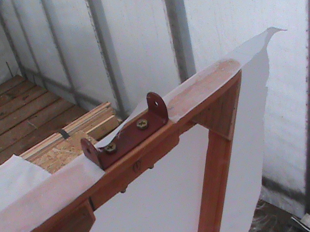

Hi this was my solution to hinges, I cut from a piece of 2 x 2 tubing. made a jig for the drill press both ends and the screw holes are drilled the same distance from the corner.
when you put the hinges on off set the last set in the opposite direction
