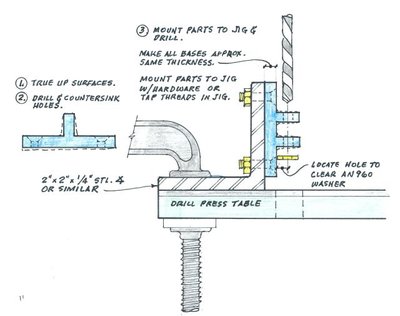

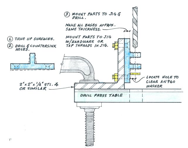

Several builders who have bought the rough-cast hinge parts from me for turning into finished parts have asked for ideas on how to set up a jig for drilling the pivot pin holes in the parts, so I made a sketch that I hope will help. Although my jig isn't like what I've sketched, it doesn't have to be... the idea is to get the bases nice and flat and more or less the same thickness so when you put each part in the jig, the pivot holes will all line up. It's not a precision operation, but I can offer some hints. The main one is to square off the bases and edges first so you'll have a true reference surface, then drill the mounting holes so you can then mount the parts securely in place while you perform the other operations.
With each part held securely, squaring up the sides of the 'ears' with a mill or file is the next most important step because the sides and edges of the parts are slightly tapered when they come out of the mold so that they will release from the mold easier. If you don't square up the sides of the 'ears' before trying to drill the 3/16" pivot pin holes, the drill bit will tend to 'walk' off of center and the holes won't line up as they should.
Once again, the attached sketch is just an idea to get you thinking about how to hold the part securely while you drill the holes. As I've shown, placement of the holes on the 'ears' is not critical but should be sufficient to allow a standard thin AN960 washer to fit on the face of the ear without having to file a flat onto one edge. Don't go too far in the other direction though, because the weakest spot in the whole hinge pair is the top of the ear on the single-tab hinge half and drilling the hole too close to the outer edge of the tab will reduce the strength of the assembly.
